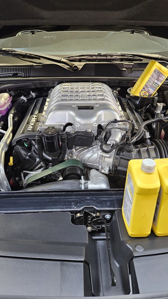

    My Tundra isn't due yet, but I did change oil today in my Hellcat. Doing your own maintenance is a good thing.20250131_170616.jpg

    What's a Hellcat...and why is it relevant to a Gen 3 Tundra thread? Or do you just like flexing?

    I'm just adding "changing your own oil". But I'll gladly remove it since it's not a 3rd gen Tundra.
    Was just making a point to anyone "on the fence" about doing their own maintenance. It's rewarding, and saves alot of $$$!
