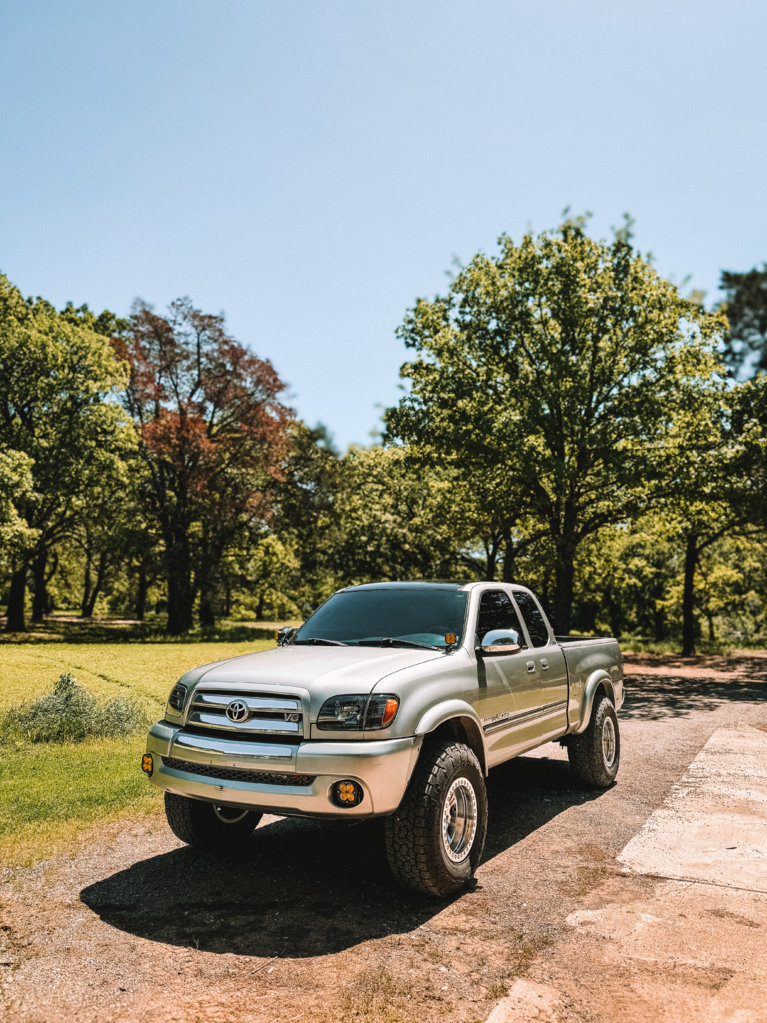

    What's going on y'all. Moseying on over from the 2.5 side. Unfortunately, my 15 TRD Pro was totaled and decided to pickup a first gen. I'll update this as more stuff shows up.
    2003 Tundra Access Cab 4WD
    Picked it up last Sunday. The kid I bought it off of was ambitious and tried to fit 35's and I had to borrow a friend's stocks just to test drive/take it home. Had some janky custom rear bumper I had to pull off cause I was scared of cutting myself and the license plate bolts snapped while trying to swap the new plates. Already stopped by the fabricator and got on the books for a high clearance rear bumper. Lots of heavy maintenance to do, but overall enjoying the truck.
    Been super busy doing some heavy maintenance and getting this thing up to par. Swapped out the easy stuff first.

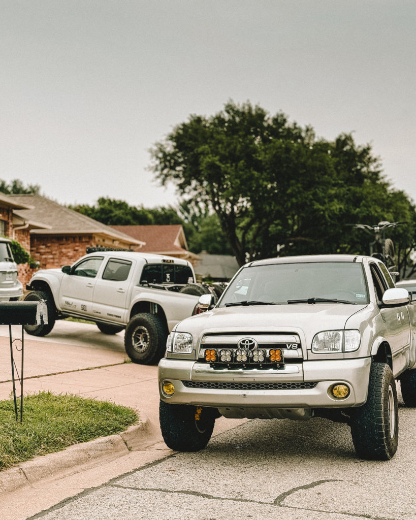

    Finally got off the 4R stocks.
    Toyo Open country AT3 305/70/17
    SCS F5 17x9 -38
    305’s might have been a bit ambitious but sucking it up until I can knock back the pinch weld tomorrow. Also need to raise the front coilovers. Ride height is a touch too low

    Ok, now I'm invested. Want to know what you do to get those tires to clear with full articulation (including reverse at full lock) without stacking a spacer atop shocks. :popcorn:
    Sure looks good!

    They currently rub like hell. I got more ambition than sense haha. Coilovers are set real low so I need to turn them up, cut the pinch weld back and probably beat the cab with a mallet. Trim the flare and we’ll figure it out as we go haha. My last tundra had 37’s so I was NOT going to settle with any tire that started with a 2 :rofl:
