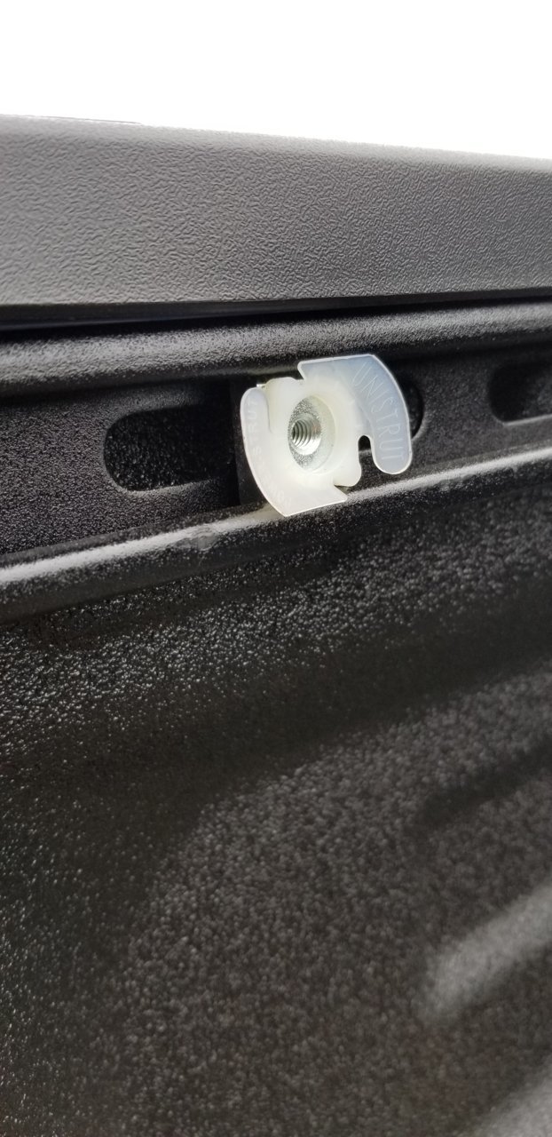

    Mine is the same with the factory installed bedliner. How did you find the predrilled holes? Did you use anything special to clean them.out?

    Yes! These go into the rails of my Chevy I traded in but just remove the back plate and use the m6x1.0 screw, easy. pretty secure.
    I'm thinking about using 3m double sided table on the mounts won't move around but it seems very secure so.. we'll see.

    I did a feeler test used a screw driver you'll feel it depress a little. It's quite soft, I just use a drill bit to press in and then proceeded to use a razor blade to gently cut into it. I didn't remove all the material, I was able to thread the m6x1 screw into it without any issues.
    I will probably replace the screw with black screws in the future so it'll match better.

    Sure. I used a M6 x 1.0 x 16 screw. I just hit it once with a cutting blade. Screw it into the hole and it cuts the paint. Go slow. May back to back it out and try again. But it worked great.

    Thanks Phabej! I had no idea the material was so soft. Your instructions worked great. Posting a couple pics in case it will help the next guy with a bed liner. Mine was factory installed and they appeared to have stuffed paper into the holes prior to spraying in the liner to make this a lot easier... gotta love Toyota.

    Awesome that's all I did too. I've seen videos where they can just rip out the entire spray on liner after cutting it with a razor blade. Peels off like an orange.
    Glad you got it working. Thanks for updating the thread with photos.
