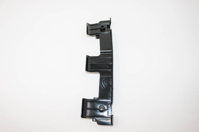

    Where did you get the brackets?

    x2. Looking for some solid/thick brackets.

    I have lights and bezels if interested

    I have these led rigid fog lights, bezels, brackets, and wiring harnesses for this setup that I looking to sell. I was all set to install and things changed and I need to order a bumper with deer protection and cant use them. PM if interested.

    Has anyone found a bracket that works with the Rigid SAE fog lights yet?

    I bet if the light was removed, cover installed - the light would fit back into place. Just a guess based off the side clearance I see on pictures posted

    Is anyone selling these brackets anymore? I need a set ASAP!!

    Where do I get those brackets? Which ones are you talking about?
