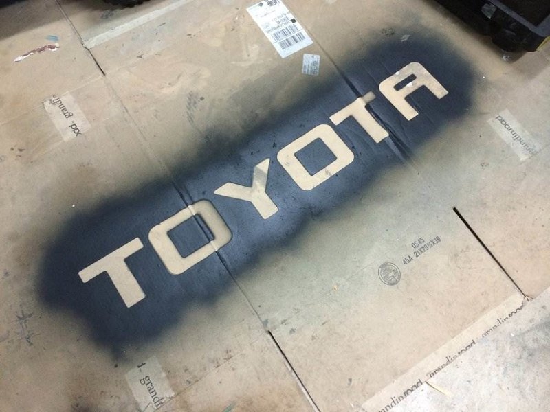

    First step was to clean and paint the letters. I used a self-etching primer and then a flat black paint to cap it off.

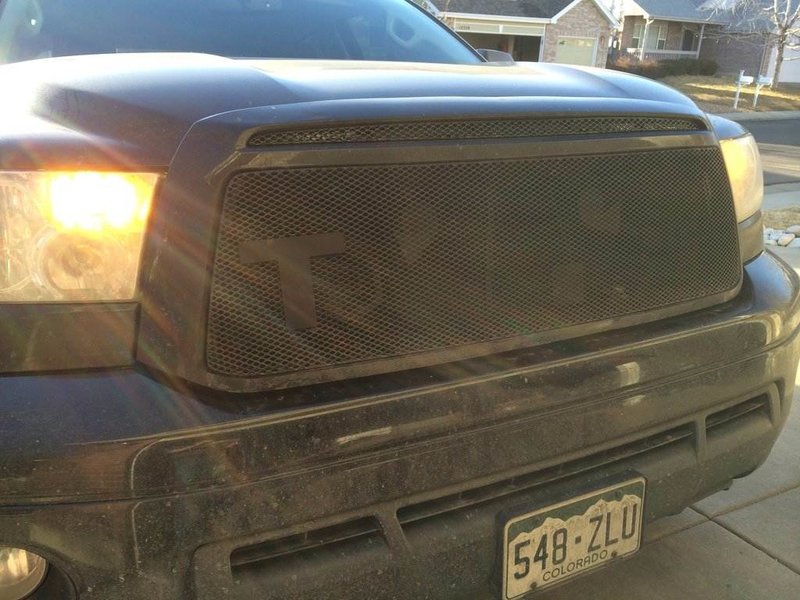

    I started applying the letters one by one to the grill starting with the outside letters and moved toward the center. The heat gun came in handy here as well. The grill mesh and the tape were heated to a warm temp before pushing them on. I used the lower blue tape as the guide for the bottom of the letter and just eyeballed the center between strings. As I was applying I used a level on the top of the letters as I wanted to get them placed as best as I could the first time. Once leveled and placed, I pushed them on hard to ensure adhesion. Tape was then removed to complete the project.

    Recent picture. Still holding strong. The paint on the letters does have chips in it. Expected in Colorado.

    BRIAN, is your grill curved at all or is it flat? Should I be worried about attaching flat letters to a curved grill?

    Mine is curved. Worked fine. To help you could leave tape off the middle of the letter so it tuck in.
