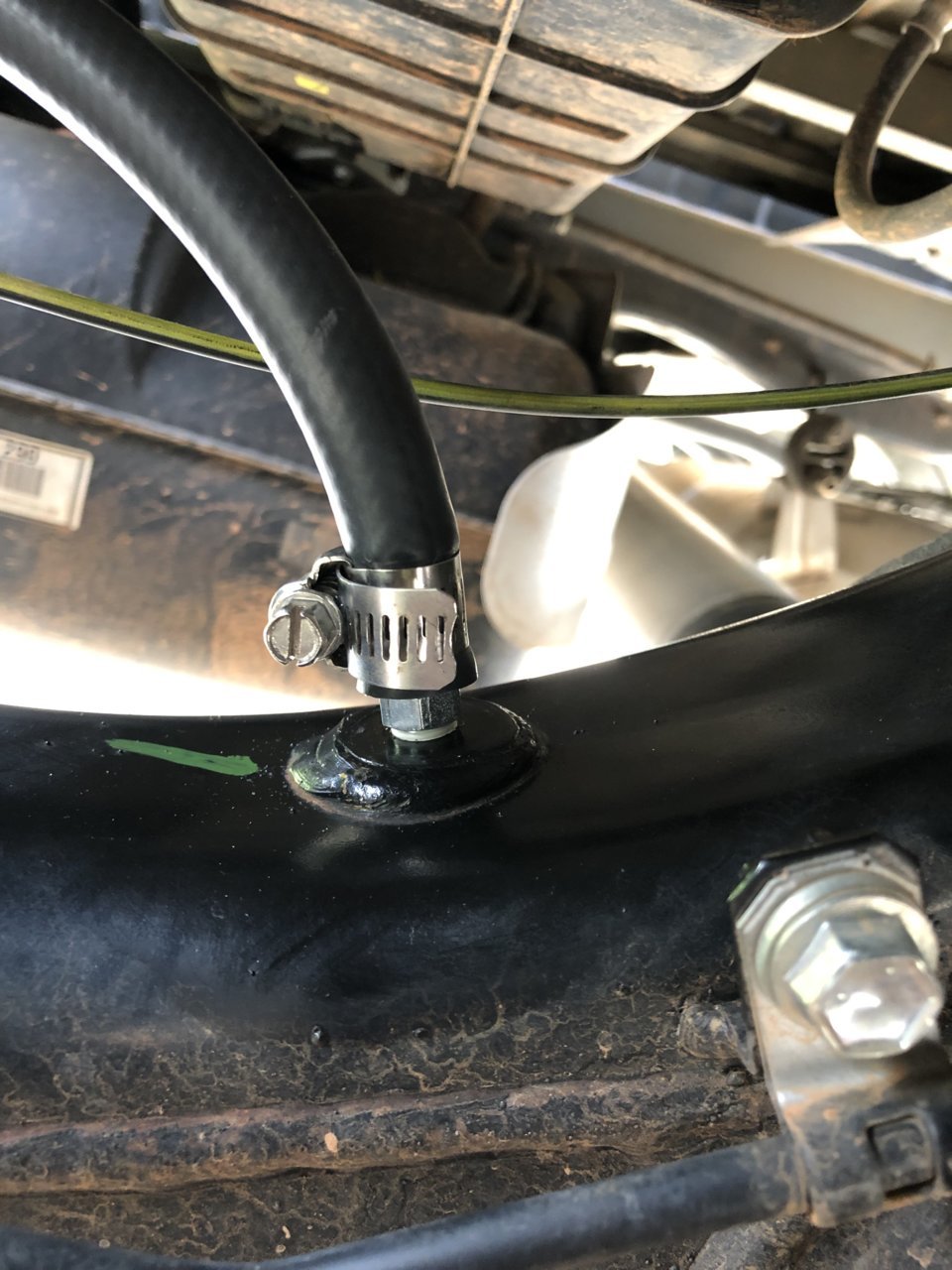

  30. Sep 3, 2022 at 4:57 PM
    #270
    ToyoD
    ToyoD New Member
    Jul 9, 2021
    #65325
    40
    Drew
    2021 SR5 DC
    Build page link in signature
    I did mine today and FYI it’s a M6x1 (standard thread pitch). A 16mm length one fit perfectly for me with the hose clamp, regular, and lock washer with just a little thread sticking out of the top when tight. Great spot to put a thread, thanks Toyota
    851BCF95-43B7-4AE1-98FD-D6A3FD93D65B.jpg CFCCBA70-5CA3-4CB0-804A-E9B2555686CF.jpg C424D72F-6876-4A51-B2B6-FD054A74C086.jpg 84C7B5AF-BB28-4FC9-A380-3777B9BE20F7.jpg
    And thanks to everyone on this thread for their input. This community is awesome at sharing info!
