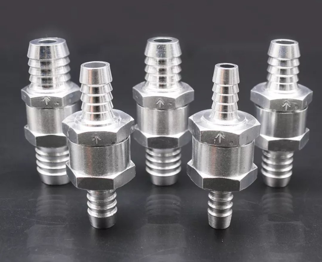

    @MadMaxCanon so these one way vavles would work as well? I think it would but just making sure.
    I was thinking of putting this in line so the air goes out but not come back in.

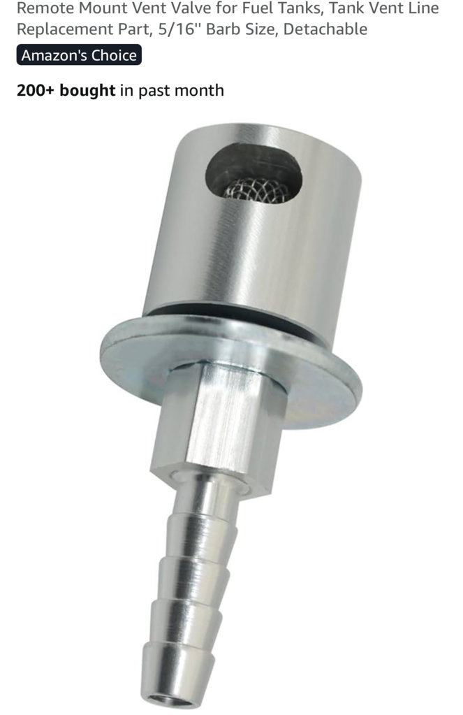

    I'm not familiar with those but you want a 2 way valve for sure. You want the breather PN that is in the engine bay.
    This is what I used along with the union that goes with it for the diff connection.
    https://www.amazon.com/gp/aw/d/B06XHBY38X?ref=ppx_pop_mob_b_asin_title

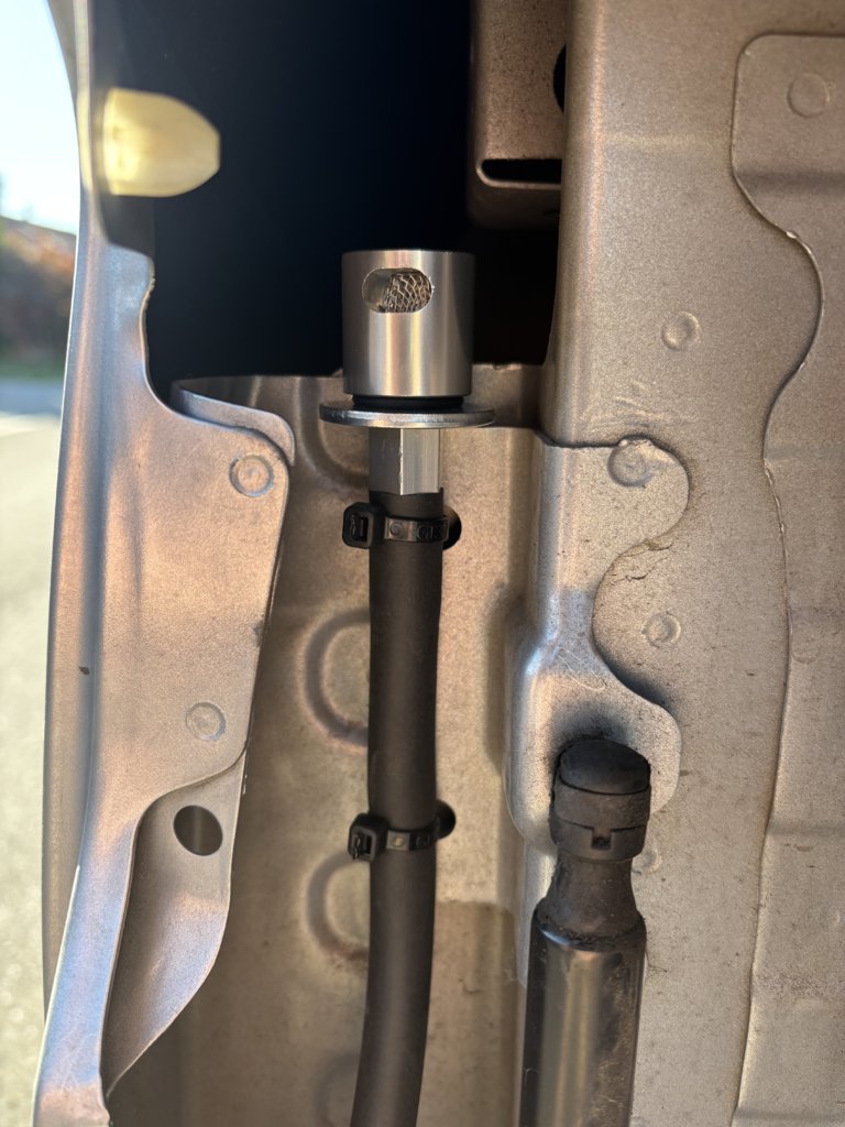

    @MadMaxCanon good morning. I just did this mod a week or two ago. I used the oem valve that I relocated from the axle to just above my d/s tail light via about 9ft. of hose. That valve is one way, lets pressurized air out, but doesn’t allow ambient air in. Seems you’re saying it’s better to have open airflow in both directions?

    The difference is probably minor, I'd have to concede that the way toyota designed it is fine, but I can't see why 2 way wouldn't be better. The way stock is, I can understand why it's one way, you don't want water getting sucked in when it's raining or if you are submerged. But when you extend the line to somewhere without any danger of ingress there are no negatives, except for cost if you are toyota.
