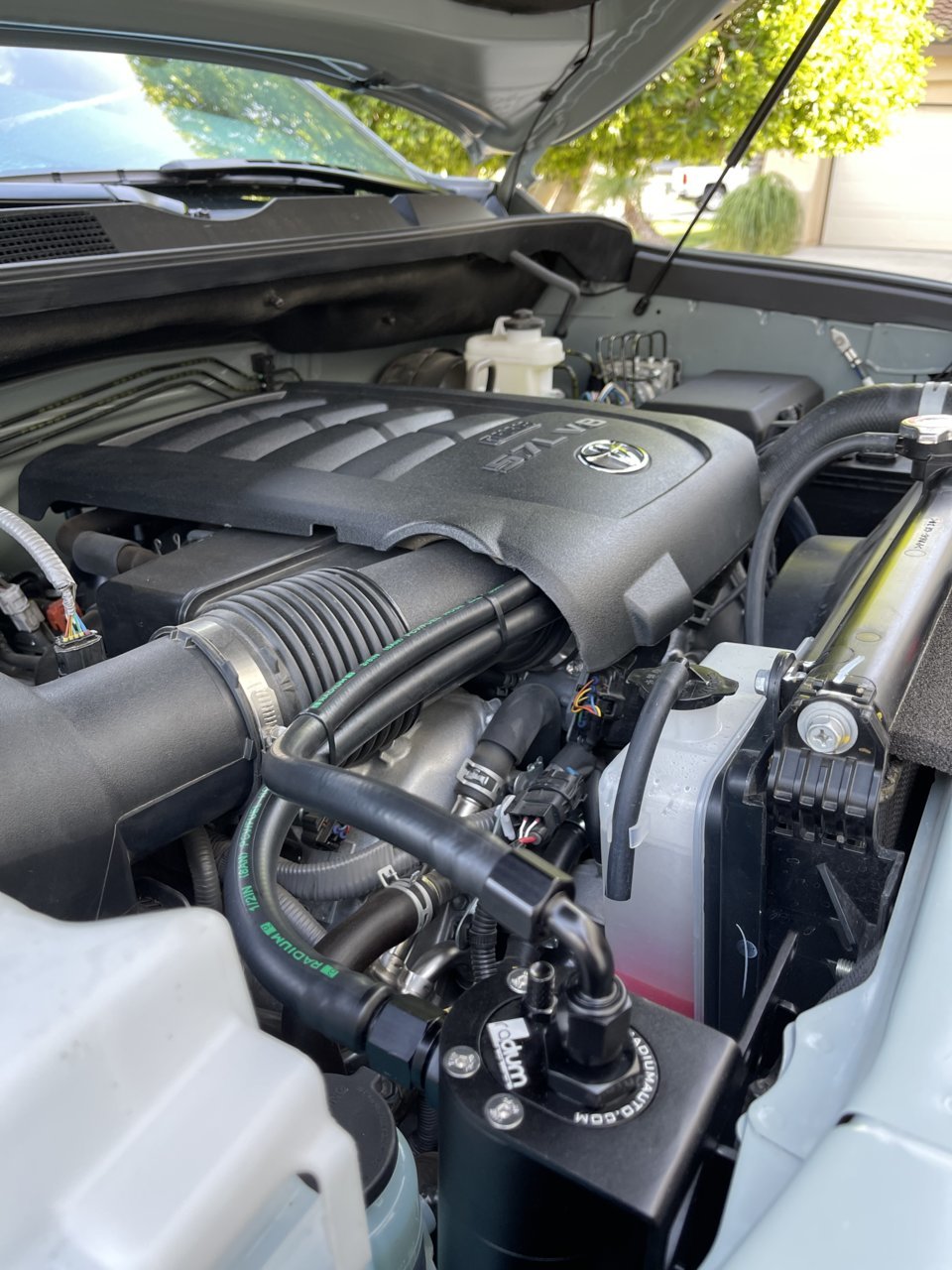

    Ok. I need to settle this once and for all. Does the 5.7L tundra engine uses direct injection or sequential injection. I just order the radium catch can. Now I think I don’t need it anymore. If the gasoline with clean the intake valves I don’t think I’ll be needing it. I don’t have Supercharger.

    There are alot of opinions on whether catch cans are necessary or not based on DI or not.
    Regardless of engine style the PCV dumps un-necessary contamination into the intake to be burned in the combustion chamber. The intent of the PCV valve in a closed loop system is to minimize emissions and make the EPA happy. The pcv dumps moisture / oil and blow by gases back into the intake so it can be burnt in the next cycle in the combustion chamber.
    For non-DI engines, fuel is injected into the intake and helps wash the moisture /oil/ gases into the combustion chamber and the fuel helps clean the back side of the valves. In DI engines there is no fuel to provide this cleaning task so buildup can occur in the intake and on the valves.
    My opinion is that a catch can help minimizing the root cause of contamination before it gets to the intake regardless of fuel injection type.
    I have a catch can on my Tacoma and have collected 8oz of fluid a month in the winter. Volume collection has been highest in the winter. Most of it is condensation but the can still stops the fluid from being dumped into the intake. I will be adding a can to the tundra soon.

    Ty for your input. I think I’ll just put it in when it arrives. I walnut blasted my bmw 335i. It took me two days to finish. Too much work. Don’t wanna do that again.

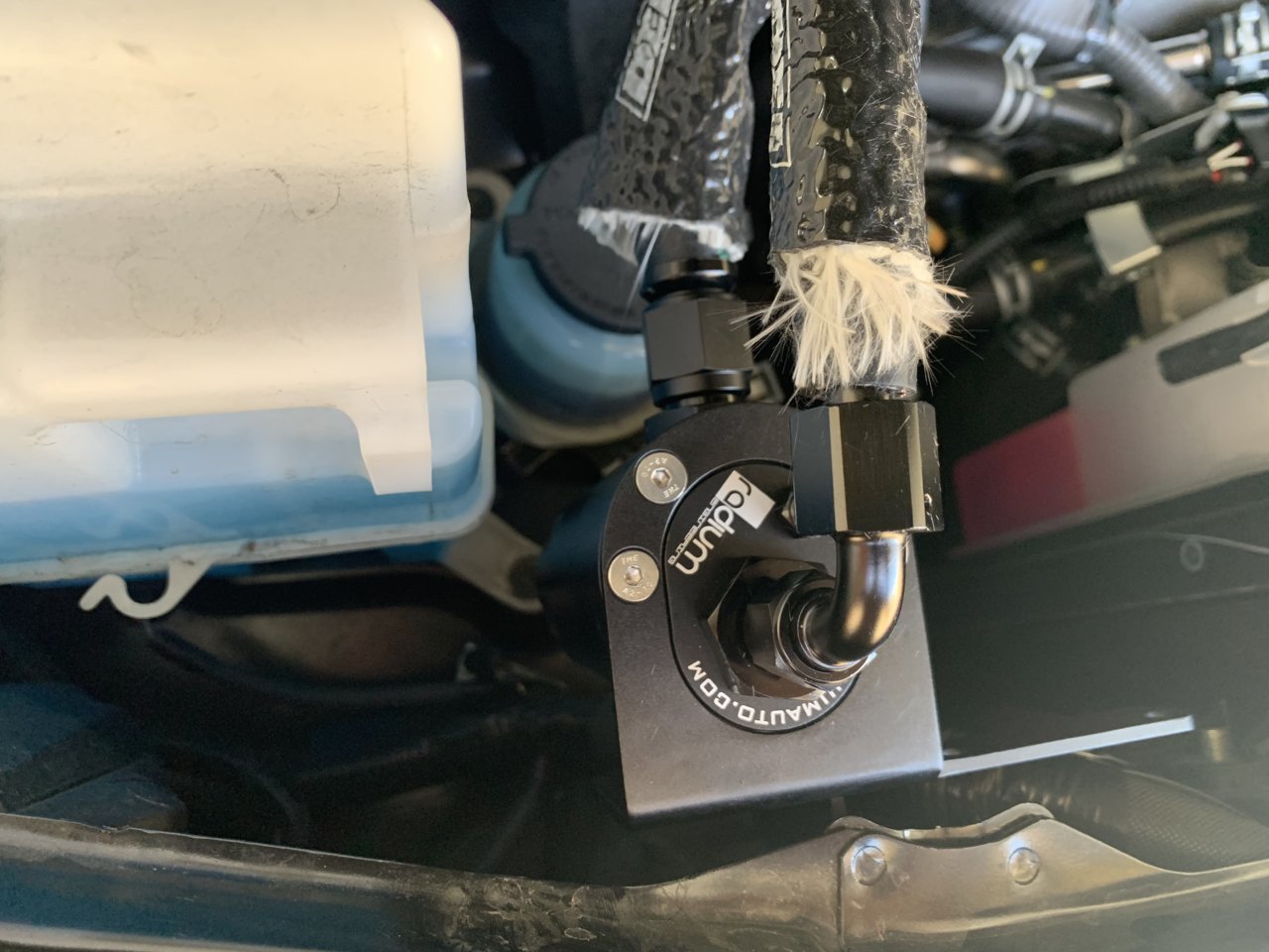

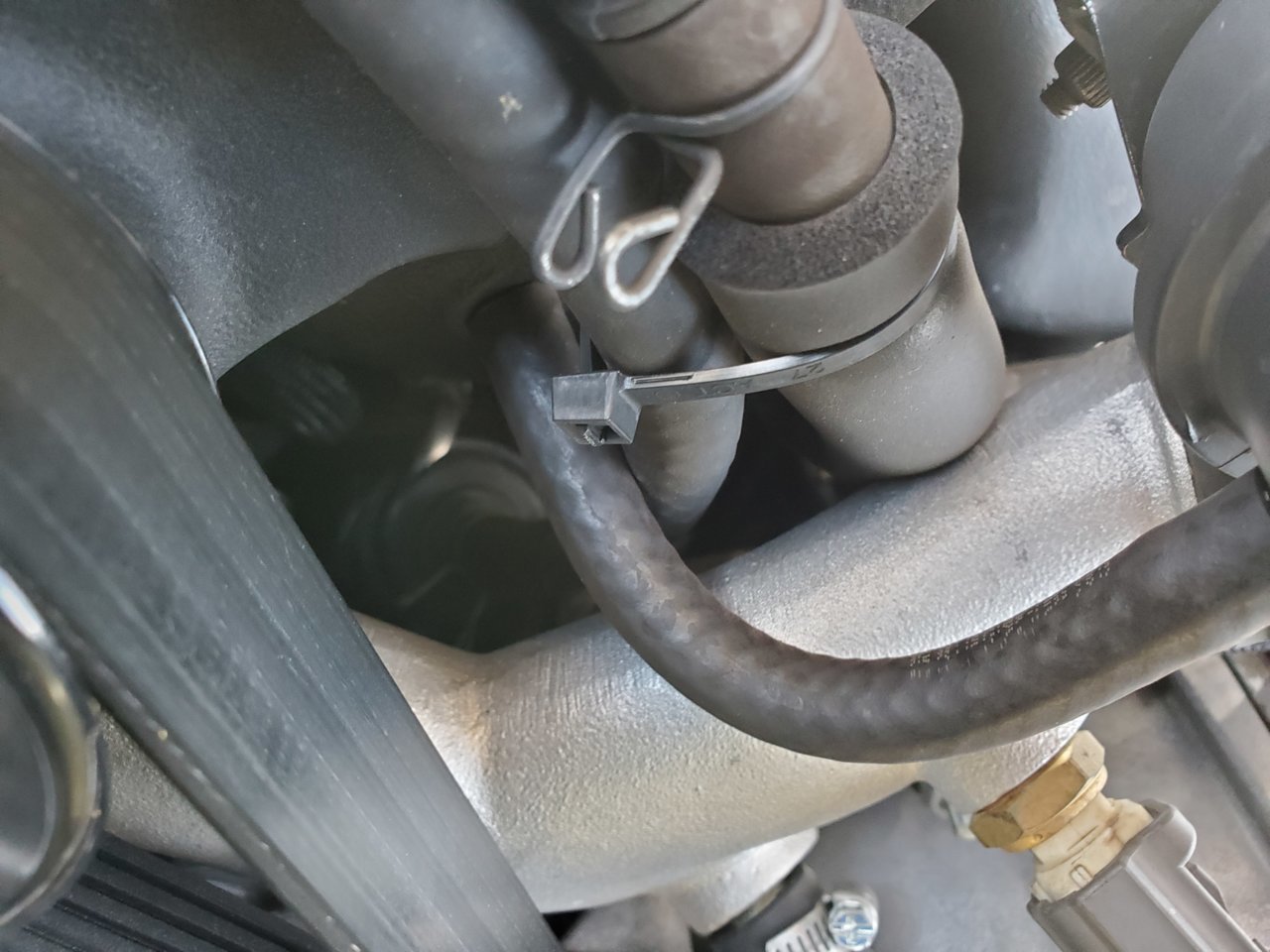

    Just installed the radium catch can. Couldn’t route the hoses underneath the intake, but it works
    Krewcial and AZTundra like this.
  6. May 23, 2020 at 10:25 AM
    #96
    AZTundra
    Feb 13, 2018
    #12894
    4,488
    Paul
    Phoenix, AZ

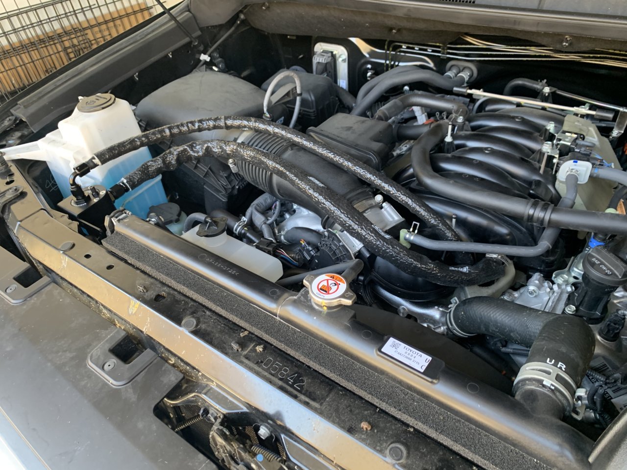

    What's the covering that you have over the hoses? Is that needed? I didn't put anything over mine.
  7. May 23, 2020 at 1:50 PM
    #97
    Sickining
    Sickining New Member
    Nov 16, 2019
    #38722
    27
    Che
    San Francisco, CA
    2019 tundra CM Ltd
    It’s a DEI heat shield for the hoses. Preventive measures.
    How did you route your hoses. Did you get it underneath the intake? Also are you catching anything from the crankcase?
    AZTundra[QUOTED] likes this.

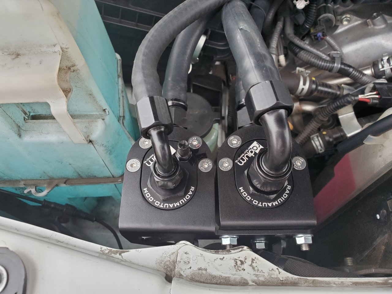

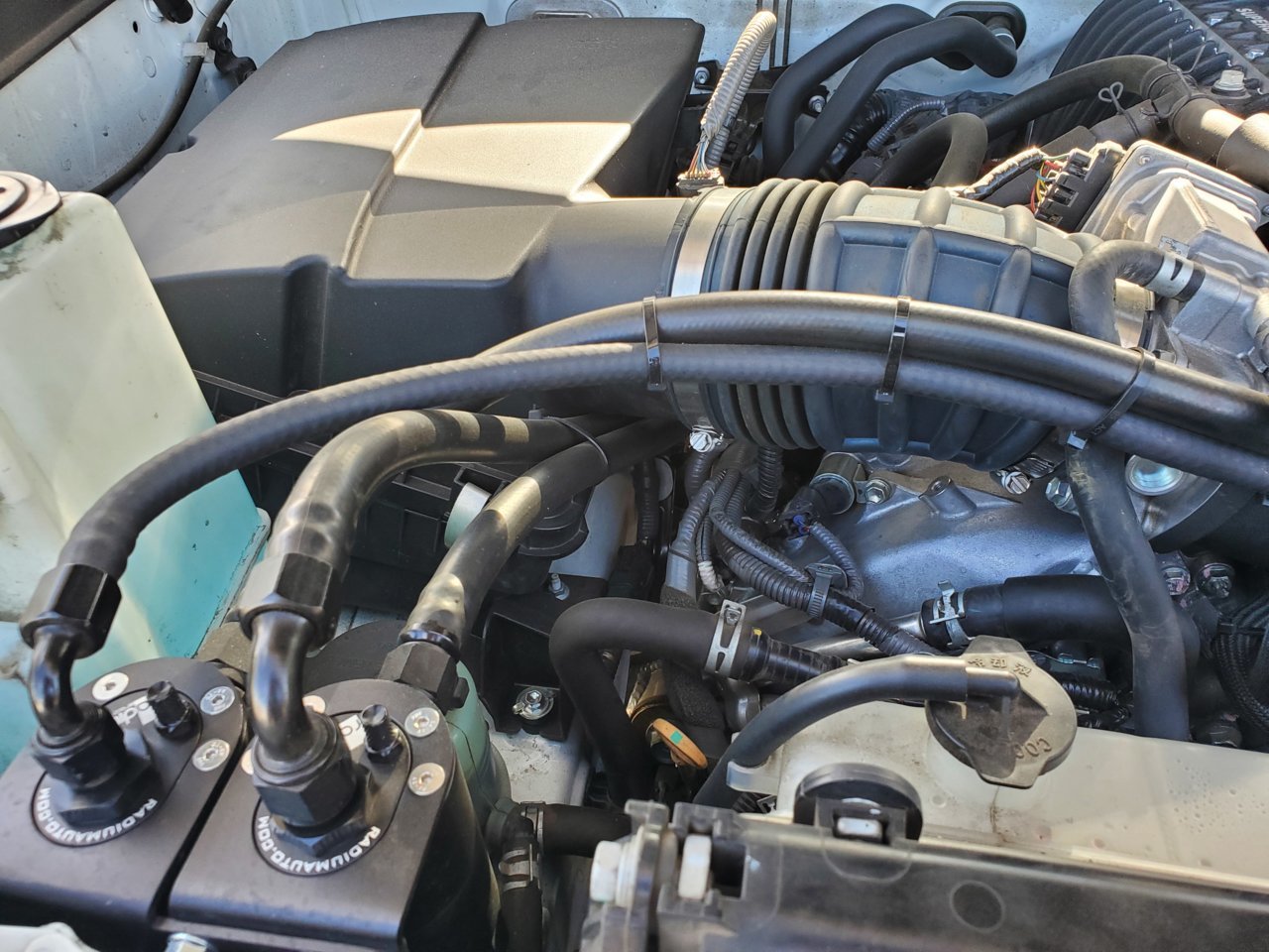

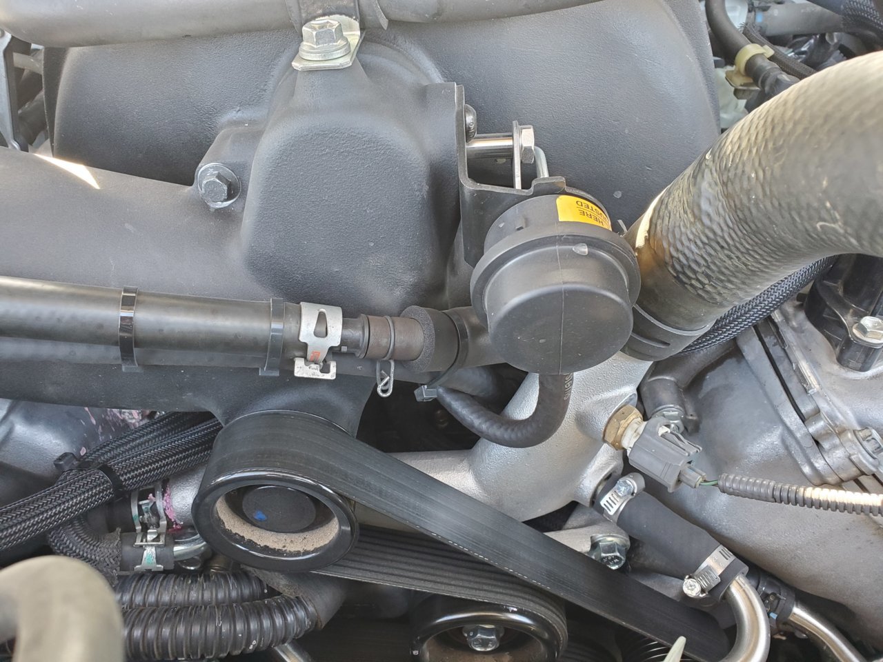

    I'll take a picture of the routing shortly. Crankcase can doesnt seem to catch anything yet after about 3200 miles.

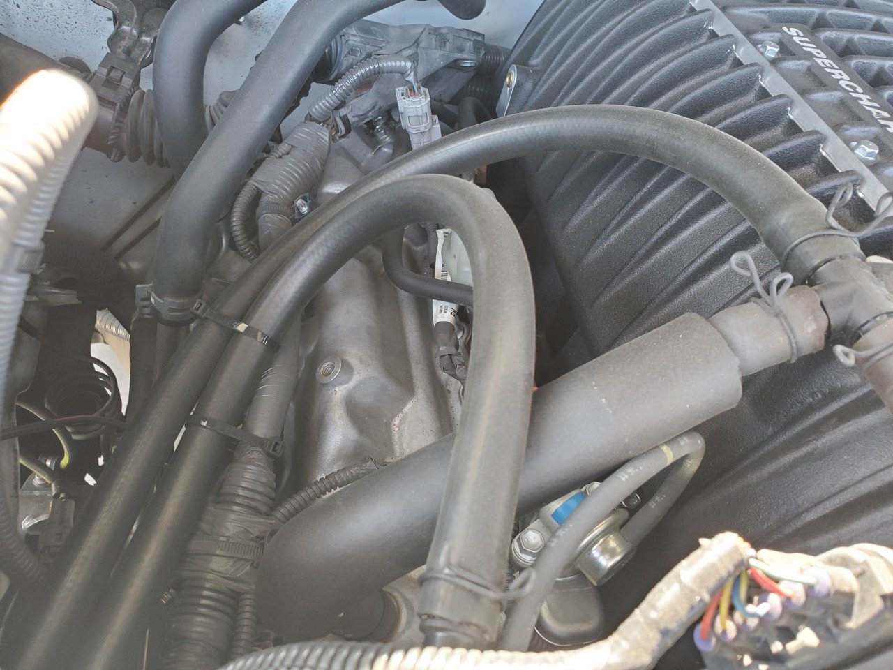

  9. May 23, 2020 at 5:54 PM
    #99
    AZTundra
    Feb 13, 2018
    #12894
    4,488
    Paul
    Phoenix, AZ

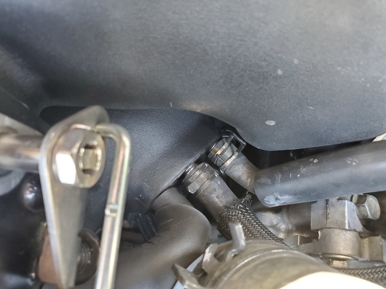

    My setup is a little different with the Magnuson, but here are some routing shots of both can lines (pcv, crankcase).
    WVI likes this.

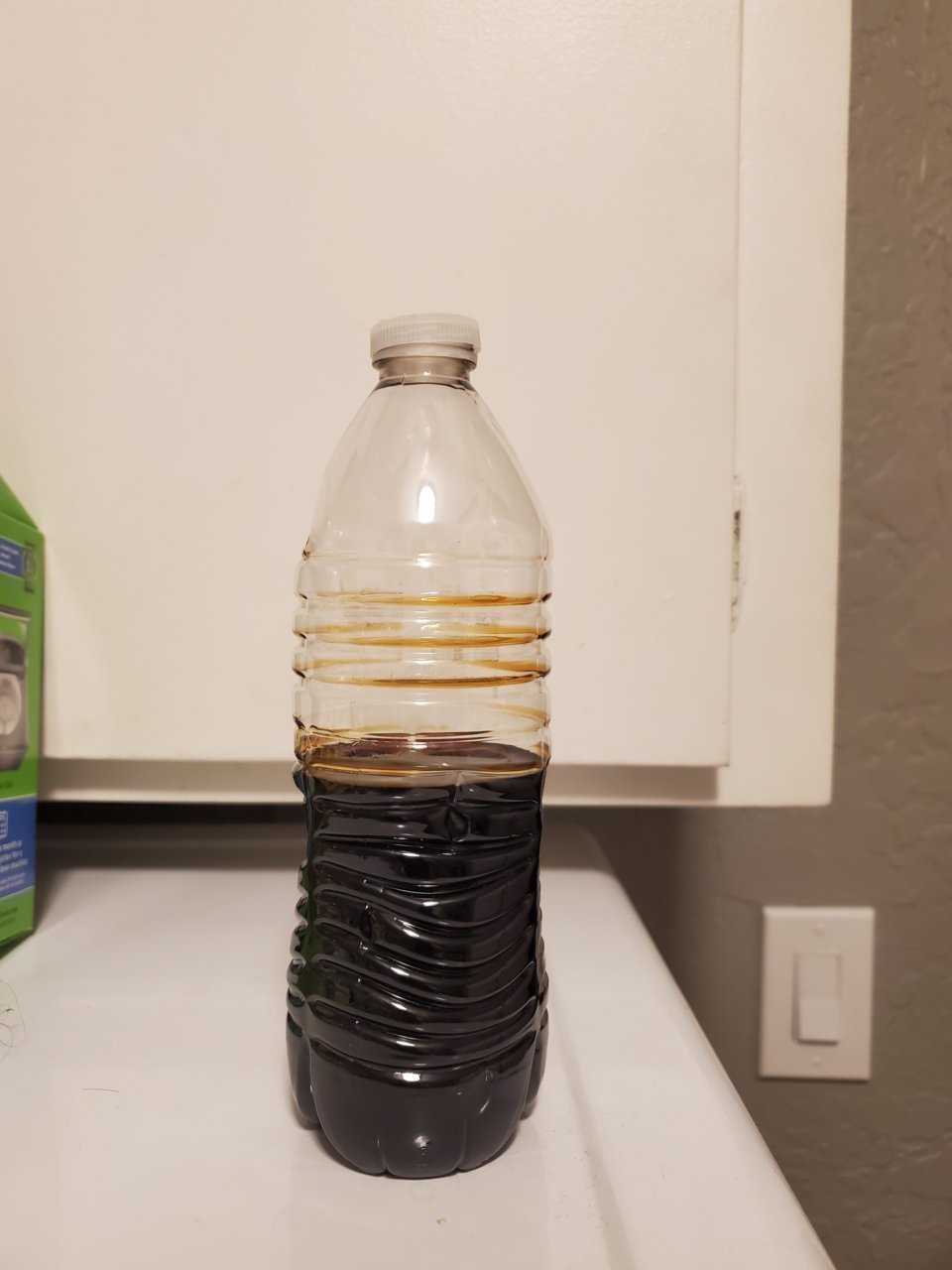

  18. Mar 21, 2022 at 12:59 PM
    #108
    AZTundra
    Feb 13, 2018
    #12894
    4,488
    Paul
    Phoenix, AZ

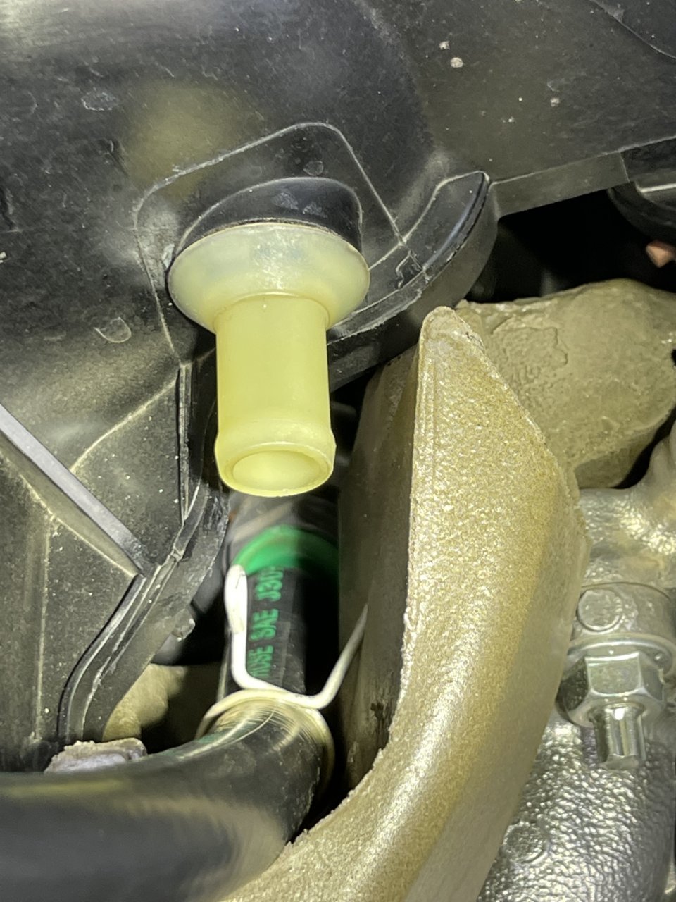

    Updated picture with my accumulation after 22K supercharged miles. This is all from the pcv can. The crankcase can is still empty.

  20. Mar 21, 2022 at 1:03 PM
    #110
    AZTundra
    Feb 13, 2018
    #12894
    4,488
    Paul
    Phoenix, AZ
    I'm not the OP, but above is what I collected in mine. I had the cans installed at the same time as the supercharger, so I'm not sure how much they collect on a normally aspirated 3UR.
