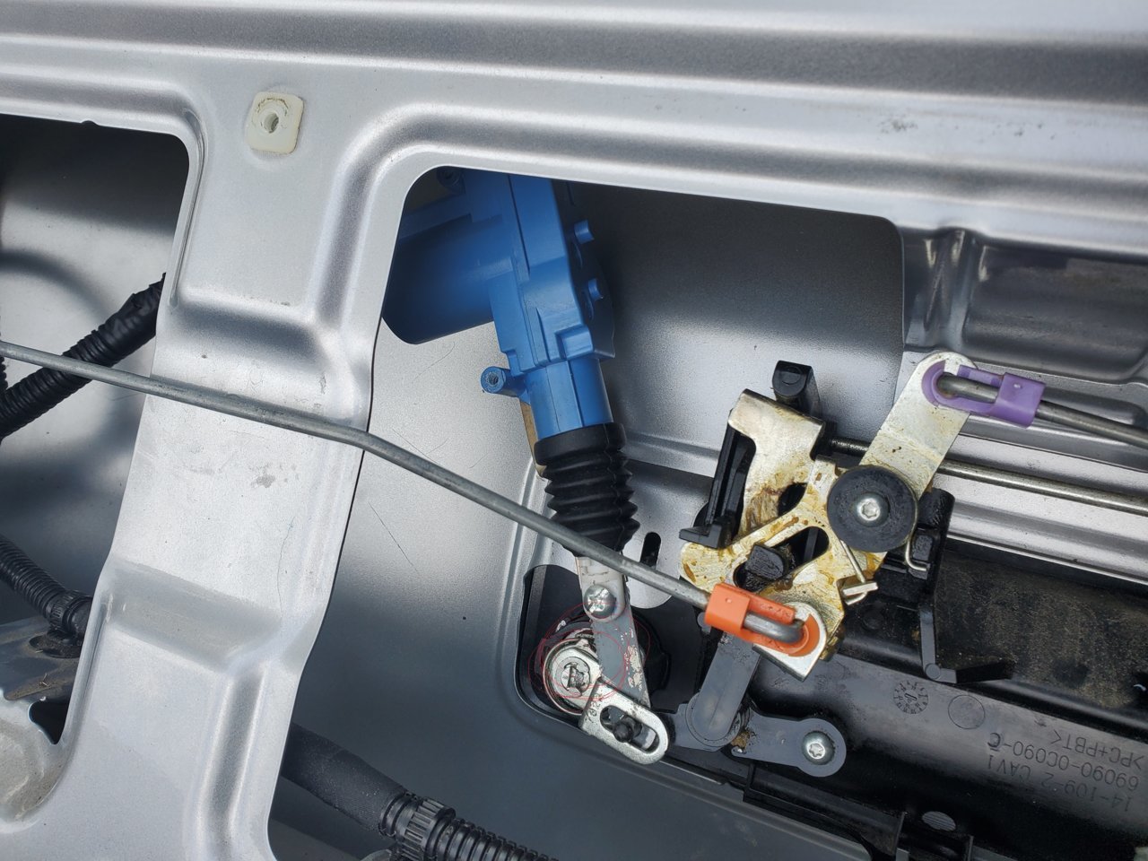

    Maybe because I'm OCD it took me 2 and a half hours start to finish. I did take about a 30 minute break (hot as hell today). I just kept looking for spare parts i could use to connect the actuator to the locking mechanism. Got it hooked up and am thankful this thread is here. Lots of neat tricks after the OP

    ^^Did you come up with an interesting way to hook up the actuator to the mechanism?

    I used some spare plumbing hanger I had and just used aviation snips and cut the sharp corners off. The big hole fit the mechanism perfectly. I put that piece I made under the lock piece as to secure it more than just sitting on top.

    ^^Great idea! I've got some somewhere in my garage...I bent my brass support piece so I'll give that option a go.

    Yea I bent it like a Z that someone else mentioned before. Made it easy adjusting it and tightening the 10mm bolt

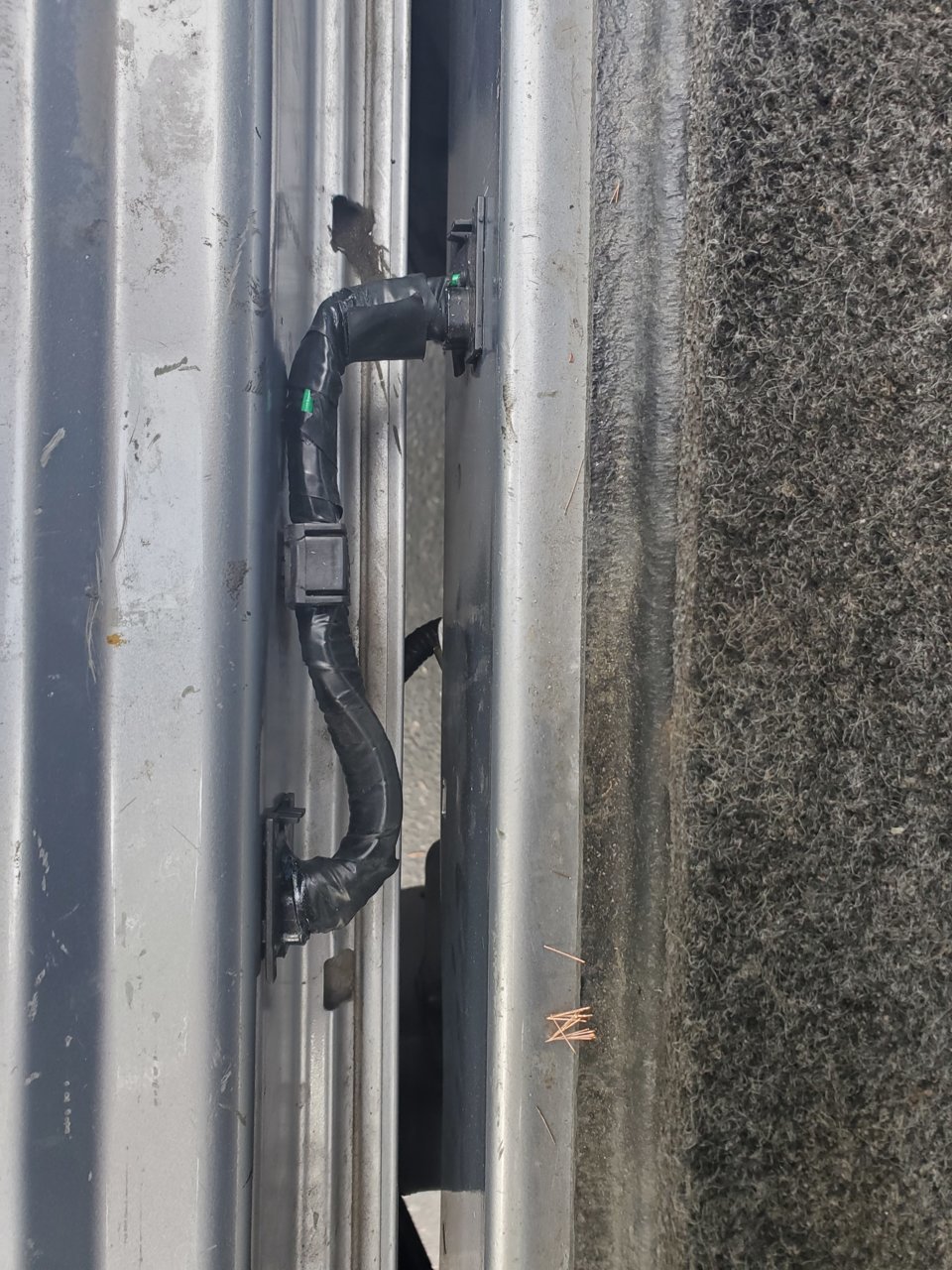

    Does anyone know what wires you would have to splice into on a 2020??...about to do this tomorrow on my 2020 Platinum and don’t wanna screw it up...haha...thanks!

    The key was extending that end piece with a thin piece of metal...
    It has been working flawlessly since I put it in.

    Anyone figure out the color wires for the 2020?

    I have a post from awhile back showing my 2020 install, let me see if I can find it for ya

    I just did this. It was super easy. I cut a piece off for a sink drain handle and used that for the extension. Works great. Glad I found this forum.

    how did you get the attached metal piece under the piece that moves the lock?

    there are a few small screws that remove that assembly and allow it to be lifted enough to add the metal piece in.
