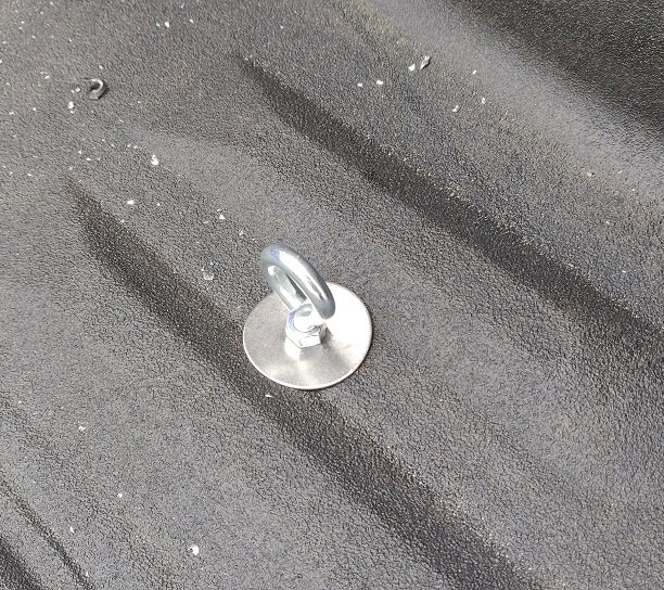

    For anyone looking for other ideas and is willing to drill a bunch of holes in your bed (I've drilled over 15 holes into the bed for several mods already), here is what I did..
    And some pictures of my tie down setup in use..
    Edit: The 6 eye-rings are removable in case I need to load something big and flat into the bed, by the way, as they thread in like a bolt to the permanently-mounted female end.

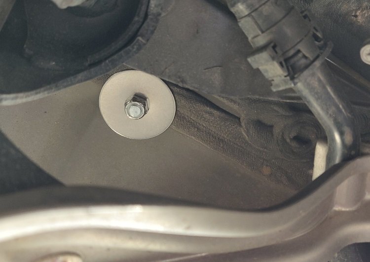

    Drill the holes before the spray liner and add some 1/8" or 1/4" aluminum plate underneath to distribute the load then you will be fine.

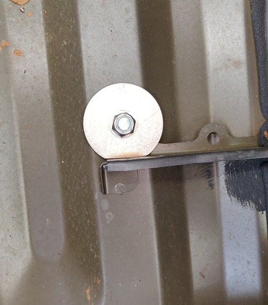

    I liked this idea, and didn't mine drilling holes, but wanted them off to the side a bit more.

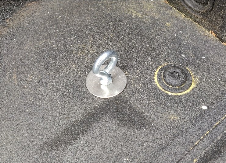

    Instead of notching the washer, I put the hook in between bolt and washer. Cleaner look
