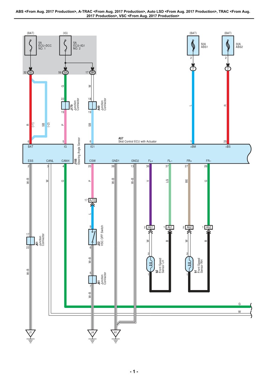

    pretty much all momentary switches I can think of are normally open - at least in the truck wiring diagrams.
    Full wiring diagram for the VSC system attached.

    Thanks, Casey! That helps. Funny, all the aftermarket switches I've found thus far are listed as normally closed. Go figure.
    If I'm interpreting the wiring diagram correctly, the Steering (Wheel?) Angle Sensor is on the same 5 amp fuse as the Skid Control ECU and VSC Off switch.

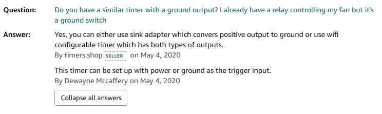

    Their Amazon answers say something about programming ground output with the WiFi programmer, but I'm not feeling warm and fuzzy that the Chinglish translator got the question right...

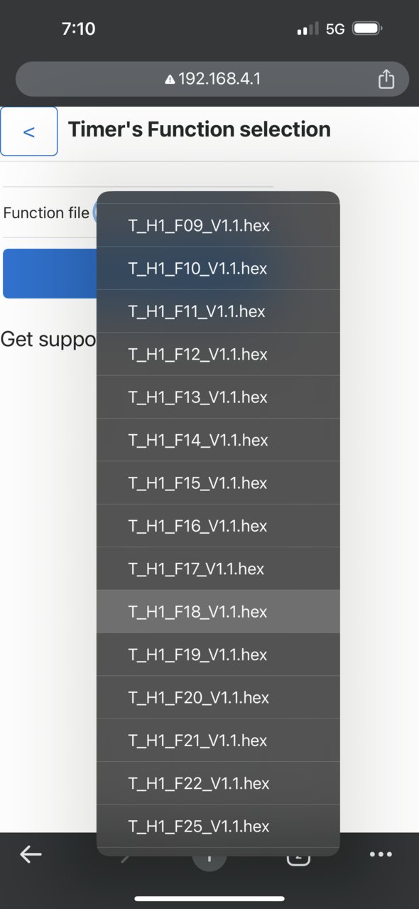

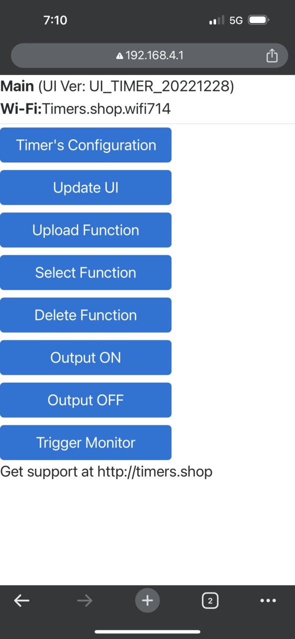

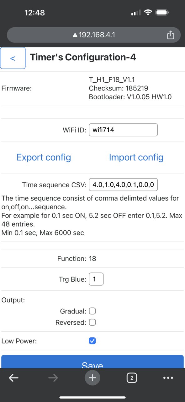

    Finished messing with the v8 timer - once you figure out a view of the gotchas with the programming software, it's not bad at all.
    First step, connect the 3 wires from the programmer to the corresponding wires on the timer:
    Connect it to a USB power source (also flip the switch on the module with the power out wires, if not already forward) and wait for the blue and red lights to light up. Now you can connect to the programmer via Wifi (something like Timers.shop.wifixxx). This part can be tricky, depending on the device used, so make sure you disable auto-join for other home networks temporarily while you're doing this process.
    Once connected, open a web browser and go to http://192.168.4.1
    For this use case, we need to select a different function than what comes in the default config. Select "Select Function" and pick T_H1_F18_V1.1 (versions could change, F18 is the important part):
    Once the function has been successfully updated, go back to the main page and select "Timer's Configuration". Two sections will be updated, the Time Sequence and Trg Blue. The Time Sequence is as follows: 4.0,1.0,4.0,0.1 Change the Trg Blue value to 1:
    Save the configuration, and once completed you can remove the programming leads and bench test as outlined in the rest of the guide.
    https://youtu.be/GEgF4BDsZ7U

    No sink output on the 5A one btw. I think the reviewer on Amazon was talking about "reverse output" that would make the output always active except when the timer is active. Keep us posted on the 10A version when you get it.
