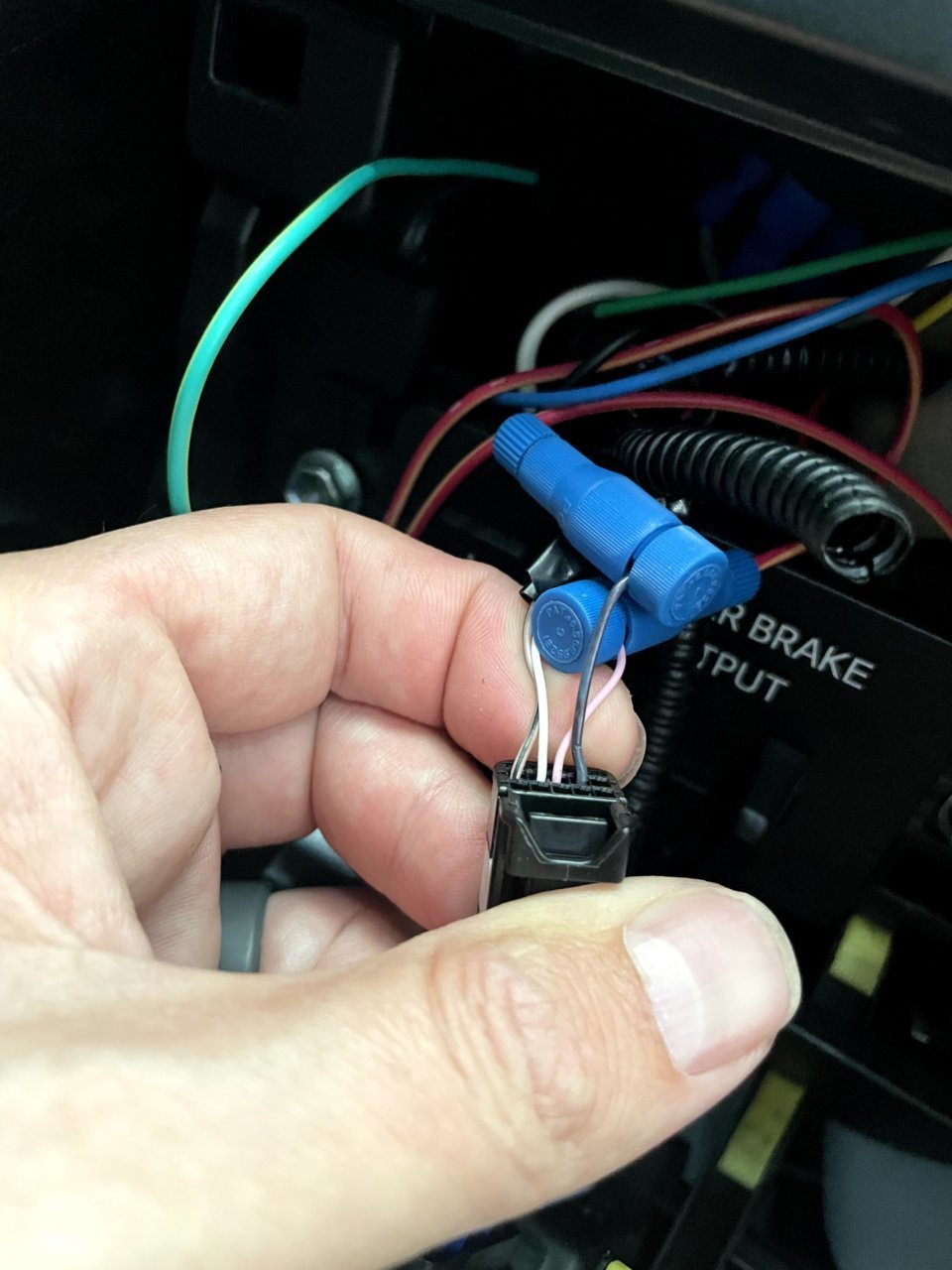

    TDRFerg,
    In these two pis, the top pic hoes to bered wires.
    Are these the two you connected to the wires of the VSR switch in an earlier pic?
    Is so, why is there only one connected to the VSR pic in this quoted bottom pic?
    Thanks
    Clif

    That was an in-progress pic. If you read through the 1st post it’ll give you all the info you need, but here’s the relevant pic of both wires tapped.

    That's what I suspected. I just wanted to make sure.
