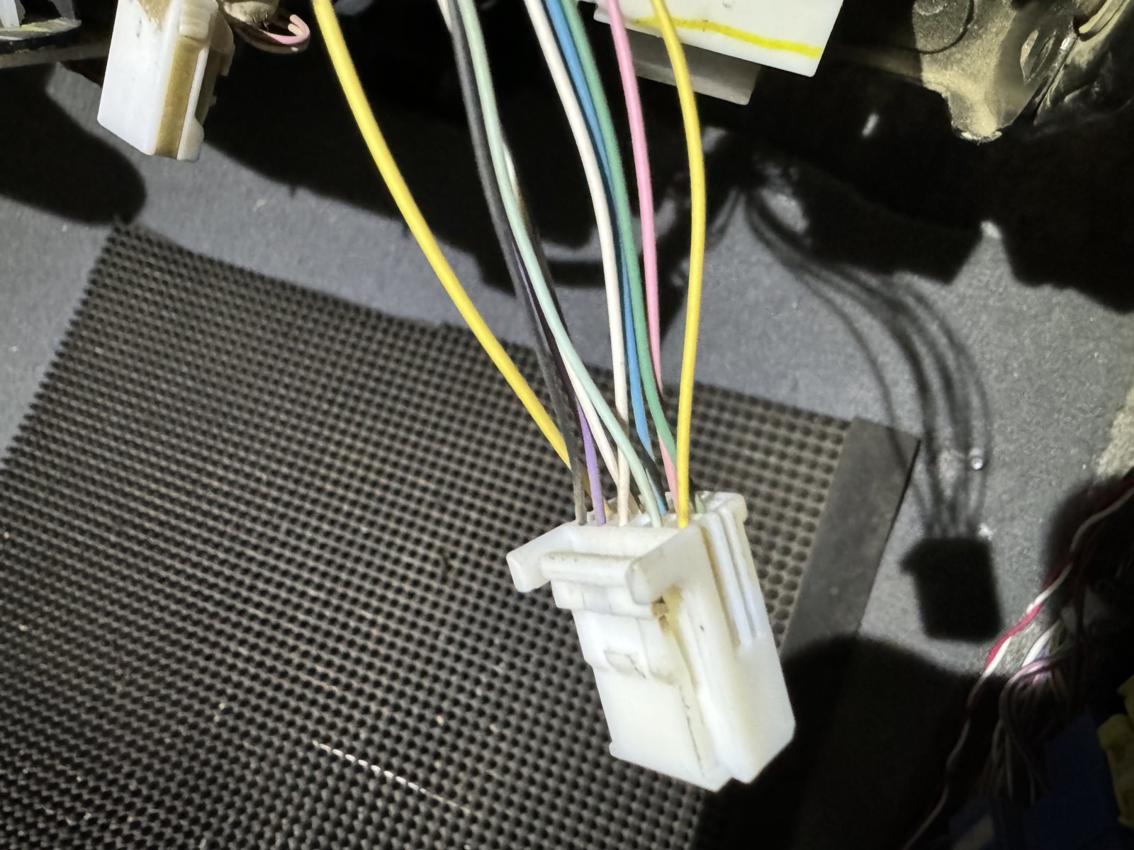

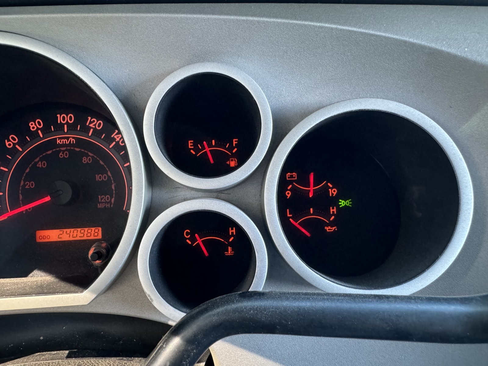

    So thanks to you all for the pics and descriptions. My truck is 2007 SR5 RCLB 4.7 with tow package. My sensors were corroded garbage when I bought the truck. I removed them all when I put on new Coopers AT3’s. My wiring is identical to the one posted above. I cut the light lime green and yellow. Jumpered the green into the yellow from the truck side. Leaving the green cut off going into the plug. Lights gone. Took the Autel meter and cleared the TPMS code. All good. No flat tire light. IMG_0845.jpg IMG_0850.jpg

    Awesome !!! Glad it worked out for you.
