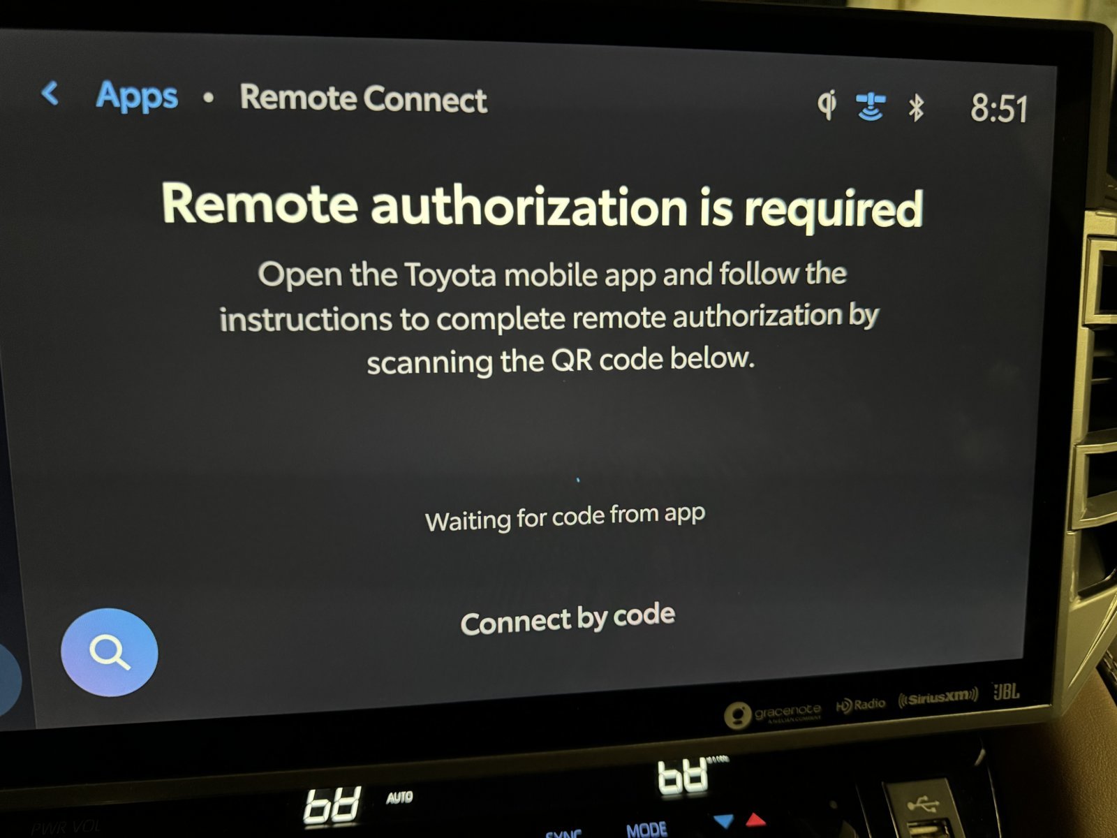

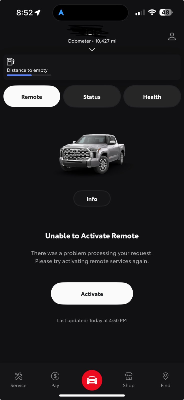

    I just had this happen for the first time today. I opened the app and it says "Unable to Activate Remote" (see pic below).
    I tried to "Activate" the service following the instructions and it just sits on the "Waiting for code from app" screen. I also tried to activate using a Code with the same results.

    I had a similar issue with my Sequoia. I could not get the app to activate after my trial period was over and also could not get the QR code to show up, like you mentioned.
    I was able to resolve it by calling Toyota ( https://www.toyota.com/support/contact-us/ ) at this number: 1-800-331-4331
    At the automated prompt I told them I needed help with connected services. The person they transferred me to was able to get it to connect. Interestingly, he did have me push the SOS button, say “No” to needing emergency help and then say that I needed help with enrollment or connected services, I don’t remember exactly, but it was obvious from the list of choices. When I pushed the SOS button it of course disconnected me from the phone call with the Toyota help center, but he called me back to make sure it was resolved.

    Reset the radio and it will give you the code to repair to your app.

    Resetting worked, thank you! It took about 15 minutes total, including fixing my custom vehicle settings, etc.
