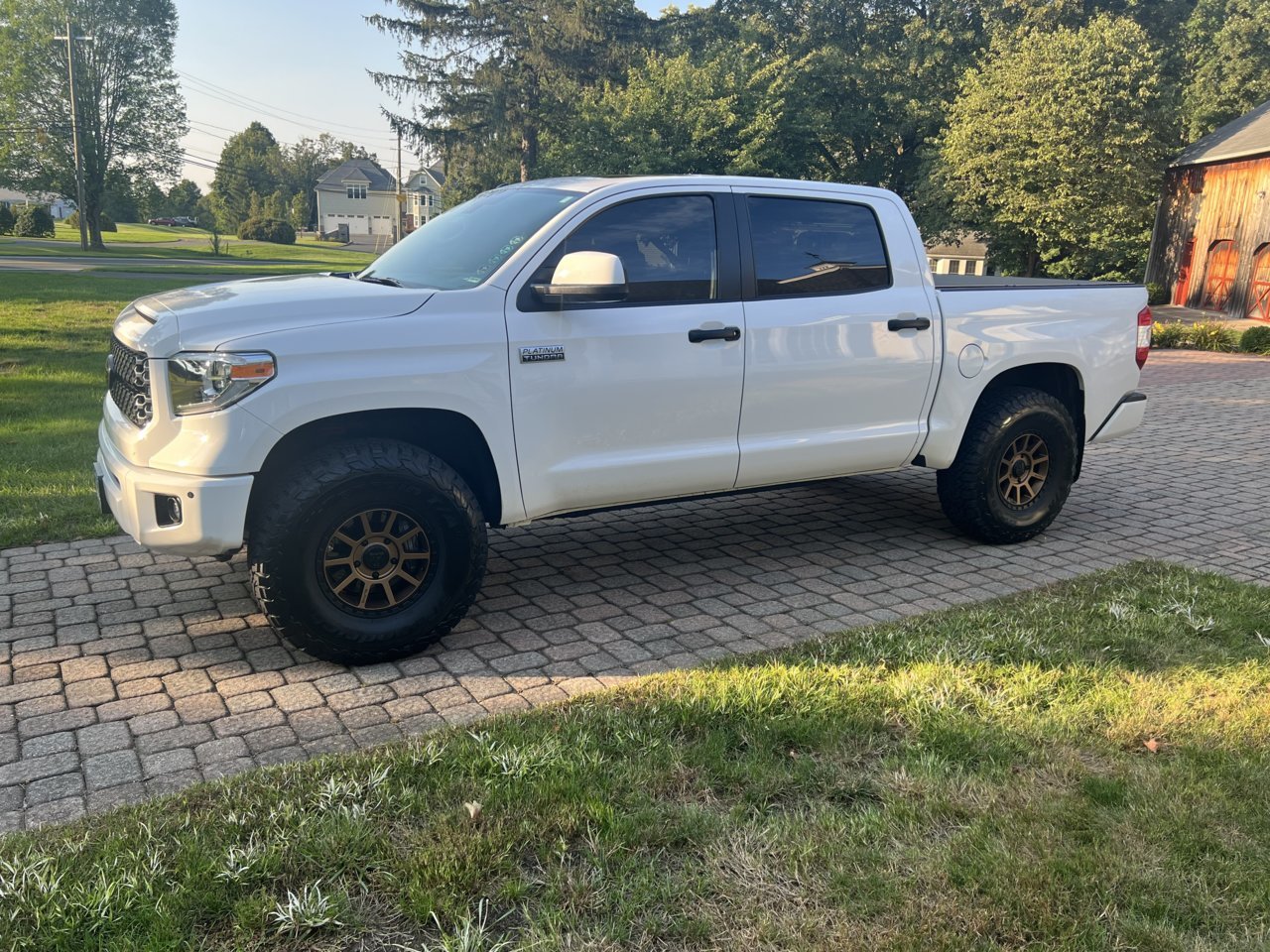

    Sorry I can’t attest to the stock front bumper, but I have found 35mm offset is the best at clearing body mount and able to have a 12.5 width without rubbing on the UCAs.

    I have the +35's. I already had the BMC so no problem with clearance there. The front of the fender was spaced with Coach builder spacer plus my mechanic was able to push it back another inch + by removing the bolts and re drilling them. Looks factory under there and clears the 37"s with the +35 offset. If you follow the line of the fender well you can see how the bumper spacer moved the front bumper slightly forward.

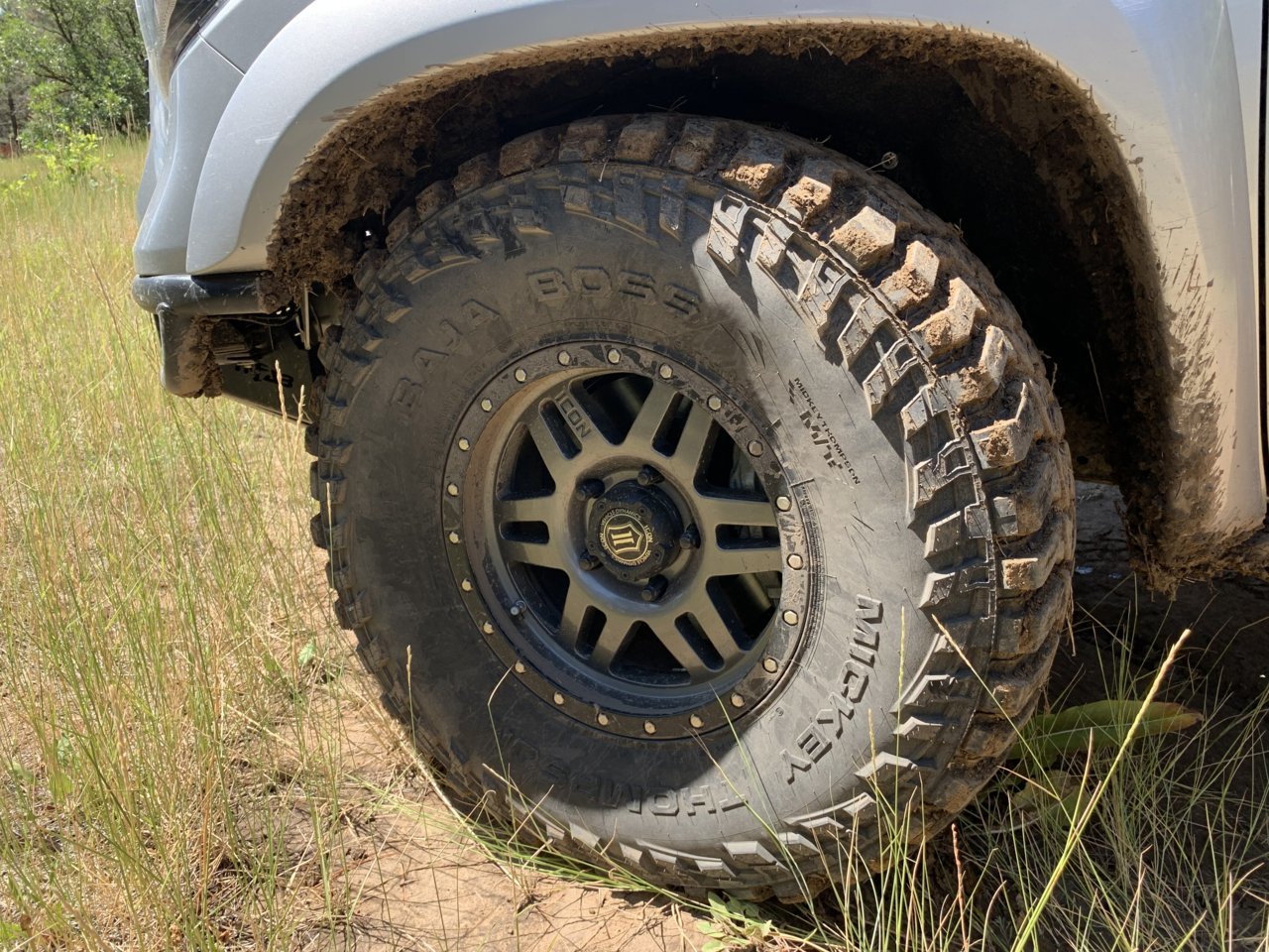

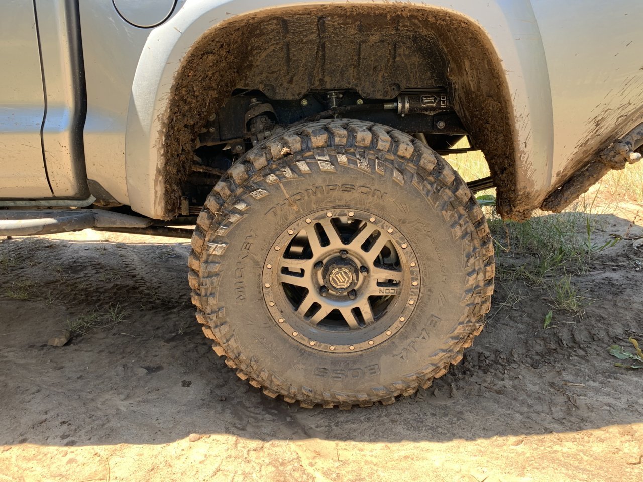

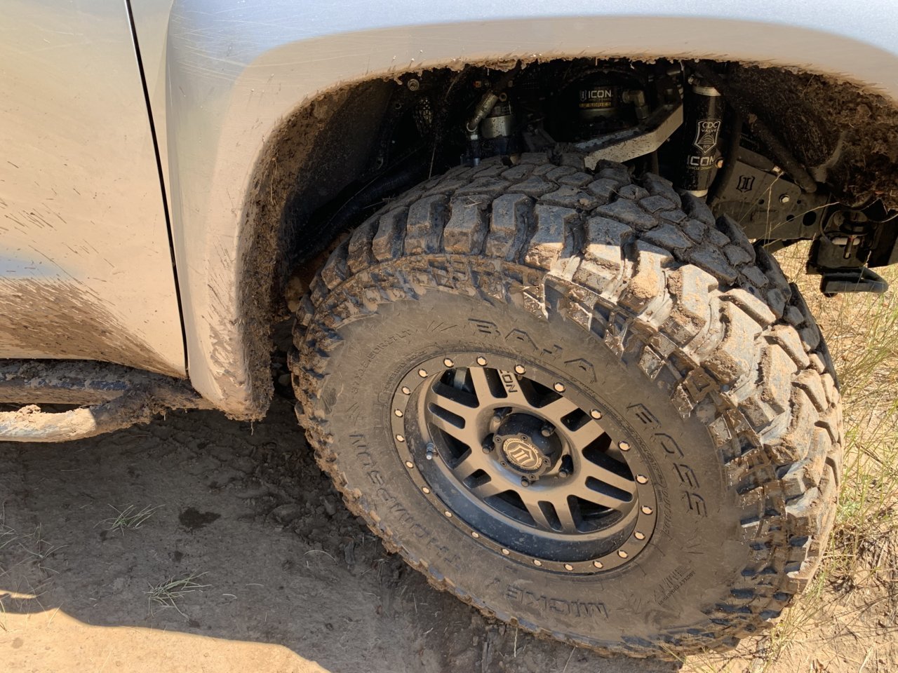

    Mickey Thompson Baja Boss MT’s are 36.8”

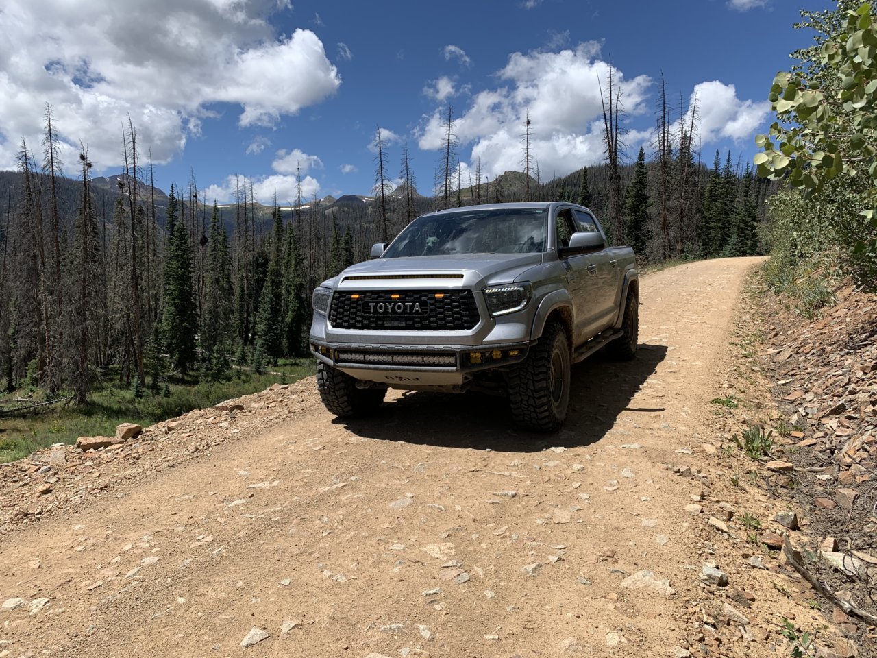

    A full shot of the side while in Colorado
