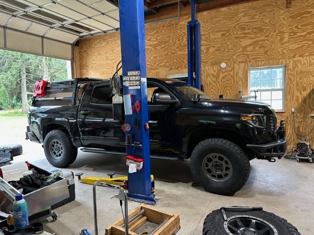

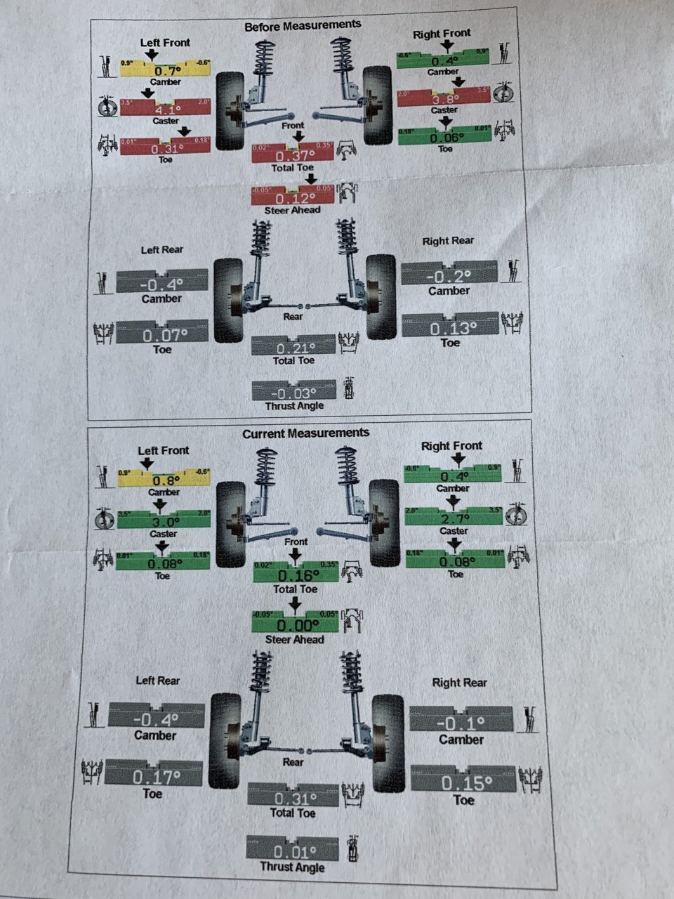

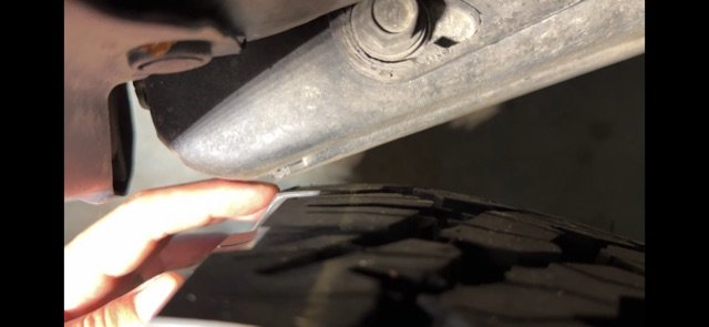

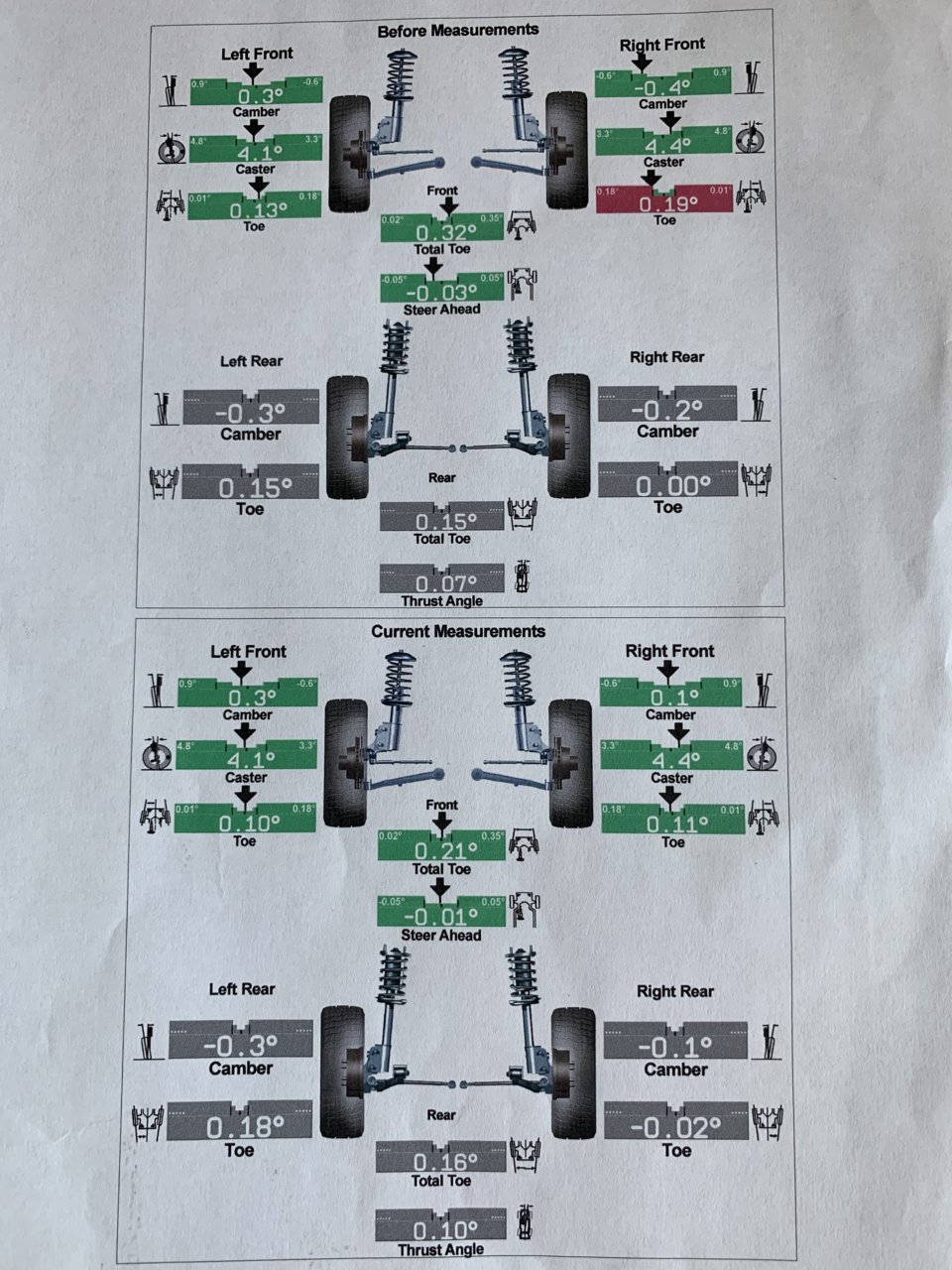

    I am trying to figure out how my truck went from being aligned with no issues on April 26th and then last Friday July 8th I have maxed out camber. He said it should be ok the way it is. OK? These tires are freaking expensive and the last thing I want is to wear the tires unnecessarily.
    This first pic is from the alignment in April when I took my 35’s for their last ride
    This is from last Friday after the 37’s were mounted the day before
    Any help would be appreciated, I do not know where I should be with the 37’s. After the first alignment I drove around 35,000 miles with all on road driving and never Offroad.
    Thanks in advance

    Hit any big pot holes? Or they didn’t fully torque the cam bolts and they moved?

    Which UCAs?

    2018 Tundra Platinum with Icon Stage 9 w/3.0 and billet UCA, Harrop Elockers, 5.29 on 37’s
    Icon Billet DJ kit

    I think you need to be more explicit to the guy on the alignment rack on your target numbers. Seems to me the tech was chasing OE spec numbers...Who performed the alignment?

    On April 26th when I got the alignment and there were no issues (first alignment sheet) I got my alignment, drove home and packed my truck for a long drive across the country and I did not look at the cams when I got home. When I came home after the trip and weeks later I started trimming for the 37's that I was planning on buying and while under my truck I seent the cams on the LCA's had a yellow mark that all of them were pretty far off except one that was slightly off. I have no idea what color the alignment tech used for his marking or if he even marked them (assume they would for return purposes) and I was going to call today but that was so long ago I don't think it is worth the effort.
    When I got the alignment last week I would have assumed if they were loose they would have told me and they said nothing about that.

    Did you hear any clunking when turning hard?
    It used to clunk on my old truck until I tightened the cam bolts.

    If I knew what numbers to ask for that would help. I posted up in this forum looking for 37 alignment numbers and got a few. I asked on here for someone in the area that knows what they are doing and got a recommendation of a guy named Sarge (his last name is actually Masters so it took me a while to find him) and I found him at Big O Tire on 7th st and Camelback. When I talked to him the first question I asked was if he was fluent with adjustable UCA's in particular the Icon Billet DJ's and he said of course, that is why everyone comes to me. Well afterwards when I got home I seen the aligner was not him it was another person. I called and left a message on Monday for him to call me and no return call.
    I will be visiting them tomorrow unannounced. The guy I talked to was the Assistant Manager not the Manager so I am going to looking for him and see if we can resolve this issue.
