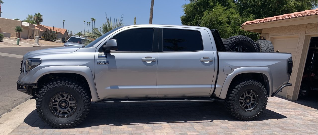

    Done, I have an alignment scheduled for 8:00am tomorrow. No rubbing but close to the edge of the fender flare. I can easily trim it but waiting for the alignment to get done tomorrow. For some reason the tire on the drivers side is closer to the rear of the wheel well and the passenger is nowhere near that close. Explains the weird freaking ride for 3.5k miles on vacation.

  26. Jul 10, 2023 at 7:20 PM
    #2846
    COTundra23
    COTundra23 New Member
    Aug 14, 2019
    #34617
    1,018
    looks great! Looks like it clears the BM without a chop?
    SAGE63 likes this.
  27. Jul 10, 2023 at 7:55 PM
    #2847
    CaptRussia253
    CaptRussia253 New Member
    May 15, 2022
    #78415
    1,260
    Ruslan
    Impressed it clears the body mount. Does it run on the sway bar at full lock?
  28. Jul 11, 2023 at 6:02 AM
    #2848
    king.cong.1119
    king.cong.1119 New Member
    Oct 29, 2020
    #54229
    831
    The driver side was a tad closer than the passenger side to the body mount, I guess I am going to see if it rubs during full articulation of the suspension. But normal driving it is completely rub-less (if thats even a word)
  29. Jul 11, 2023 at 6:03 AM
    #2849
    king.cong.1119
    Oct 29, 2020
    #54229
    831
    Surprisingly its very far away from the sway bar.
    CaptRussia253 likes this.
