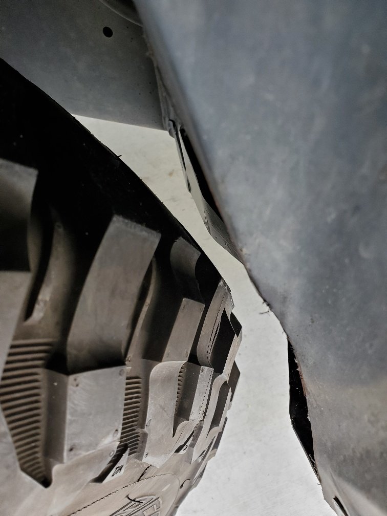

    I did mine since I went to 37's. A simple mod.

    I chopped the body mounts and trimmed the mudflaps for clearance.

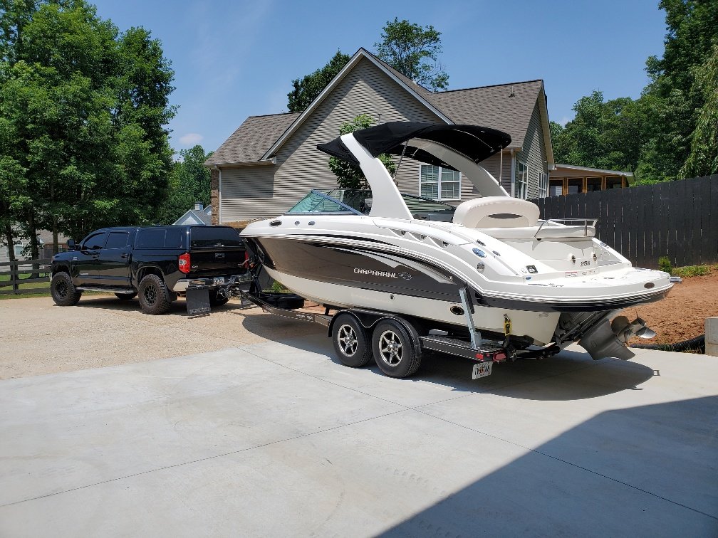

    I'm not a fan of mudflaps at all but they are needed when towing shiney things behind the truck. :D
    I had to add hitch-mounted Rock Tamer mudflaps to mine for towing. There are numerous rock chips in the gelcoat of my boat from a previous owner.

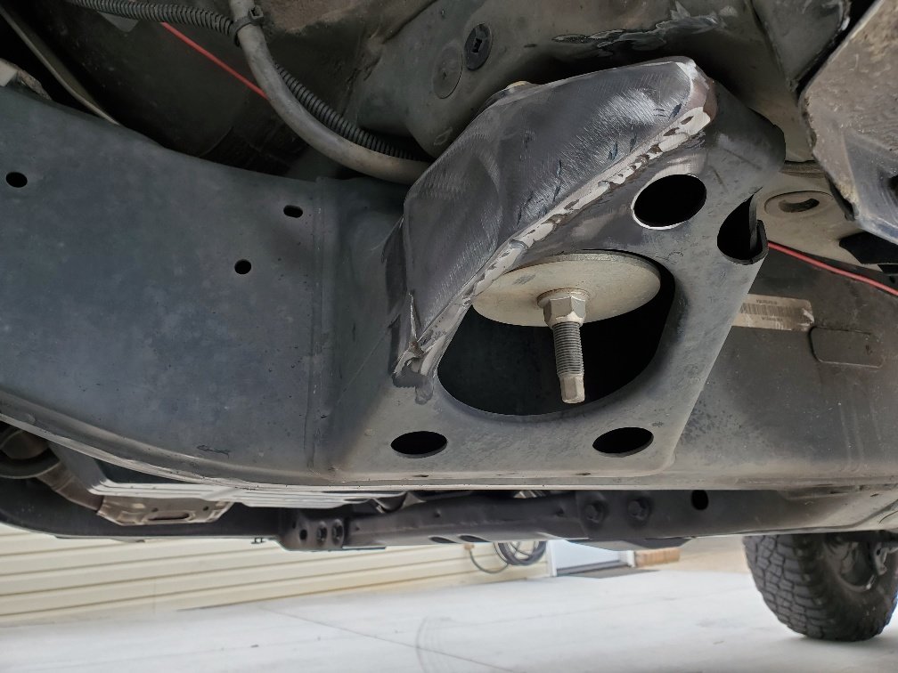

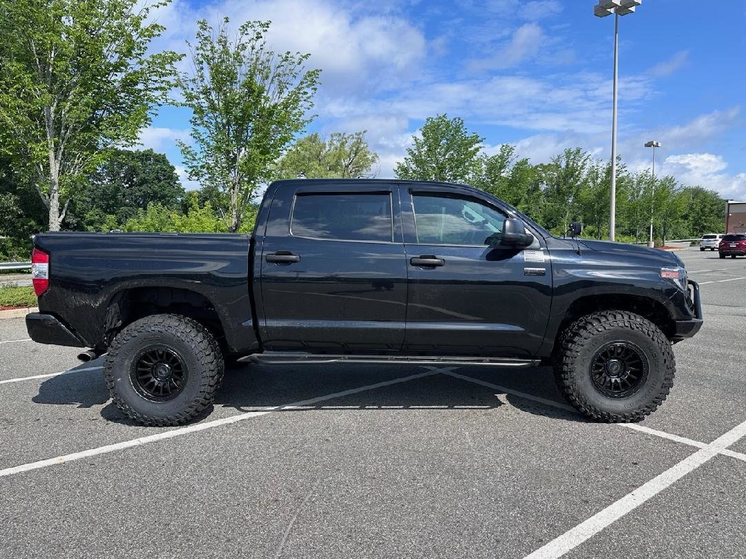

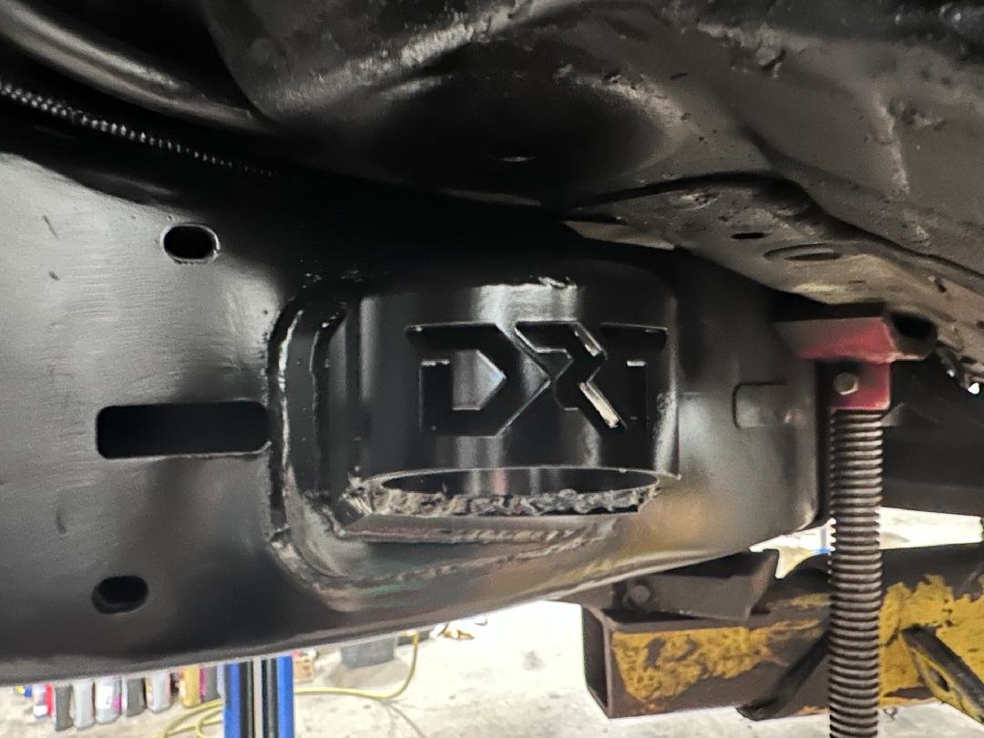

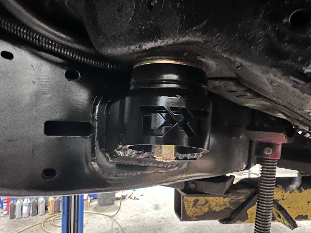

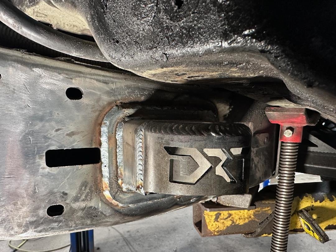

    Finally Join the Club
    Did the DRT CMR as well
    IMG_20230629_182532_01.jpg IMG_20230629_182535_01.jpg IMG_20230629_182538_01.jpg IMG_20230629_182601_01.jpg

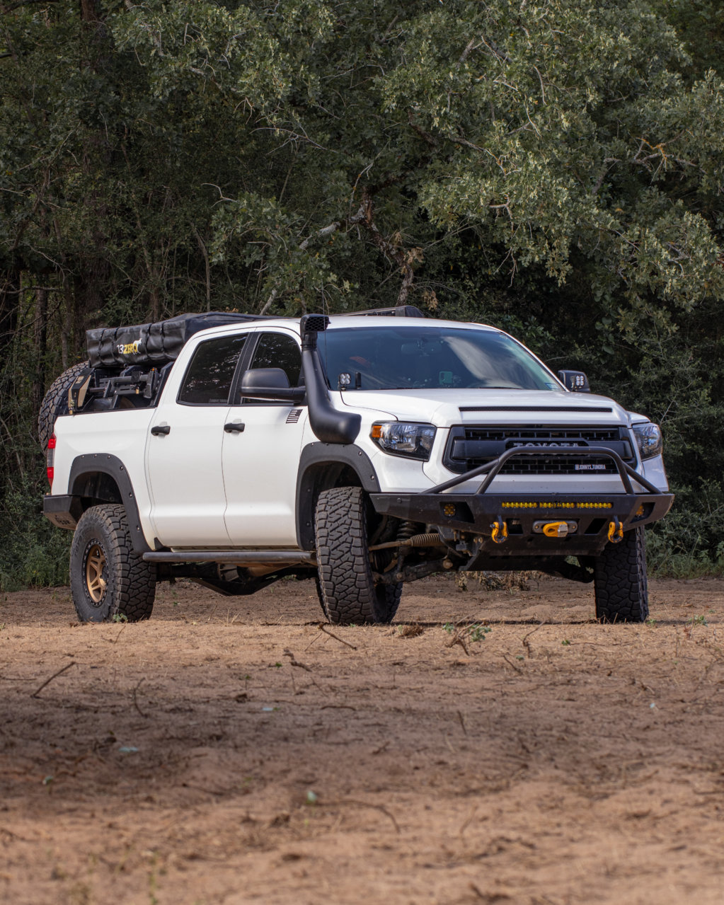

    New set of 37x12.5 RT Trails

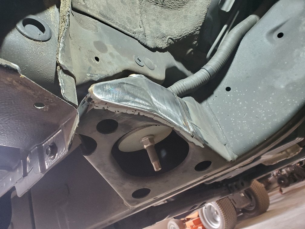

    Yep, a day after the 37's went on. They were OK when driving in a straight line... but rubbed when turning and I needed more room for the front end to be properly aligned.

    I had my alignment done at a local offroad shop. (Southern Offroad Specialties) They couldn't get much positive caster without messing up the camber... so I told them just get camber and toe set so it doesn't eat tires. Camber is at 0.0 and Caster ended up at around .8-1.0 degrees. It steers and drives just fine so I'm not too worried about it. I have upper arms for it but haven't gotten around to slapping them on yet.
    The cab mount chop was really not as big of a deal as it would seem. Just a quick surgical cut, a little grinding and fitting then weld it up.
    I hammered the pinch weld over and sprayed black engine enamel on everything. Worked like a charm.

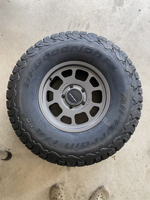

    So my 37s (36s actually) on +35mm are in. Will they fit without bmc? We will find out in the next week.
