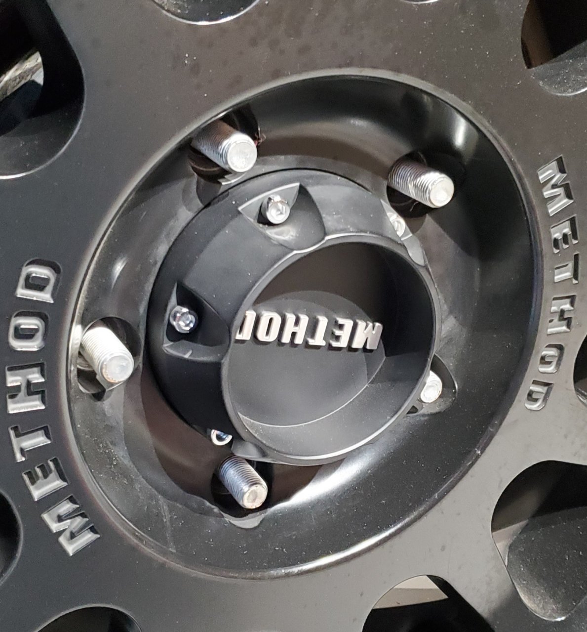

    Longer wheel studs are also a smart upgrade...

    for the stock length wheel stud, which lug nuts are you using? I am trying to see if the ones I have now to fit ICON wheels would work for the method 705 wheels.

    The stock studs required extended lug nuts. I dont have a part number or link handy at the moment.
    The longer studs allowed me to go back to a standard lug nut.

    Definitely agree on the longer studs
