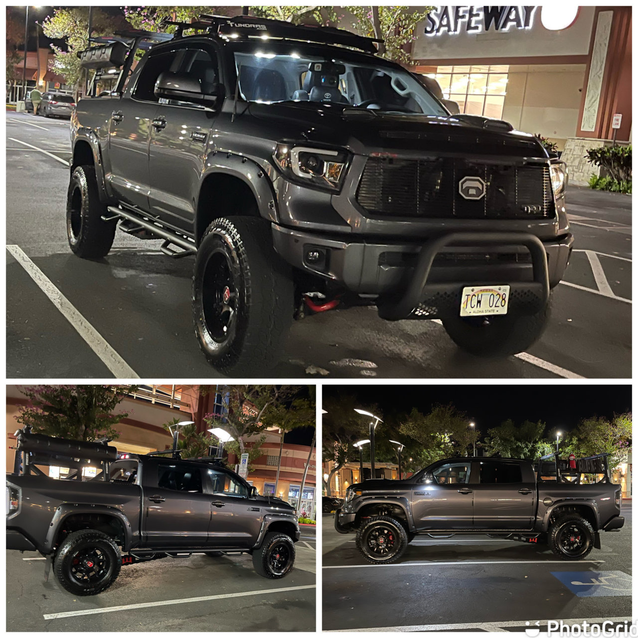

    37’s at midnight

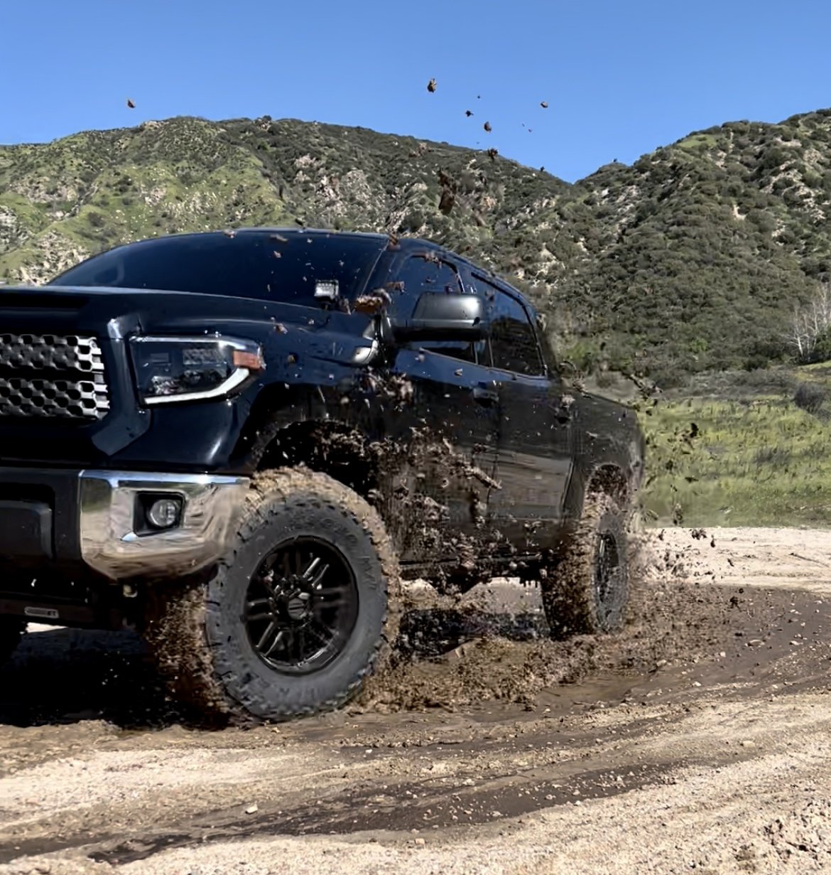

    - Carven Type R Exhaust - TRD LED Headlights - (2) LED Ditch Lights Mounted on Hood - Cali Raised Ditch Light Brackets - (2) 42” LED Light Bars Behind Grill - Cali Raised Hidden Grille Mounting Brackets - AJT Interior Chrome Delete - AJT V3 Shift Knob - 8" ReadyLift w/ Bilstein 5100's (all around) - 18" Raceline 948B Split Wheels - Toyo Open Country MT 37 x 13.50 R18 - Amp Research Power Steps

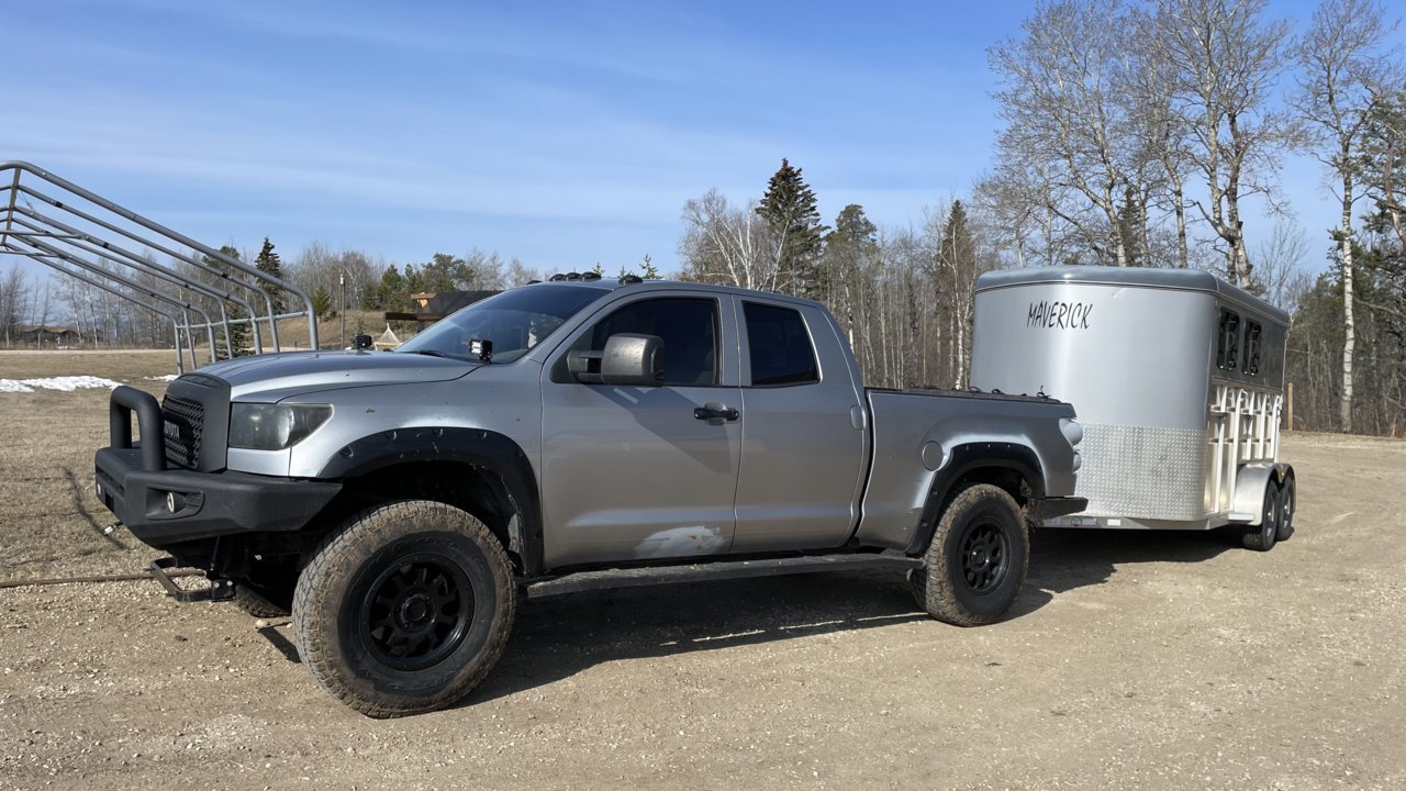

    It’s a Goat.
    37’s covered in horse shit :p

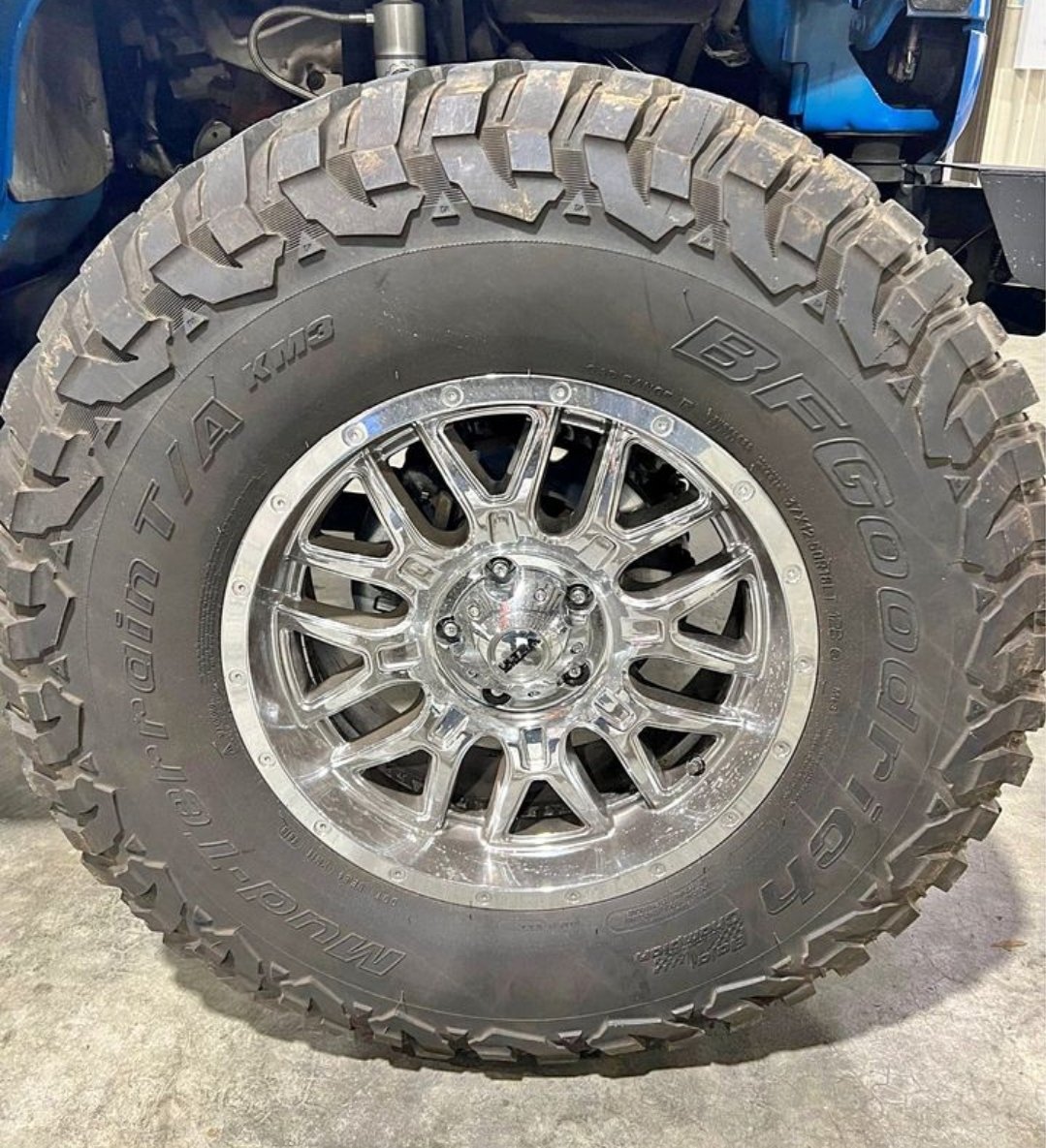

    Found a set of used 37x12.5-18" BFG M/T KM3's locally and will have them on later this afternoon. Finally joining the club... even though they are only 36.5" tires. lol

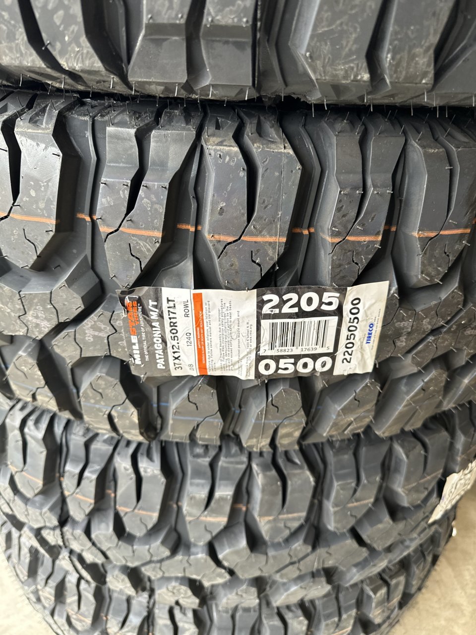

    Thanks for talking shit about my 35s. You’re a bad influence @reywcms :rofl:
    $800 brand new offerup deal!!!

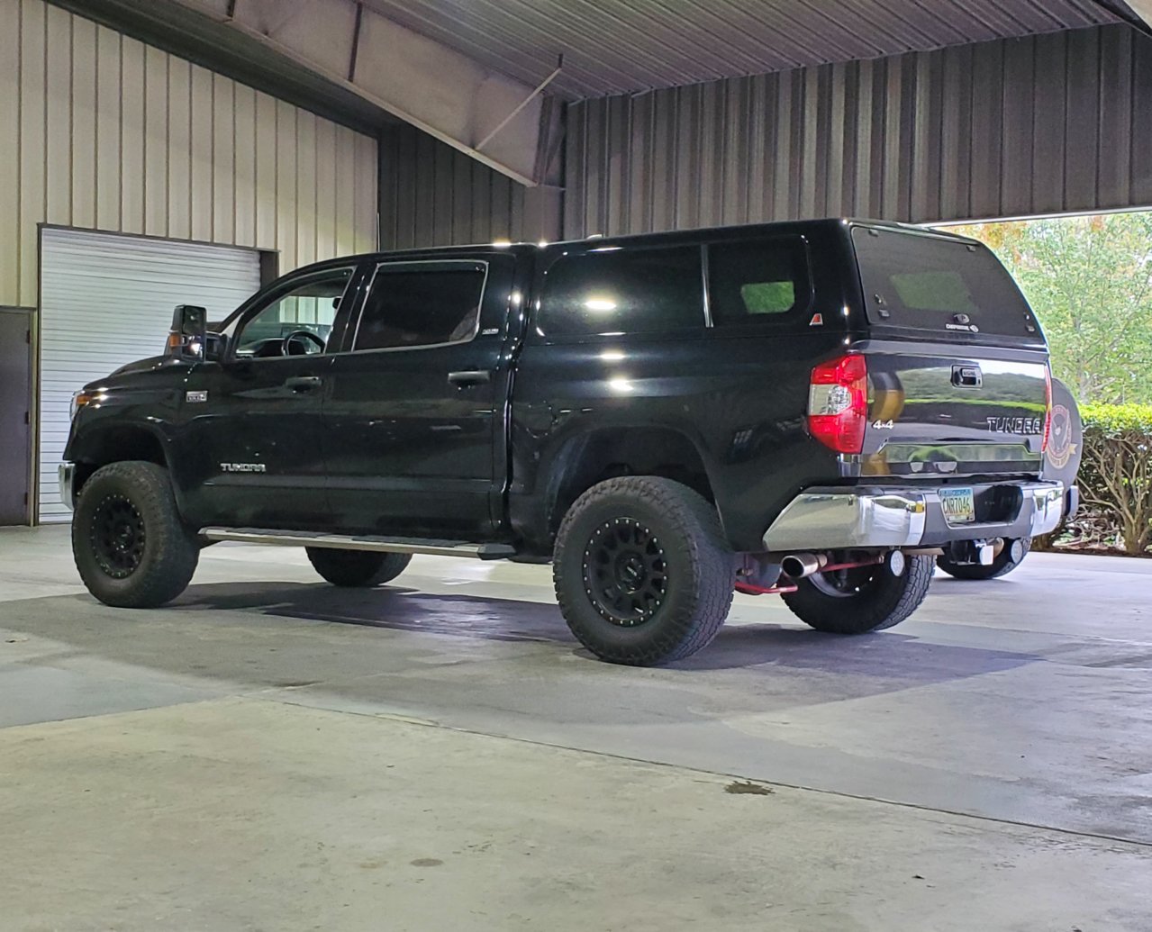

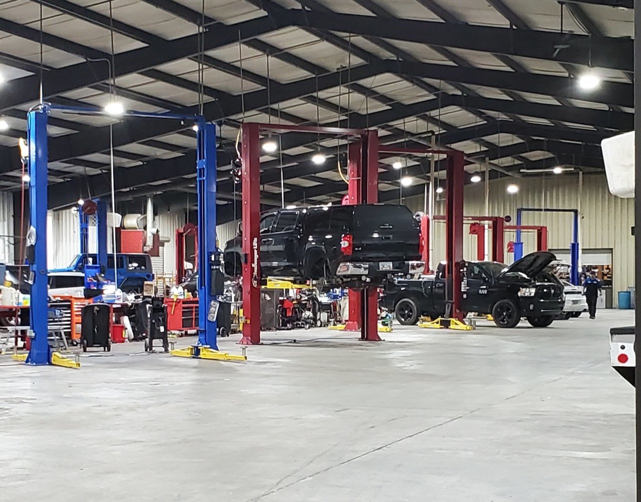

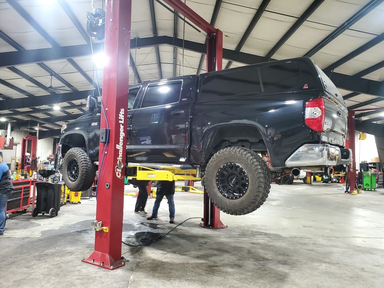

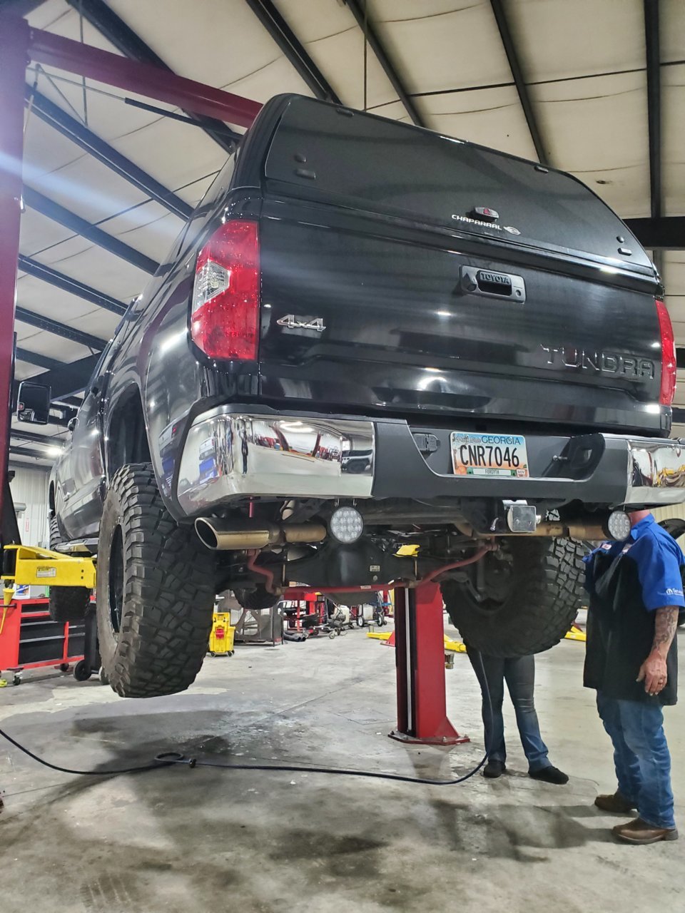

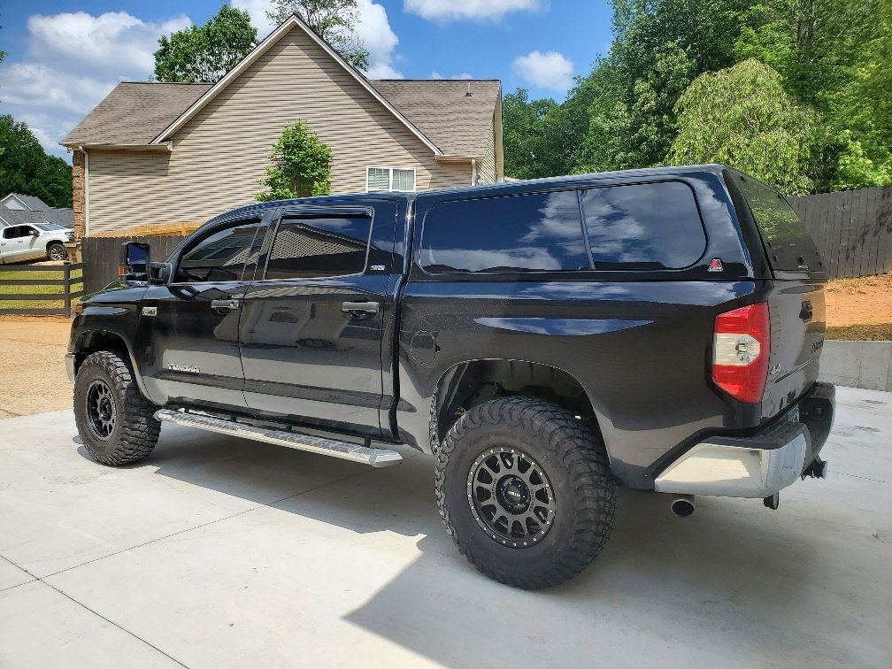

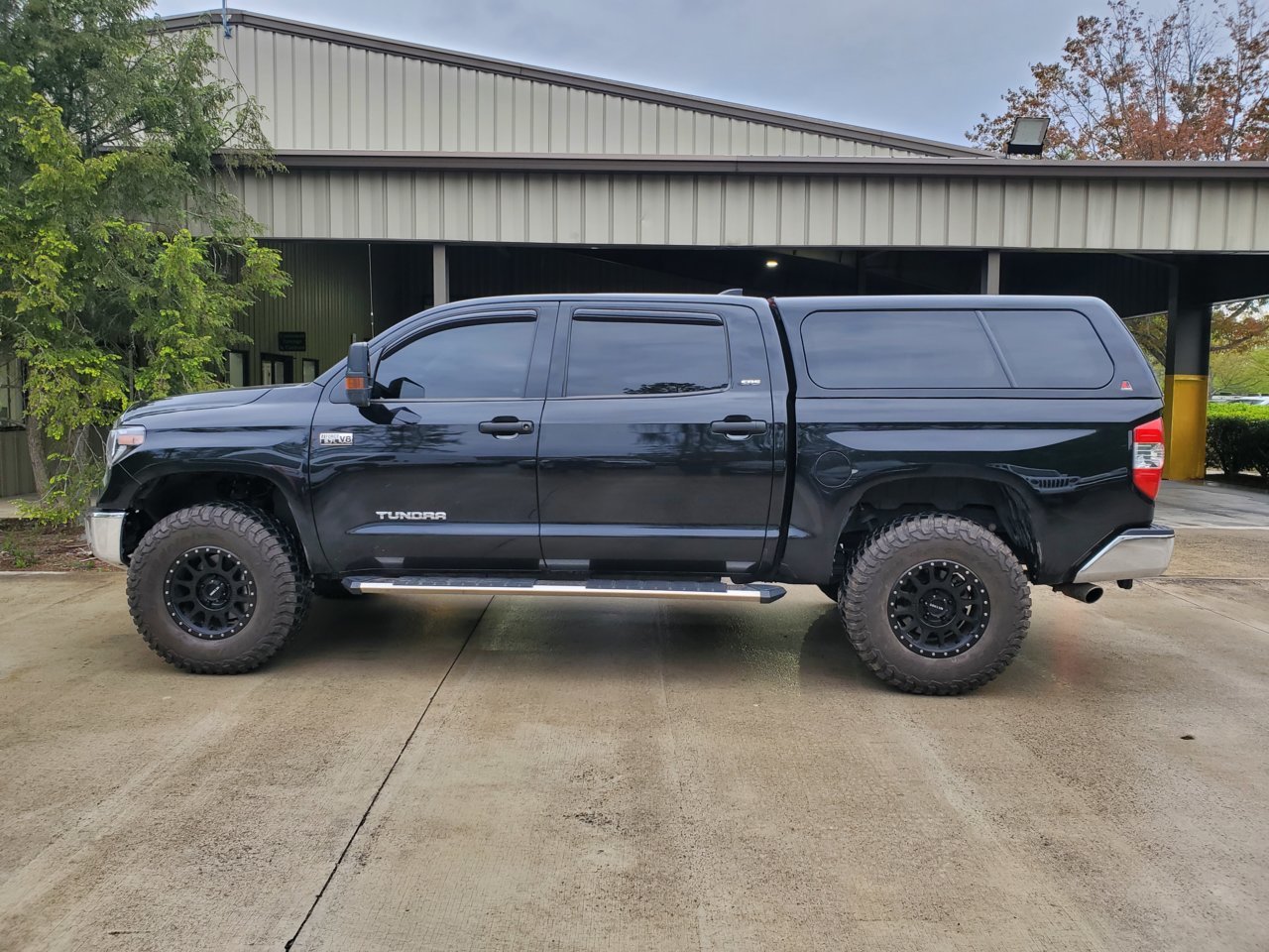

  16. May 5, 2023 at 5:13 PM
    #2596
    CaptRussia253
    CaptRussia253 New Member
    May 15, 2022
    #78415
    1,260
    Ruslan
    Looks awesome. Can’t wait to officially join the club.

    I like it! :thumbsup: Hopefully this fall I can join the club.

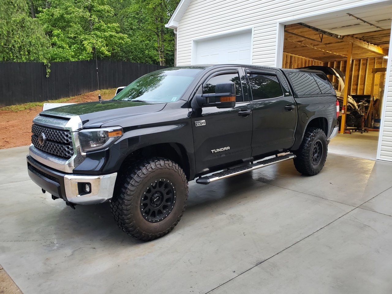

    751
    Dawsonville, GA
    2020 Crewmax 4x4
    5100's/+2.5" Eibachs, 18x9 +25 Methods,37x12.5 BFG KM3's

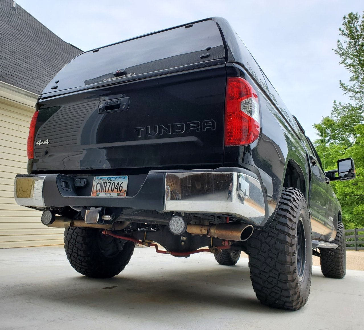

    These cant be true 37" tires... as they should be rubbing more than they do.
    They both barely touch the plastic near the cab mount. Drove it 45minutes home and didnt hear them touch at all. Only near full lock backing into the driveway and the knobbys just barely kiss the plastic.
    Absolutely love these tires.

    BFG says they're 36.5". I agree that they're great tires. Considering they're one of the lightest tires available, they've held up really well against Baja and other desert terrain.

    I was also surprised that they didnt feel any more lazy than the 35" Nittos I took off. Speedo is a solid 5mph off now though.
    The true test is when the boat gets hooked to it.

    they only have less than 500 miles, but i’m thinking of going down a rim size: 18/10/-24 or 18/9/-12 and still keeping 37/13.5/18

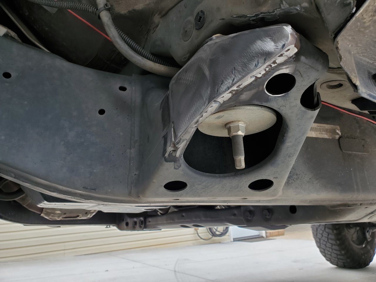

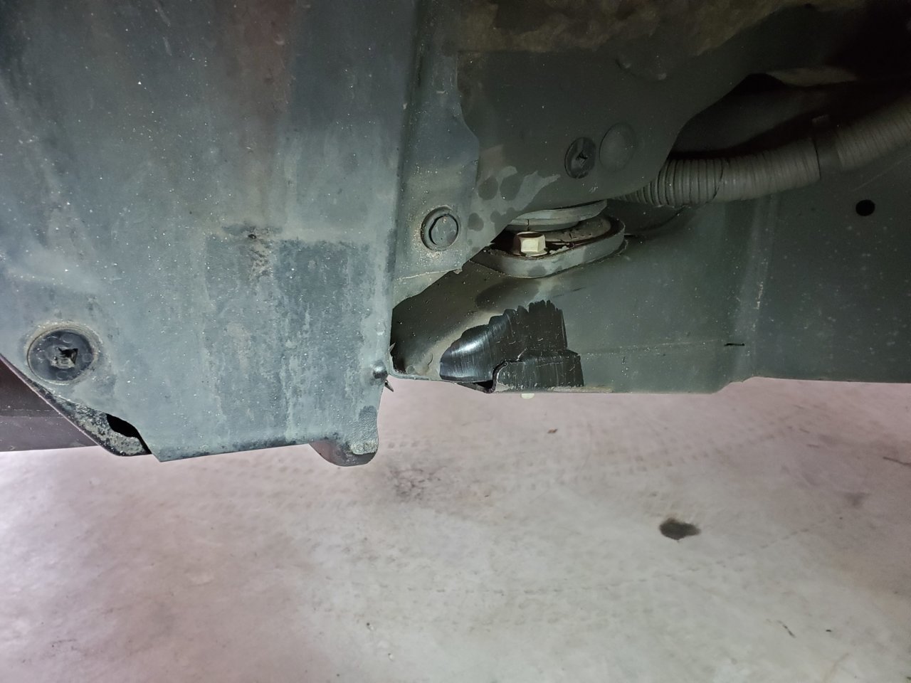

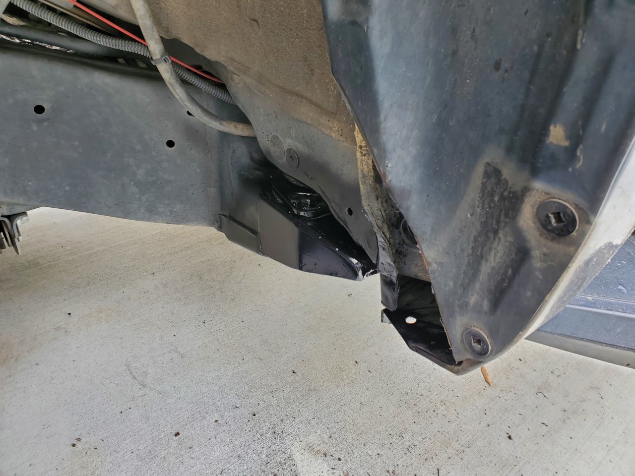

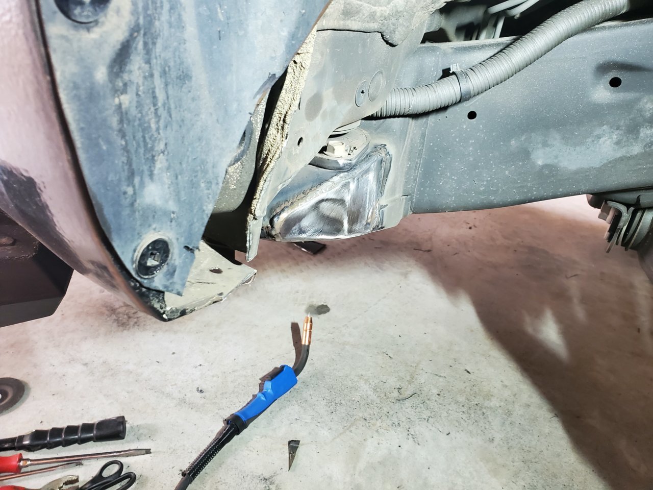

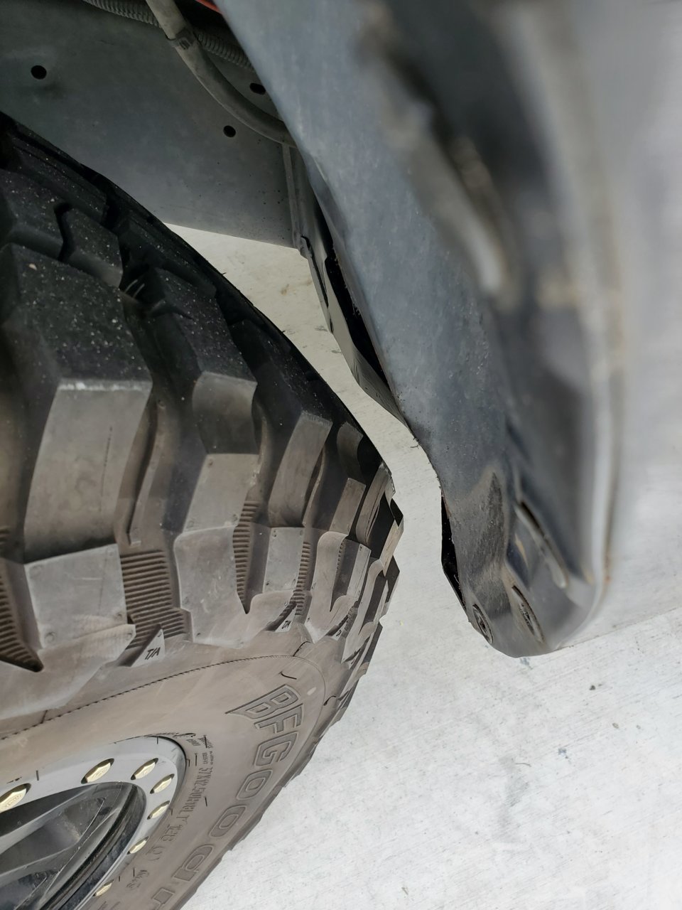

    Just finished up my body mount chop.
    I bought these plates a couple years ago for the 35's but didnt need them so I just tossed them in a drawer.
    Took a better look at my clearences today with these 37's and decided I definitely needed to chop the mounts.
    Took about 2 hours total, start to finish. No issues whatsoever and have tons of room everywhere now.
    You can see in this first pic where the tire was rubbing.
    I just hammered the pinch weld over and nipped off the lower inside corner of the fender.

    Nice work!

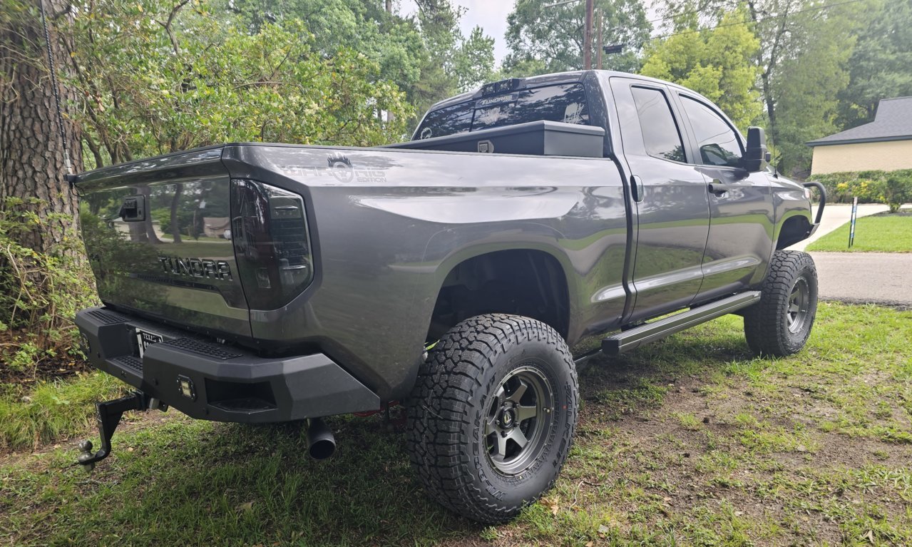

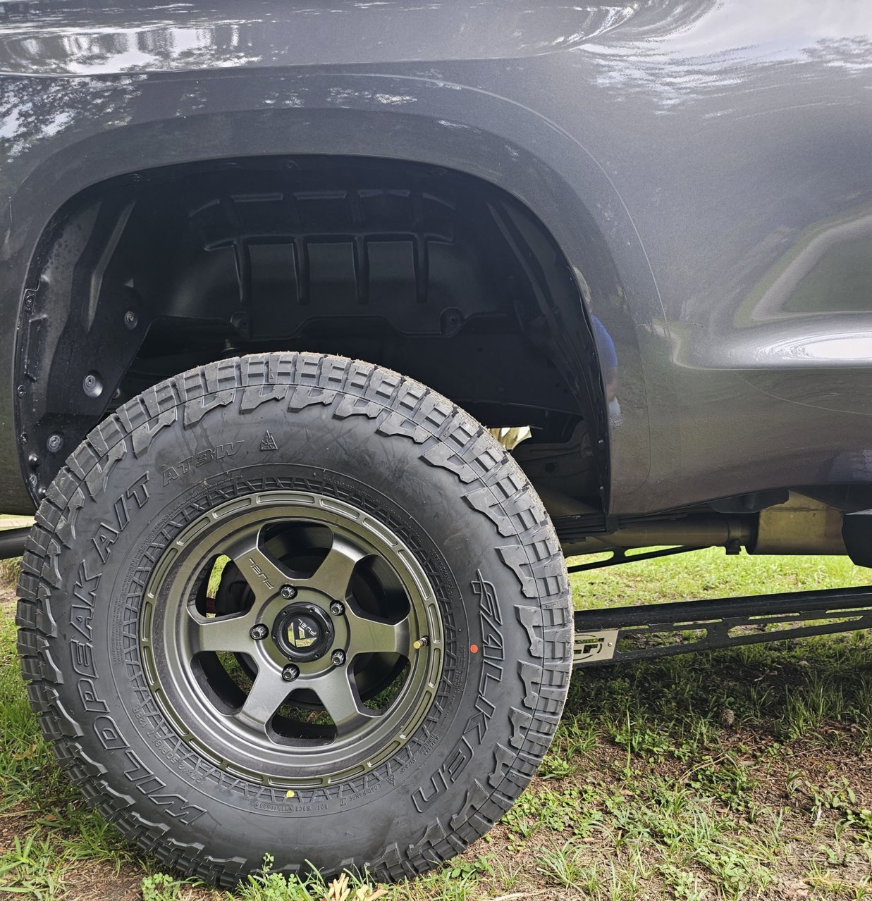

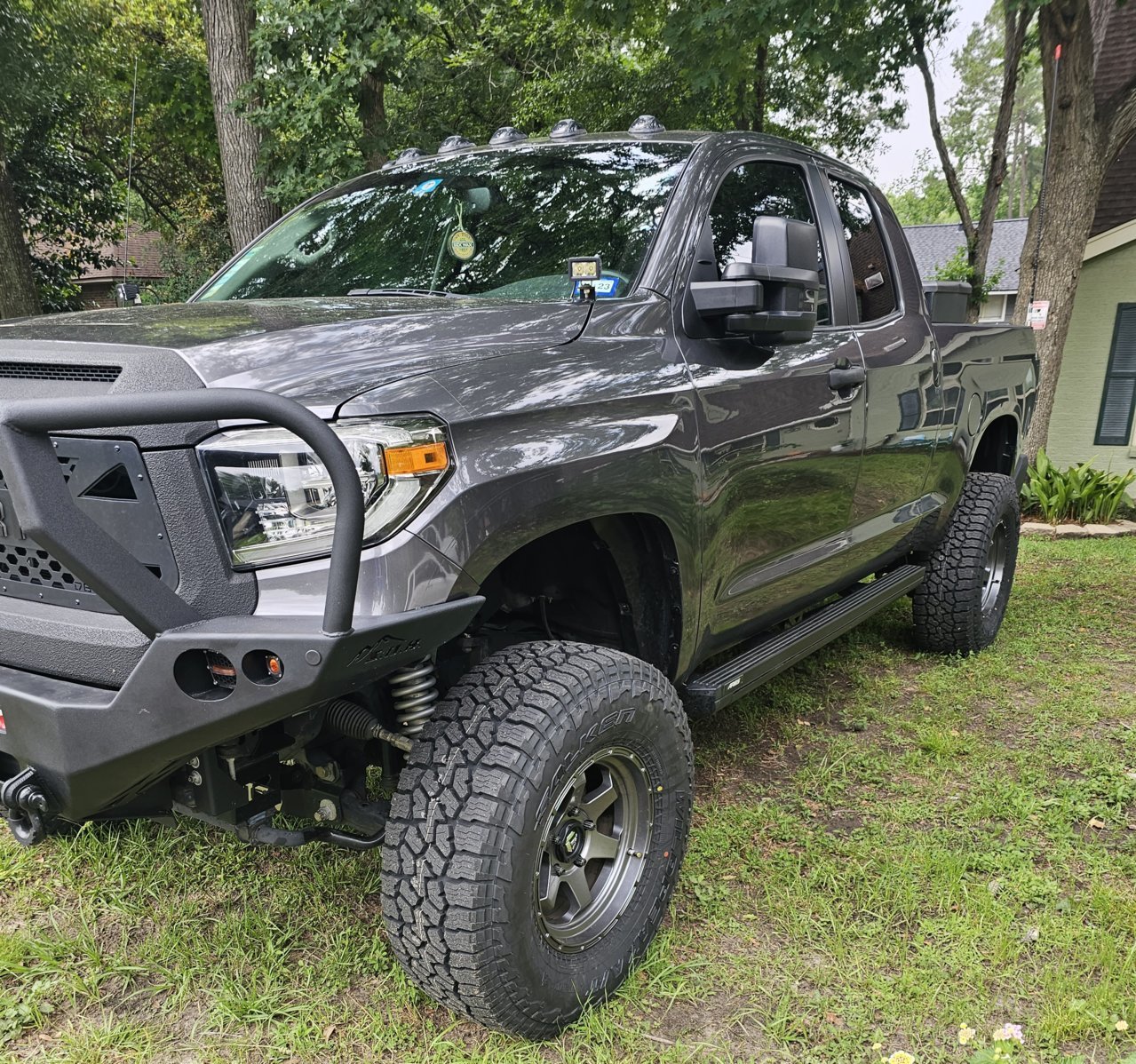

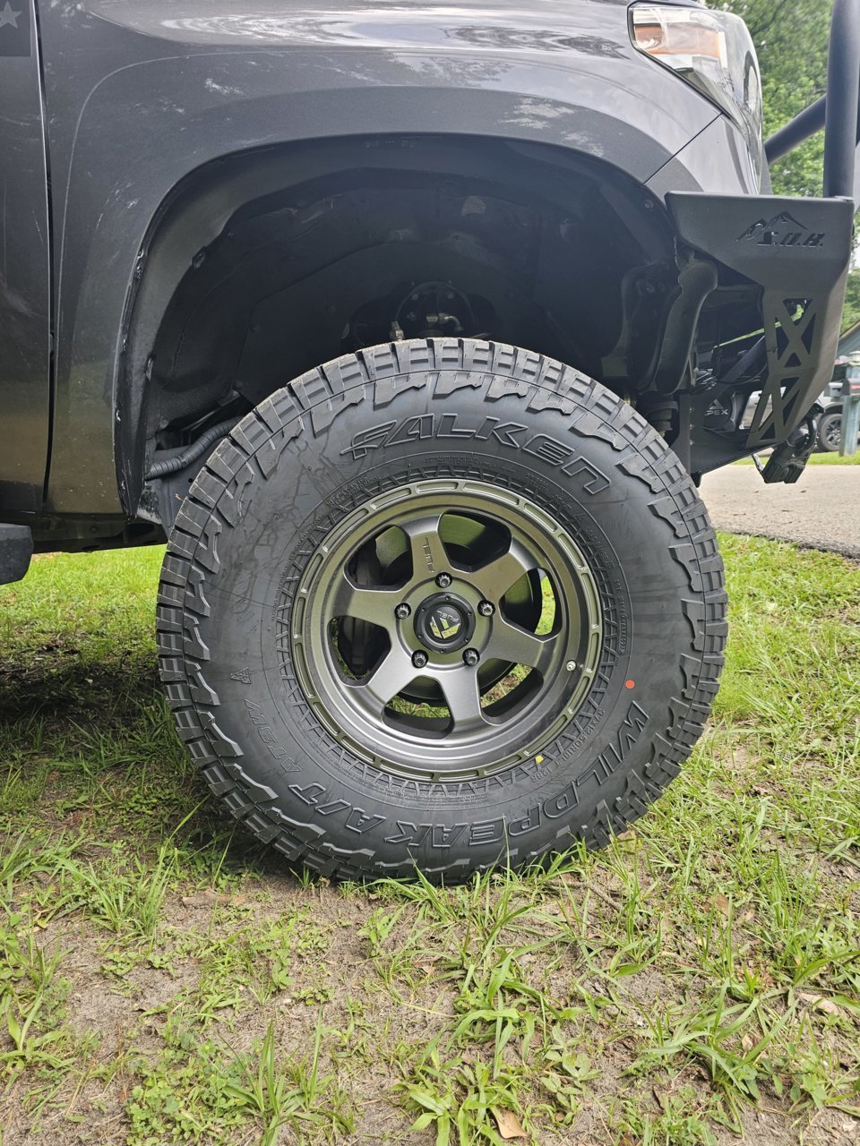

    Joined the Club today!
    20230506_145946.jpg 20230506_145936.jpg 20230506_150046.jpg 20230506_150036.jpg20230506_150009.jpg

    Looks great. Are those 17s or 18s?

    Thanks! They are Method 18x9/+25
