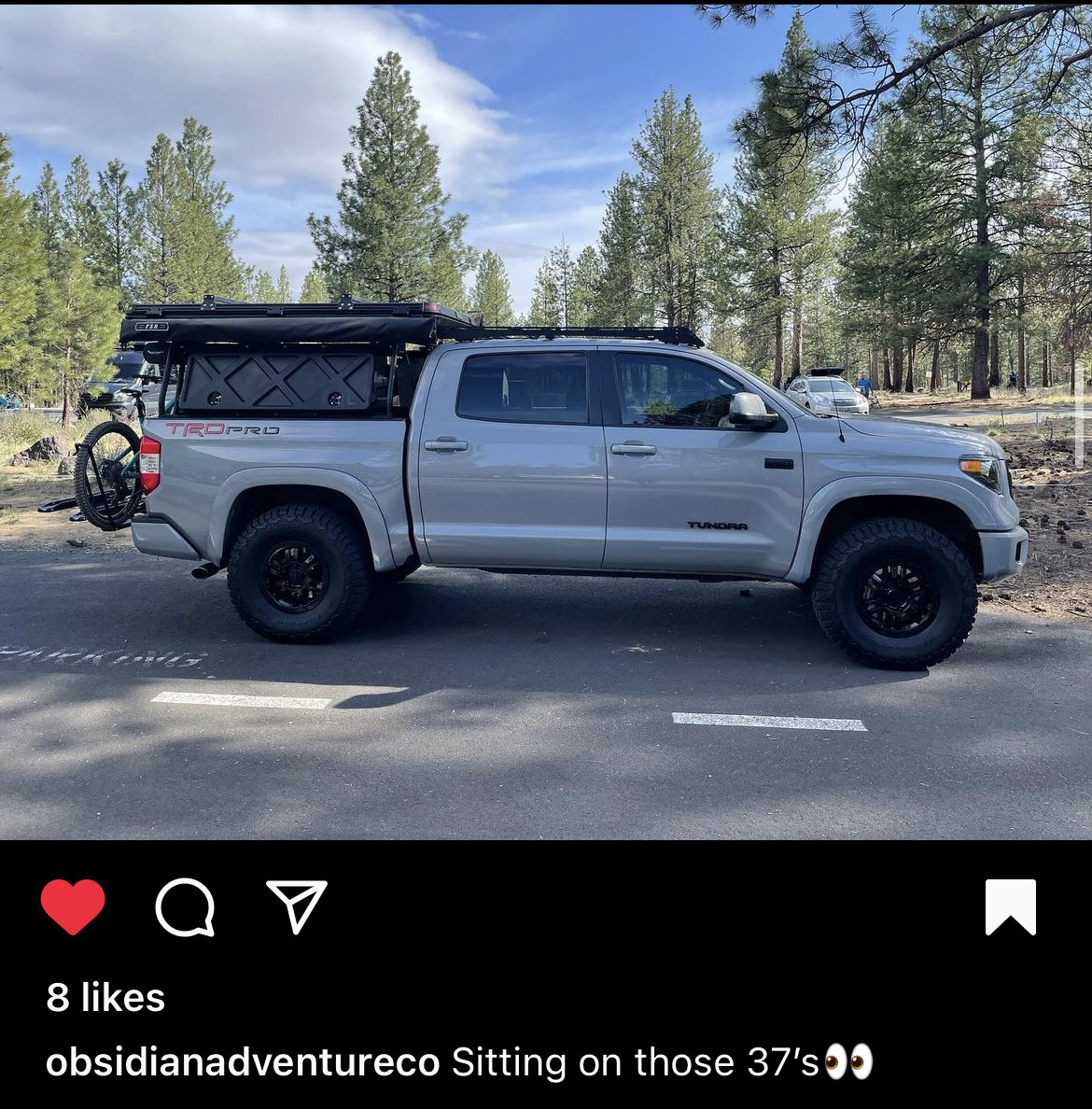

    Question for you all. This individual I’ve been talking to has Pro suspension and coachbuilder shims up front… he’s able to fit 37s with rock warrior wheels. No wheel spacers, no BMC…
    Doesn’t seem like that much work but what do I know
    What are y’all’s thoughts?

    If you've read through the thread, it is definitely extremely rare that you can do this - although, that doesn't mean you can't.
    Body mount relocation can play a factor into this gentleman not needing a BMC.
    PWM, I only know of one person that runs 37 without this mod and that's @Vizsla.
    Pro suspension yields roughly 2" stock, so he's probably sitting at about 2.5" with shims. Rear, you can fit 37s without any sort of modifications.
    The only thing is that, I'm pretty sure he's gotta be running wheel spacers because the RW wheels are +55 which is going to pull the tire extremely close to the UCA. Also, KM3 runs a tad smaller than other 37s. Aside from that, it's probably minimal modifications that he's made to fit the 37s. May have played with his caster, may have trimmed bumper caps, may have added front bumper shims too.
    I think there is a guy (not sure if he's on here, but @king.cong.1119 knows the guy) that runs no lift with 37s.

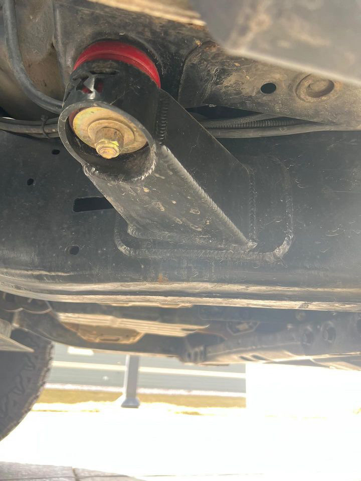

    Mrf1987
    Mrf1987 New Member
    Sep 2, 2020
    #51663
    244
    2020 Trd sport tundra
    If anyone is interested drt-fabrication just went live with their body mount relocation for the 2nd gen tundras. Price is $275 and it is by far the most robust kit on the market! I’m not affiliated with them just spreading the word.

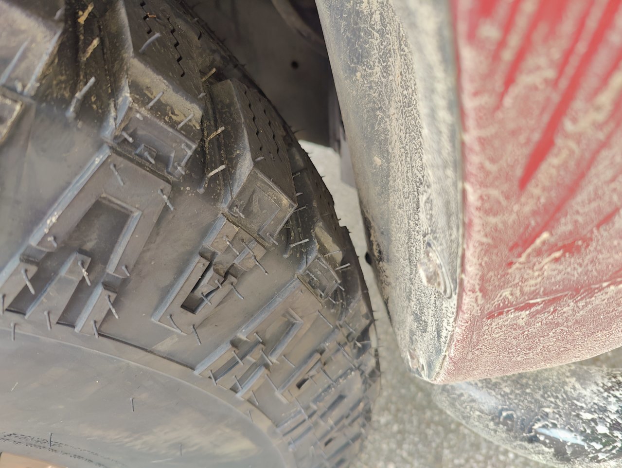

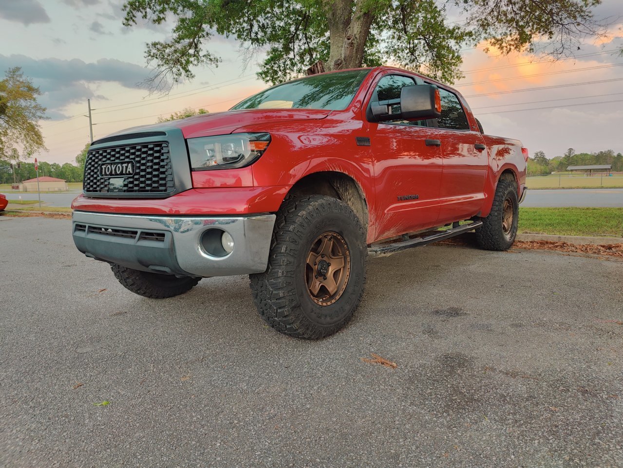

    I know this is a 2.5 gen thread, but I'd like to submit my application to the Dirty Seven club!
    Setup:
    Bilstein 6112/5160 top setting
    2 Driver side Coachbuilder shims and one passenger
    Freedom Off-road UCAs
    Toytec Diff drop and carrier bearing drop
    Pro Form Fab lift shackles (if they ever get dropped off to USPS)

    1,489
    San Diego,CA
    2013 CM 5.7L 4x4 SR5 Super White

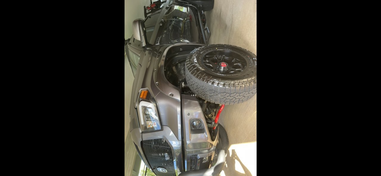

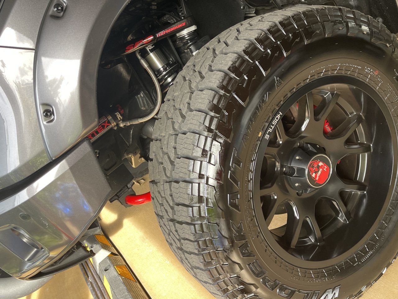

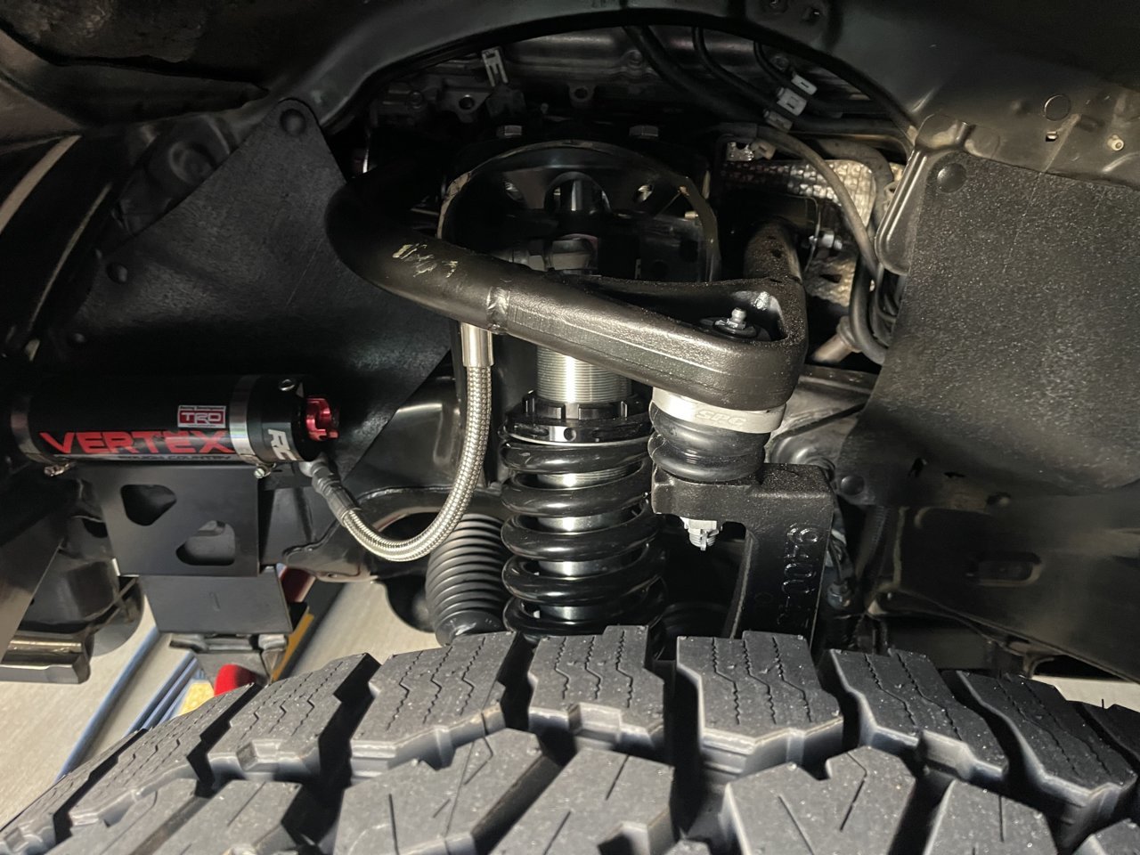

    Love the look on the 2nd gen! Can you you share photos of the inside wheel well? Also tire/rim details?
    TIA

    TimS458
    TimS458 New Member
    Feb 5, 2022
    #74182
    29
    2012 Barcelona Red TRD Off-road
    Here ya go! I used the SDHQ plates and they clear great. I might have to trim and hammer the pinch weld and massage the liner a bit, but I have noticed much, if any rubbing

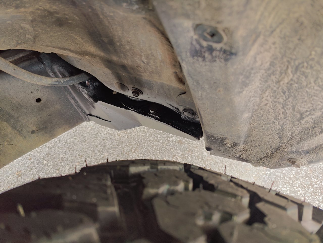

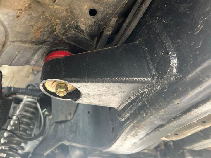

    Jonnynewton909
    Jonnynewton909 Jonnys_Tundra
    May 14, 2020
    #46579
    337
    Jonny
    East Texas
    2017 Tundra CrewMax

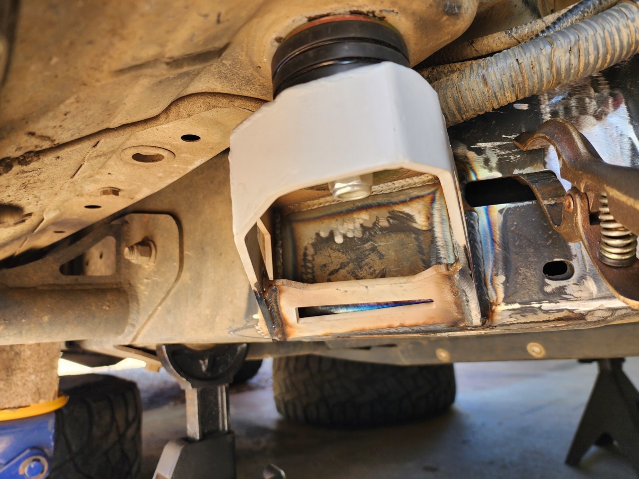

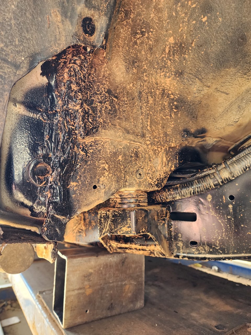

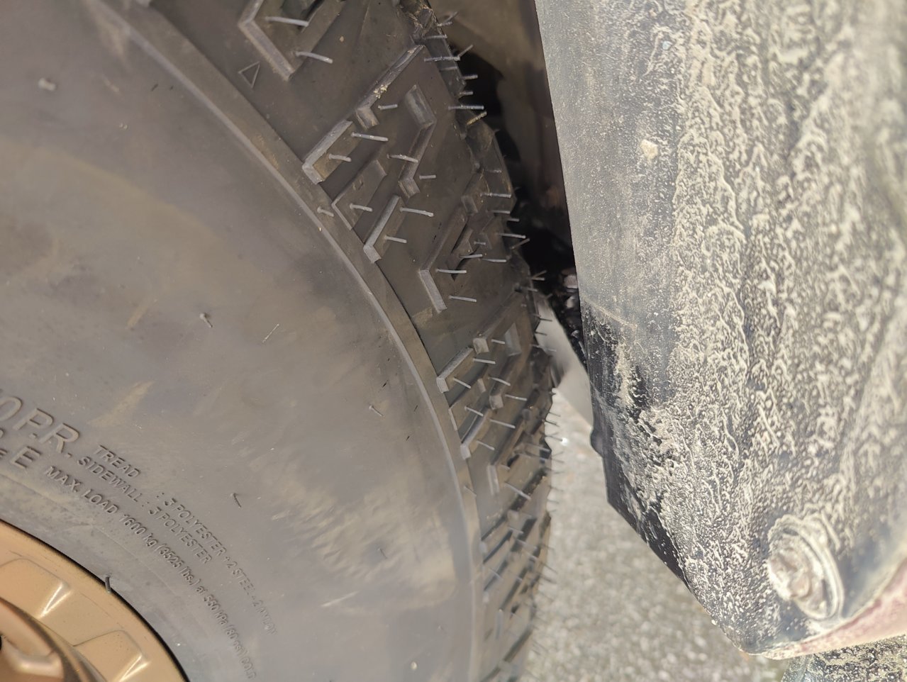

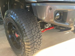

    Accutune Fox DSC 2.5 front w/ SPC UCAs, Alcan custom spring pack and Accutune Fox DSC 2.5 rear. 37 Toyo RT Trails on Method 312s. SOB Fab F&R high clearance bumpers. AT Overland Atlas.
    Well, I finally took the time to install my LCS Fab Cab Mount Relocate bracket, pushed the UCAs forward and set caster to 6.4 which was maxed out on setting A, and threw some 2nd hand 37x12.50R17 Cooper STT Pros on. Came out pretty nice but man that's a lot of tire and gas mileage really went to crap! LOL The 0 offset isn't helping either but it seems to be clearing everything for now. Gonna put it through its paces and see what needs attention or if I may make the swap to a + offset wheel.
    This is just mock up. I threw a longer bolt in there once everything was finalized!
    Pinch weld sliced and hammered in then coated in 3M body seam sealer.

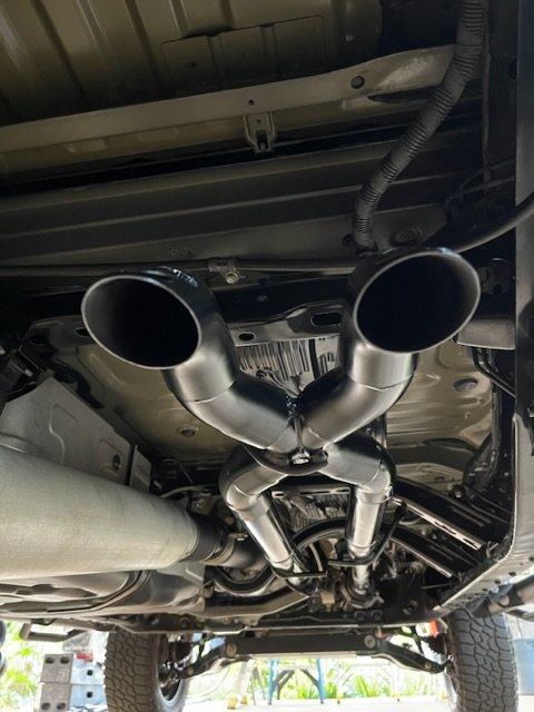

    ever since the 6” lift, my OCD took over so i can clean the under carriage easier. Now part of my wash/detail is interior, exterior, engine bay and undercarriage

    Ok I need an exhaust sound clip lol
