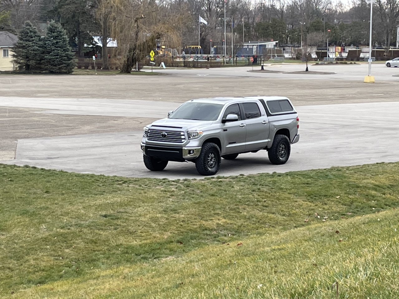

  25. Dec 15, 2022 at 11:18 AM
    #2425
    Brendybobby
    Brendybobby New Member
    Jan 17, 2021
    #57768
    68
    Indianapolis, IN
    2019 tundra limited crew cab - silver sky metallic
    2019 Toyota Tundra Limited Crewmax Silver Sky Metallic Rock Warrior Wheels Spidertrax 1.25 spacer 37x12.5x17 Dirty Sevens Club Bilstein B8 8112 Coilovers Bilstein UCA BILSTEIN 5160 Wheeler mini leaf pack addition (I think deaver f-85) Increasingly aggressive BMCs/CMCs
    You can’t see where it rubs from far away…
