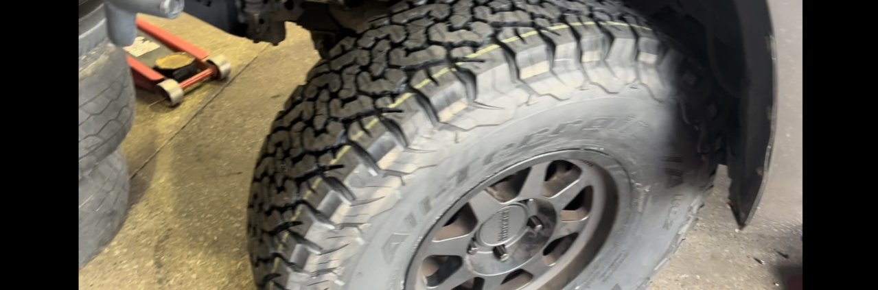

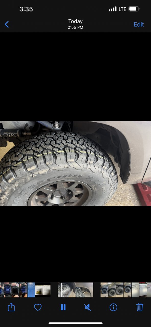

    K02 37 fit with no chop. Mickey Thompson on the way should be here soon

    Looks sick! I scheduled my install for Monday.

    How much clearance do you have between your tire and the UCA? I can't really tell from the pics. Looks close, which makes me nervous because the wheels I just got are +35 offset. I've heard that +25 was the "sweet spot" but Method didn't make the wheels I wanted in a 17 with that offset. And I heard that 0 offset would cause a lot of rubbing issues, which doesn't seem to be the case with you.
    Makes me wonder if I'm going to need a spacer...

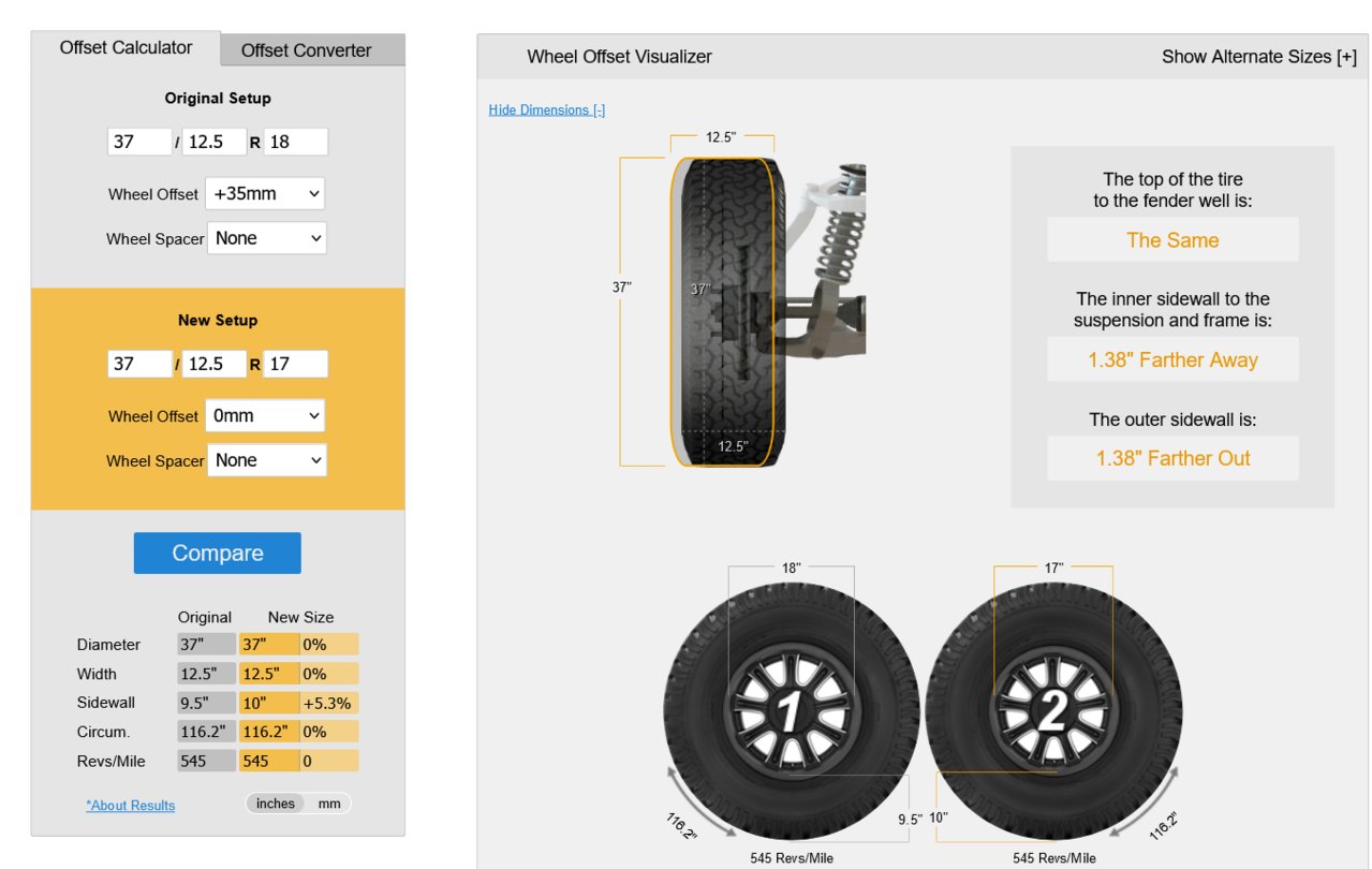

    Well if I was going to do a spacer, it would only be a half inch spacer. That would get me pretty close to a +25 offset. But I only want to do that if necessary, because that would require changing out the wheel studs to longer ones.
    But if I did do a standard 1.5in spacer, that would bring me a -3 offset which is VERY close to 0. It's roughly only 1/8 of an inch further out than 0. And again, yours surprises me being 0 offset without even needing a BMC.
    I'd still like to know how far away your tire is from your UCA though.

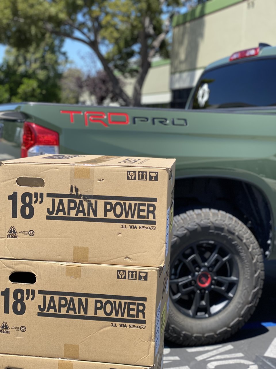

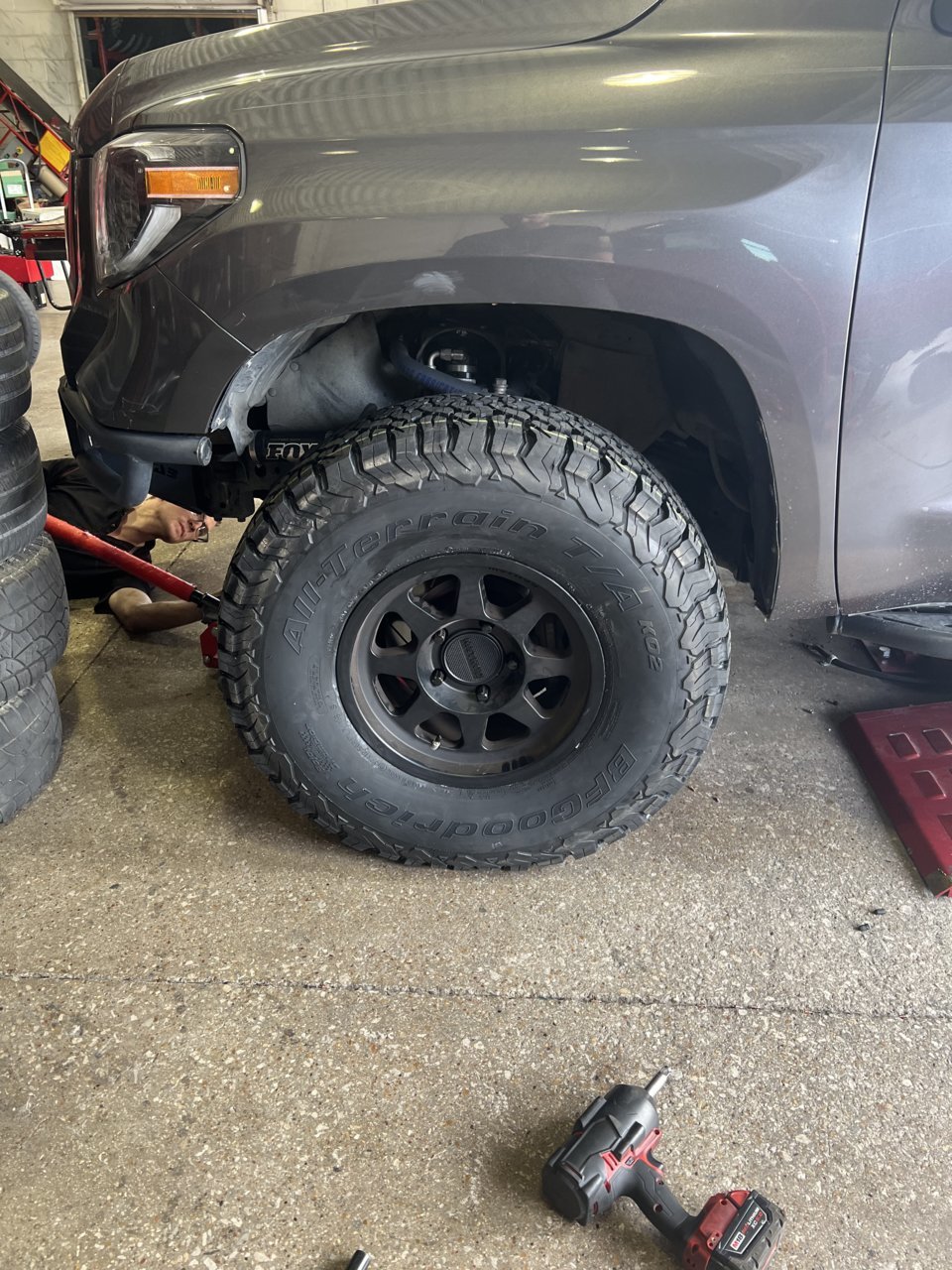

    Almost there.

    Now you just gotta get the tires and slap them on. Can't do much until you do that step. You can guess all you want about clearance and what not, but all of our trucks will run slightly different from one another.

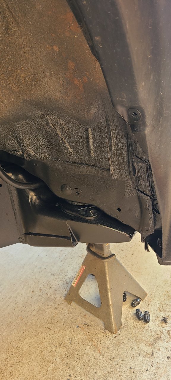

    my BMC and PWM. I have A C4 overland bumper so not worried there 3" lift

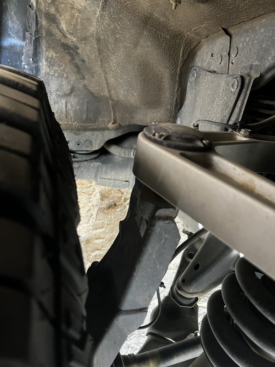

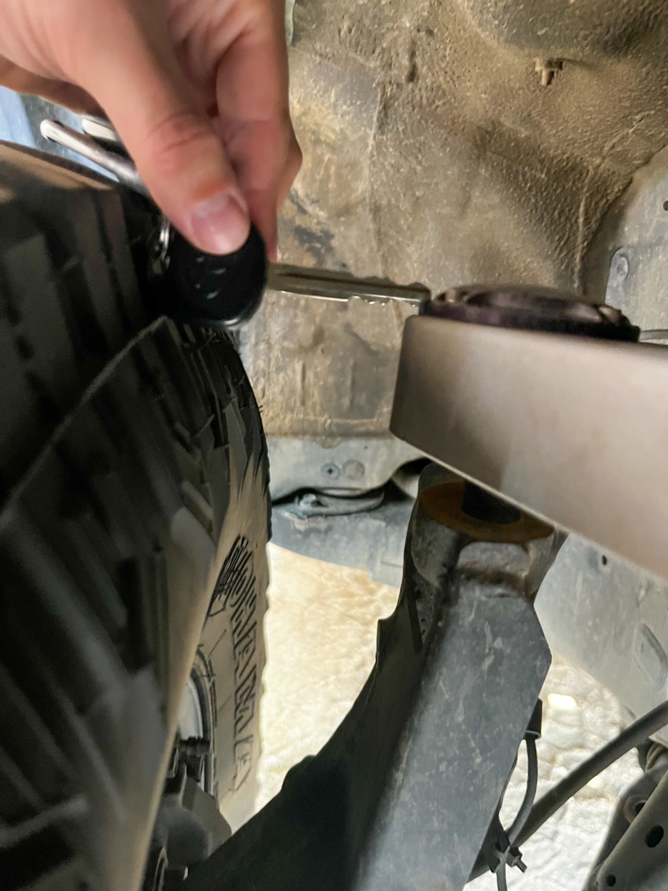

    Here’s 37x12.5x17 with 17x8.5” methods at 0mm offset.
    (don’t have a tape measure handy but here’s a key for scale - not at the widest part though)

    dont forget you have the icon billet UCAs so that helps a bit too on the clearance

    Did you have Jason do it? Looks really clean!

    I sure did!!!!

    Totally. I know it’s more for clearance on the body mount, but the “thickness” (for lack of a better word) could play a roll in clearance. I’d imagine max of like 1/4” change between these and a UCA that sticks out more.

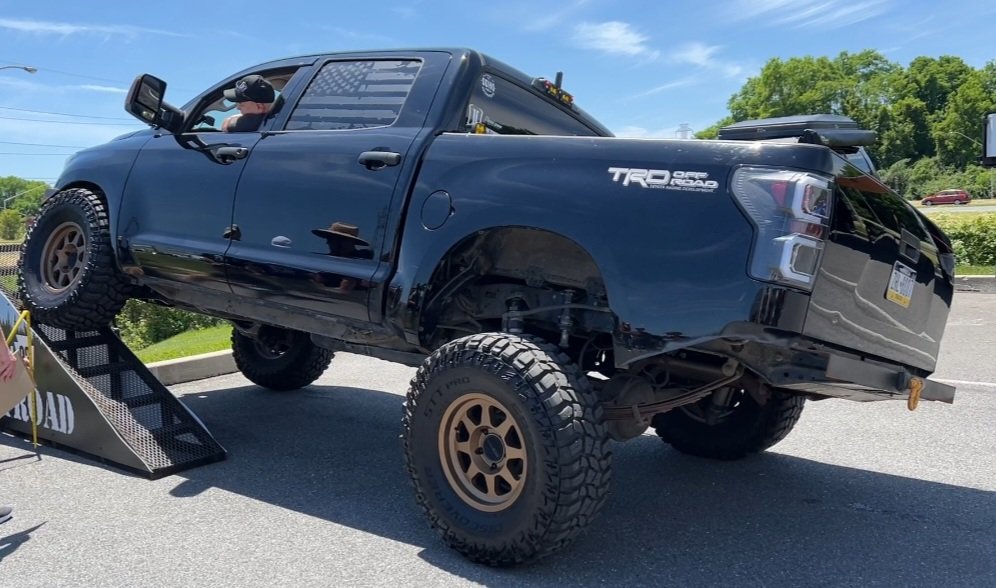

    I'm on 37x13.5 and I have no rubbing in the front and very little rubbing in the rear at full flex.Screenshot_20220615-201045_Gallery.jpg

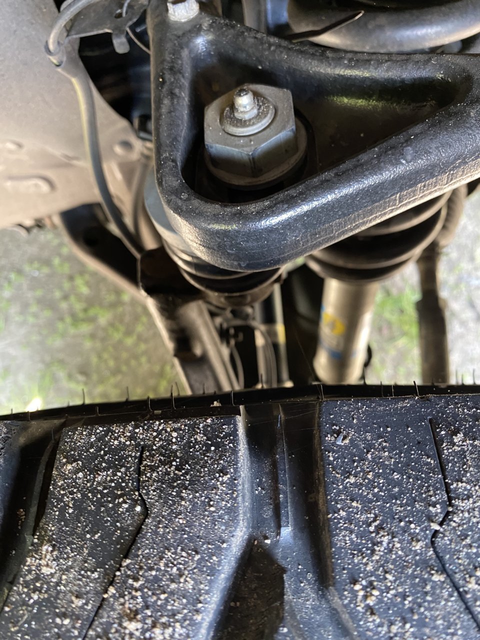

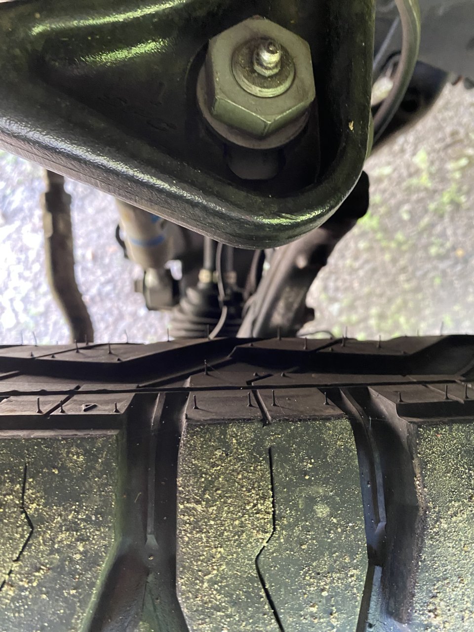

    This is the clearance I have between SPC and my Toyos.
