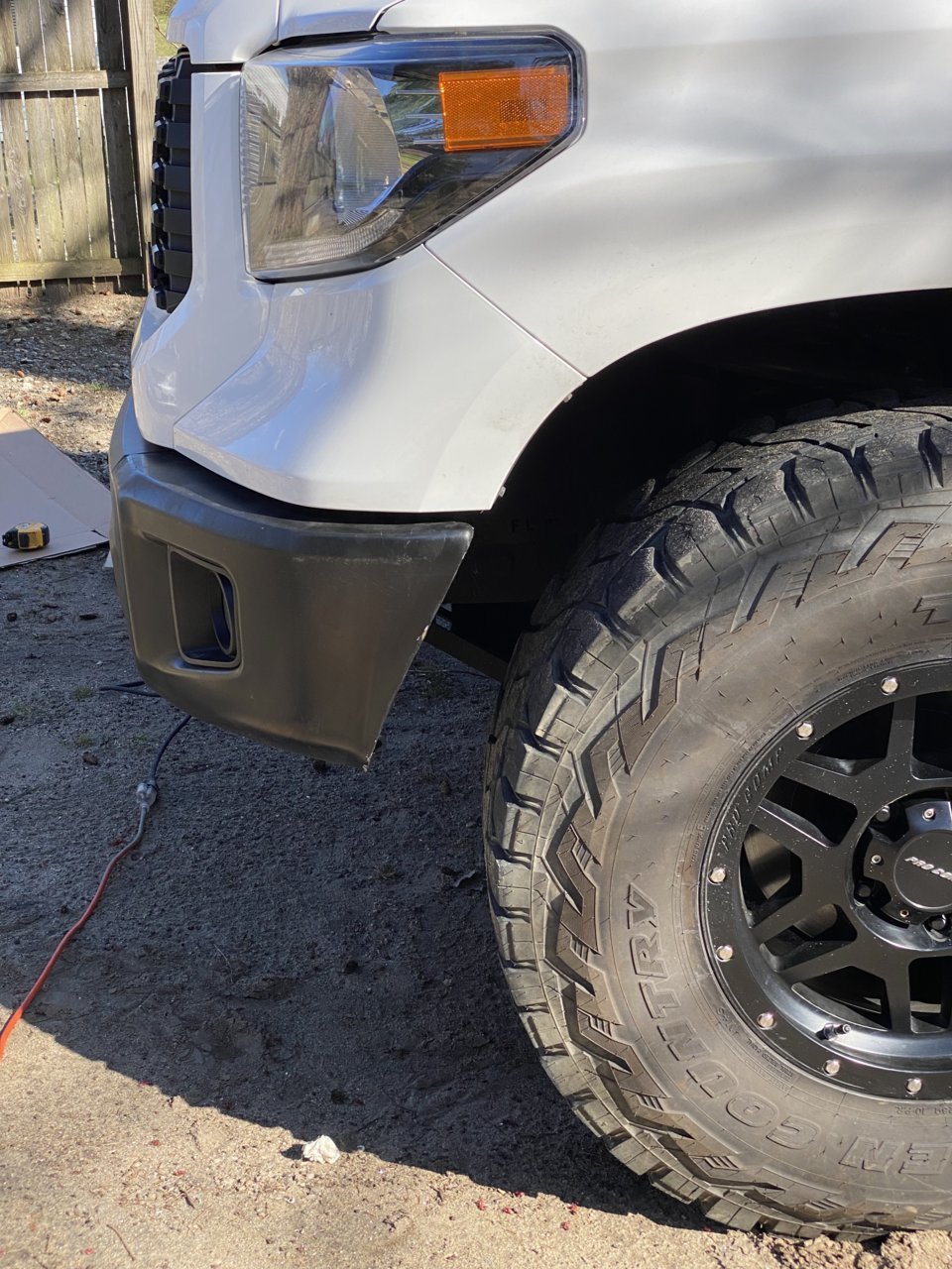

    That viper cut looks great! Or an aftermarket bumper lol Just got this in preparation for 37s

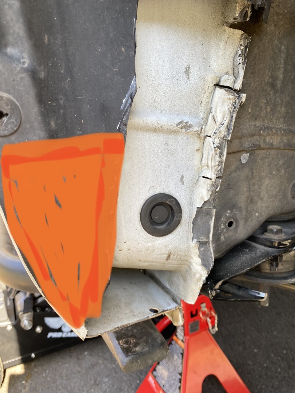

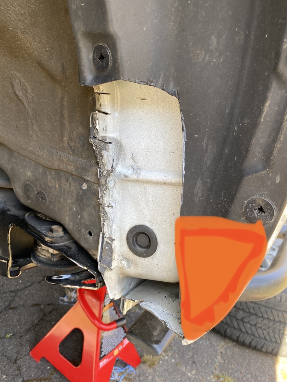

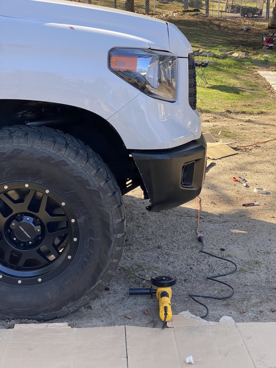

    I swear, you guys weren’t kidding when you go below the sweet spot offset of 18 and 25… holy cutting. :sawzall:
    The wheels are 12 offset, so you guys who are running 0 offset wheels… :bowdown:
    Anyway, I figured out what was currently rubbing without the alignment. It was the bottom portion of the fender well that was catching when I was turning full lock. Now when turning full lock, I’m touching the pinch weld and the body mount.
    Next up is to cut the caps, so when I get an alignment, I won’t rub up front.
    So the orange area was where I had cut, and the hole which the fender liner was mounted on, I had folded it back.
    351CFD4D-9730-4908-A0AE-97D58B126C3F.jpg 6CEBD851-D9B4-411E-A2C4-DF9E921CD270.jpg
    For those going below 18 offset… be ready if you’re willing to cut, cause you’re going to cut a hell of a lot.
    And if you’re cutting your fender liner, this tool cuts it like butter.

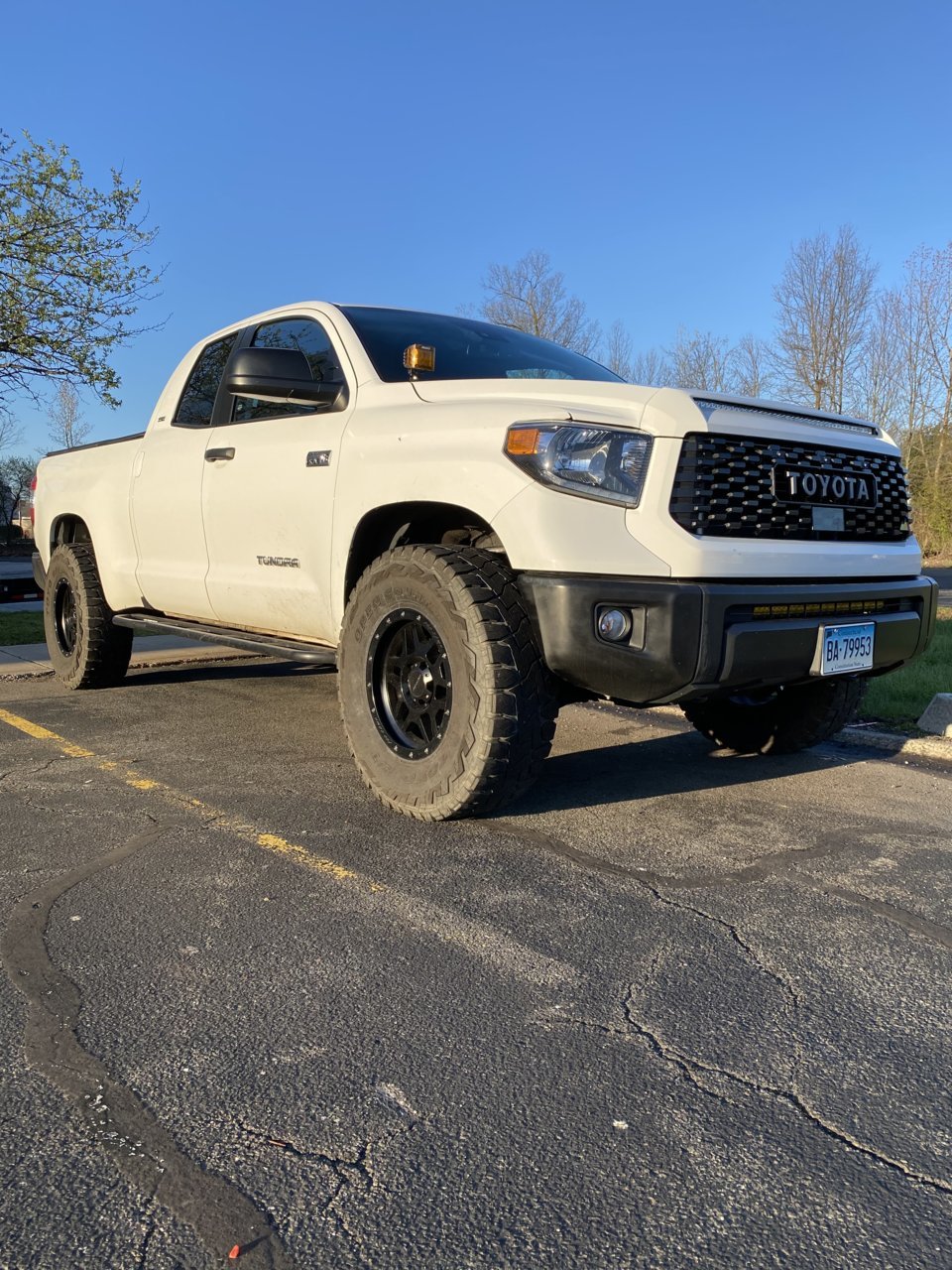

    We’re on 2.3” up front, 3/4” in the rear.

    The cut came out better than expected! Was going to do the viper cut, but she said she didn’t like that look.
    So now to get an alignment and adjust caster…

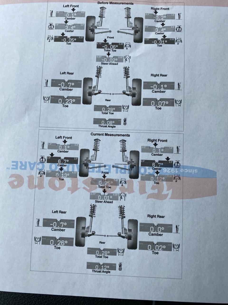

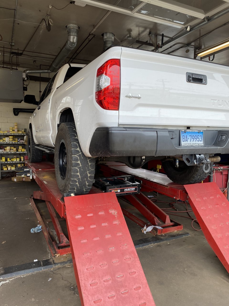

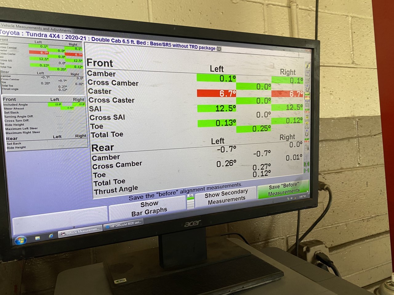

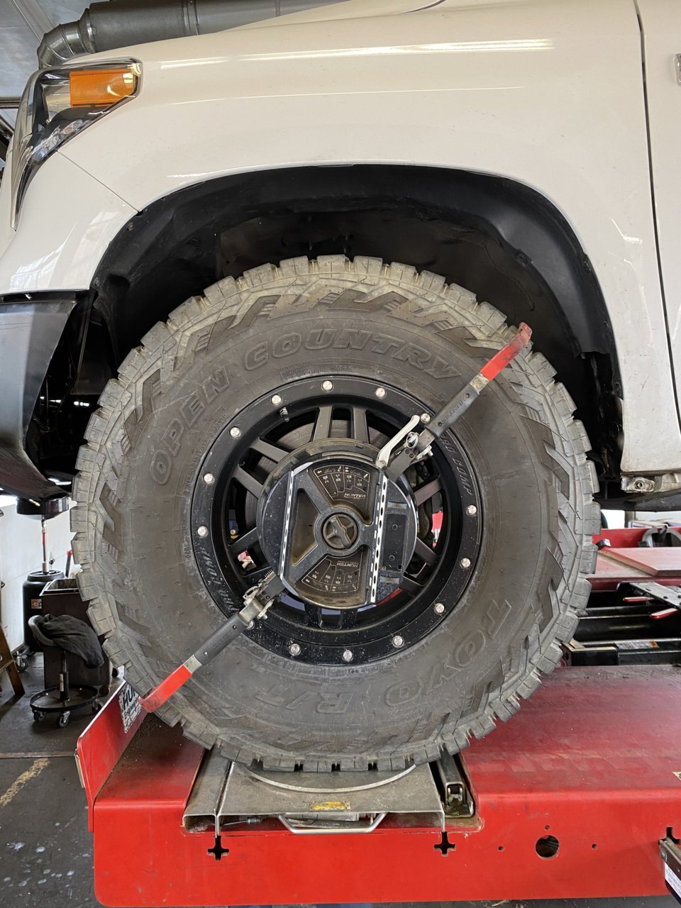

    She’s going in for an alignment today.
    Aiming for 5-6* caster, total toe .24, camber 0.
    Let’s see if we can center the wheel in the wheel well so I can push my wheel away from my body mount!
    J&ATundra, Mountun Goat, Ryuu and 3 others like this.
  9. Apr 18, 2022 at 12:59 PM
    #1929
    pvn.beluga
    pvn.beluga New Member
    Dec 28, 2020
    #56744
    2,009
    Phuc (Phooc)
    Connecticut
    Magic numbers I tell you. My alignment guy is a wiz!
    Camber: 0.1/0.1
    Caster: 6.7/6.7
    Toe: 0.13/0.12

    At Firestone of all places! Those are great numbers. What UCAs are you running?

    Was talking to Mike (@eccracer104) and he had Firestone lifetime too… thank goodness that I was able to get lucky with an alignment guy that knows how to get those numbers!!! So now that lifetime alignment is definitely worth it!!!
    I’m running SPC @ A setting.

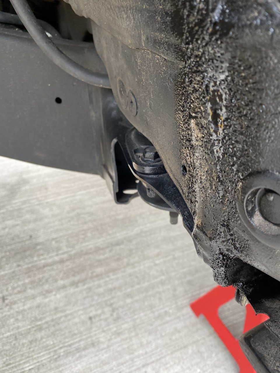

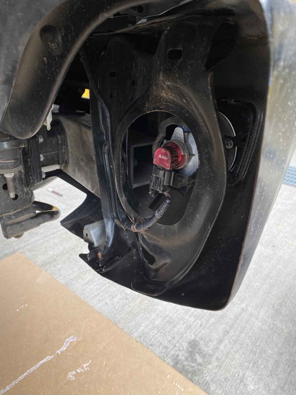

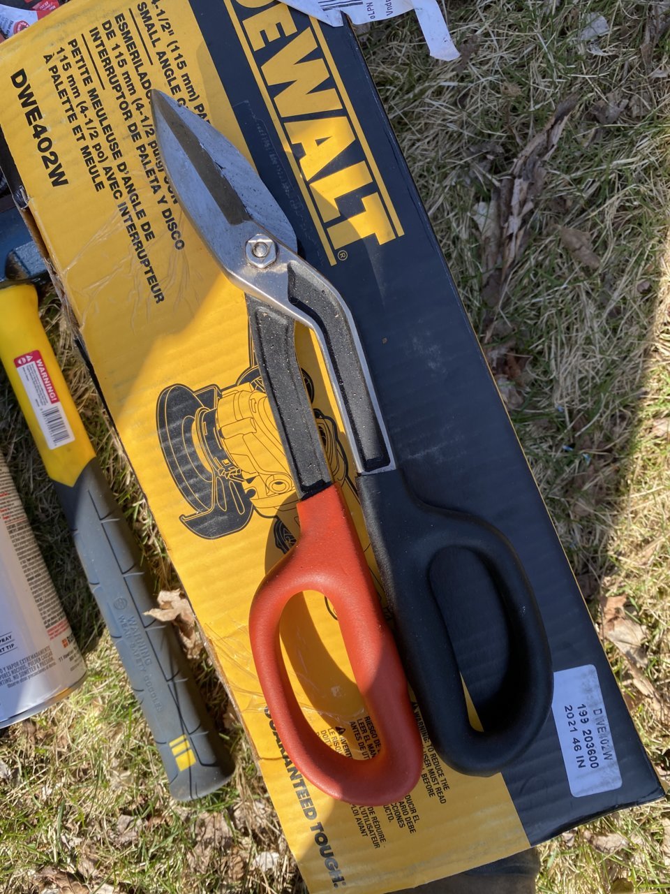

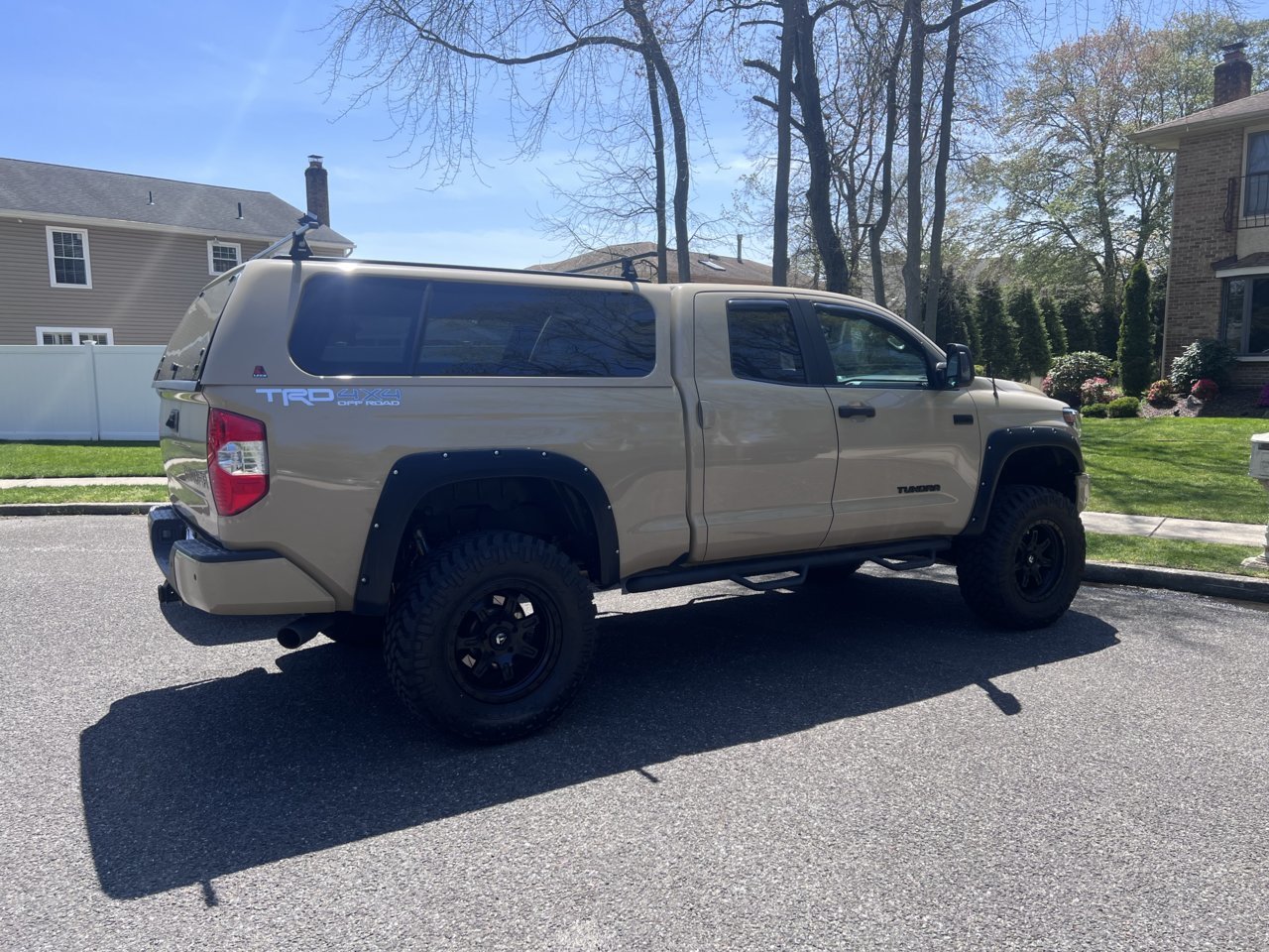

    Had some free time today, so I went in and cut some more :sawzall:
    Trimmed the bumper caps another 2” and rigged the 12mm bolt that was holding the bumper cap to the fog light sub frame. I had cut it and then saw that it was too loose. Figured I was going to rivnut it, but then realized that I can just drill a hole and re-use the piece I had cut.
    CB06D83F-DE97-482D-AF43-8FE6E675D37C.jpg B3F3F02E-6A4B-4134-9082-FB068216A746.jpg
    Then we went down town with the BMC, AGAIN… it’s probably my 3rd time chopping it, but I think I’m fairly confident that it’s as aggressive as I can get it.

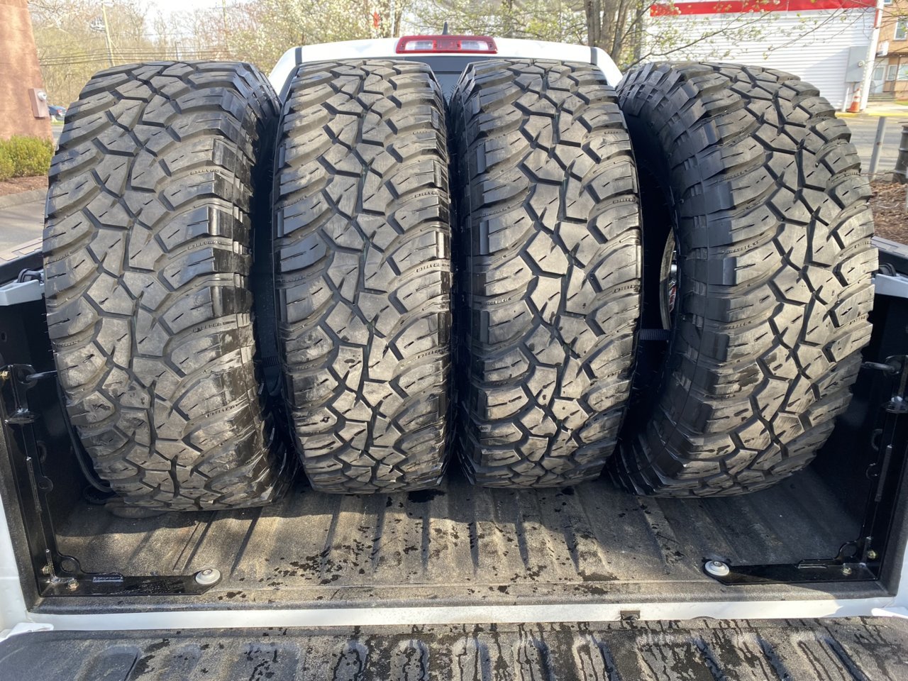

    Recently picked up a set of used General Tires Grabber X3 for a steal - treads measuring all at least 13/32 so we’re at roughly 60% life which definitely isn’t too bad!!!
    My Toyo Open Country RT are sitting around 6-7/32 I believe… so I may run these set until end of summer and then swap over the Grabber X3 for Fall/Winter.
    I got my tires balanced again, took out those damn beads and then used hammer and tape weights. Rides perfect now and no more steering wheel wobble at 55-65mph.

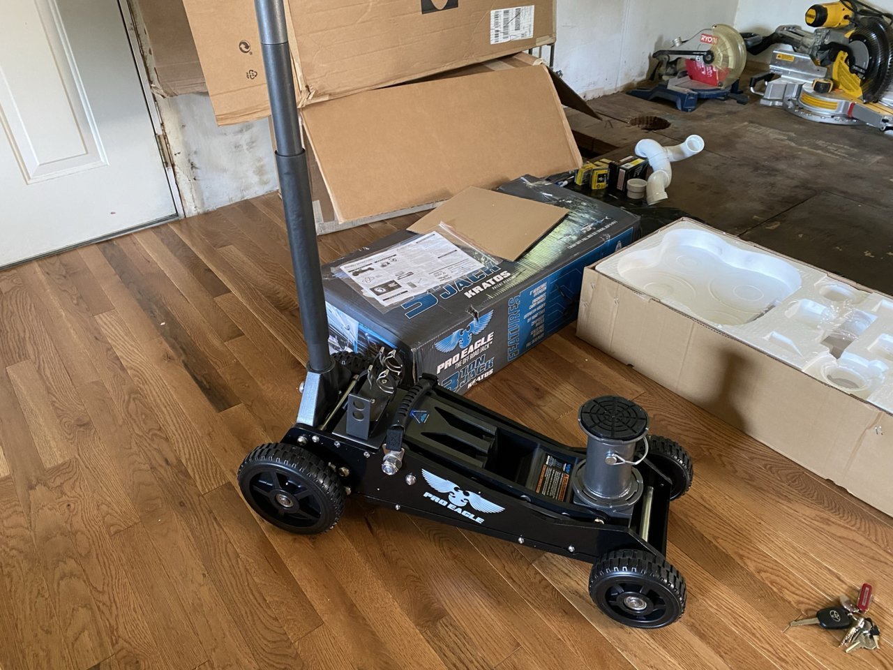

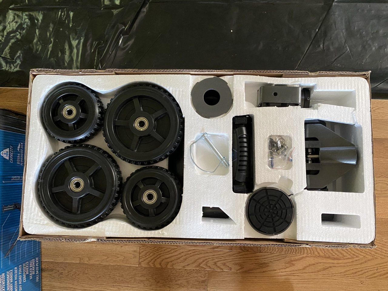

    I bought mine (Beast) from Discount Tire on eBay but it also didn't come with a cover or bag. I think they did away with them. As for storage I just keep it in my truck box along with all my other gear (jack stands, recovery strap, jumper cables, 6 ton bottle jack, extra coolant and water, and various blocks of wood)

    I have mine pushed to the back and ratchet strapped down onto the bed with my d-rings. Have a cable locking the Pro Eagle to the bed.
    I'm running a tonneau right now so it's covered, but I do eventually want to pick up the Pro Eagle mount.

    I thought about it too. Cheapest I found was something like $160.

    Man, the Kratos is almost $250.

    Exactly. The Beast is a bit more but still not paying $160 for something to hold my jack. It does quite well in my truck box
