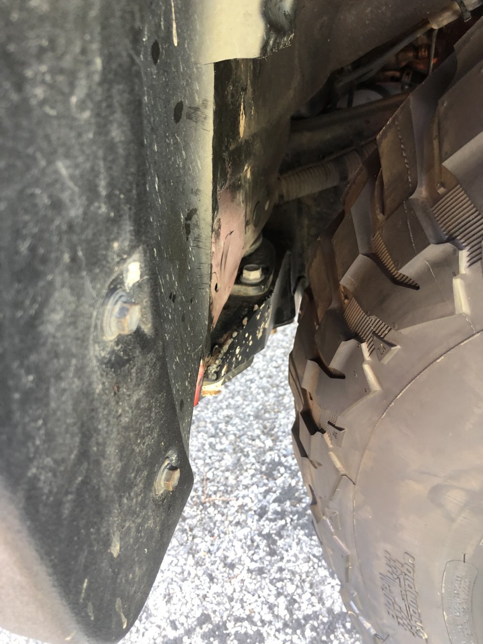

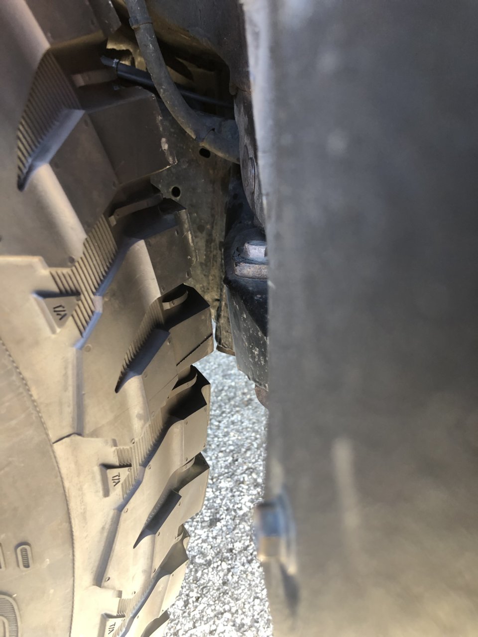

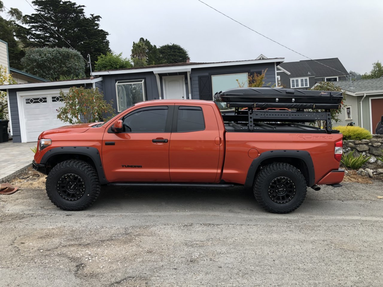

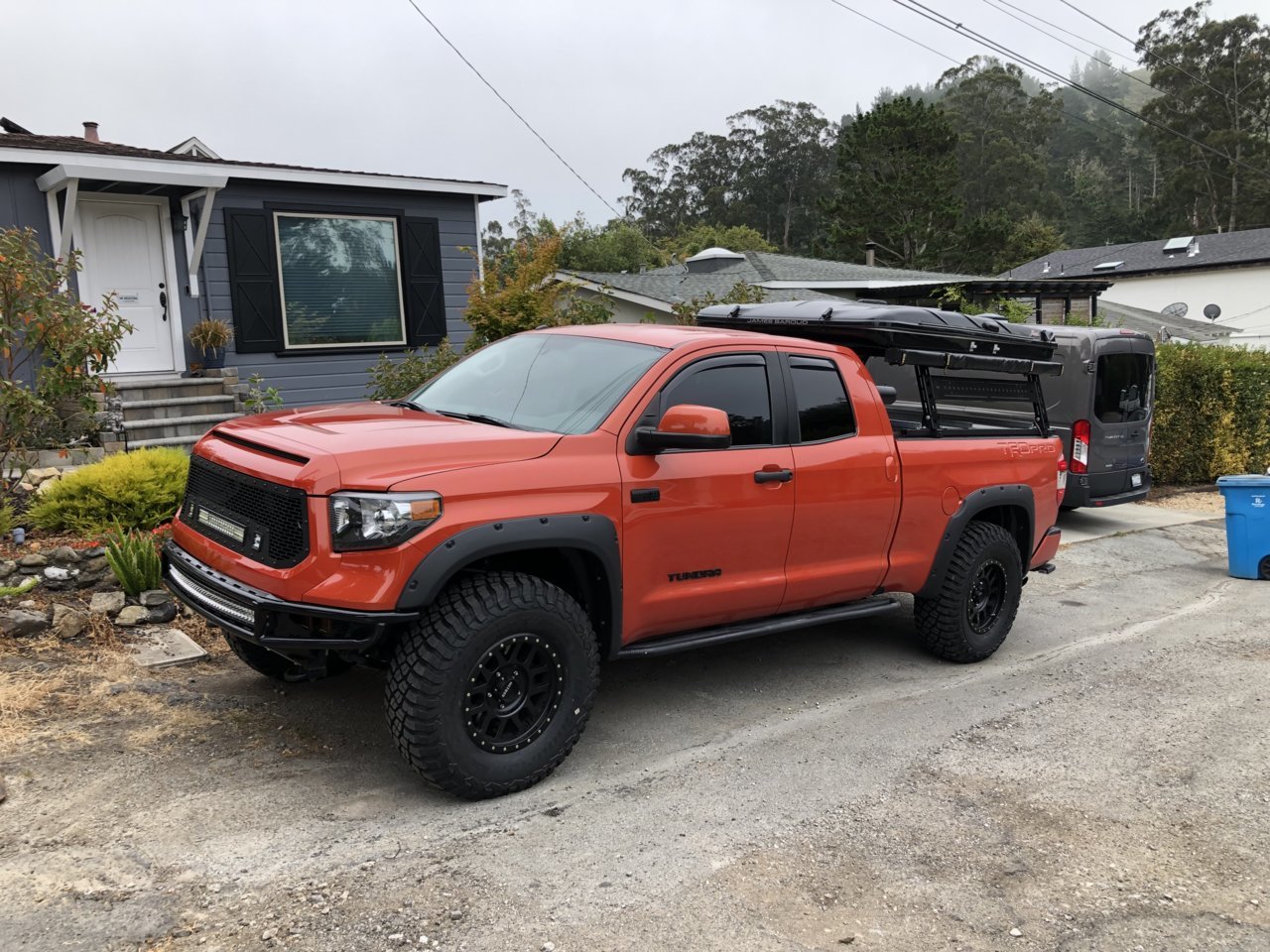

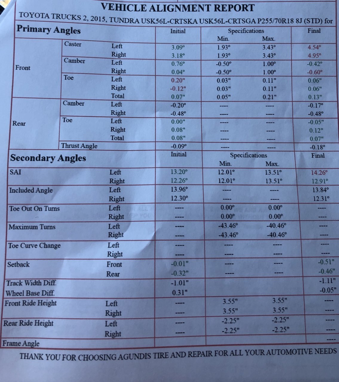

    So I finally got it aligned and now I’ve got plenty of room for activities. I ended up going to Agundis tire in South San Francisco. As soon as I got there they brought it in and an hour later it was done. Had to pull if from dealership as they had it for two days and didn’t do shit. They apologized and offered a free oil change. Now to put on all my skids again. Now I have to find a loading dock to test it while articulating.

    theres the magic caster numbers :thumbsup:

    dang... how did you get the caster that high ..mine is around 3.5

    I took it to the right shop. I told them I wanted as much caster as possible by adjusting the LCAs forward with staying in spec everywhere else. Best part was that they did it in one hour. First time I’ve taken my truck anywhere and got my work done the way I want it in a timely manner. Unheard of with mechanics. Glad it’s done and now back to breaking in the gears so I can test this bitch off road. C4 hybrid bumper and warn winch are the last on my list. Otherwise the truck is exactly how I want it.
