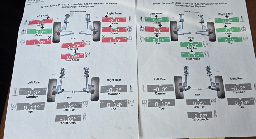

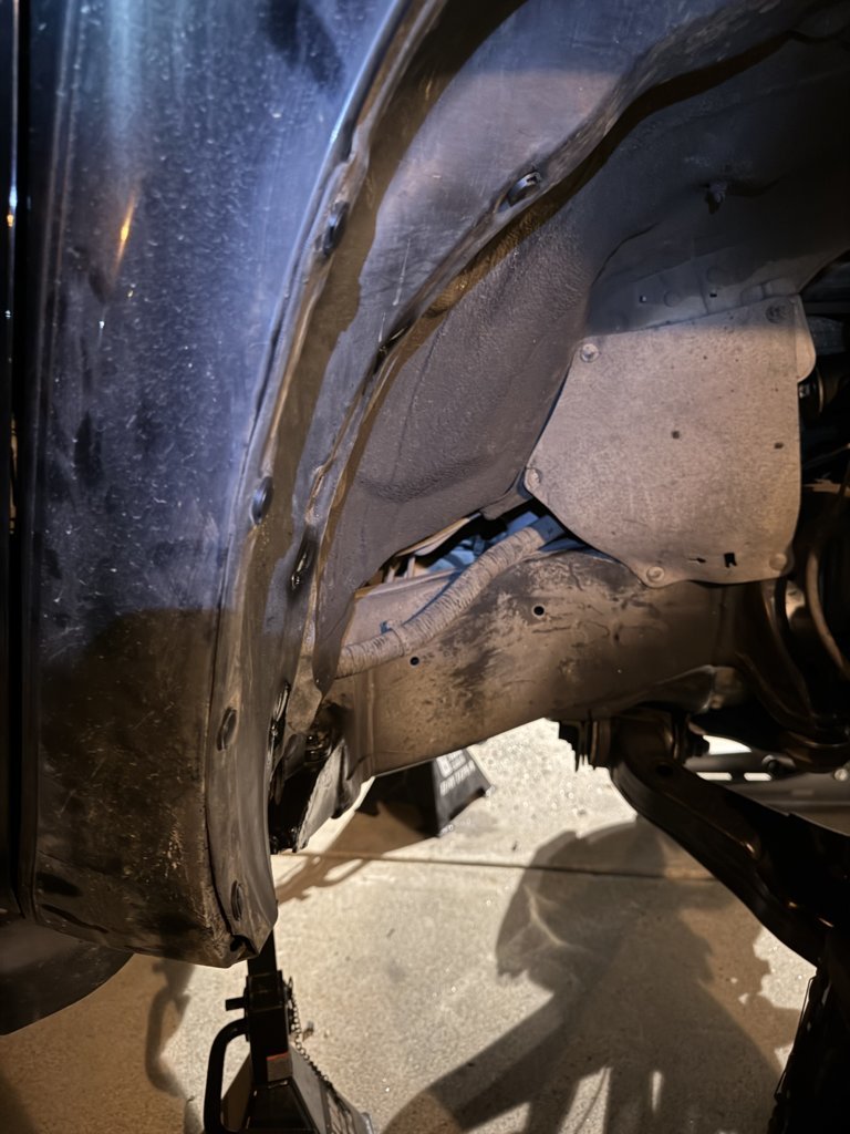

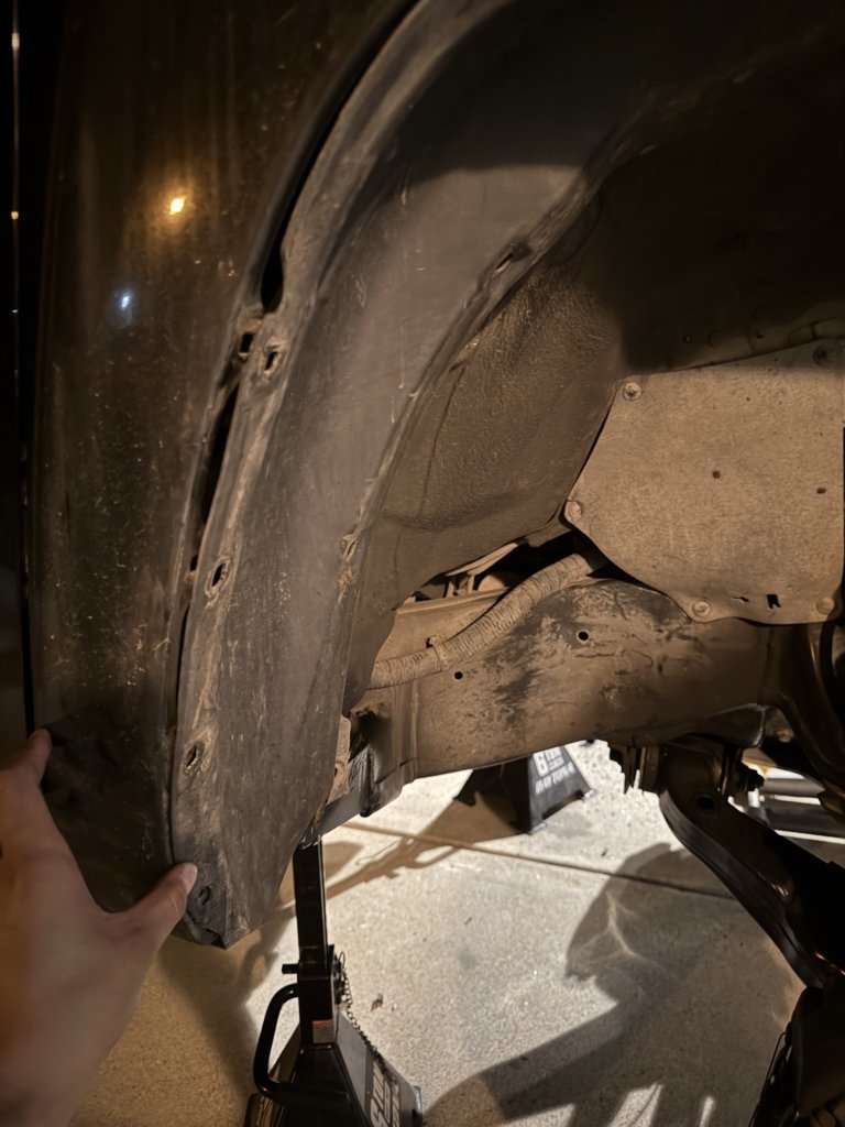

    alright got a alignment done this morning and rubbing less with a little more positive caster
    that being said, think I need to hammer or saw off some of the fender.
    what do yall recommend?

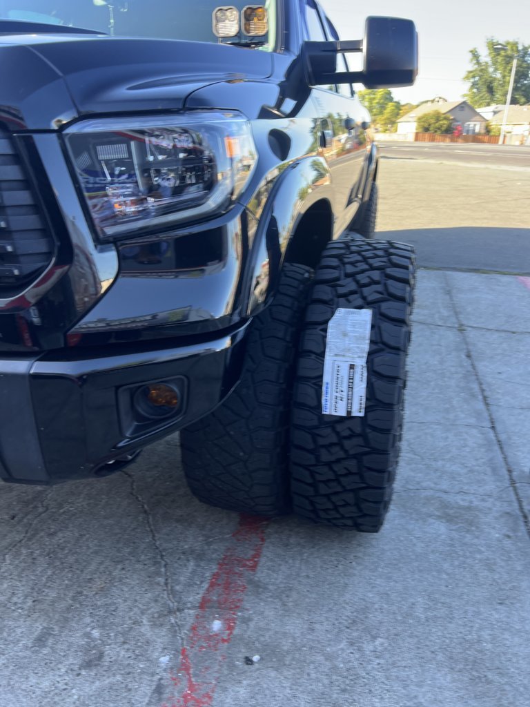

    Yo fellas, need some help. Finally pulling the trigger and going 37's. My question to you guys is I'm going all out and getting a new pair of shoes too. New wheels I'm looking at have a +10 offset. Would I be good with that? I'm also going down to a 17" from an 18" wheel. Heading to the local shop tomorrow morning so any info would be appreciated. Thanks

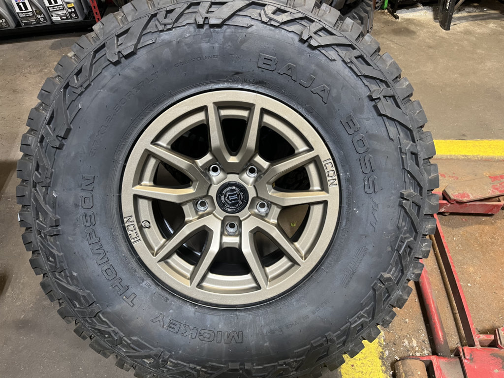

    Hey all I am getting my lift installed this month and then I will be going with BFG 37s. Issue is I have the TRD BBK so I have to keep a 20" wheel to clear the caliper. I found a company that will build me the exact wheel I need to get the perfect offset. So from the online calculators it seems like I should go with a 20x8.5 et+45 rim to get me the best offset for the BFG 37x12.5x20 tires. Any input on this would be appreciated! These wheels ain't cheap.... And I don't get any do overs.
    https://9and3wheels.com/collections/all-wheels

    I would double check the +45. seems the sweet spot is +25 -+35... with 18s anyway

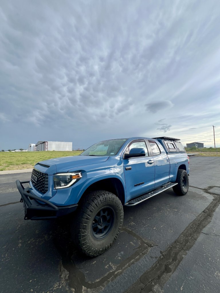

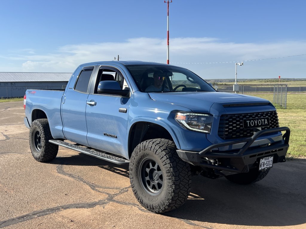

    IMG_4377.jpg Took the RLD cap off and installed a Rough Country Speedometer Calibrator. Truck feels great with the reduction of weight. The canopy alone was 300+lbs not including the roof rack

    Nice looking truck. :cool::thumbsup: Your build looks proportionately right. :101010:

    Thanks! I have a SOB fabrication high clearance rear bumper sitting in the garage that I need to install. I think that’ll even out the look of the rear when compared to the front. I am on 37x13.50 right now but think I will switch to 12.50 for me next set of tires

    Have you hammed down the pinch welds?
    I have KO2s as well in 37s with ET0, I had to flatten the pinch welds to allow proper clearance during compression.

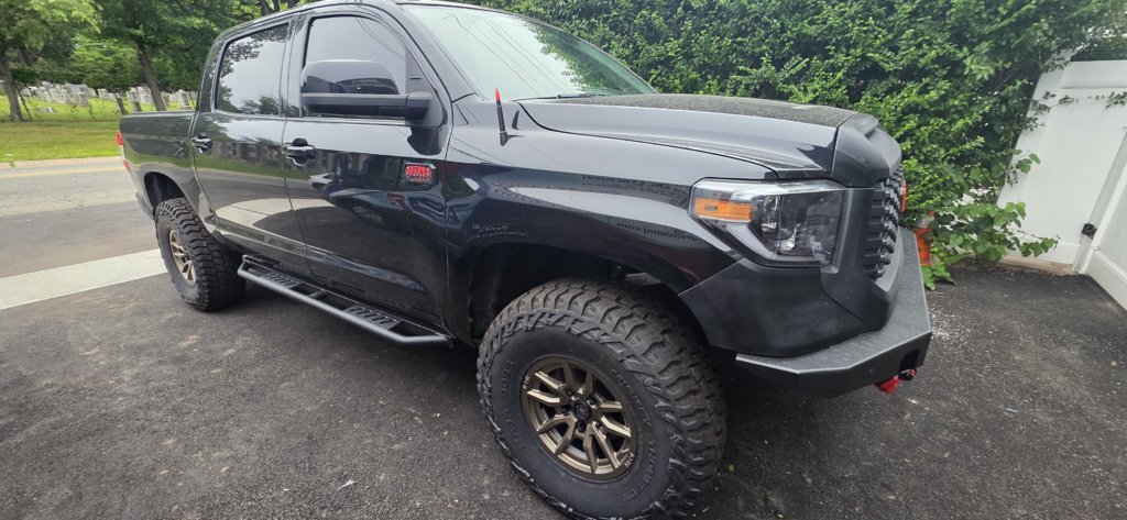

    Went from 35s on 18” SCS SR8 +25 offset (added bora spacers 1.25” effectively making the offset -8).
    Running 37s on 17” RRW rr7-7 +0 offset.
    The wheels were pretty flush with the flares, but didn’t poke as much as I’d prefer….. so i reinstalled the 1.25” spacers, effectively making the offset -32.
    Obviously there’s a ton of rubbing and I will be grinding down on plastics for fitment.
    May not be considered the ideal setup, but I happy to achieve the stance I was aiming for.

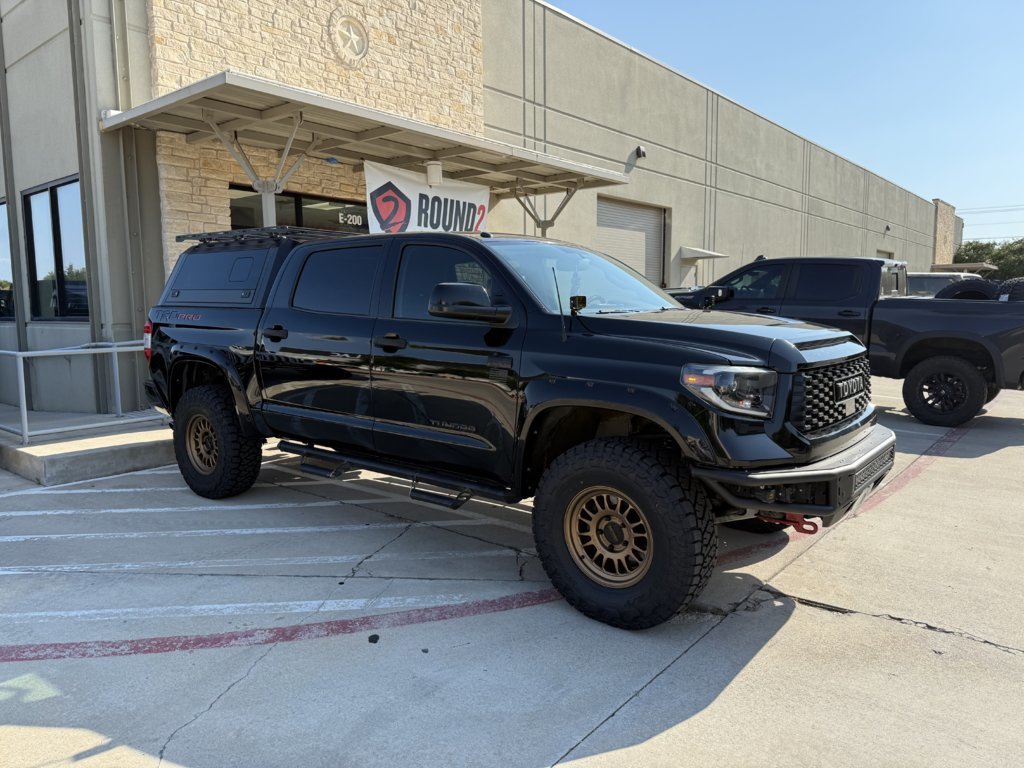

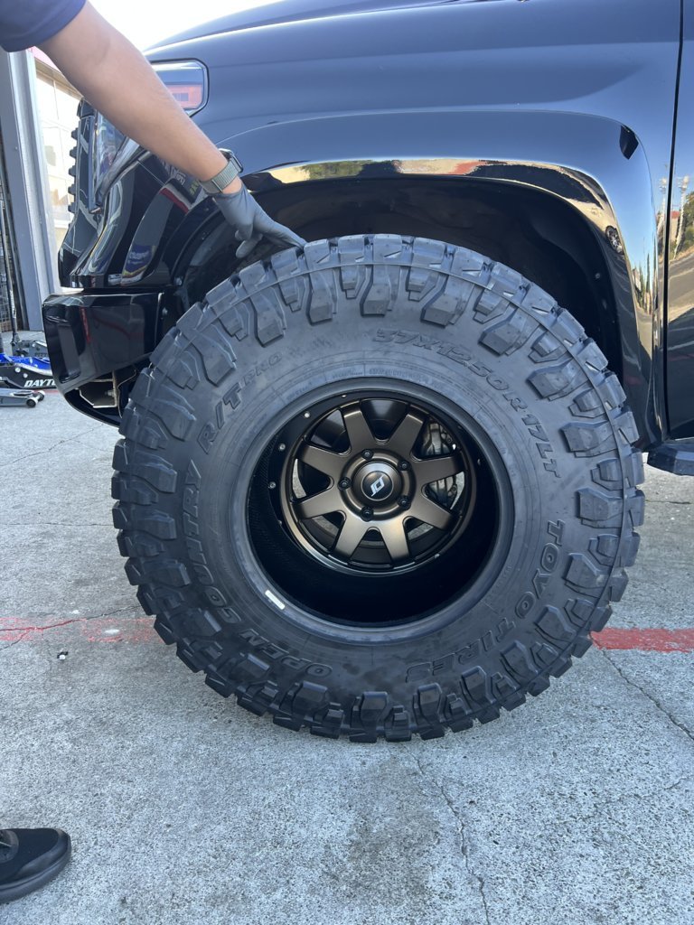

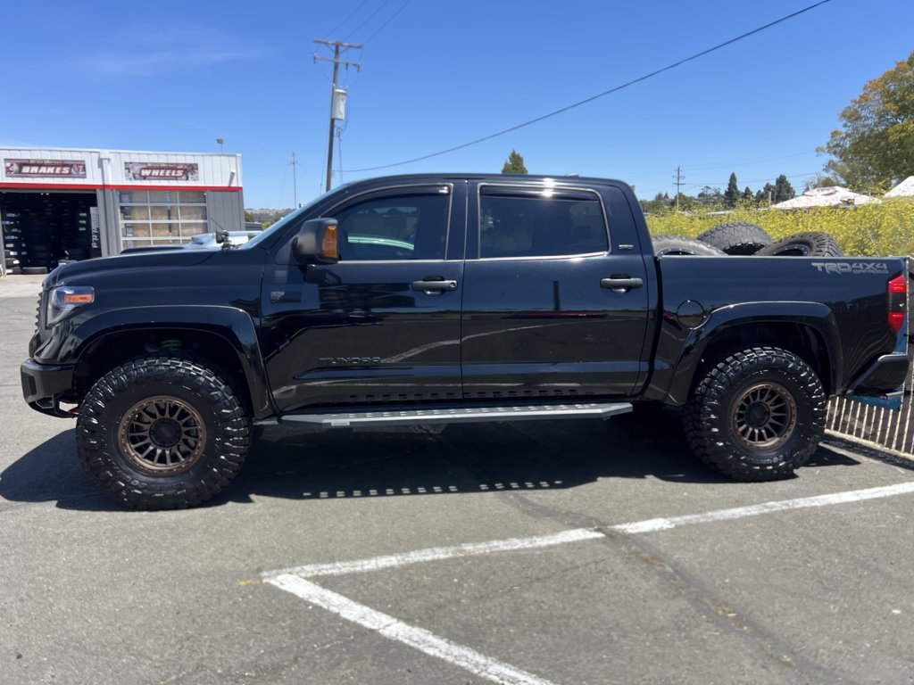

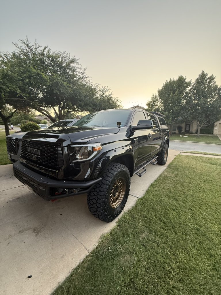

    Just set aside the 35’s and joined the club. Slapped some 37x12.50 Toyos on Method MR318 18X9 5X150 +18
    Thanks to everyone here posting their experiences I have zero rubbing :cheers:

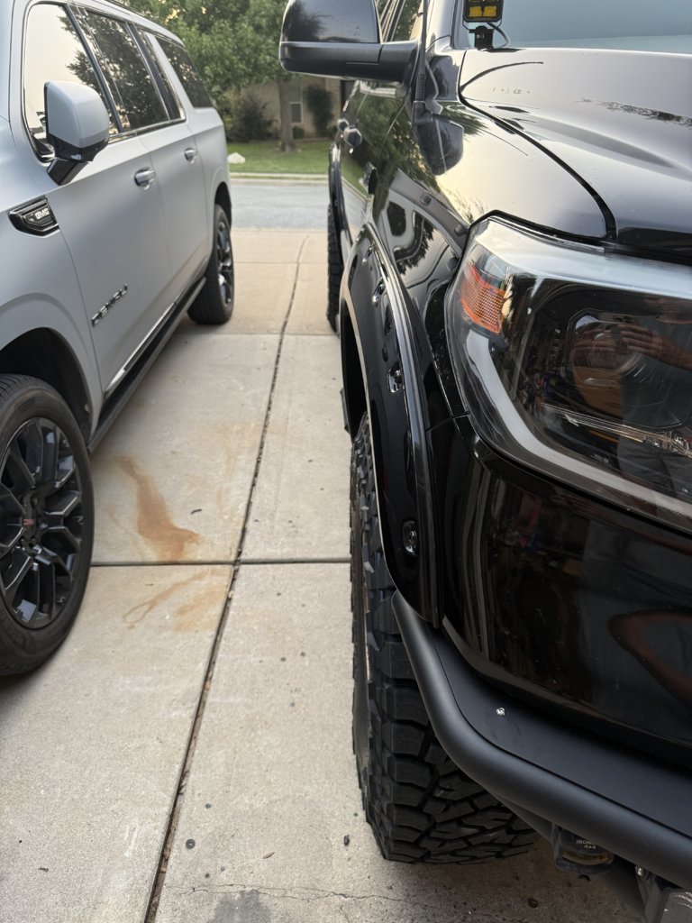

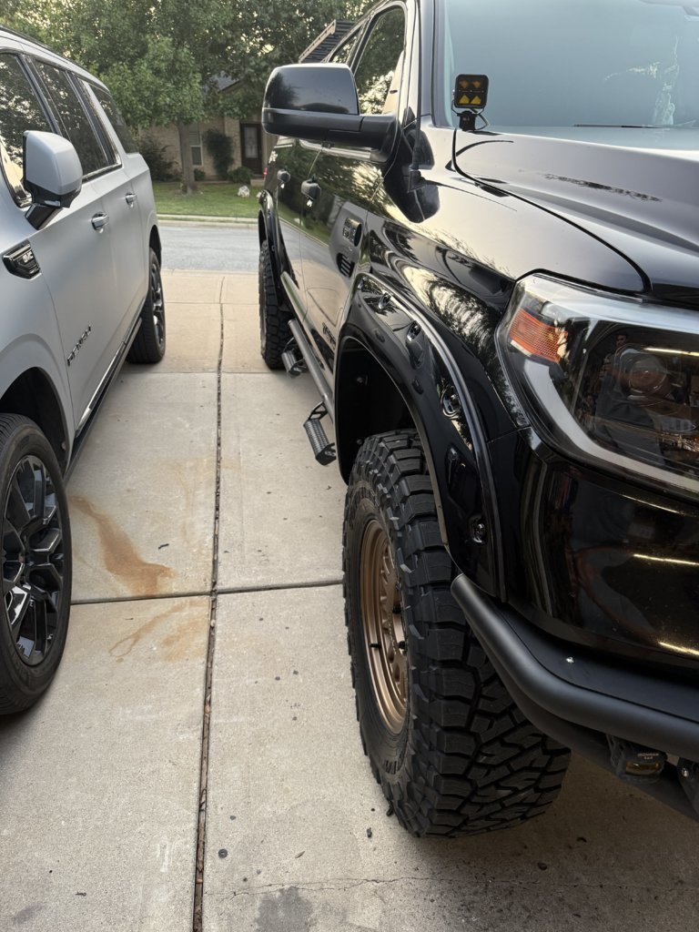

    Looks great! Do you have a front view showing how much the tire pokes out or is it flush with the fender?
  24. Aug 8, 2025 at 6:39 PM
    #3834
    AaronD334
    AaronD334 TX
    Oct 25, 2020
    #54056
    16
    Aaron
    Austin, TX
    2015 Tundra TRD Pro
    Thanks! It’s slightly more narrow than the fenders.
    I have 1.5” spacers that I ran with the 35s and had the shop install the wheels with the spacers out of curiosity. They said they were rubbing the body mount slightly. My plan all along was to ditch the spacers so I’m happy but I may put them back on at some point we’ll see.

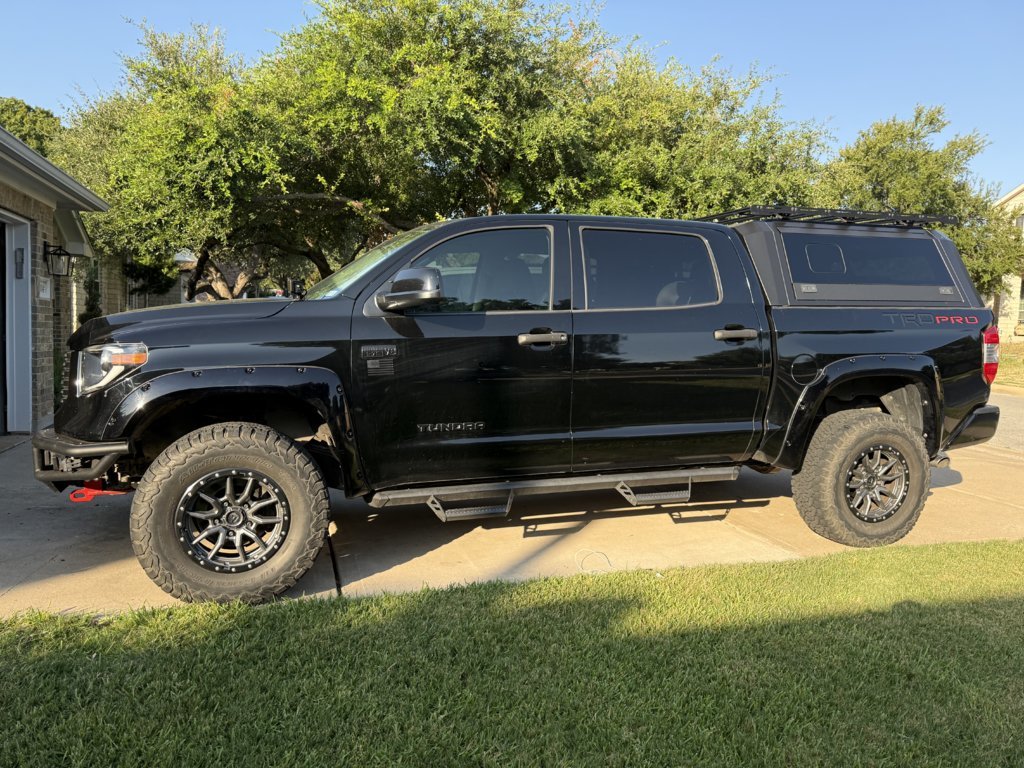

    Good to know. I’m going to try to take it offroad this weekend and see how they tuck and if there’s any rubbing.

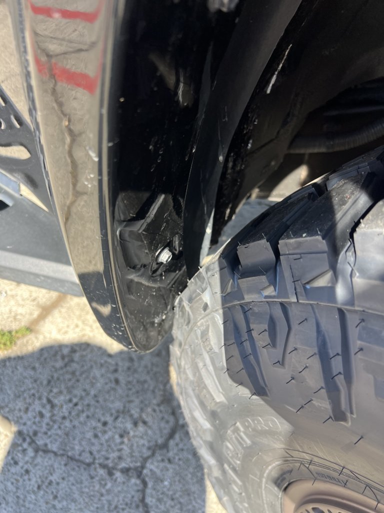

    One thing I just noticed is that the rear wheels seem to be much closer to the rear of the wheel well vs the front so I have a feeling I may rub there. Maybe I installed my leafs springs backwards? :monocle::facepalm:Not sure if it would have that effect.

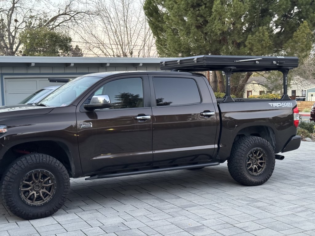

    That looks great.
    I have the exact same set of Fuel wheels as on your truck in the last picture, 18x9 with a +18 offset. I’m curious if you had the same spec. Also wondering if you swapped out the wheels plainly for the looks since you’re on the same +18 offset, and not for potential fitment issues with 37 inch tires.
    I want to pull the trigger on 37s but really thinking it would be pretty tight with potential rubbing on the body mount.

    I swapped the wheels for the bronze look. If I had yours I would keep them! Also, my stock TRD pro fenders flares have bolts so having bolts on the wheels as well just felt a little overkill.
    My fuels were +20 offset. It’s my understanding that keeping the offset between +18 and +25 is the sweet spot. The BMC and SPC UCA are definitely helping.
