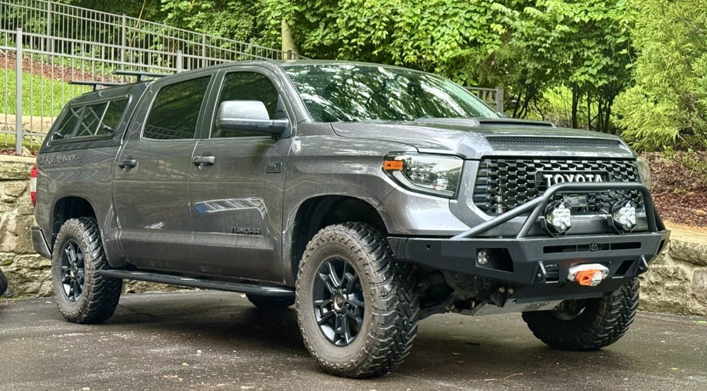

    Thanks! It’s a Rough Country bumper. Definitely not the most boozhy bumper on the market, but it matches well with the look of my camper and gives me a tad more ground clearance on the corners.

    for RC… that’s pretty darn clean!

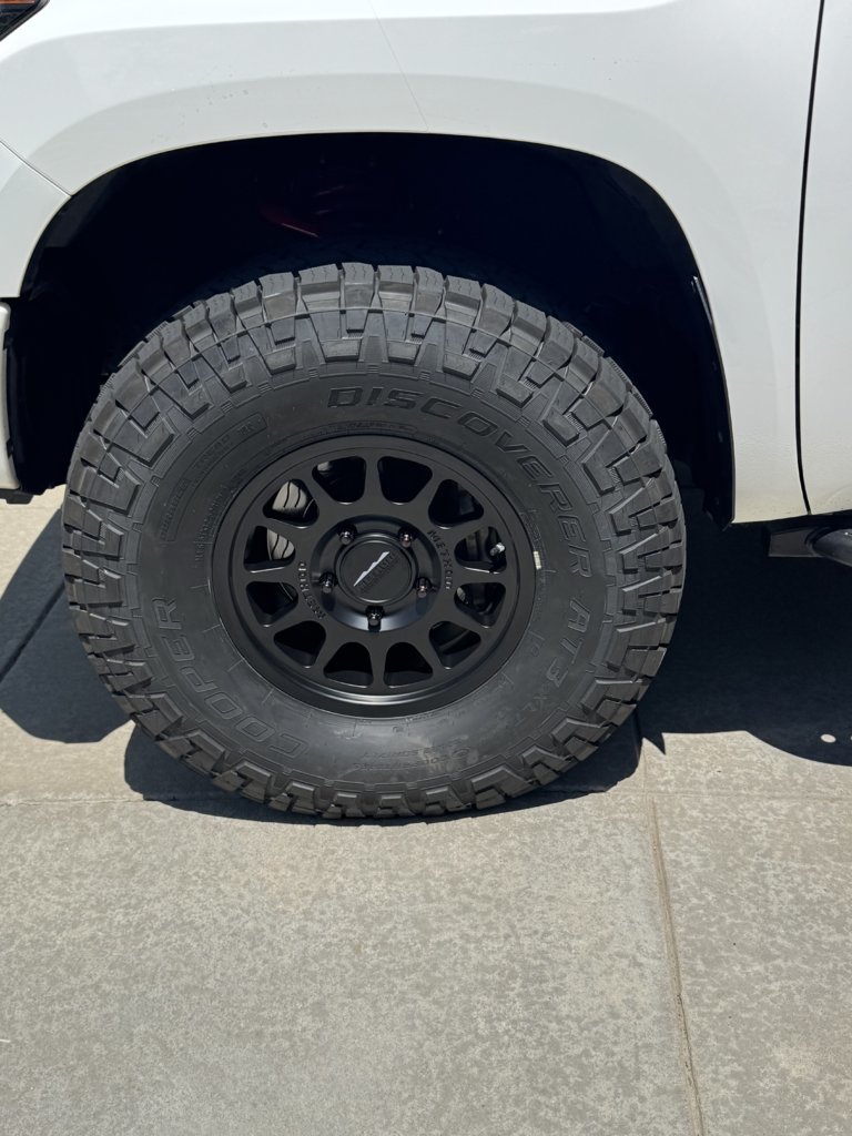

    I have method 701 18x9s +25 backspacing.
    Bmc
    icon billet UCA
    icon 2.5 remote resi shocks. Otherwise stock.
    Im needing new tires. 37x12.50 will fit right?
    (5.29s for gears)
  19. Jun 17, 2025 at 7:32 PM
    #3799
    SAGE63
    Dec 9, 2020
    #55939
    3,709
    San Diego County
    ah yeah... might need to lose the swaybar. If you off road hard and fast you will lose er self clear the fender liner... also fold the pinch weld

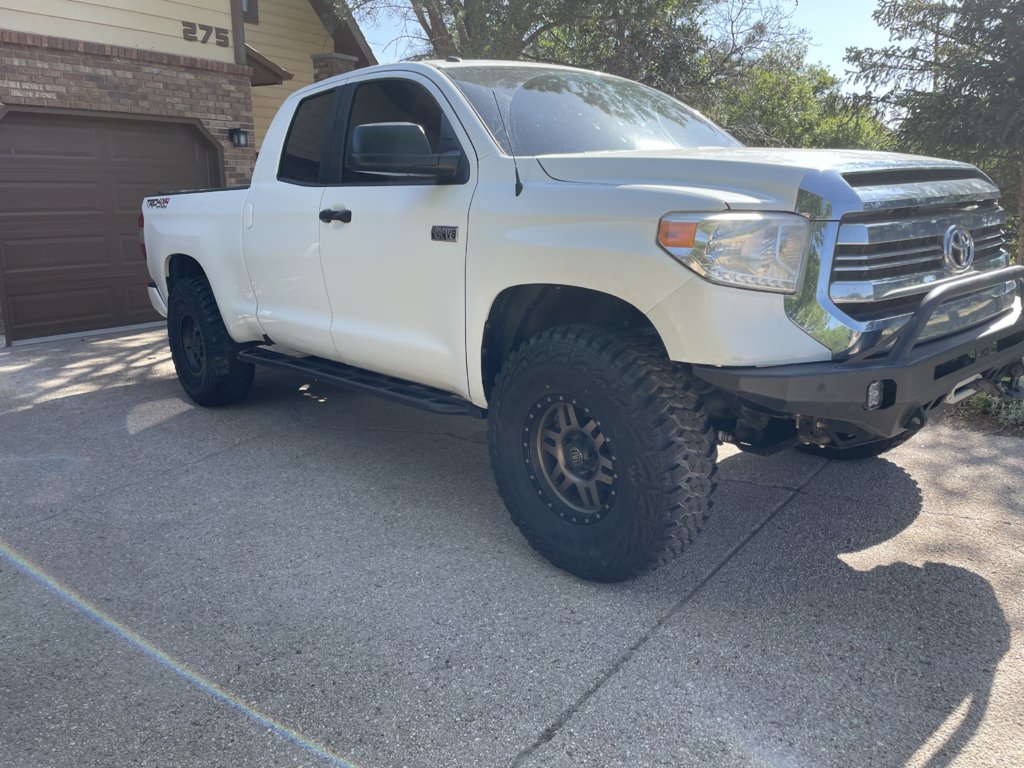

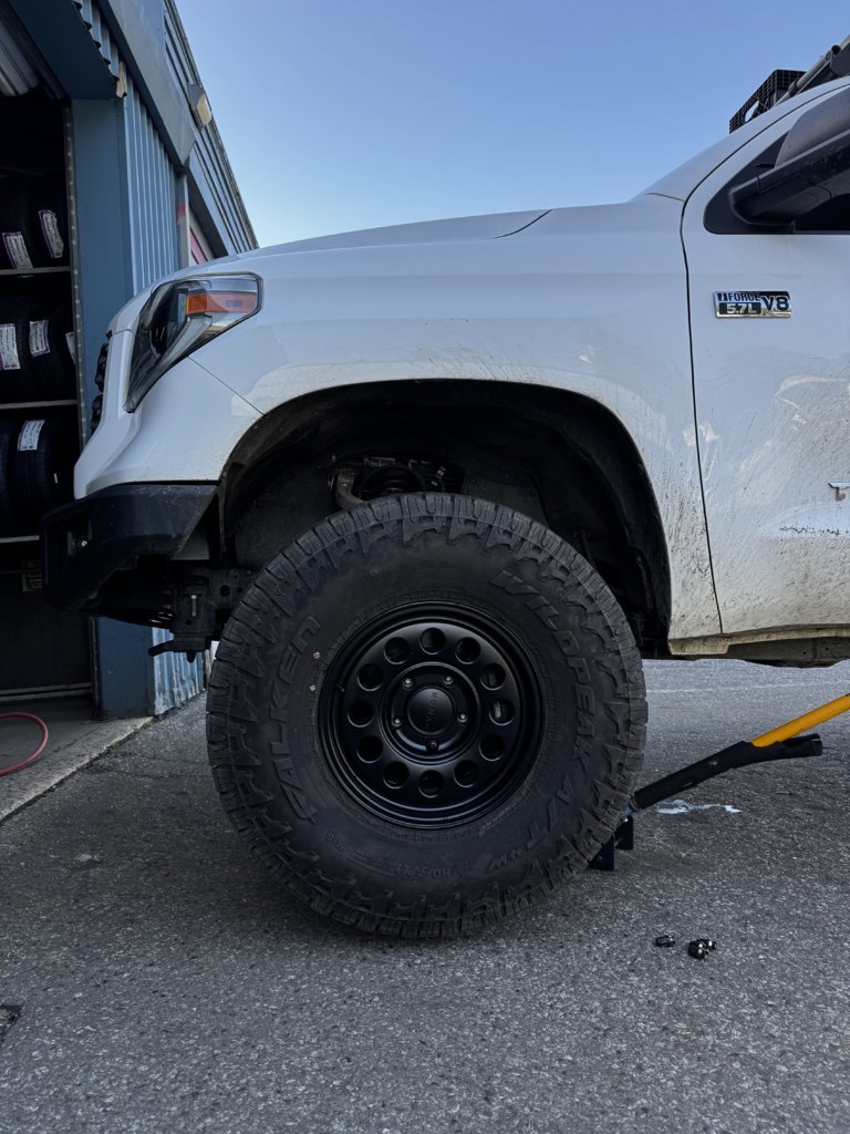

    Got everything mounted yesterday and clearanced last night. Long story short I had to replace pretty much the entire front end, so I was able to get a dead on factory alignment. Excited to get out and see how the truck performs!
    Edit: Wheel and Tire Specs
    Icon Six Speed 17” Wheels
    Kanati Mud Hog 37x12.5R17

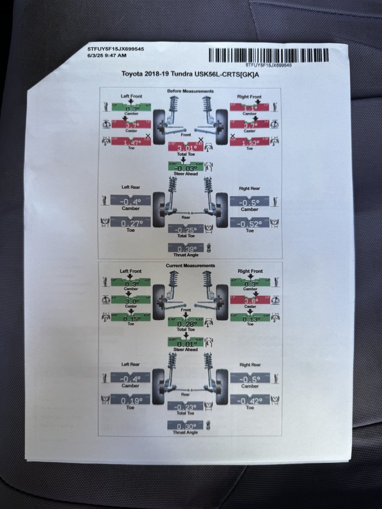

    So i just picked it up from the alignment shop and this is the end result. How does it look?20250630_180748.jpg

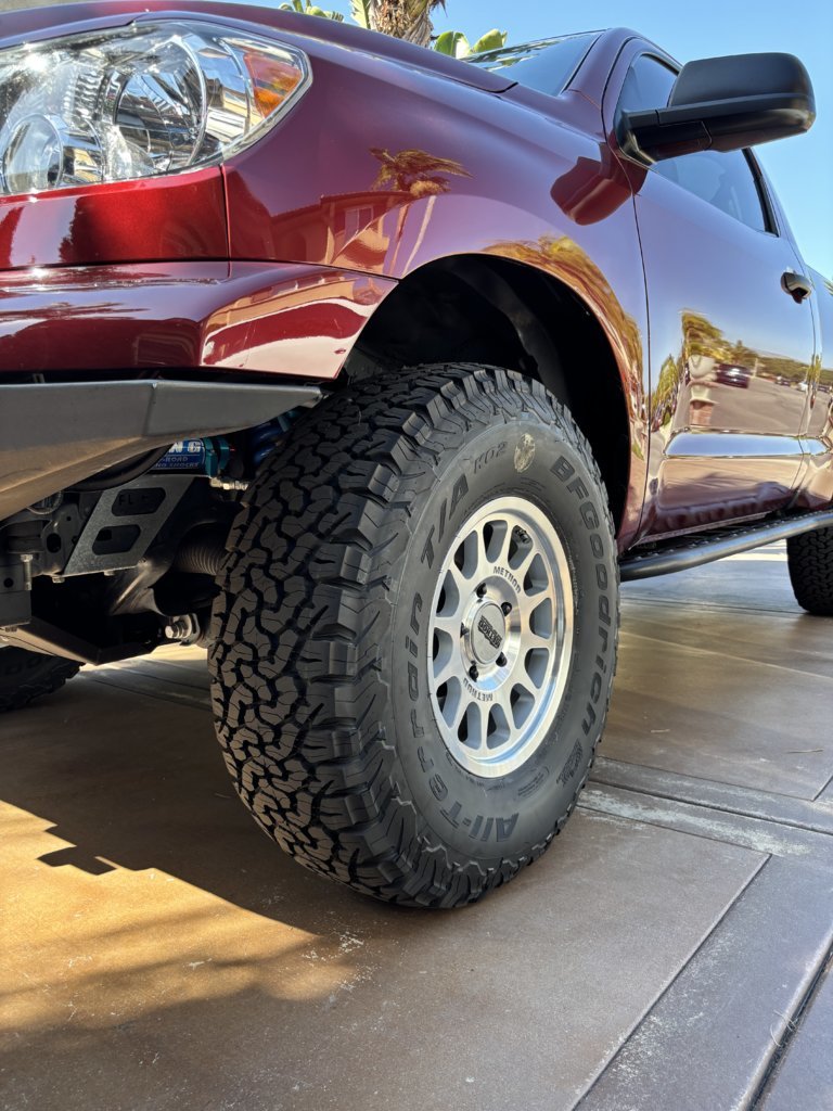

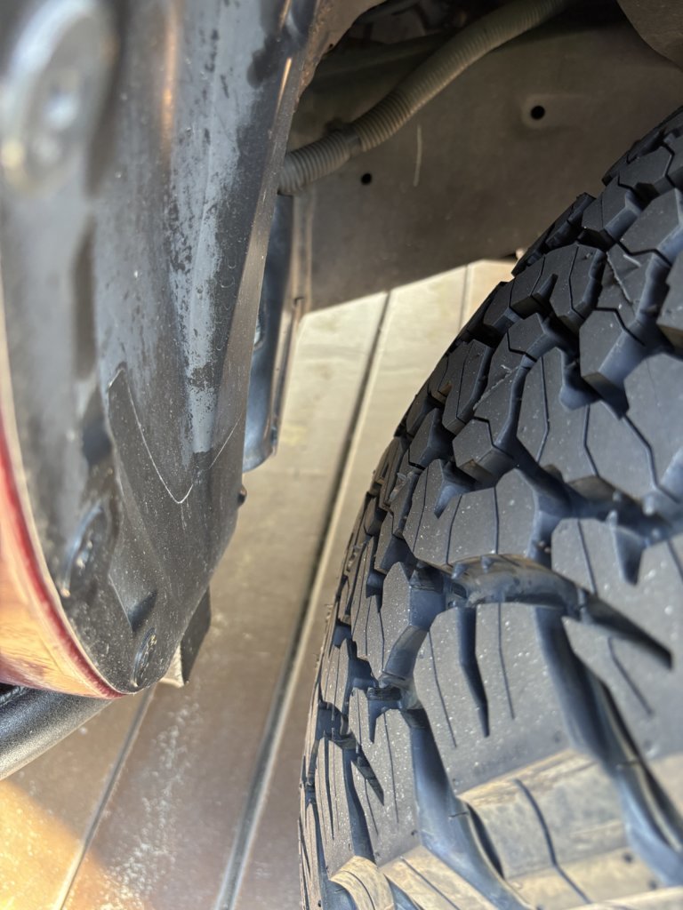

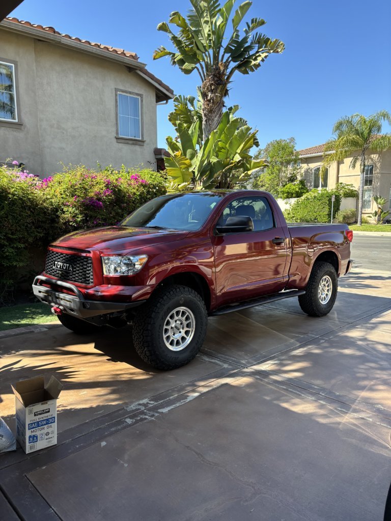

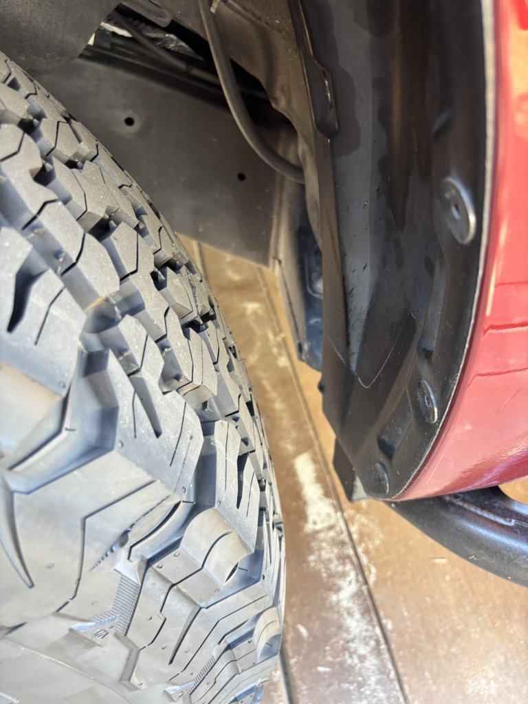

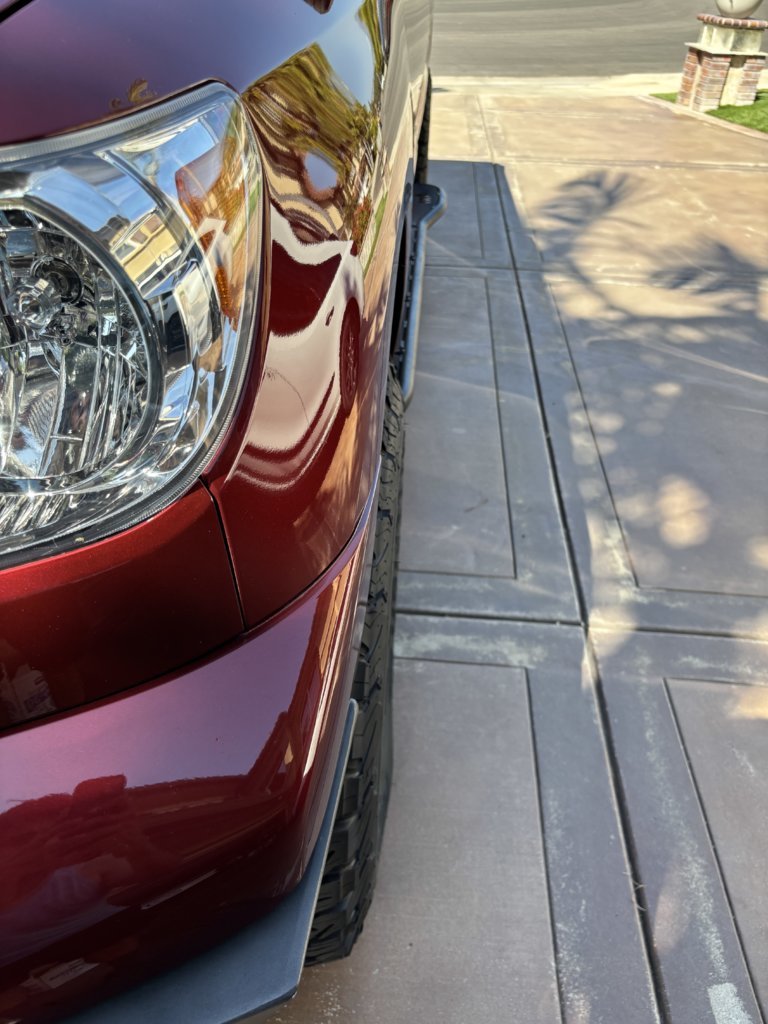

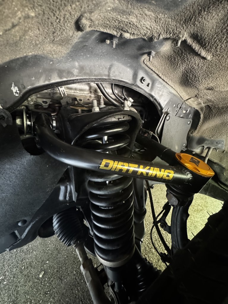

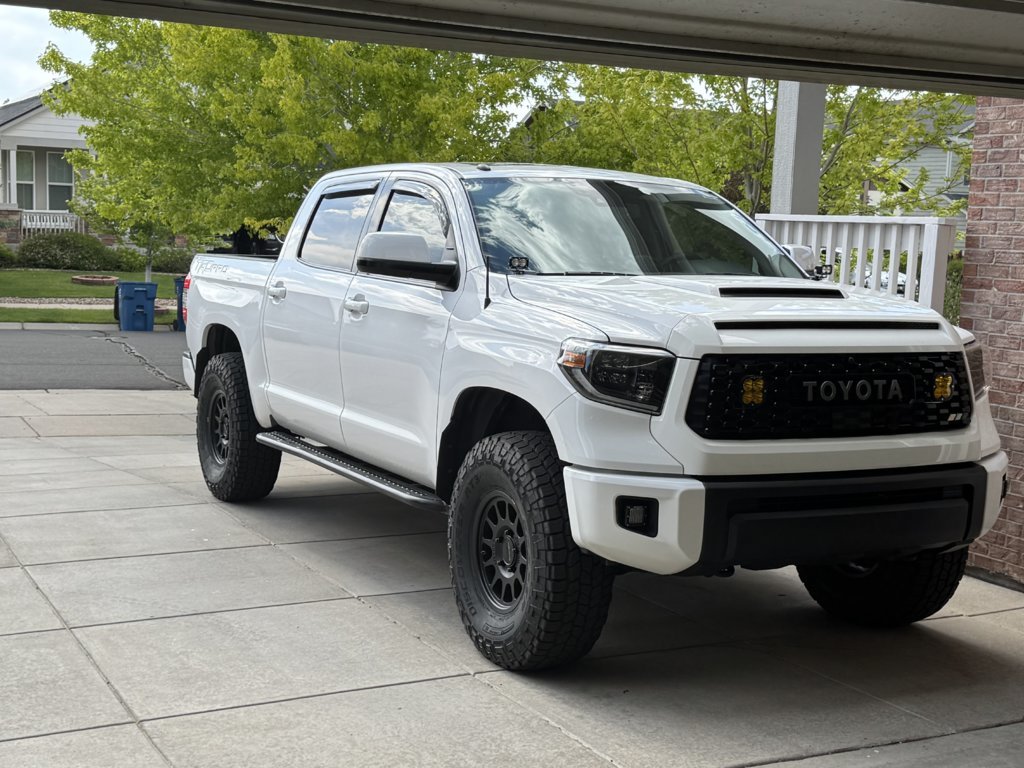

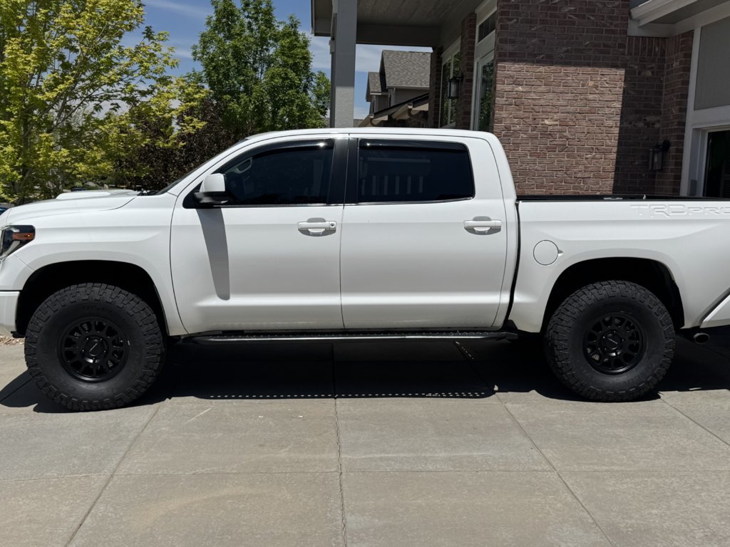

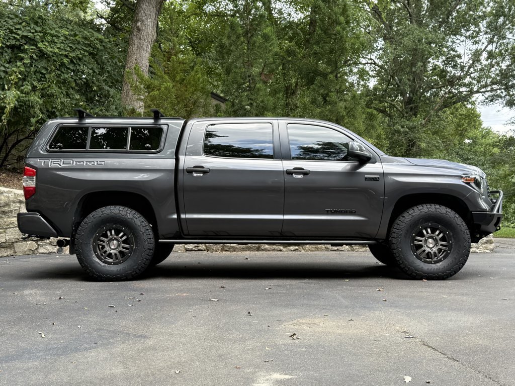

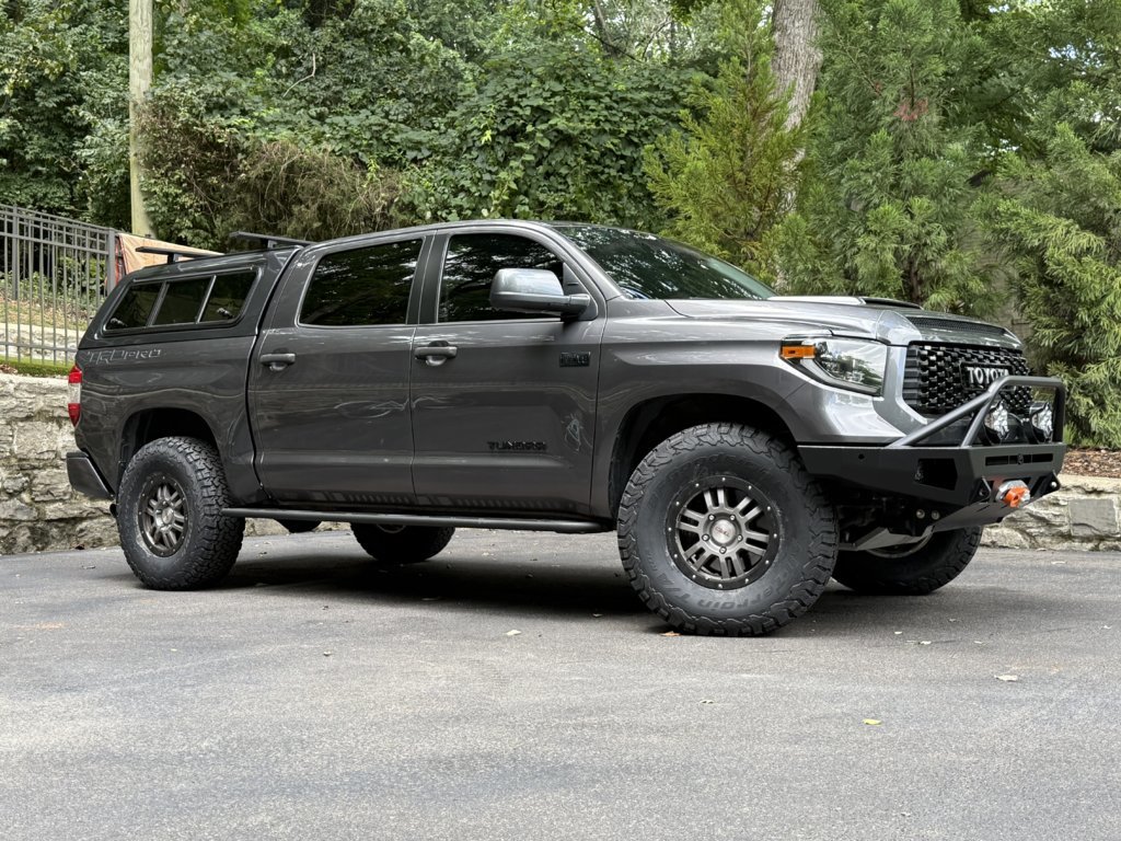

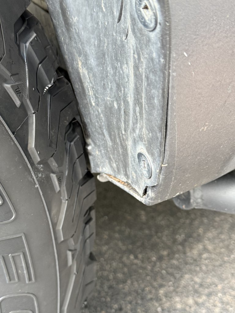

    Joined the club!
    I am slightly rubbing on the driver side metal body. What do yall suggest to fix? Just a proper alignment?

    :sawzall::welder:
    COTundra23[QUOTED] likes this.
  29. Jul 19, 2025 at 3:03 PM
    #3809
    COTundra23
    COTundra23 New Member
    Aug 14, 2019
    #34617
    1,018
    do we think more caster would help?
  30. Jul 19, 2025 at 3:59 PM
    #3810
    BreyTundy
    BreyTundy Big 4Lo Guy
    Sep 4, 2019
    #35600
    1,174
    Andrew
    Colorado Springs
    2016 White DC TRD
    Absolutely, yes. But it may not get you all the way there, there still might some running at full lock and compression. Likely not since the rock warrior wheels are so inset, but you never know until you test it out.
