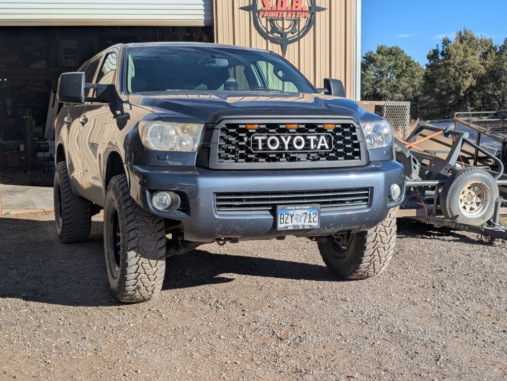

    I've only ran the mud hogs in the past. They aren't great in the rain or snow, but also not terrible. Mine started pretty quiet but as I beat them up they have gotten loud.
    I'm hoping that the new ones in a more hybrid style will wear better and be quieter on the road. They should also be better in the rain and snow but time will tell.

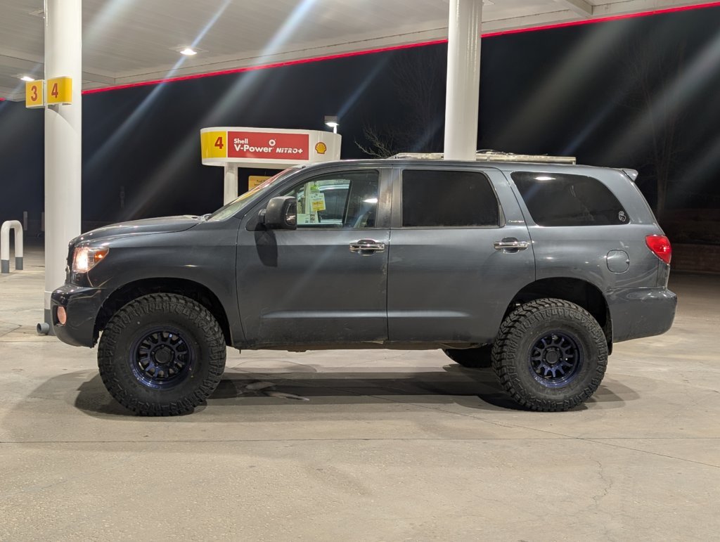

    The sequoia is in the club now.

    Geez that looks so good. Can’t wait to see 39s on it :rofl:

    Haha that's not gonna happen. My wife would kill me for doing that to her car. The 37's make the thing look ridiculous as is.

    How much cutting did this take lol

    Nothing crazy yet, it won't ever be a hard core offroader, mostly forest roads so I shouldn't have to do too much. I have cut the cab mount, hammered the firewall and trimmed the front bumper until I can get the time to build a front bumper for it. No rubbing anywhere as a daily.
