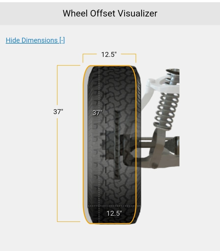

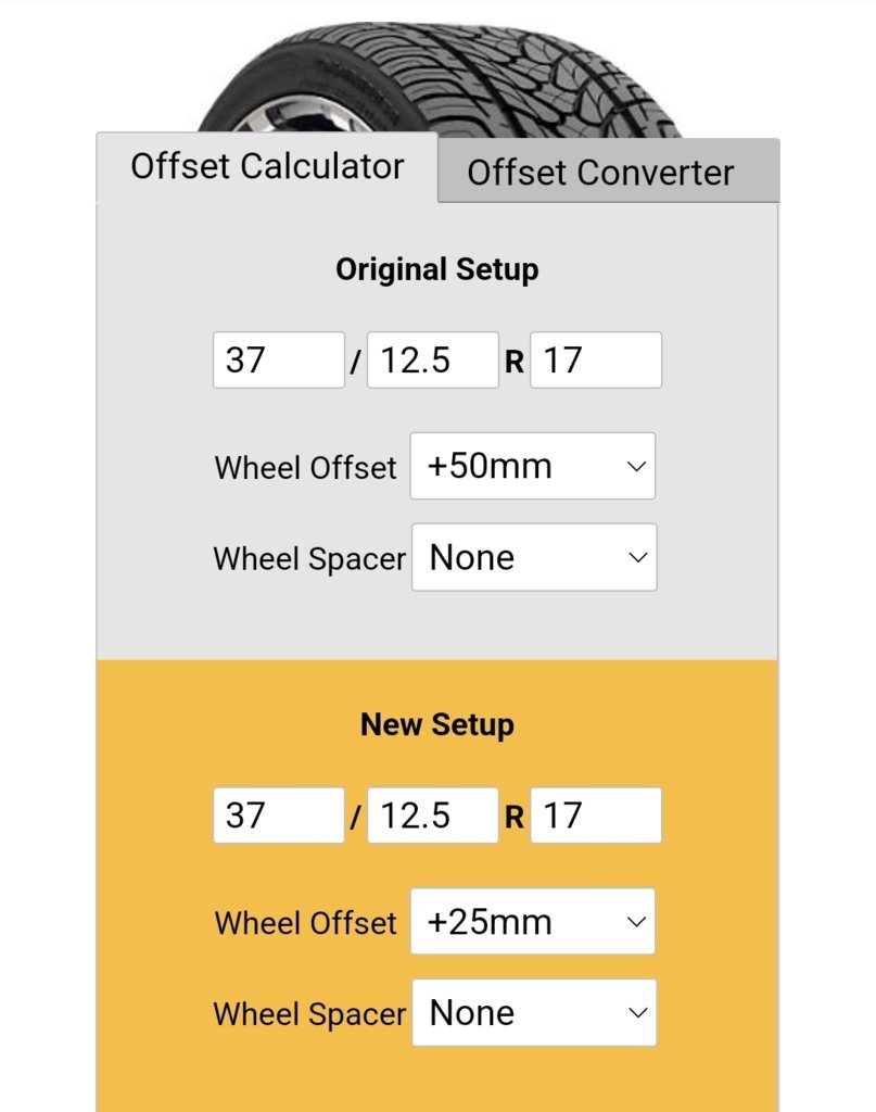

    I'm afraid if I go 37x12.5x17 +50 with RW wheels. It will rub alot
  6. Jan 28, 2025 at 8:54 AM
    #3666
    rcsbguy
    rcsbguy New Member
    Jun 3, 2024
    #117908
    237
    It’ll do the opposite. Given there’s a minimum offset, you can fit a 37” tire easier on a +50mm rock warrior wheel than a +25mm.
    More offset (closer to 0) = more rub. This is true for most cases.

    I thought +50 is closer to the UPC so it will rub against more things then a +25 which is about an 1" father out.

    The UCA? It will clear the UCA, but won’t clear ball joint styles like JBA/SPC if I remember correctly.
    There are things that can happen like rubbing the sway bar or skid plates with a high offset wheel and big tire. But those are manageable and usually in full lock scenarios.
    With +25 or lower, then the cab mount chop / relocation have to be done.
    So many variables: alignment, tire size, etc. But to answer your first question, a 37” will fit easier on a +50 or +35 than a +25, and all are better options than a +0.

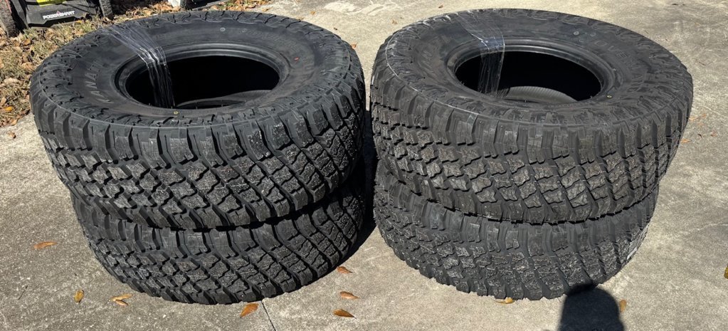

    New set of 37s arrived today:D
    Kanati Overlander RTX 37x12.5r17, actual height is 36.7 and width is 13 so pretty close to true 37s.
    Going to be replacing my old Fury R/T 37x12.5 which were also pretty close to true 37 at 36.8

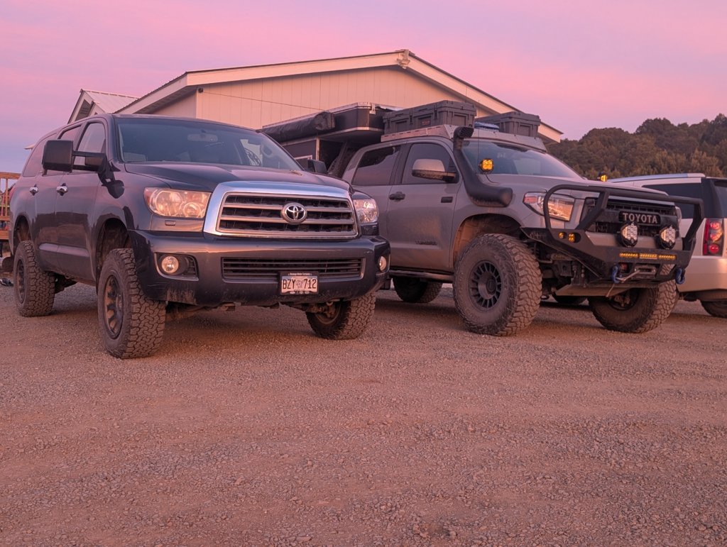

    The sequoia is in the club now.
