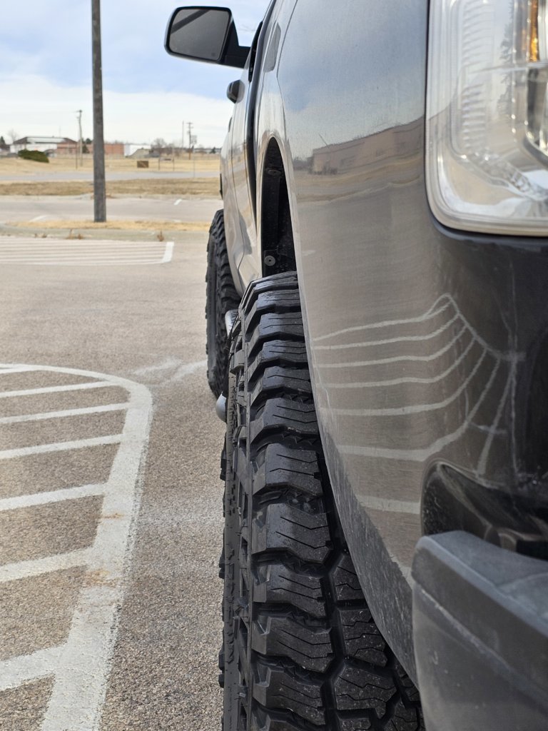

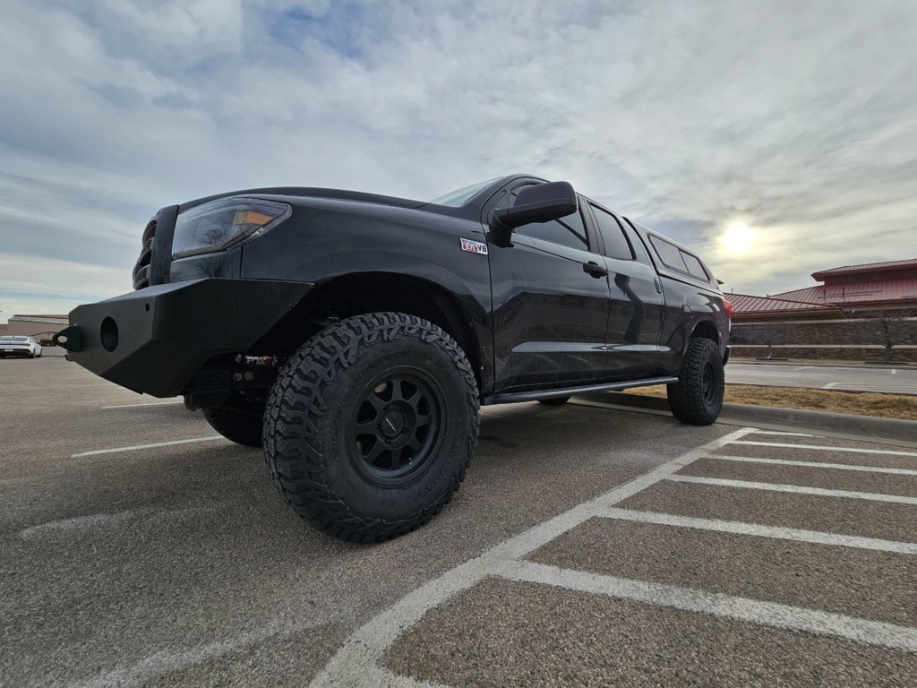

    COTundra23
    COTundra23 New Member
    Aug 14, 2019
    #34617
    979
    Making room….
