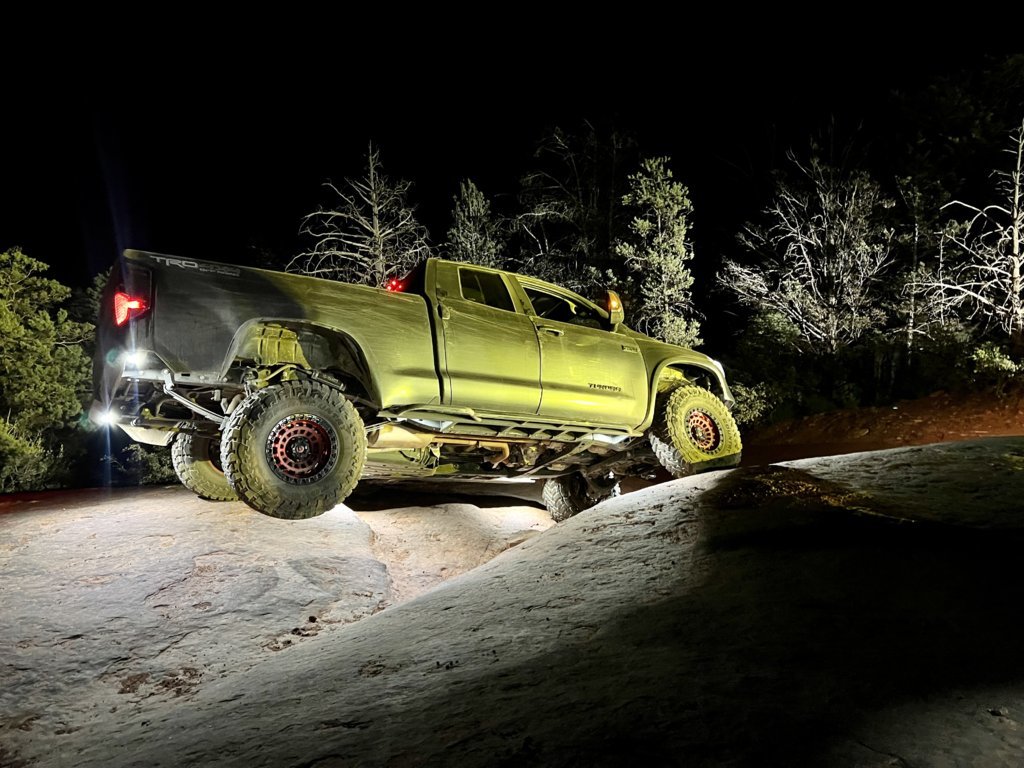

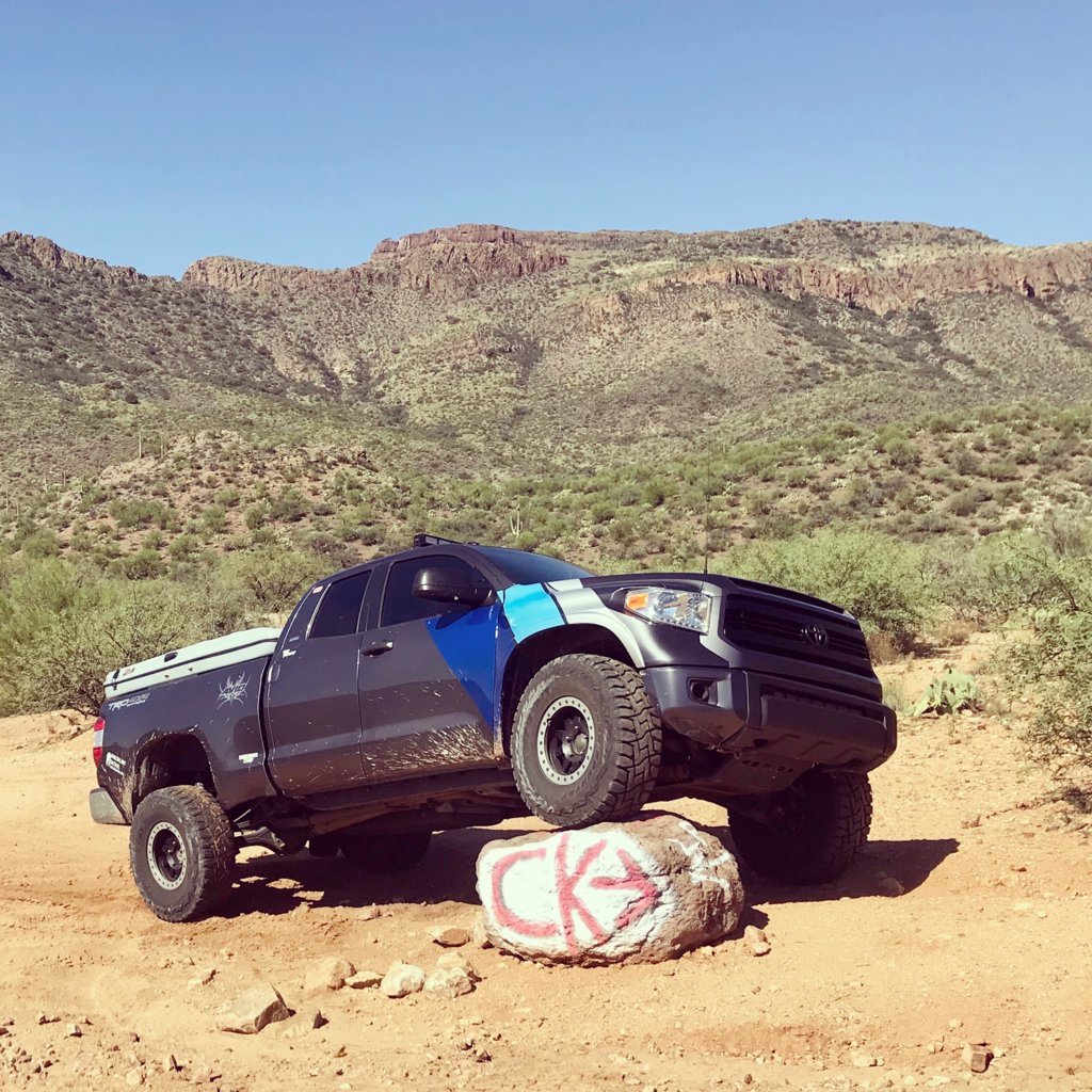

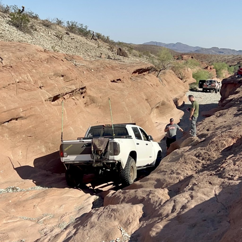

    You’re local to a shitload of us. We can/should get together and you can eyeball the goods before marrying the milk maid or screwing the cow or whatever the fuck the saying is.
    And also yes - you can flex off road and still turn.
    And like @reywcms said, if you’re looking in this thread, the money is already spent. :rofl:

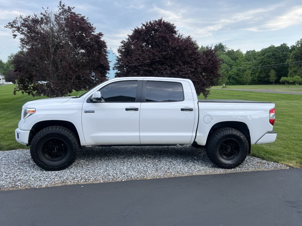

    @bmw345 care to share your lift and what all was needed to make these work? This is exactly what I’m looking to do to mine.
    thanks in advance

    TRD Pro Fox shocks at all four corners, added a .5 coach builder spacer to the fronts for a total of 2.5" of lift. Rear is plus 1" Coach builder shackle only. BMC done and Coach builder bumper spacers also added. Plastic at front of fender well also massaged for another inch or so of clearance. That's it.

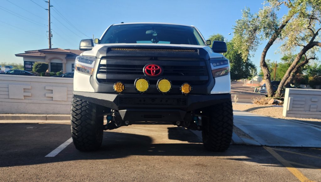

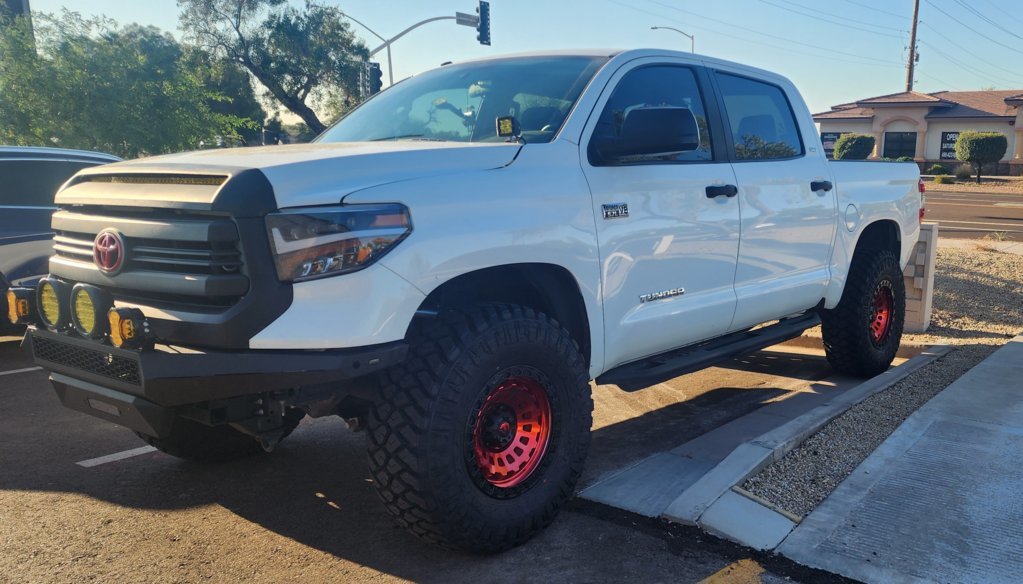

    Officially joined the club! Have some pretty good rubbing but still need to get the alignment done.

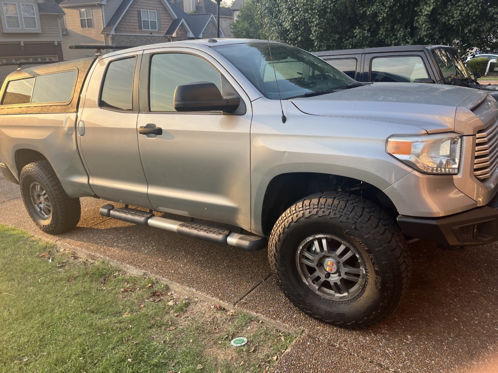

    You running wheel spacers with those RW wheels?

    Yep. 1.25”
