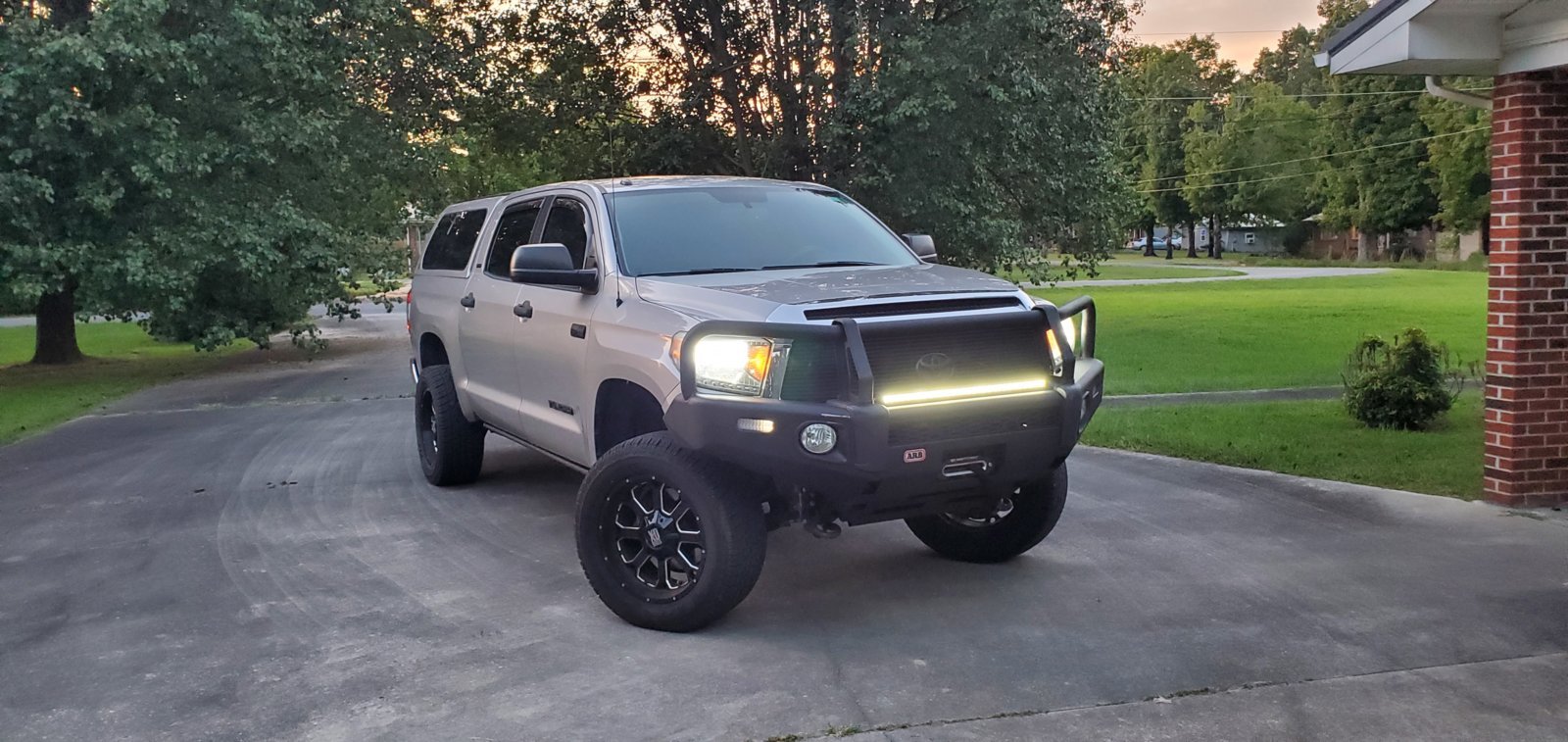

    I need to check my lift sometime.

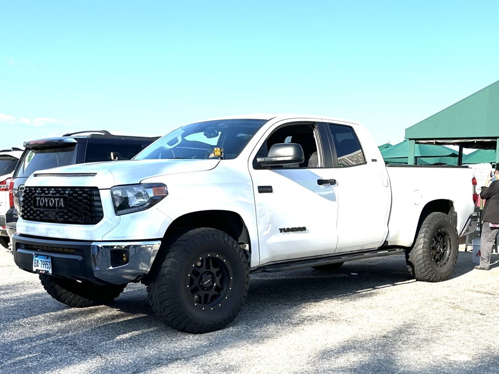

    Anyone running +35mm Method 703s?
  19. Aug 20, 2024 at 1:52 PM
    #3379
    pvn.beluga
    pvn.beluga New Member
    Dec 28, 2020
    #56744
    2,009
    Phuc (Phooc)
    Connecticut
    I think @bmw345 is running +35.
  20. Aug 20, 2024 at 1:59 PM
    #3380
    rcsbguy
    rcsbguy New Member
    Jun 3, 2024
    #117908
    230
    Looks like an easy offset to clear 37s. But doesn’t look like it’ll work if you add in secondary bypasses on midtravel.

    +25 701 r18s fit Mid Travel 2.5 secondaries
    coTony and rcsbguy[QUOTED] like this.

    Yeah but 18s…I’m a 17 guy haha! I do have a few +25mm options in a 17”.

    Adding secondary’s would require you to add an additional shock hoop anyway. At that point, I’d assume you’re doing everything you can to gain max up travel/down travel to clear your tires.
    Why limit yourself to an “easy” to fit offset?

    Keep in mind that most 17” wheels are 8.5” wide, while the 18s are more likely 9” wide.
    The only reason that matters is because it changes the relationship between offset and backspacing. Look at an online wheel offset comparison tool to see what this means, but the backspacing difference (which is what affects clearance to UCA) between a +25 18” wheel and a +35 17” wheel is NOT 10mm.
    KevinK and rcsbguy[QUOTED] like this.

    I just looked it up. An 8.5” wide wheel with +35mm offset will sit only 4mm CLOSER to the UCA than a 9” wide +25mm offset wheel. Less than 1/4” difference on the backspacing.
    It’s the outer edge where you’re gonna see the difference. The 8.5” wide +35mm wheel will have 16mm LESS poke than the 9” wide +25mm wheel. This means more clearance for the fender well, body mount, and back side of the bumper. Quite a bit more…

    I like my tire tucked in under the fender, and easy to fit = less BS to deal with.
