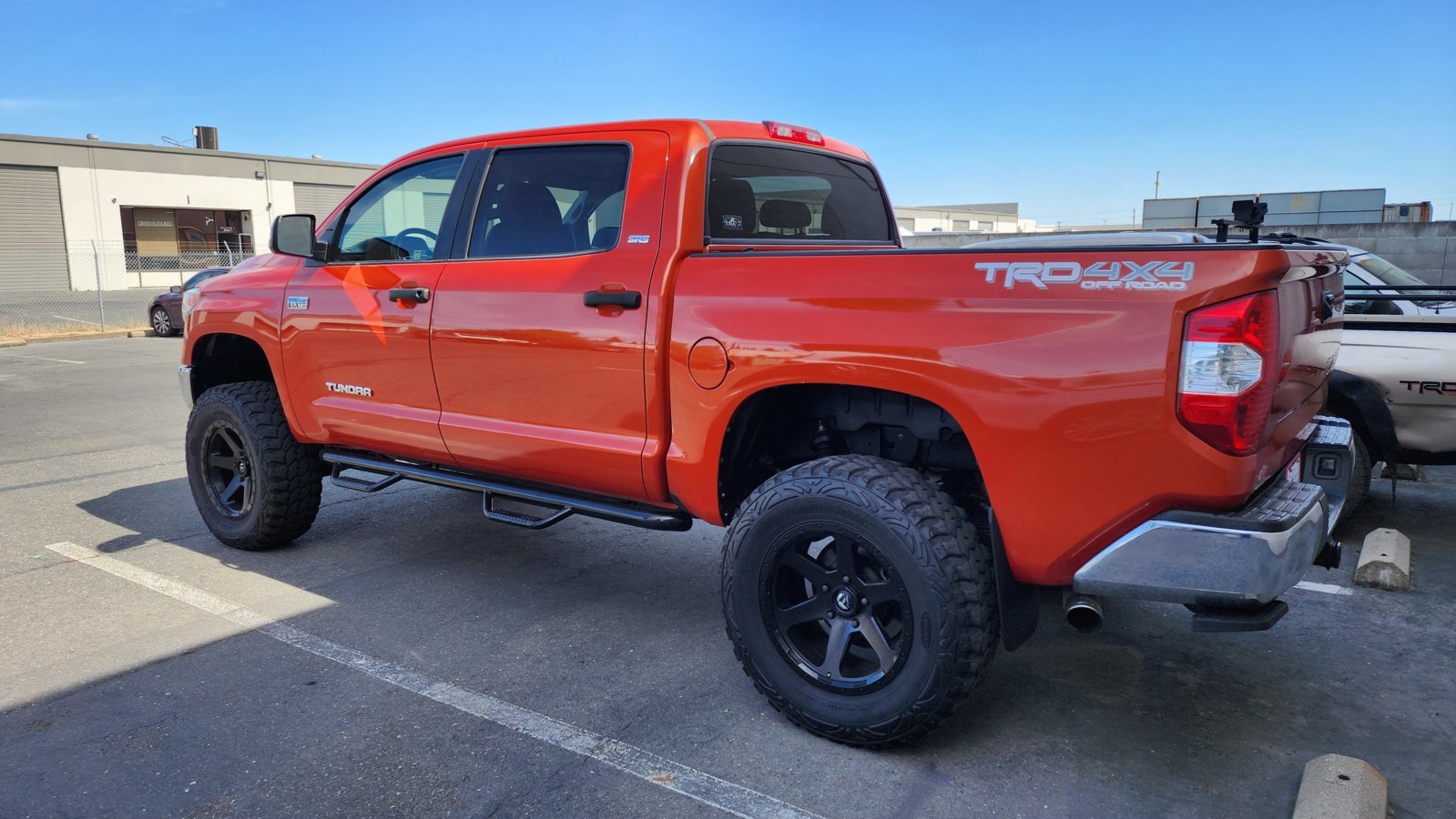

    2017 lifted and supercharged
    My 2017 inferno orange on 37/12.5/20

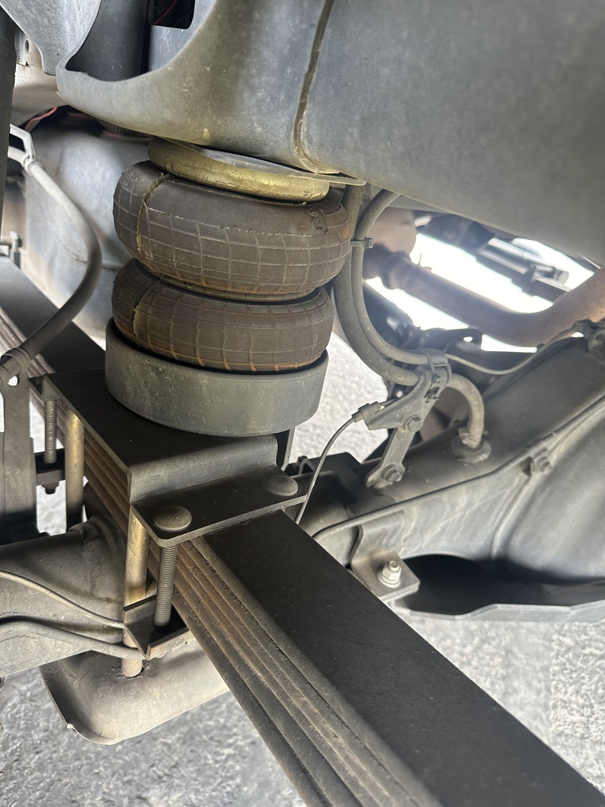

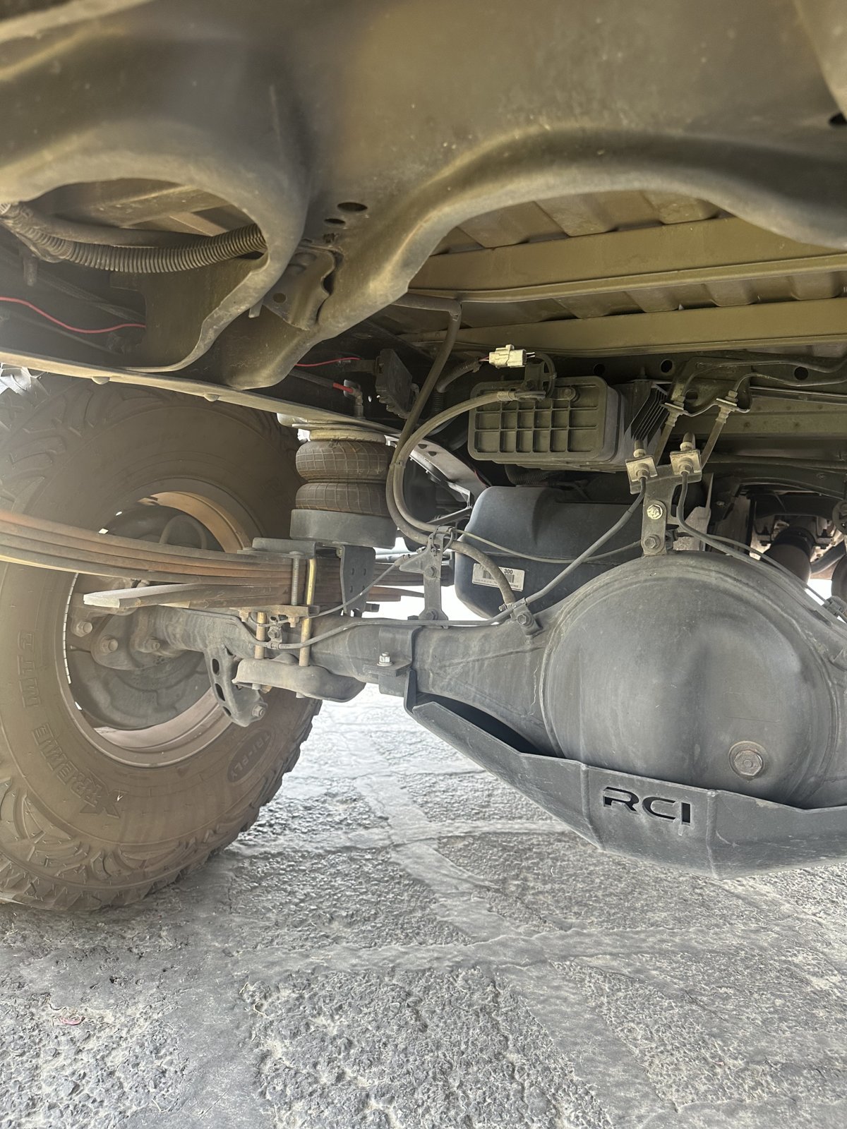

    I've been happy with my deavers with air bags/daystar cradles. Rides nice with 10 psi and tows great with 60ish psi

    can you share pics/details of your setup please?

    Sure thing.
