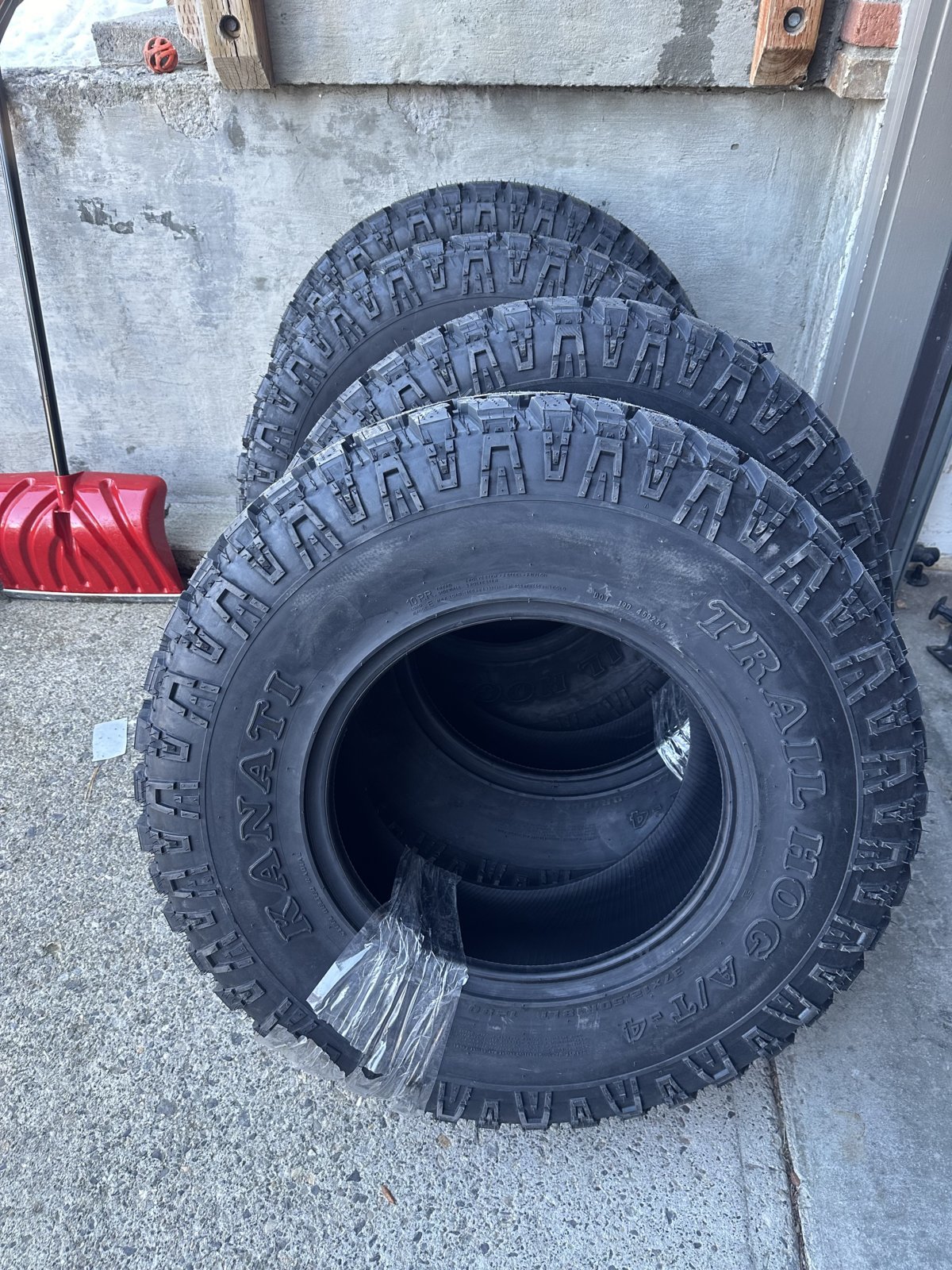

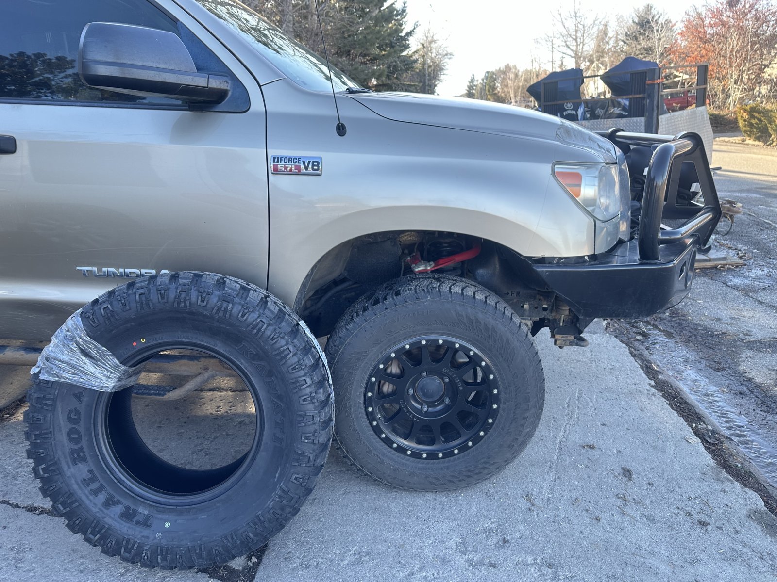

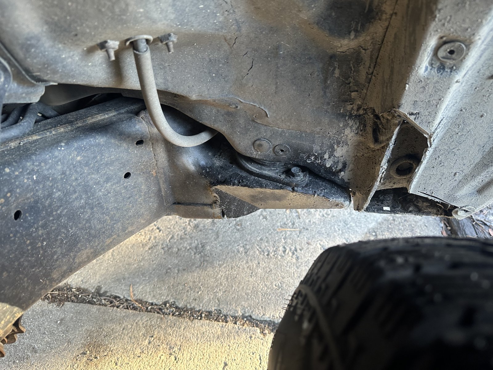

    New meats have arrived! DIY BMC already knocked out.

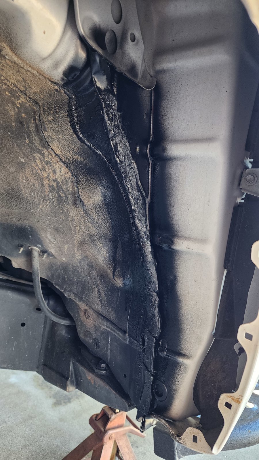

    Did you hammer it over? Or cut and weld?

    I ground the lower 5” of the pinch weld with the right angle in addition to doing a BMC plate and cutting about 1.5” off the lower body panel beneath the pinch weld. I’ve seen some folks get away with only a BMC and not address the pinch, while others grinding the pinch down at least 1’ up the wheel well. I’ll find out soon enough what’s needed for the 36.5” trail hogs…

    I hammered over the upper portion for the 37s... the lower portion was done along with the BMC. It was all that was needed for the 295s

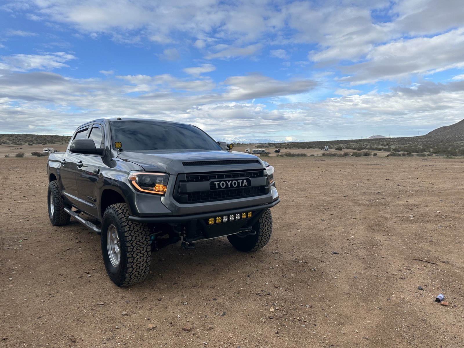

    Here is my setup, King 2.5 all around, camburg uniball UCA, ADD bumpers, fuel 17x8.5 10+ with 37x12.5-17 KO2, BMC and lower pinch weld taken care of.

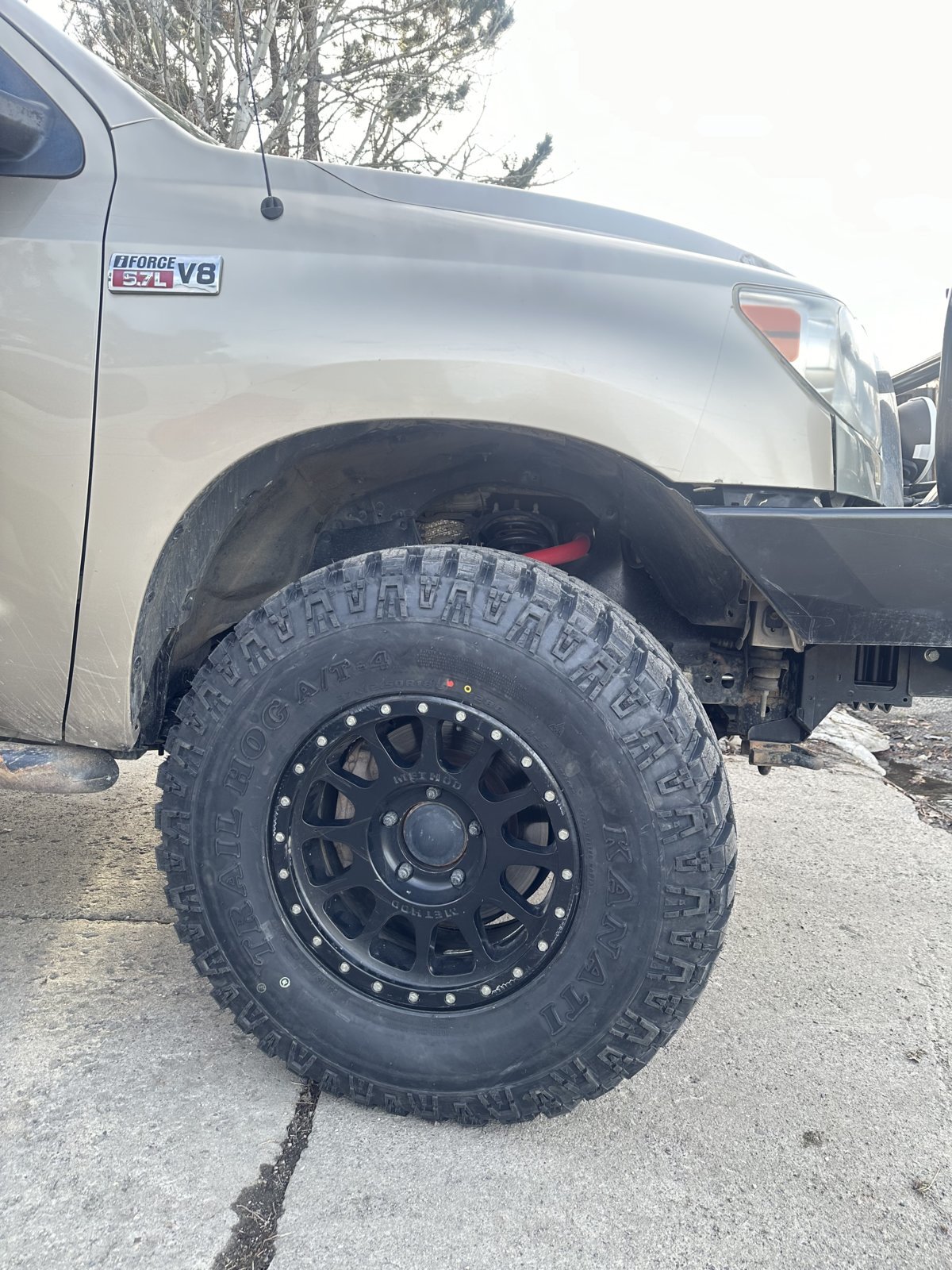

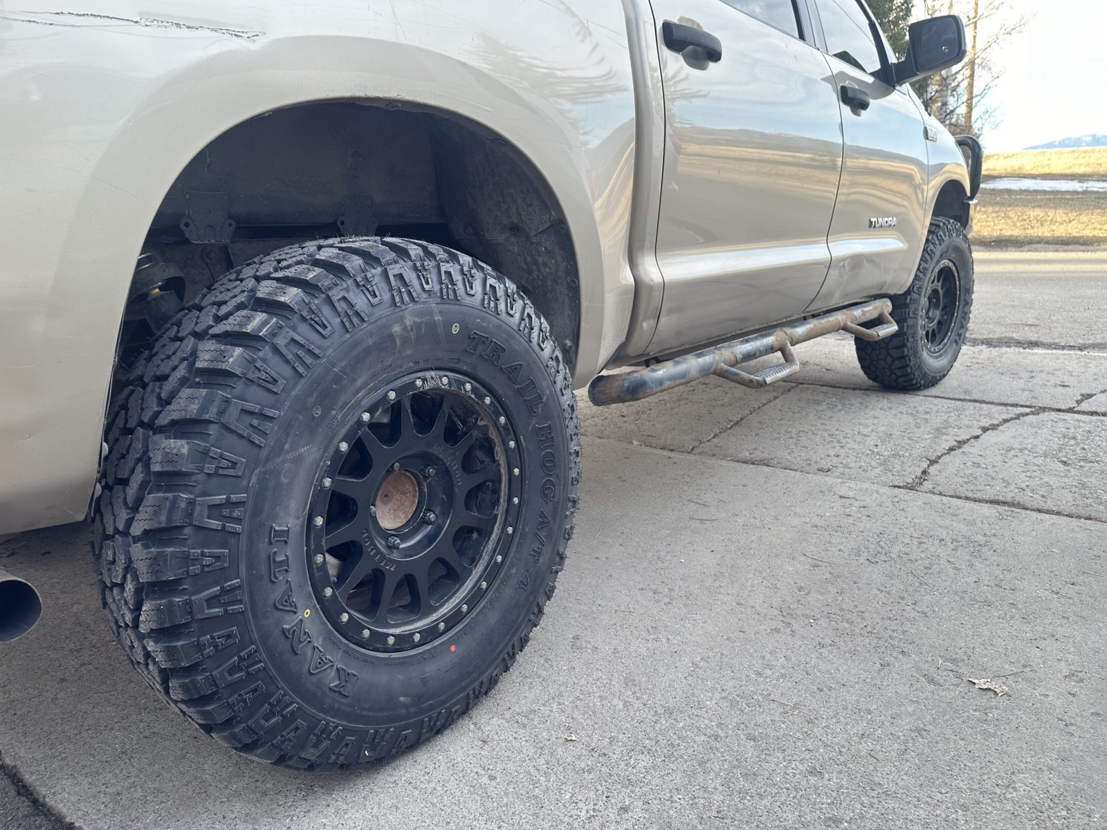

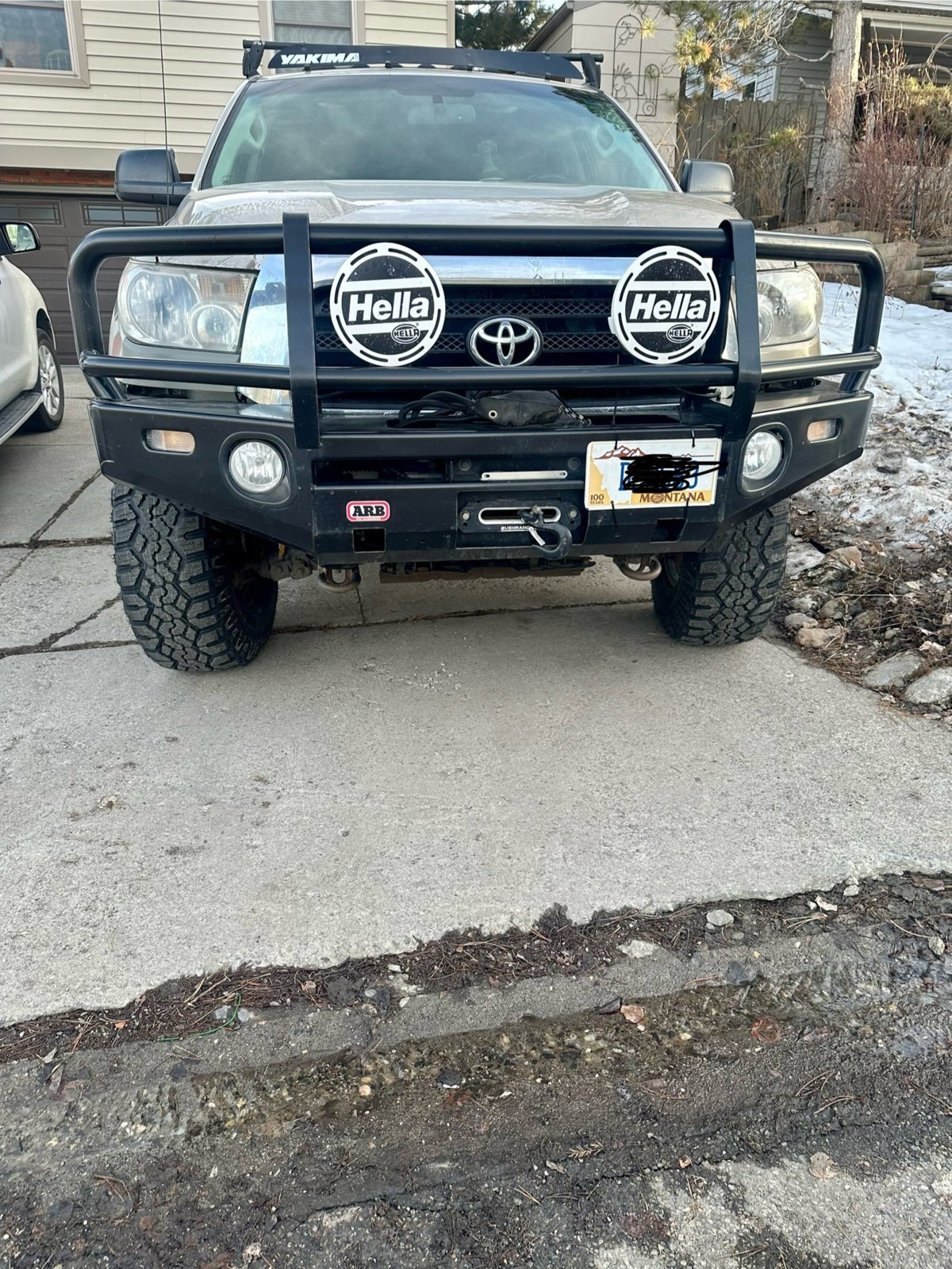

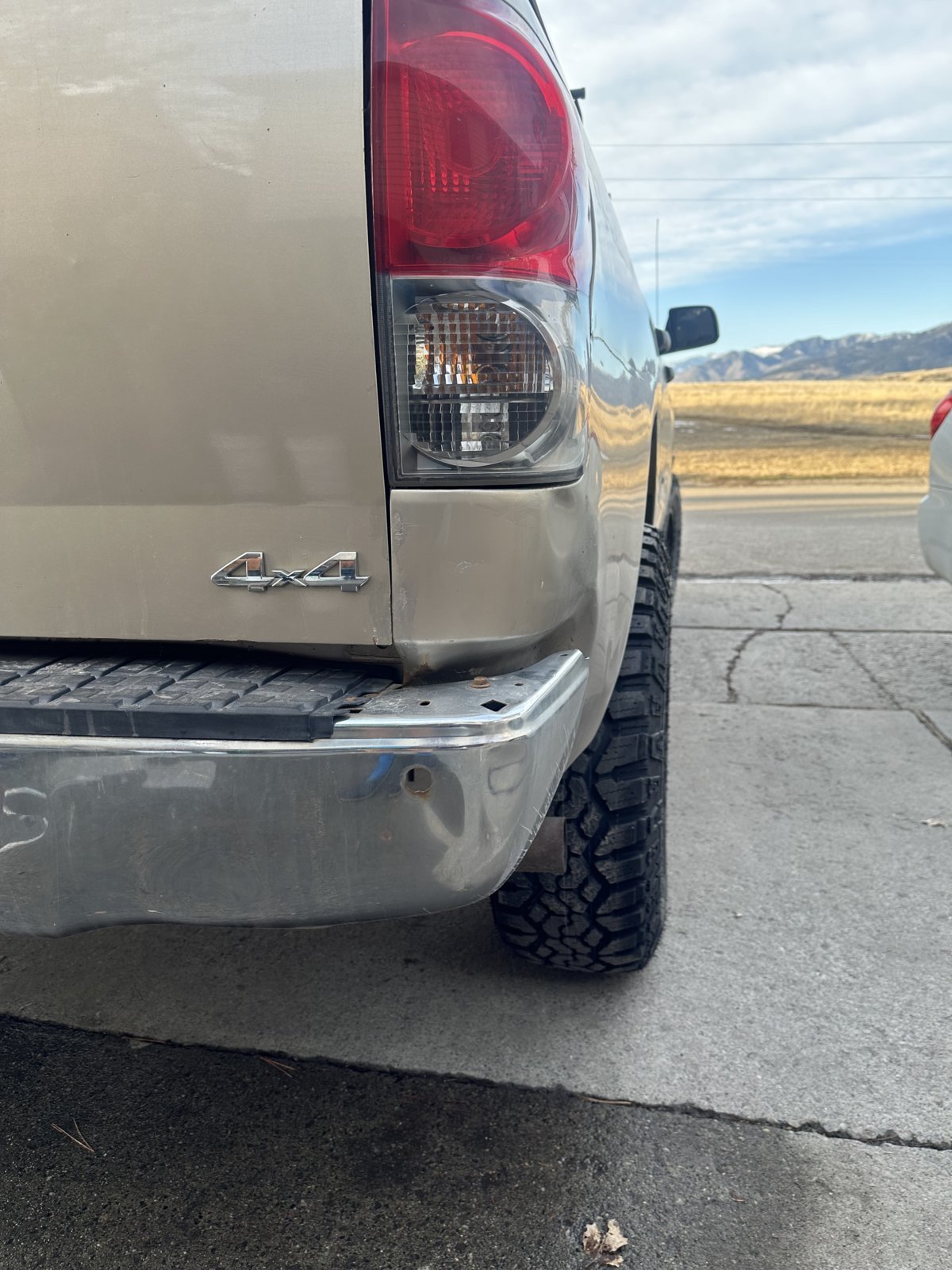

    New shoes on, and FSB now off.
    +25, coachbuilder tie rods, JBA UCAs, OME 613, Dakar leaf, coachbuilder shackles, BMC and mild pinch weld mod, 37x12.5r18

    Nice!
    Always been a fan of the arb bumpers. How did the tie rod install go? I plan on doing the same.

    Straightforward install, no problems about 2 years later. Be sure you have offset wheels per CB advisio.
