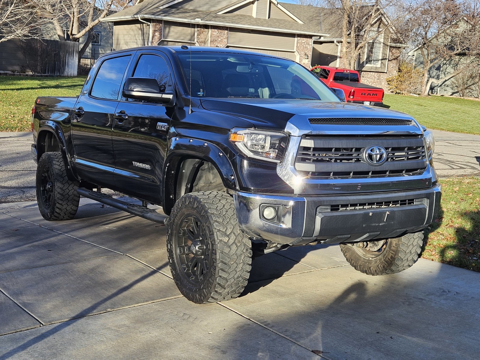

    I am excited to announce that as of tomorrow, I will officially be part of the dirty sevens club! I will be dropping off the truck at discount tire for some 37x12.5r20 Nitto Trail Grapplers. They are installing new sensors as well since 1 is bad. The stats on my truck are 6" BDS lift with Fox coils and shocks. It's running on 20x9 with a 0mm offset. I'll be doing the BMC shortly after, just waiting to see how much and what I'll have too trim! I'll post pictures once I get it out of the shop, also some now in its current set up, bald 35x12.5r20 Nittos".
  20. Jan 17, 2024 at 6:27 PM
    #3200
    CaptRussia253

    28
    2014 Black Tundra TSS SC 4x4
    6" BDS Lift Fox Coils and shocks 35x12.5r20 nittos
    Thanks! I am excited. Kind of like a kid on Christmas eve night that can't go to sleep hahaha
    CaptRussia253[QUOTED] likes this.

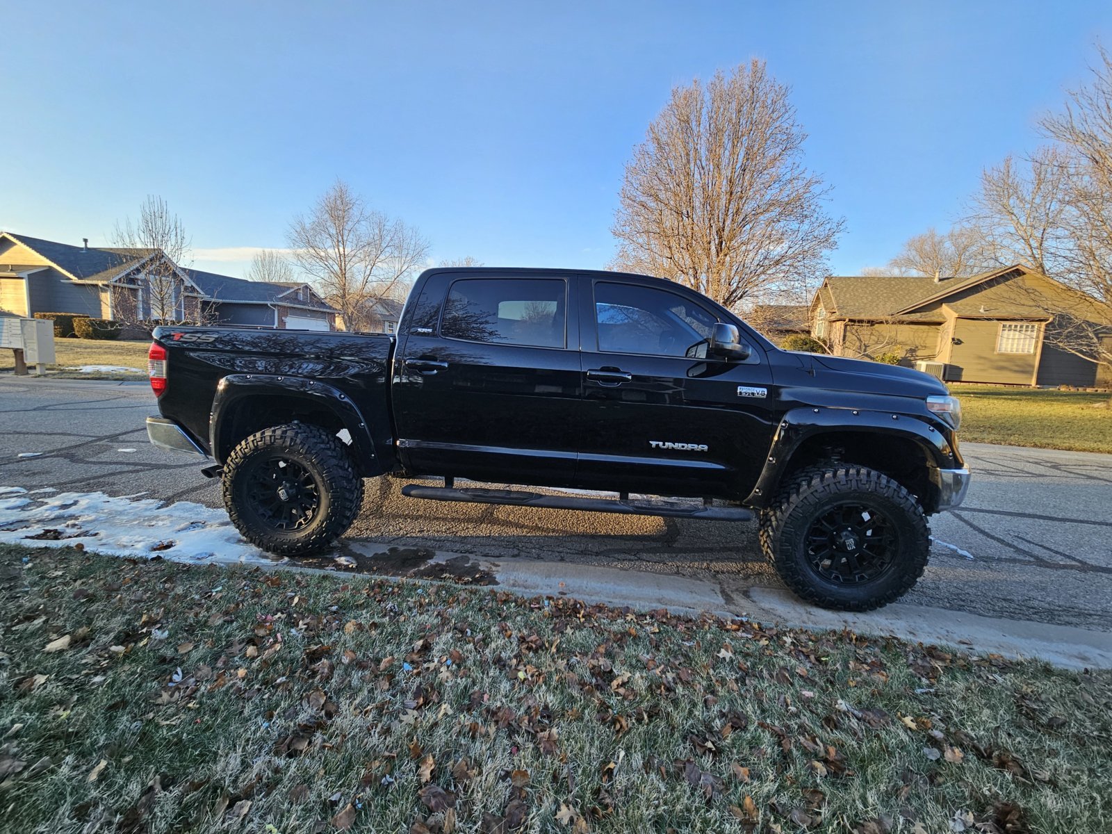

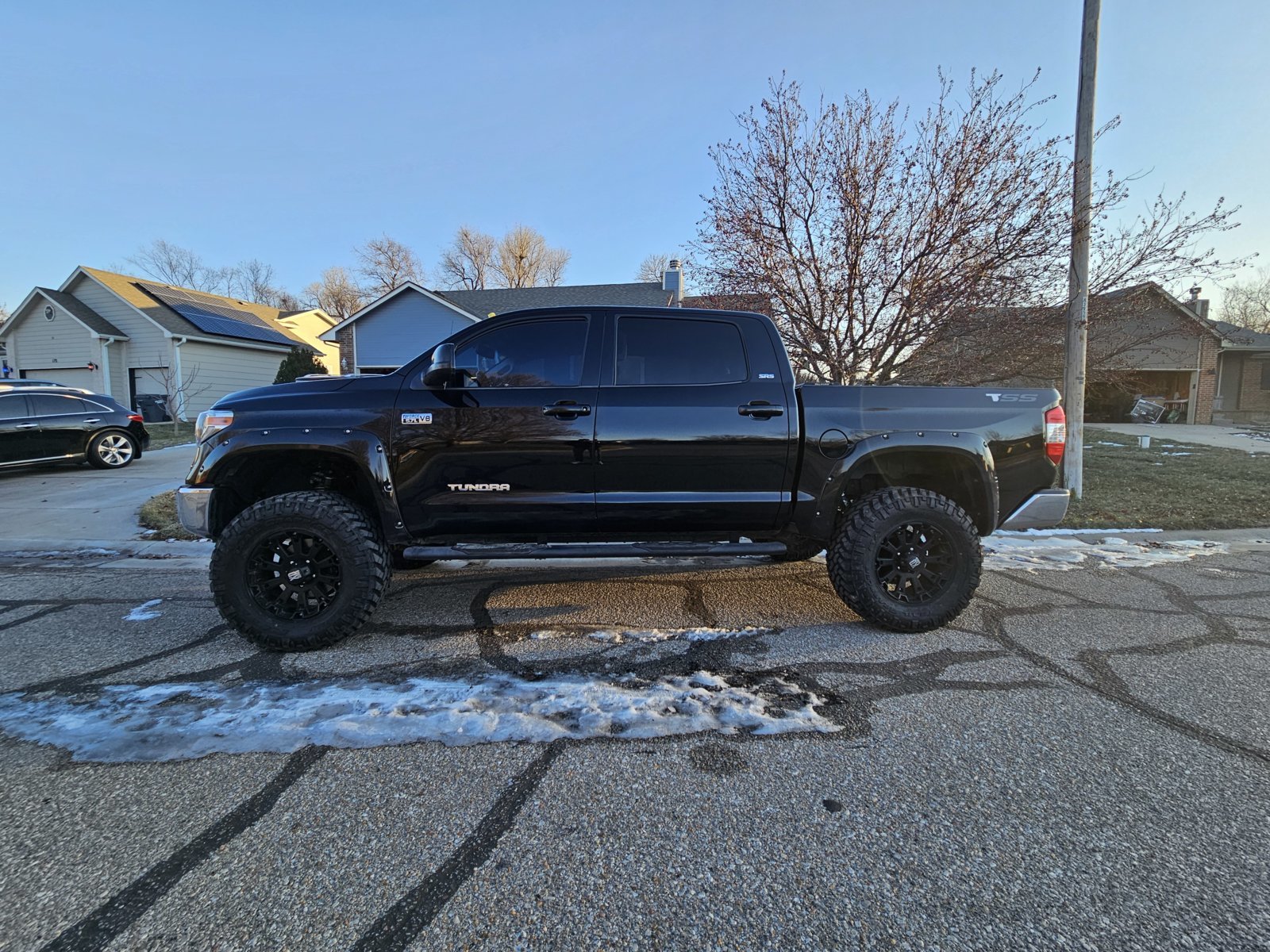

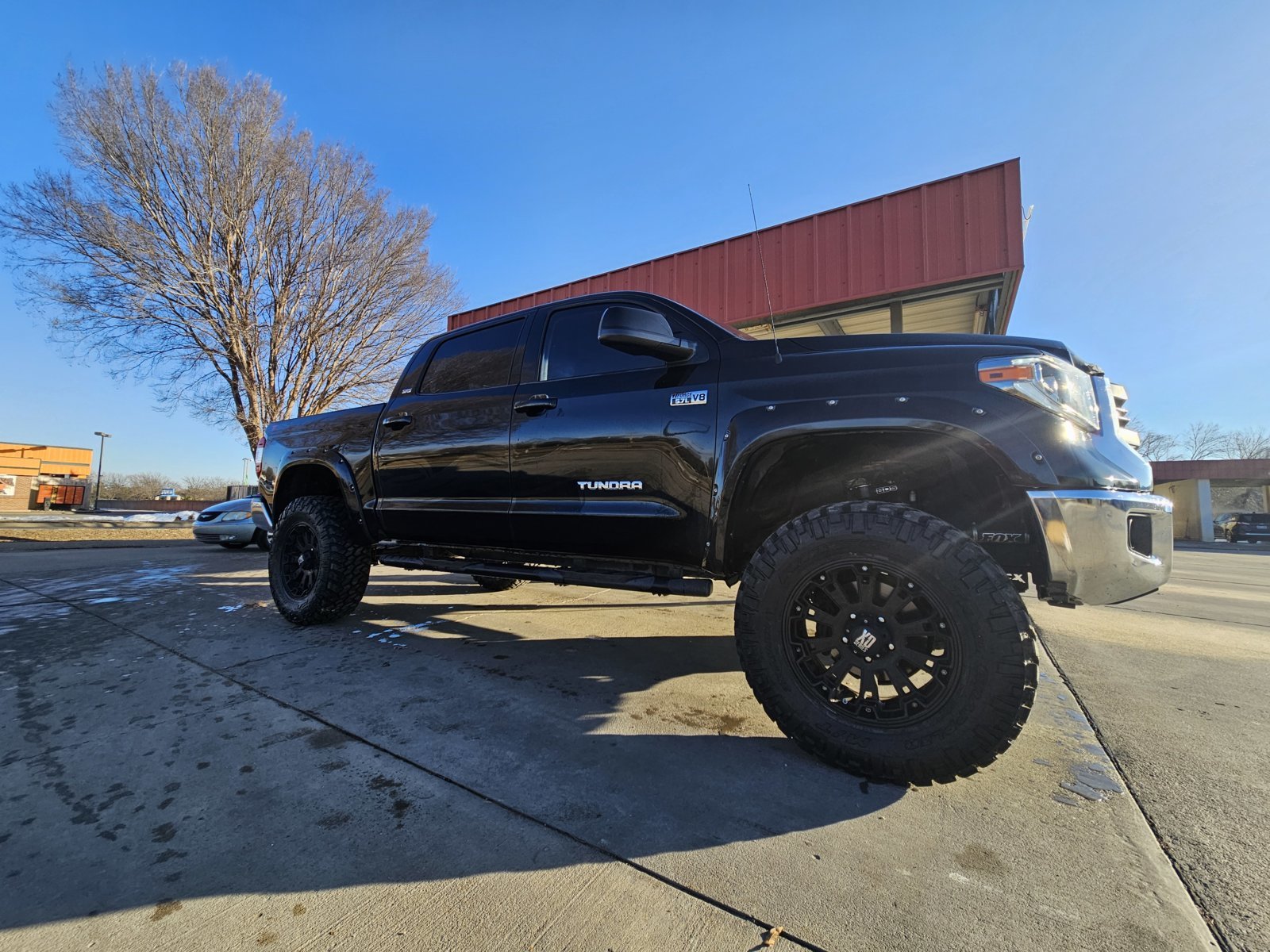

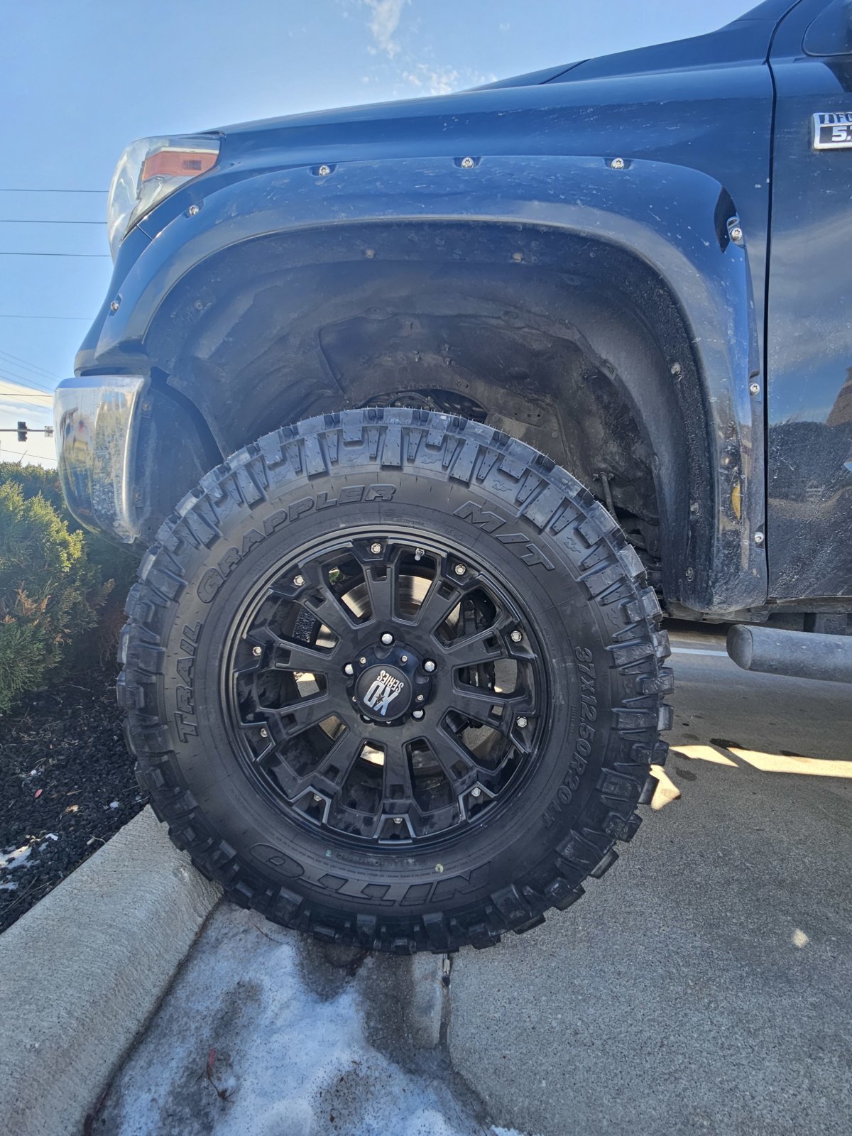

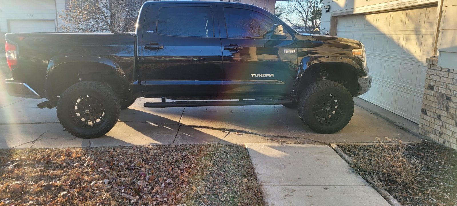

    Okay you all! Here is the Tundra with the 37s! It good to be part of the Dirty7s group! NOTE, I have a black hood bulge, I am waiting for my black TRD Pro lower grille to come in.
    SAGE63, reywcms, Skew12 and 5 others like this.

    Looks fucking amazing!!
