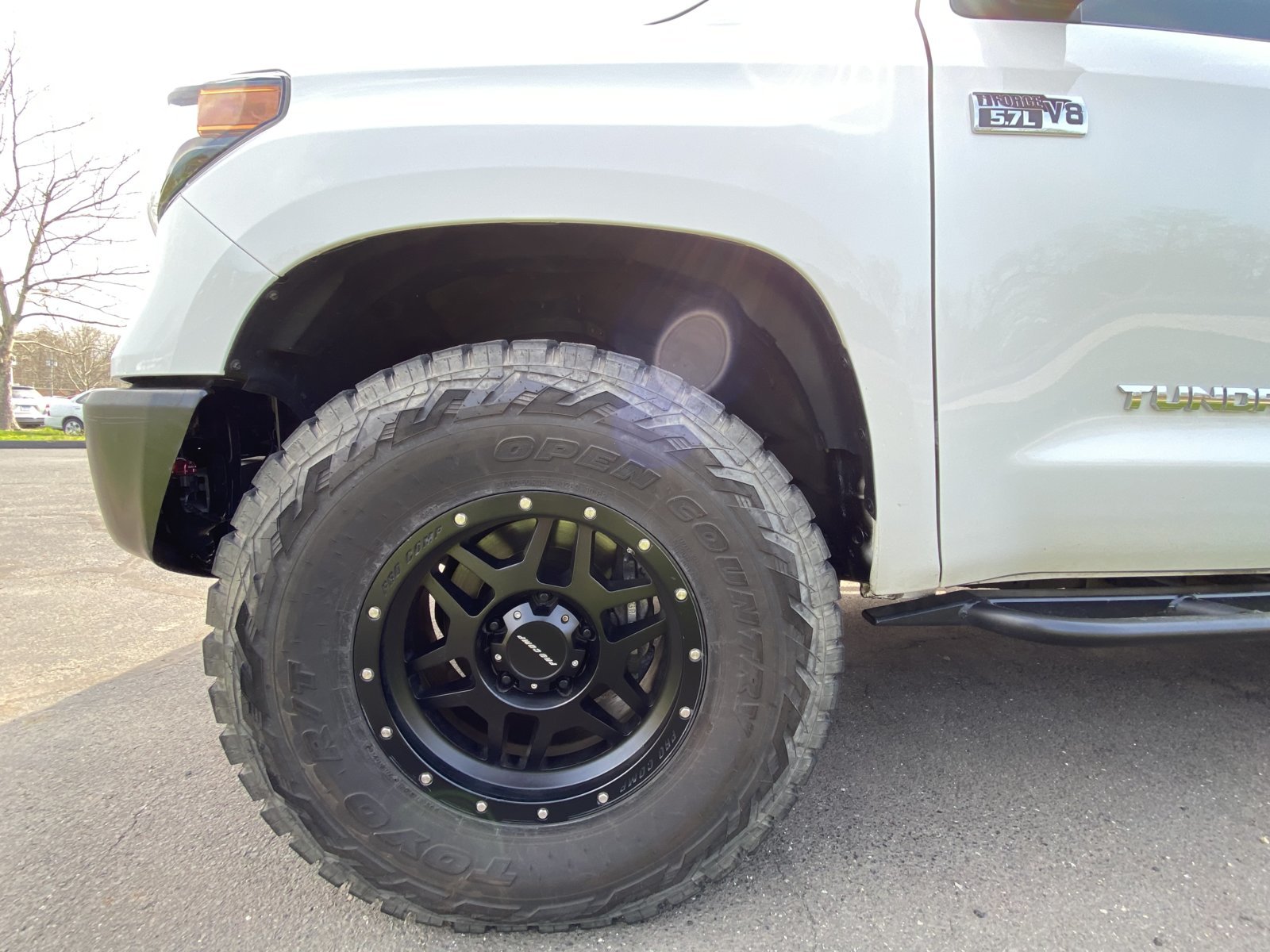

    Hoping to join the club this week. Currently on 33” Toyo RT’s just bought 37/1250/17 Toyo MT
    currently on icon 2.5’s all around with dirtking
    UCA. Unsure of current offset on wheels. Will see how much chopping is needed.
    im hoping the ride softens up a bit, the load E RT is pretty stiff for my likings.

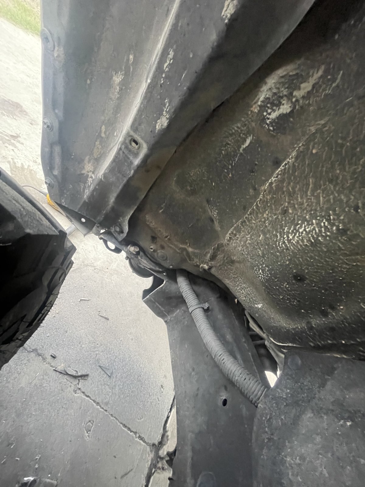

    Well I got the 37s on.
    im at about max on the body mount chop (to the bolt) and it still slightly rubs on full lock.
    Whats next? Is there a kit to relocate the body mount?
    I have some +1” coachbuilder shims on the way. Maybe that will do the trick. I think my icons are maxed (without killing the ride) and I don’t want to crank them anymore…
  11. Dec 21, 2023 at 8:53 AM
    #3161
    Kiddnapped Tundra
    Kiddnapped Tundra New Member
    Oct 16, 2017
    #34331
    305
    Grand Island, NY
    2010 Tundra DC
    Have you gotten an alignment to get your max caster?
    DRT makes a nice relocated body mount.
    n0rth likes this.
  12. Dec 21, 2023 at 9:00 AM
    #3162
    BajaSurTundra
    BajaSurTundra New Member
    Jun 7, 2022
    #79318
    20
    No I have not, we ran out of daylight. That will be next.
    I see the DRT one now, looks nice, my fabricator is thinking we can simply move that bolt a bit, and reinforce everything without spending $320... Piece looks killer though
    It does look like I could use some longer wheel studs, any recommendations there?
  13. Dec 21, 2023 at 9:15 AM
    #3163
    Chad D.
    Chad D. New Member
    Feb 12, 2019
    #26010
    1,478
    Western Oregon
    2018 CrewMax Platinum
    Check the alignment before going further with the BMC area. You may only need a touch more caster to make it jive.
    Wheel studs…. Some of us have ordered the Blackhawk ones from Japan. I think one fella had troubles, but that may be a limited issue. I’m unaware of any other people having problems. Make sure your lug nuts are deep enough to use the longer studs and you should be golden.
    pvn.beluga likes this.

  15. Dec 21, 2023 at 10:00 AM
    #3165
    pvn.beluga
    pvn.beluga New Member
    Dec 28, 2020
    #56744
    2,009
    Phuc (Phooc)
    Connecticut
    If I remember correctly, max out caster, then camber and then toe. Camber and toe should stay within spec, you’ll just have your alignment guy set caster within the range you want it in.
    For example, I run SPC and have caster set to 6.7*. Toe and Camber in spec. I rub when I steer to far while reversing.
    but here’s some info from @KevinK
    Rc23 and KevinK like this.
