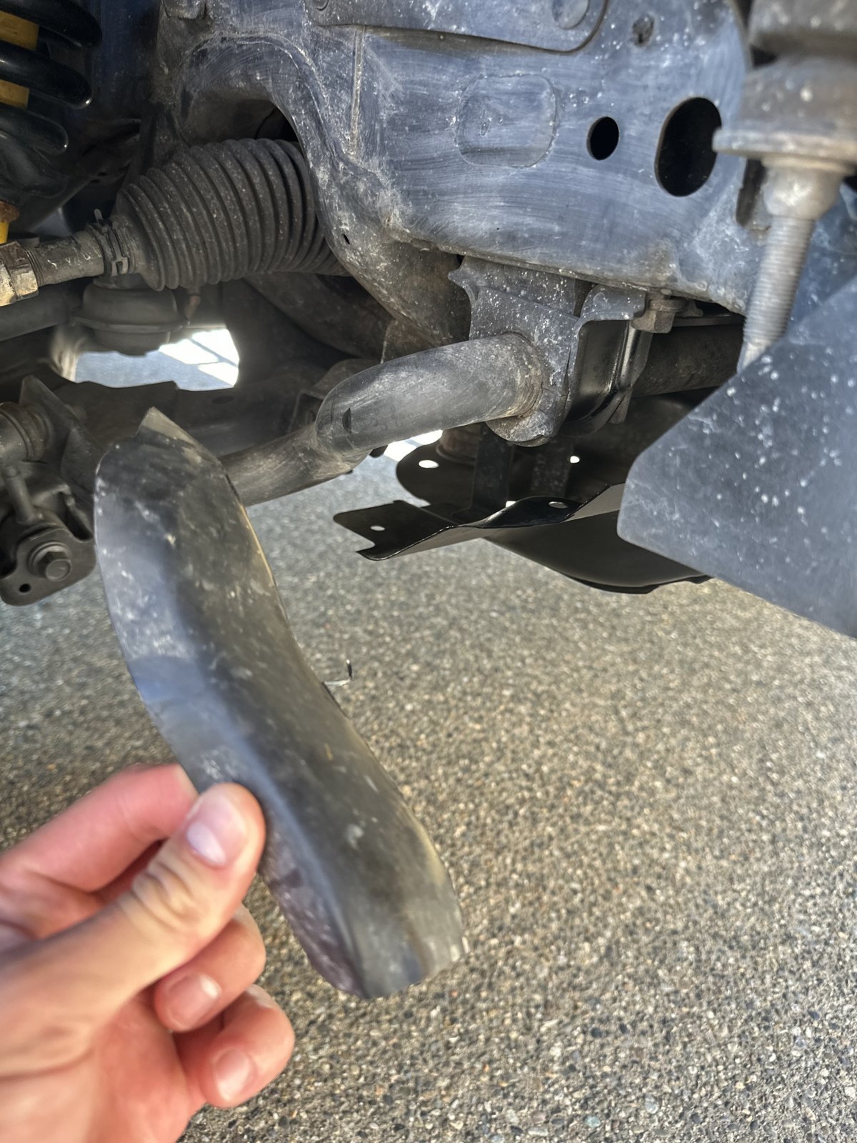

  4. Oct 6, 2023 at 2:55 PM
    #3064
    CaptRussia253
    CaptRussia253 New Member
    May 15, 2022
    #78415
    1,261
    Ruslan
    Just cut up the oem skid plate as it was rubbing too.
    I ran no sway bar with OME hd coils on my frontier with no issues. But these trucks are so damn heavy I was worried. Maybe I’ll remove and try it out.

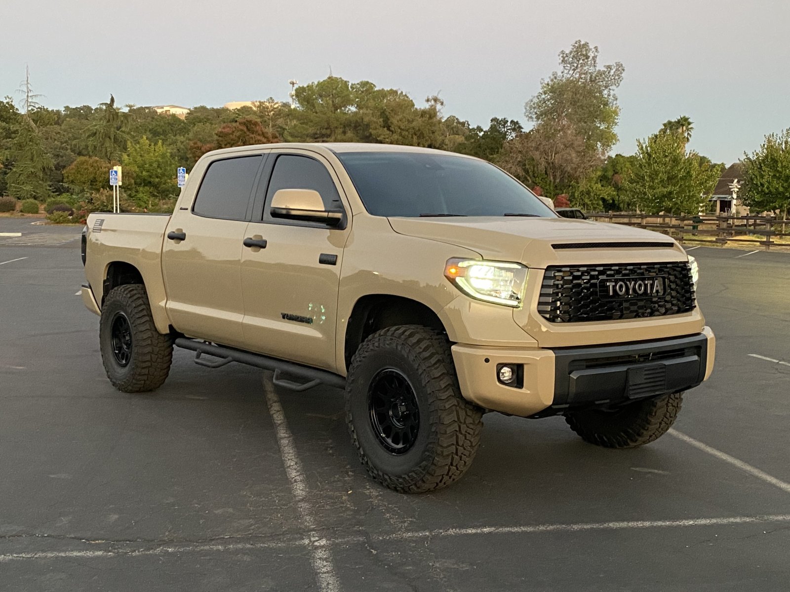

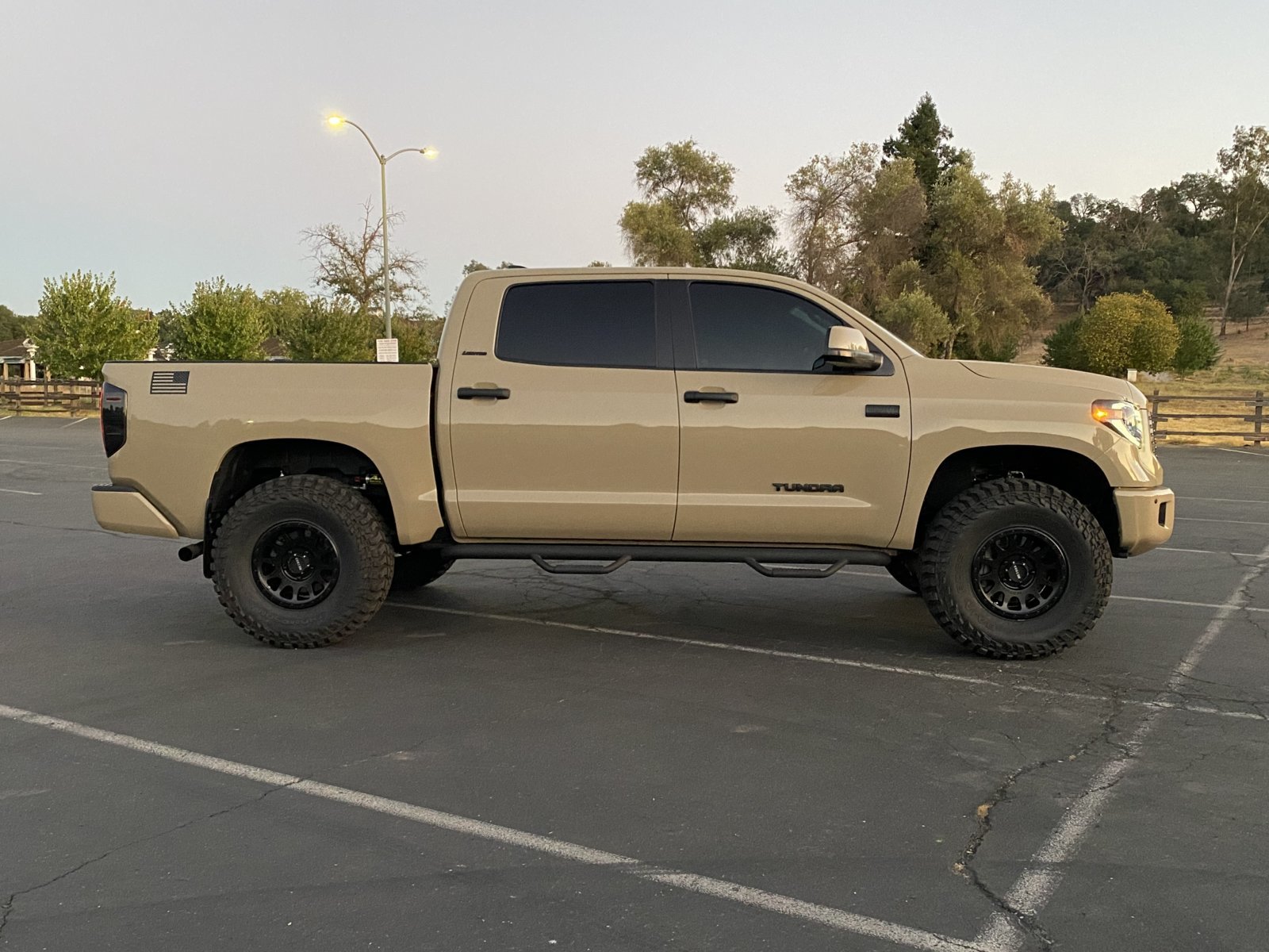

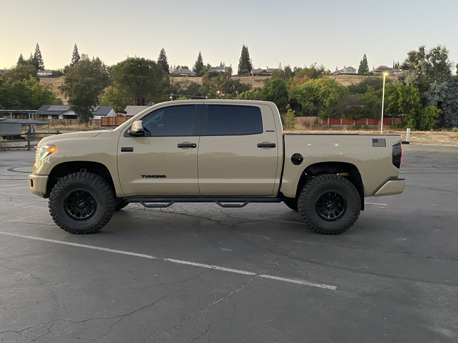

  9. Oct 7, 2023 at 7:31 PM
    #3069
    2TunGet1
    2TunGet1 Tundra owner since 2000
    Jul 7, 2023
    #99907
    330
    2020 Limited 4x4 CM QS / 2000 Limited 4x2 AC Black
    I got a chance to take some more pictures of her. 37s with 17 or 18 inch wheels look perfect on this gen Tundra IMO.
    Deaner, BillyB, TundraTEX518 and 13 others like this.
  10. Oct 8, 2023 at 1:21 PM
    #3070
    CaptRussia253
    May 15, 2022
    #78415
    1,261
    Ruslan
    Those Mickeys are looking :muscleflexing:
    2TunGet1[QUOTED] likes this.
  11. Oct 8, 2023 at 2:03 PM
    #3071
    WinterWarlock21
    WinterWarlock21 New Member
    Dec 6, 2020
    #55783
    257
    Dan
    South Jersey
    2016 Quicksand TRD Pro CrewMax
    https://gearproject.co/profile/SandShark21
    Looks amazing!
    What's your suspension setup and wheel/tire combo? Looking to make the switch to 37s after this winter hopefully
    CaptRussia253 likes this.
  12. Oct 8, 2023 at 4:33 PM
    #3072
    2TunGet1
    Jul 7, 2023
    #99907
    330
    Thank you!
    FRONT: ADS 3.0 Coilovers w/ resis, MCM UCA w/ Icon Delta Joint, Spindle Gussets
    REAR: ADS 2.5 w/ resis, Dobinson’s L59-120-R Leaf Springs, Durobumps.
    Wheels: Method MR305, 17x8.5, +25 offset
    Tires: Mickey Thompson Baja Boss M/T, 37x12.50x17
    BMC, Pinch Weld Mod, front liner cut, Toyo Bumper 1/2” Spacers

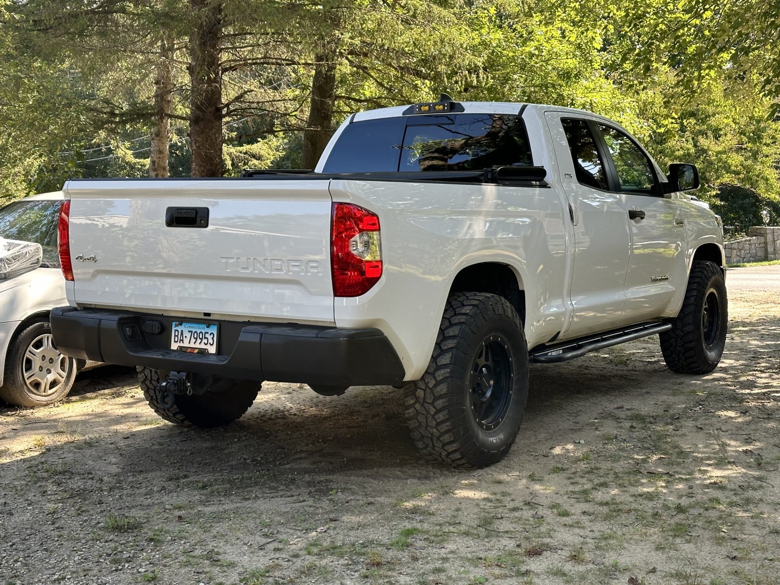

  20. Oct 10, 2023 at 7:47 PM
    #3080
    pvn.beluga
    pvn.beluga New Member
    Dec 28, 2020
    #56744
    2,009
    Phuc (Phooc)
    Connecticut
    You’ll get used to it. After going through @joonbug build thread, that’s when I decided to take my sway bar off. Haven’t looked back since. To each their own though.
    Man, glad to see so many of us hopped onto the 37s! I haven’t done much with mine except tire rotations and oil changes.
    J&ATundra, Deaner, BillyB and 11 others like this.
