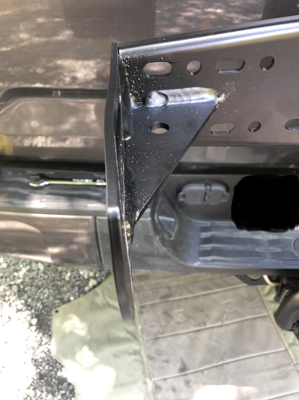

    Sorry for the late follow up but it has been hectic lately. It’s given me a bit more time to use and reflect on the TrailSwing though.
    I’m mostly happy with mine too. Seems like it’ll last a while, good install videos, and made in the US.

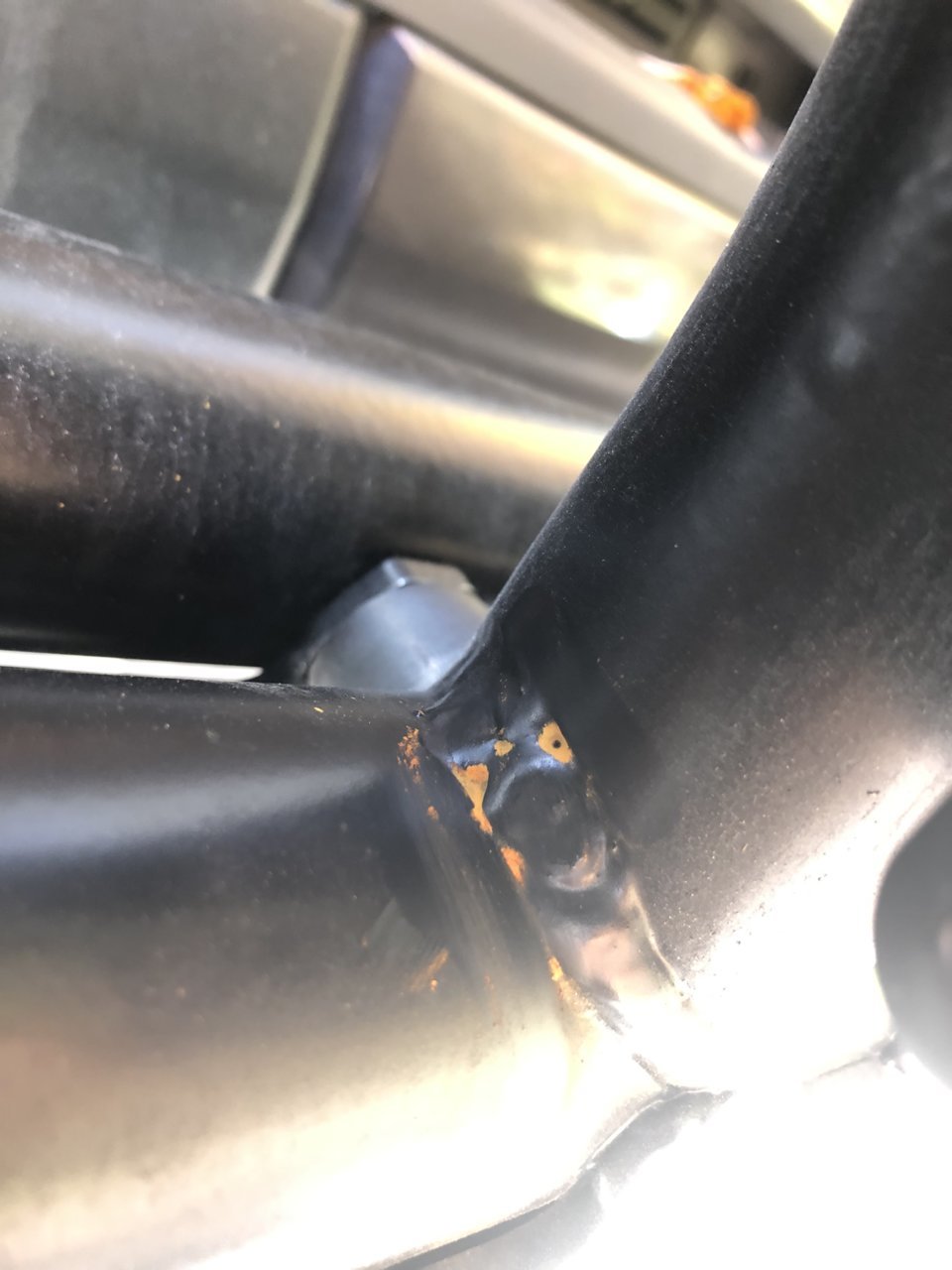

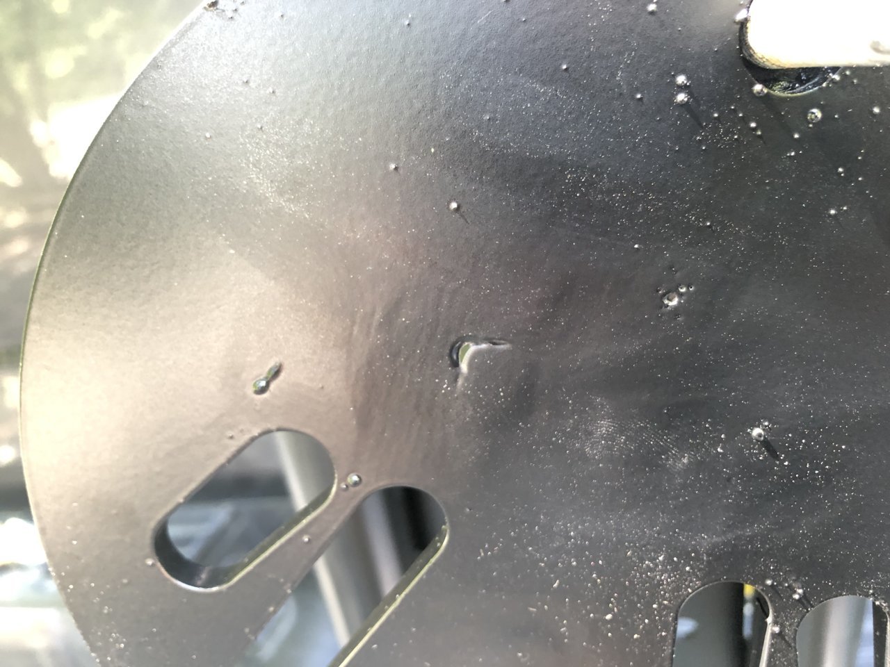

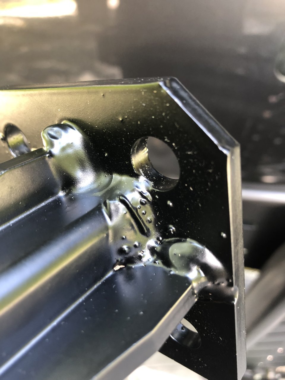

    My biggest complaint is that the welds look like crap. Lots of splatter, overflow, and even a burn through or missed fill. There are spots where the welds interfere with the tire mount bracket so much it was difficult to get more than a thread or two engagement while starting the nuts.
    First picture is the burn through or missed fill. I’ll probably just fill it with JB weld or something to stop water from getting in and continuing rust. The other pics are just the general poor weld quality/splatter.
    Minor gripes/honest mistakes:
    • Previously discussed, but they hand threaded on the wrong nut. I went to torque it down and it pulled the threads out. No damage to the threads on the bolt so I was able to replace it with the proper nut. They recently switched thread pitch on this part so things got confused. No biggie.
    • No rotopax spacer included. I don’t need one but thought it was supposed to come with it.
    • Trail bracket came bent. It was bent before powder coat so it wasn’t a shipping issue, it was a QC issue. It shouldn’t affect my use though so not a huge deal. Picture below which also showcases some more dookie welds.

    Wow, they must have hired a new welder for mine has none of that. I think overall, you’ll be ok, but for the price we paid, it should be near perfect. Have you mentioned these to them?

    No I didn’t bother. The welds look bad but they’ll hold. I mostly didn’t want to deal with return shipping.

    Understandable, but you may want to mention it to AJ (owner) so that their welder can polish up his/her skills for future customers. Just so he knows that they can improve on their quality.
