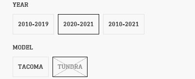

    seems like their Tundra specific camera is out of stock :(
    would the ones for tacoma work?
    Thanks!

    Yup, I initially did the exact same thing and thought it was out of stock. It’s a pretty good camera and very compact. Here’s a tip, don’t use the included double sided tape to mount the bracket. I’ve read that it does not hold long. The bracket has a small pin hole drilled in as a pilot hole. Simply enlarge that pilot hole with whatever size screw/bolt you will use to mount it to the Trail Swing.

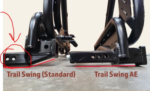

    update: called dirt complex one week after placed my order, they said the 6-8 weeks lead time still holds true, and they recently updated the design in the hitch part. Changed them from being hallow to solid.
    If I understood right, I believe he was talking about this section?
    Can anyone with the dirt complex tire carrier confirm that the current design is hallow in that part?

    Yes, it is hollow. Not sure if their updated design is the “Trail Swing AE” as in your picture, but the first thing that jumps out at me is the straight receiver. The AE in the picture looses the departure angle clearance the the standard one has.. This makes a huge difference in wheeling. I’d inquire about that.

    well I ordered the HD right hand version, I didn't know they make an AE with HD? thought HD defaults to a high clearance design?

    I would assume that but I’m not sure what the AW version even is.

    oh yea I only got that image from their website to point out where the hallow part is and they didn't mention aw at all.

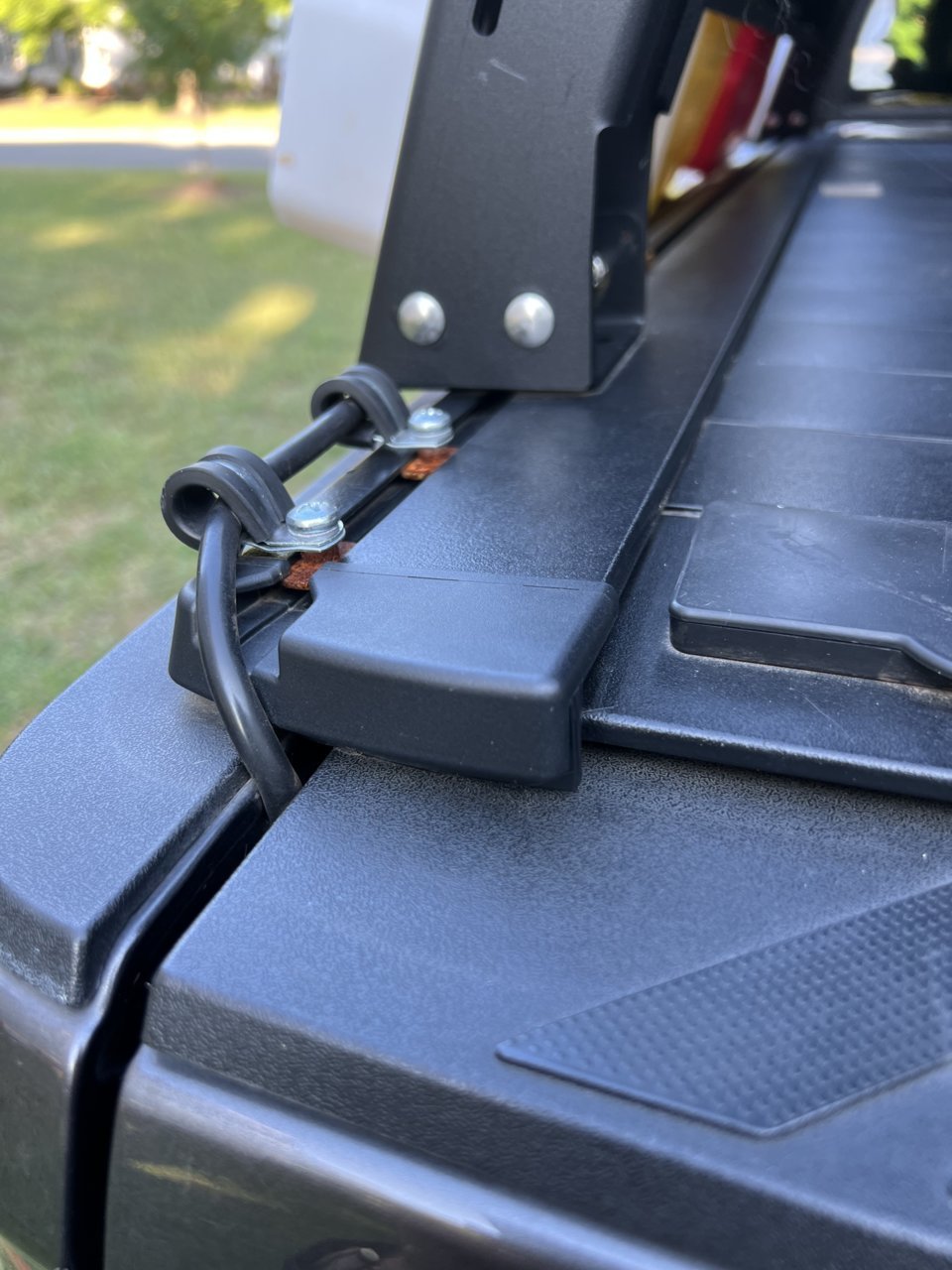

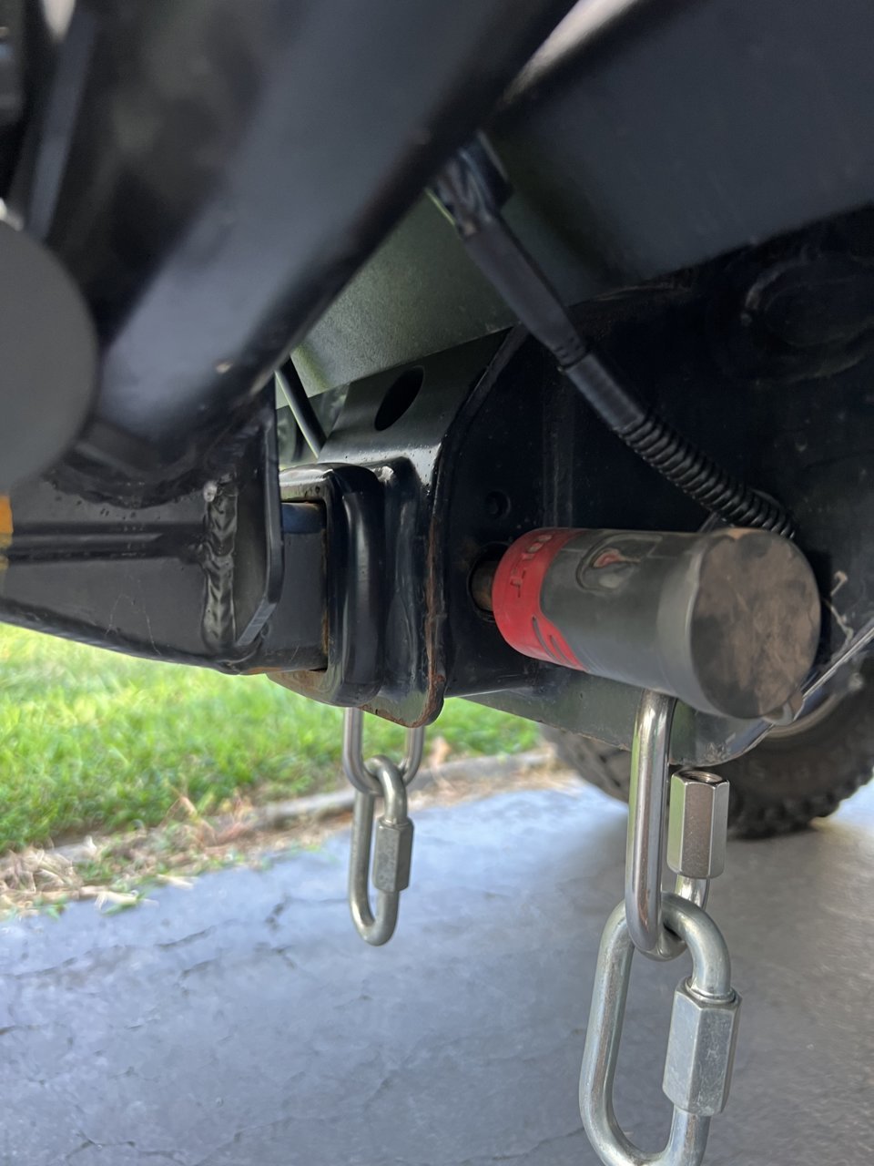

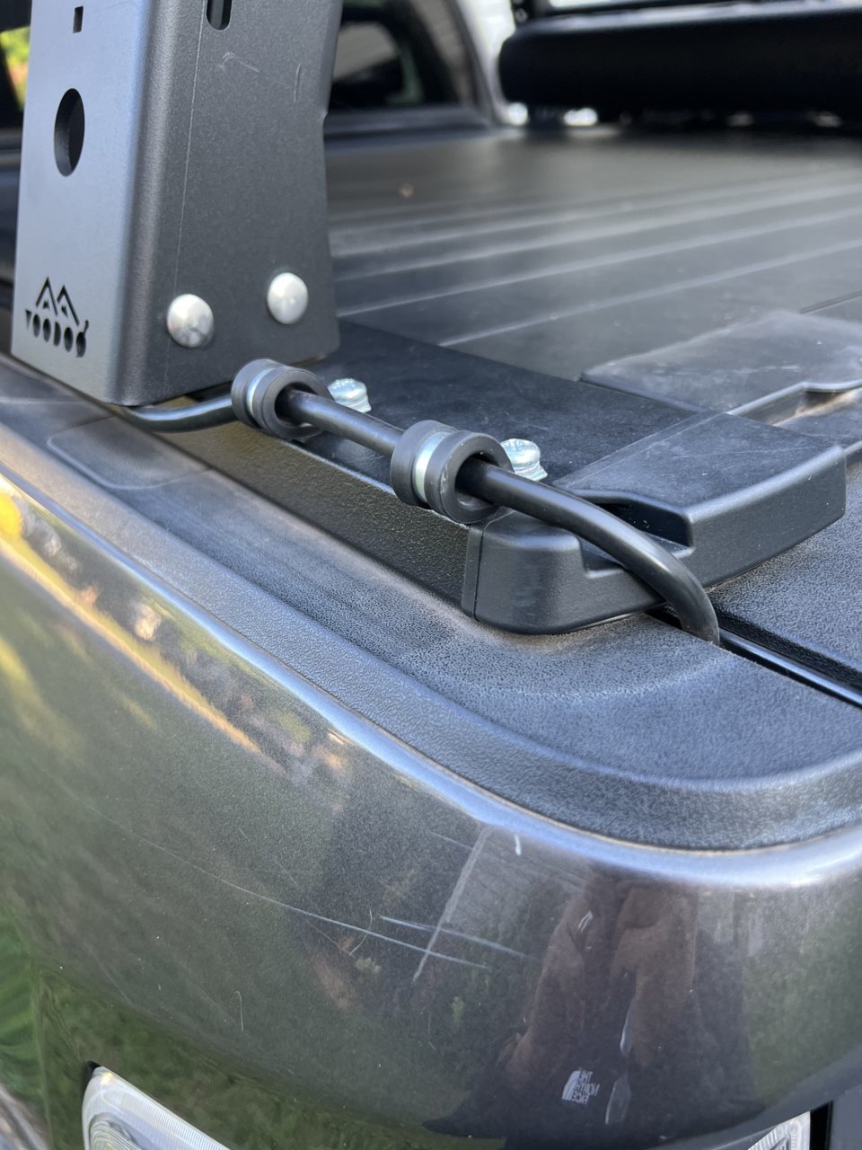

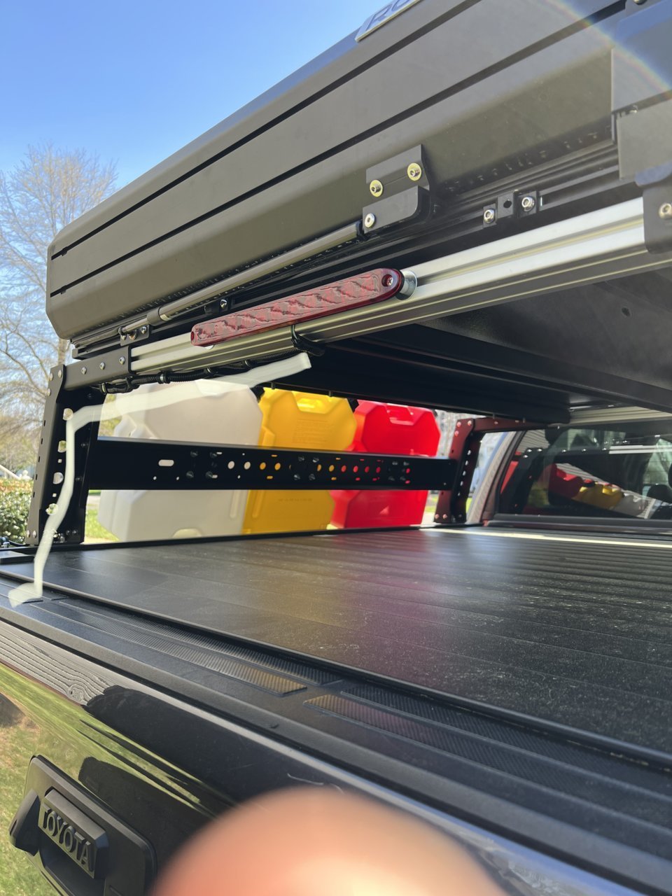

    I ran the wire along the rear rack bar, down the support leg, in between the tailgate and taillight to the underside of the truck bed. I have a pigtail adapter that inserts between the truck wiring harness and trailer plug in the bumper that gives me an additional 4 pin plug under the truck. I then plugged the 3rd brake light into this 4 pin plug underneath the bed by the rear bumper. Follow the white line in the pic below.

    Thanks...any issue with pinching the wires between the retrax and the tailgate?
  26. Sep 14, 2022 at 2:31 PM
    #56
    BayRunner
    BayRunner [OP] I’m here, except when I’m not
    Sep 7, 2017
    #9507
    2,529
    2017 Tundra Platinum
    Not at all

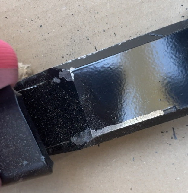

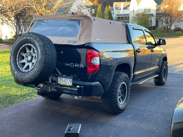

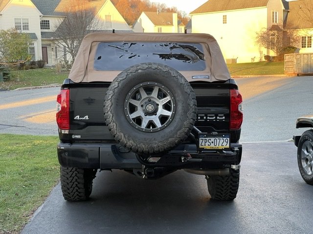

    After months of waiting, mine has finally come in today, worth the wait. I am mostly happy with mine so far, only thing I see could be improved is powder coating, mine came scratched on the edges of hitch tube
    9D45F25C-9881-48FA-B499-288C9E4EBC79.jpg 174175C2-7C93-4946-B2FE-5BAAF2B5002C.jpg F3FF6AE0-75CA-4B6B-9FE4-B18E0AB9D267.jpg

    Looks good, we’ll except for the scratch, but that’s easily corrected. Don’t forget to tighten the receiver bolt again after riding around a bit. Mine had to settle in and be retightened a few days later.

    Thanks man. I did spray rust reformer and bed liner to cover it. Did you use 80lb ft for that bolt? Seems like it is kinda high and never torqued out lol
