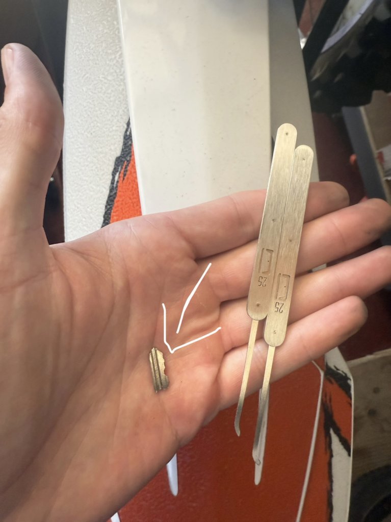

    Learned to not to try to use a dirtbike key once it’s slightly bent. Lock picking set came to the rescue.
