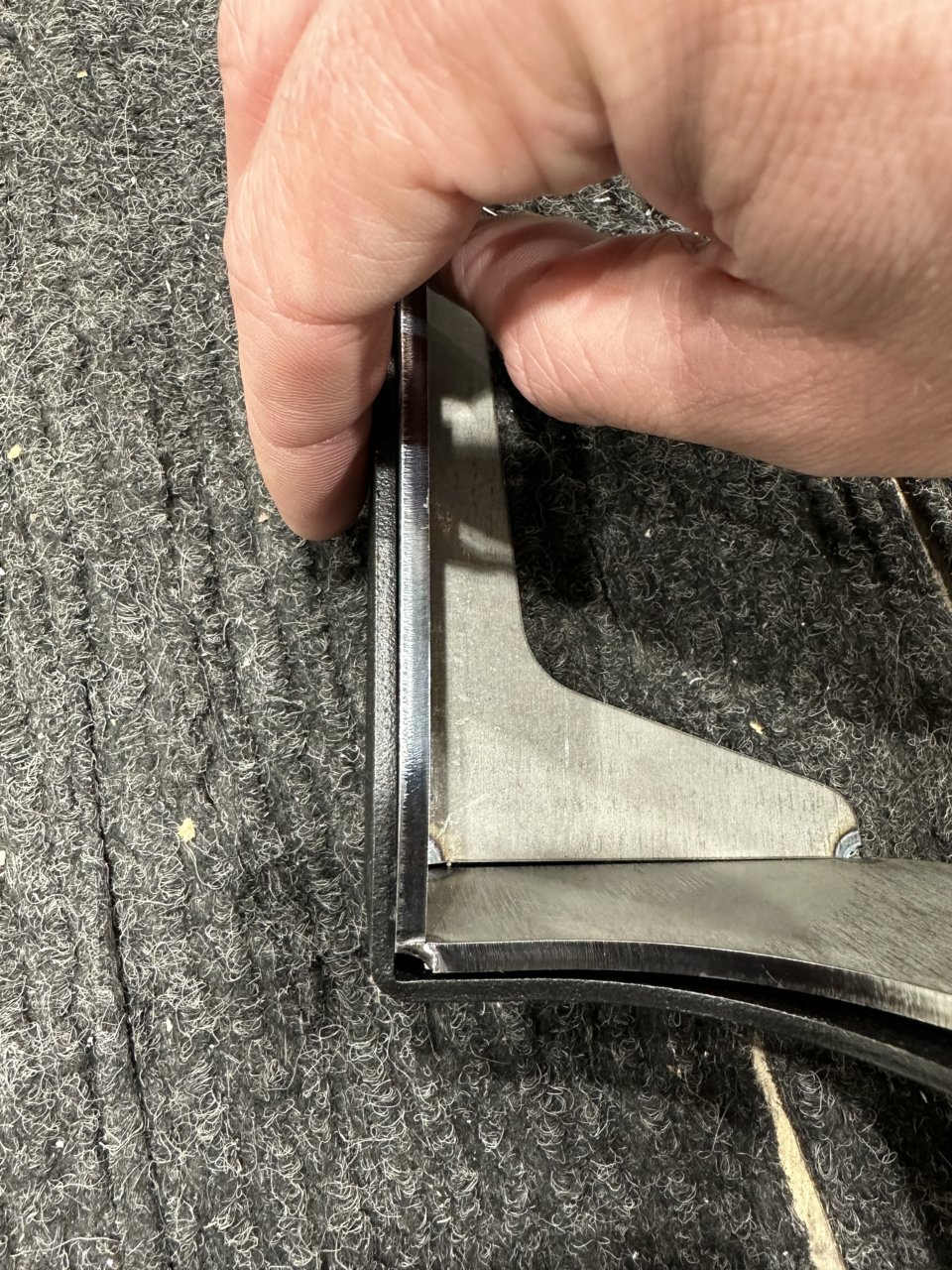

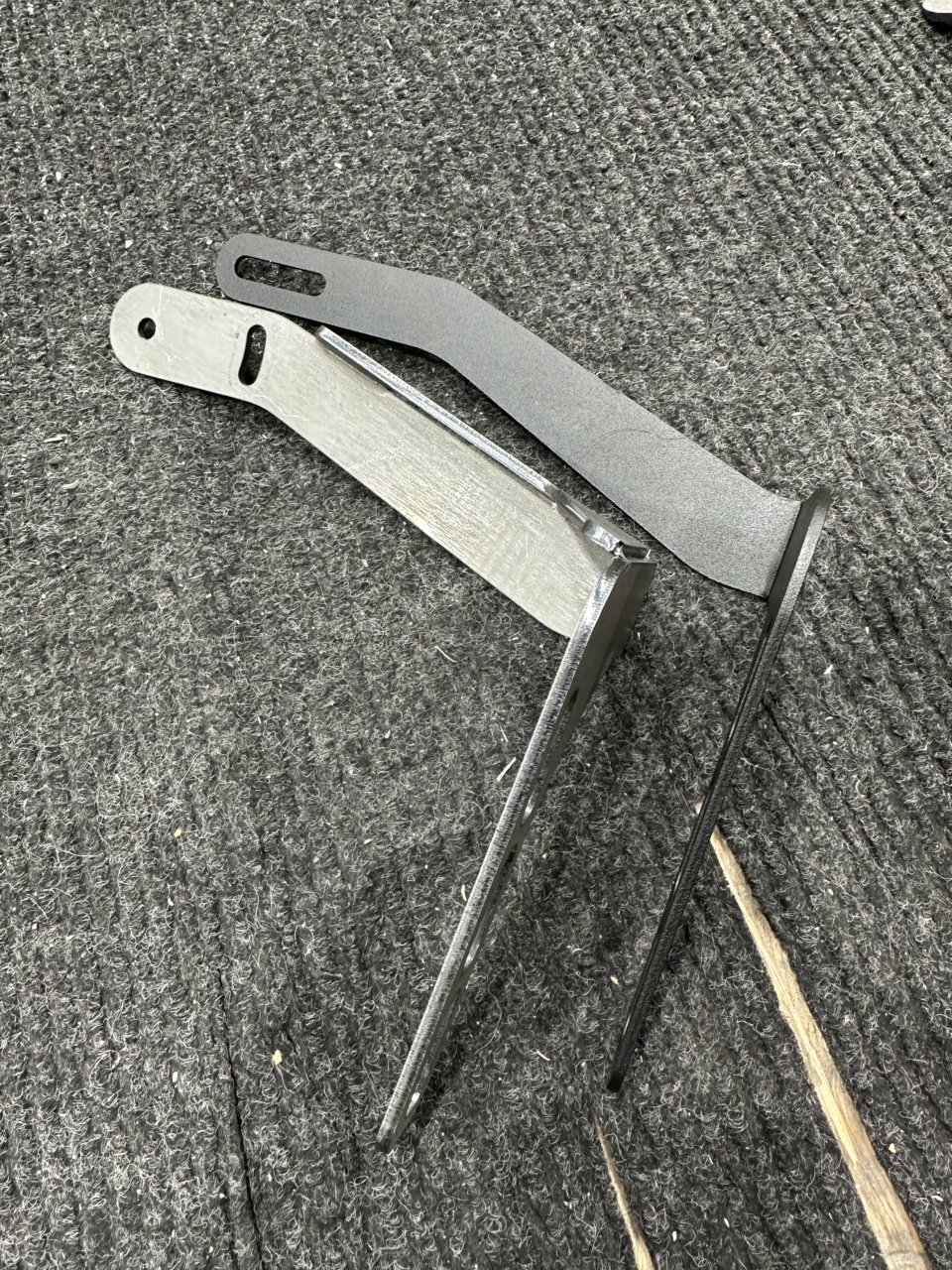

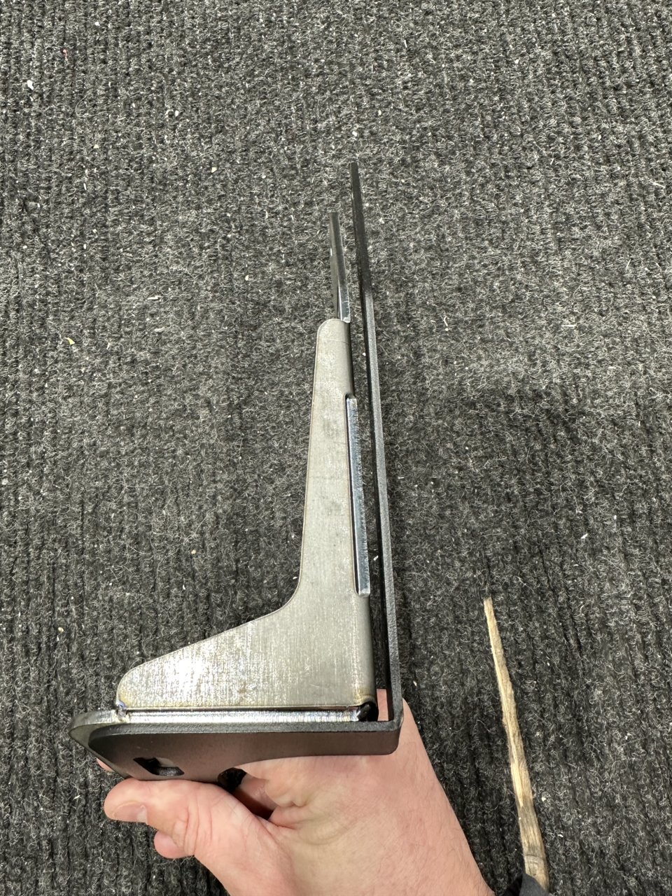

    You vs the guy she tells you not to worry about :cool:. First prototype DONE! Had to make a couple on the fly design changes, but that ain’t no thing if I can source a suitable workaround. Fitment testing is next.

    Diode needs to pay you to be their OEM for brackets. That looks awesome and should fix all the gripes we have about their current one.

    Just started dipping my toe into this world, but I'm certainly here to give it a whirl! If nothing else I can over-engineer the hell out of something :rofl:
    I have my fingers crossed that this should address everything we have been having issues with. We'll know soon enough!

    Do you have a full blown machine shop at your house? That’s badass!

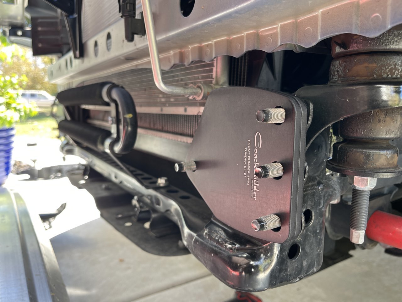

    Is anyone running a DD bumper light bar in conjunction with coach builder bumper spacers?
    I’m curious if there ends up being enough room for both?

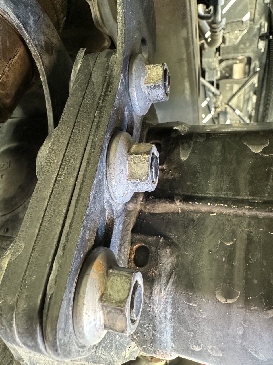

    Yep, I am and there's room. I think it about maxes out the threads, but the nuts do get fully threaded.

    I can confirm that there is NOT room for both, unfortunately. Already gave that a run myself. There's just no thread left after everything is stacked up.
    I kicked around the idea of trying to address both issues and make the light bar bracket and bumper shim one single piece (which is the only way this could be accomplished), but convinced myself that the juice wasn't worth the squeeze in terms of potential units sold.

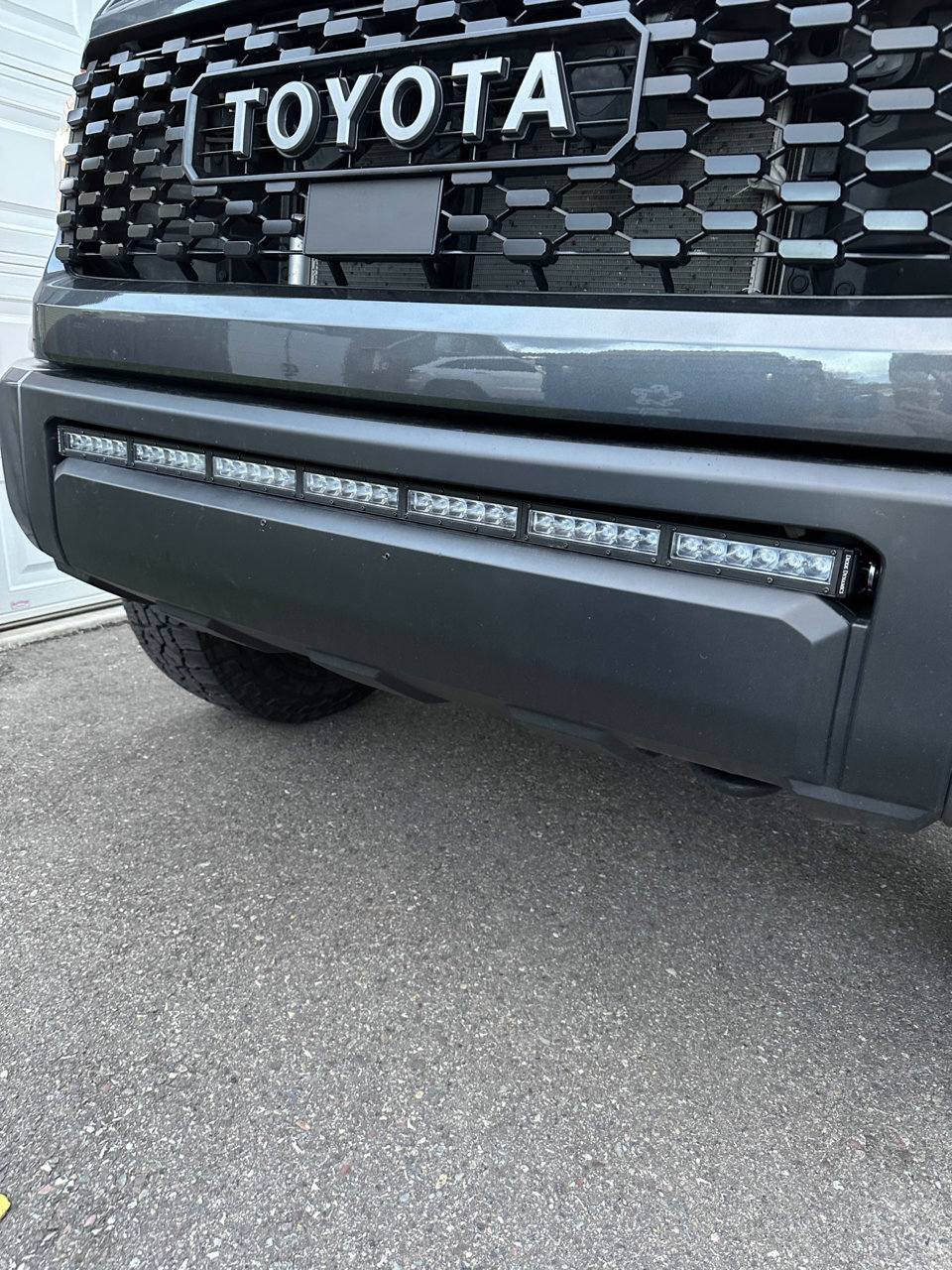

    This is how mine ended up

    Now looking at this I'm wondering how much thread I really have... hmm. I technically don't need both plates for clearance, but it would be nice to leave as-is.
    Edit: I'm comfortable with the amount of threads holding it on. YMMV

    Yes. But I’m just a hobby Machinest/welder/fabricator/blacksmith and wood worker. I just love tools, have too many hobbies, and no kids. I’m glad you liked my solution. It’s probably a little over built but that’s how I like things to be. I’d have to crash my truck before my light moves.

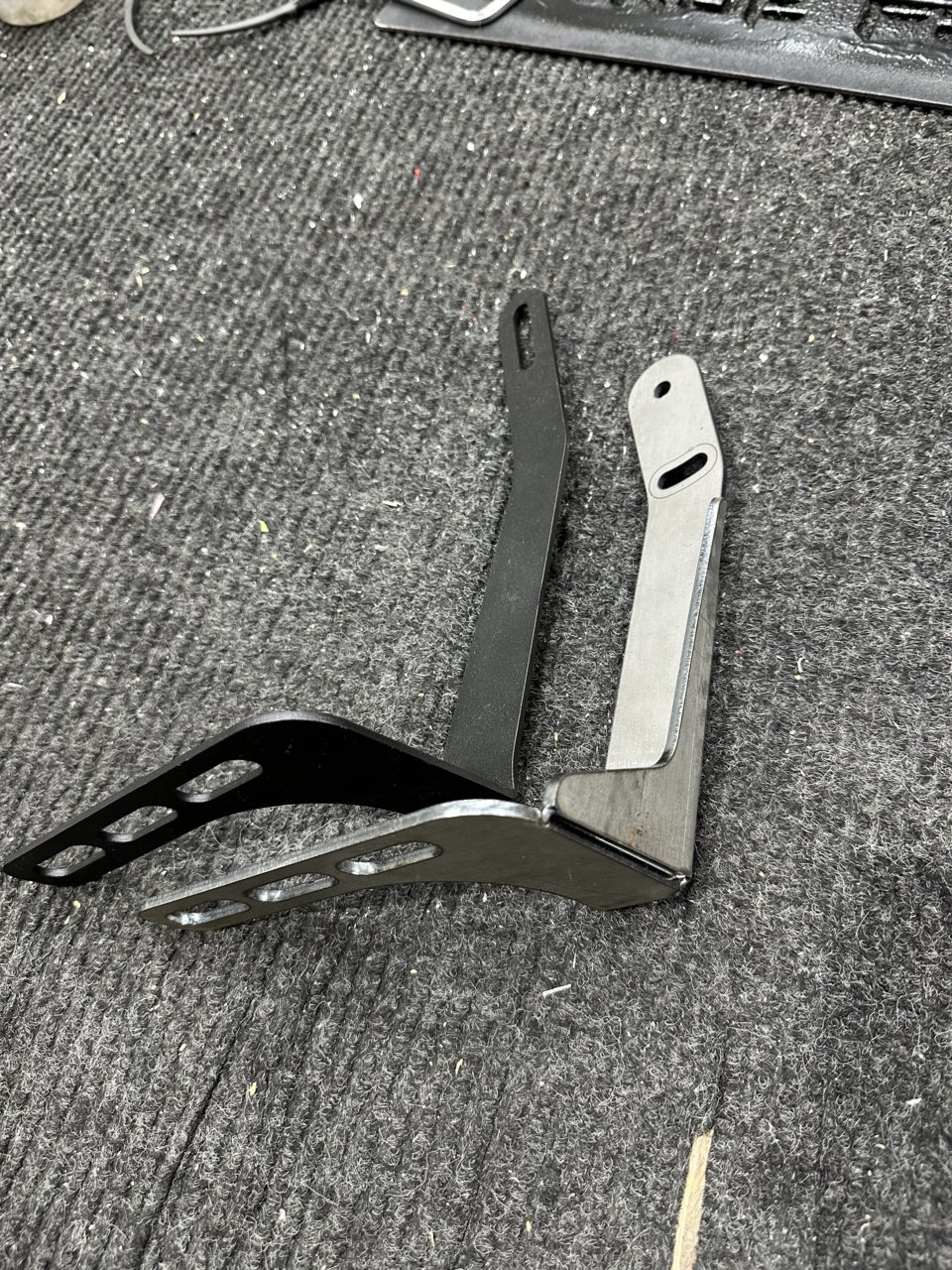

    For those that are interested in picking up a new bracket here's a teaser addressing the stability issue. Left the audio in just so that you could understand how hard I was hitting at it :rofl:
    For those who might want to pick one up... Would you prefer the bar to be resting along the bottom edge of the bumper plastic while being secure, or would you prefer that it be "floating" within the lower bumper space. This is a very small difference as far as measurements are concerned, but wasn't sure if folks would be passionate about this one way or another.

    I'd prefer it floating, but either way is fine, honestly. Resting on the plastic helps hide the clips a little.

    Okay - V1 testing is complete and I'm pretty happy with the result thus far! It is definitely more stable and secure than the DD brackets. No doubt about that. Still has a bit more deflection than I would like. I am going to assume that I will not be able to engineer out all vibration when someone is on a very washboardy road, but I fully intend on this experiencing little to no movement when traversing most forest service roads, onto/off of bridges at highway speeds, etc. Here's what we're working on now:
    • Height adjustability - Not sure why I didn't think of this initially, but we're engineering an easy fix to allow for height adjustment. We're just going to move the slotted holes down on the back flat plate 1/2". That will allow the end user to be able to make the light bar "float" or rest on the lower bumper plastic as they see fit. This will also allow you to adjust for variability in bumper/frame fitments across different trucks.
    • Deflection Defense - We are going to widen the area of the plate where the bracket meets the frame on the top-most bolt. During our testing the flex that we are experiencing now seems to be driven almost entirely by upward flex being allowed where the top bolt is located. Strengthening this location should support the overall structure for upward deflection. We've already gusseted for downward movement.
    • Fit and finish - We are going to narrow the section of the bracket between the "horseshoe" and the outermost bolt. This will allow the headroom for up/down mobility for those who want to have the bar floating. Otherwise you'll be impacting the plastic on the upper side.
    More to come!
