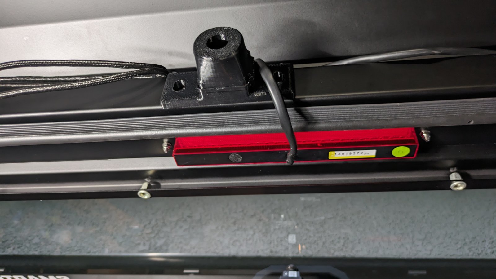

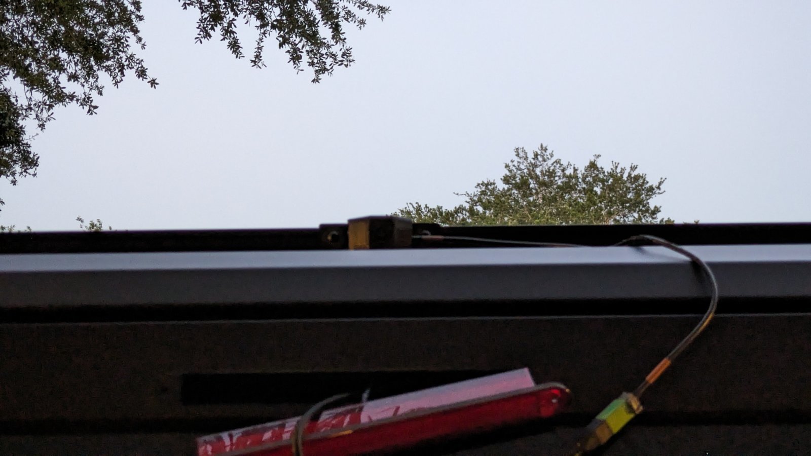

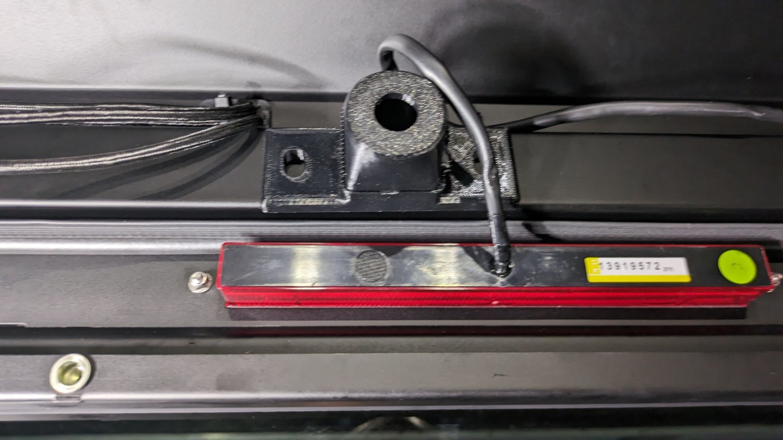

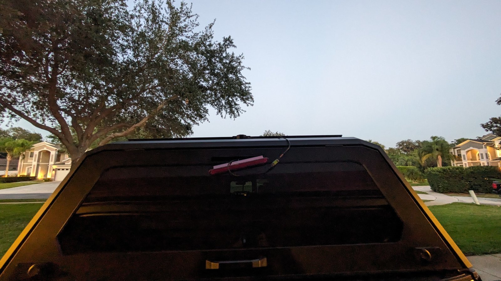

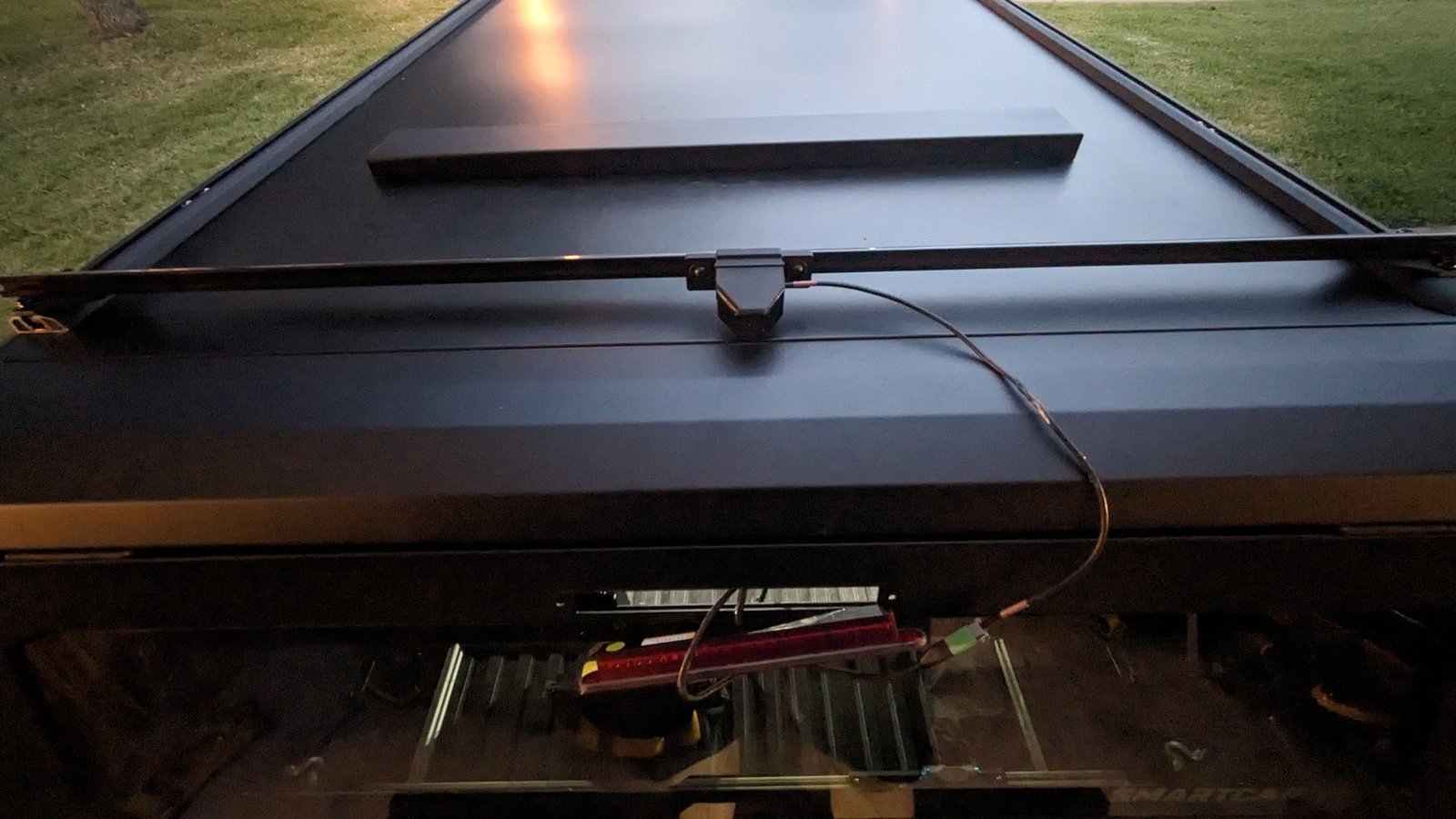

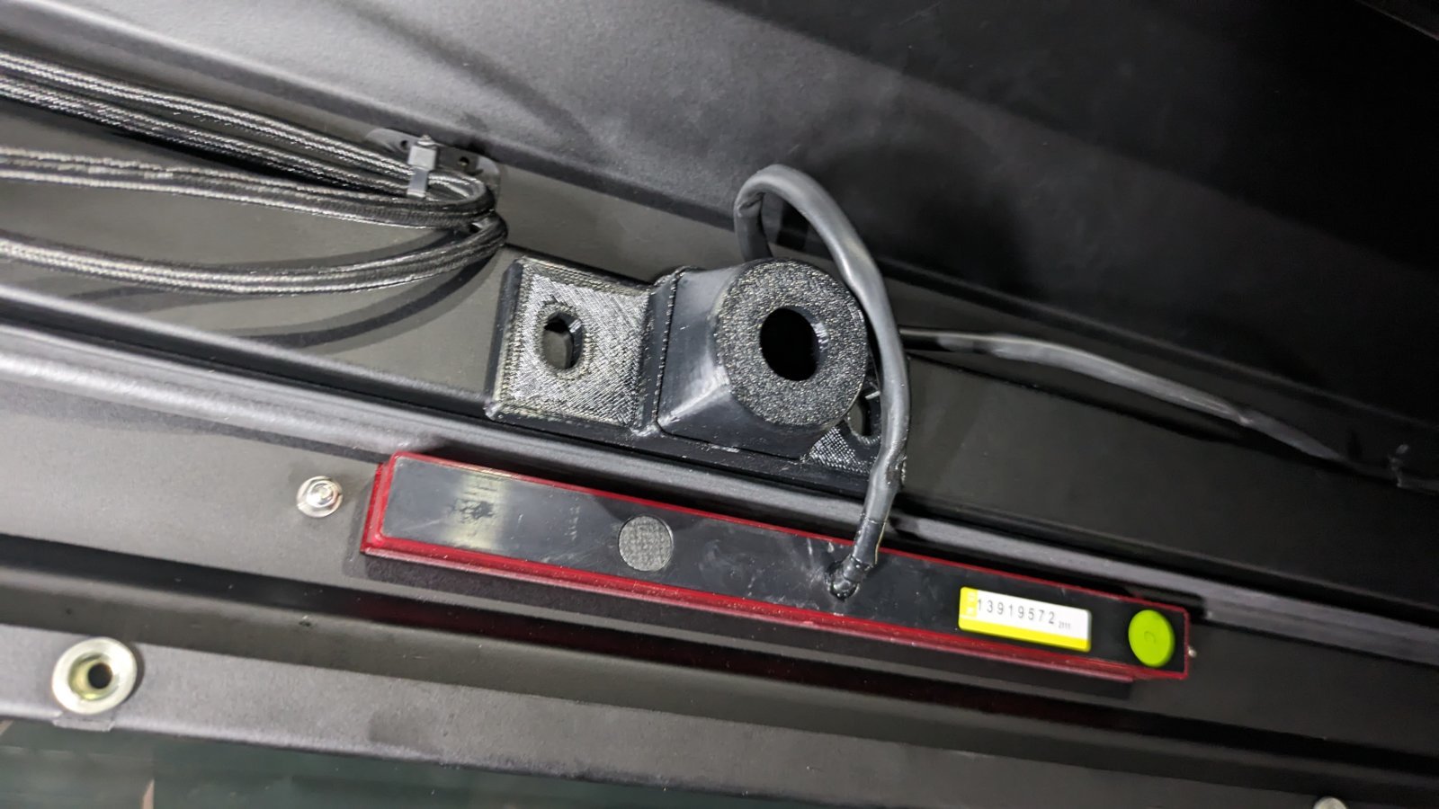

    Here are a few pictures of different mounting options.
    This one uses a t-slot aluminum as a cross bar. Disregard the cable routing. I still have not decided if I preffer the view from the top or the inside.
    This is how I mounted it on the inside. I'm using the existing security screen bolt holes on the RSI Smartcap.
    Lastly Austin (GG) also has a mount for the inside bed camera, I'm currently trying to figure out how to mount this without drilling new holes. But these give you an idea of what the mount looks like from the inside.

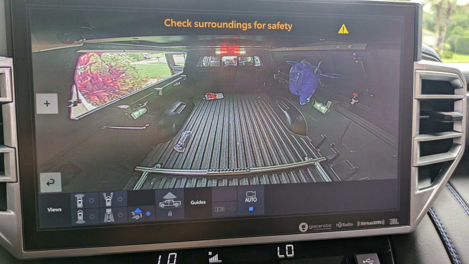

    Here's what the picture from the inside camera looks like. Mounted on the position from my last post.
