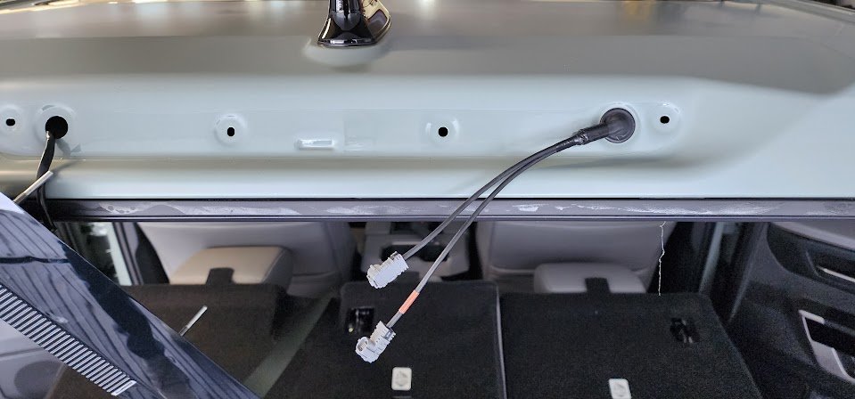

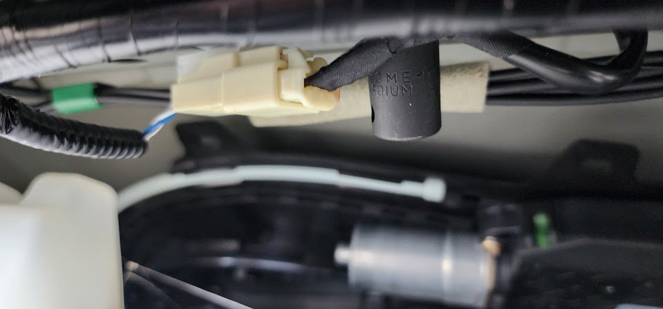

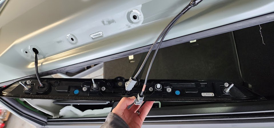

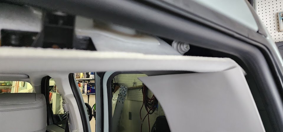

    Hey, ETA is looking like 4 weeks now because of lunar new year, couldn't get the full order produced before the shutdown. I have an instructions page that I havent published yet on my website. But i can explain here briefly. its super easy to drop the 3rd brake light.
    First remove both rear coat hangers from headliner using a plastic pry tool, pry the cover and then grab the metal hook out. Then pull aside the trim from both C pillars where the seatbelts go into the trim. gently pulling is all thats required here.
    Then you can gently pull down the headliner below the tail light (rolling the rear window down is super helpful).
    The tail light is secured with 3- 10mm bolts.
    Ill attach some pictures for you. Hope that helps!

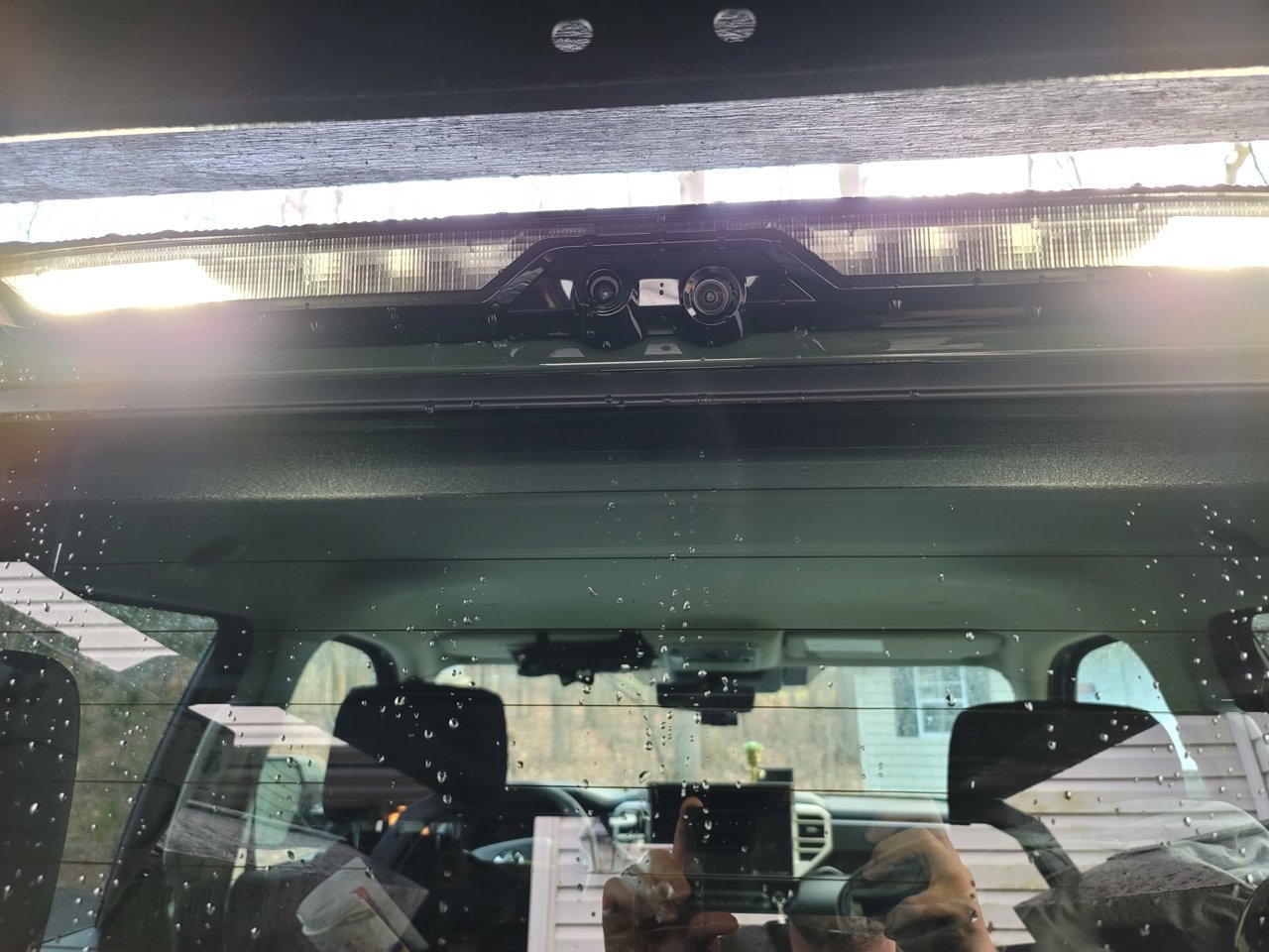

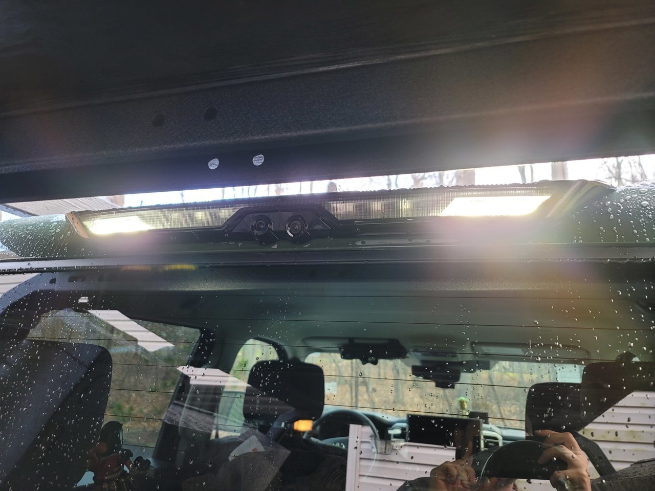

    From a distance it could look like there are 2 cameras, but the one on the left is just molded plastic that is in the shape of a camera. The left camera for Digital Rear-view mirror is part of the SPA (Straight Path Assist) which there would be a switch for that which is letter G in the picture below. If you have that switch, you'll have the digital rear-view mirror and camera.

    Let me rephrase, The digital rear-view mirror and it's camera on back of cab seem to always be packaged together with the SPA.

    Yes!! I just completed the install. The wiring harness was pretty easy to make.
