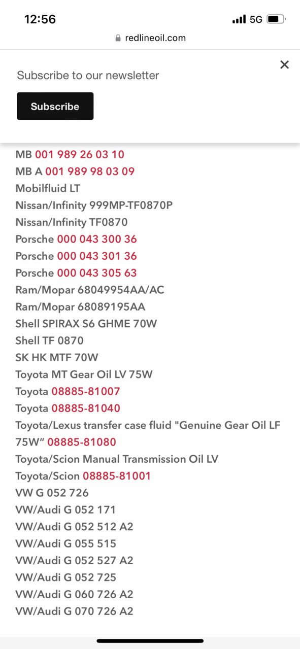

    I'm sure it'll work just fine, others on here have used that fluid, they advertise is at a 75w equivalent but the only fluid actually approved is the Toyota fluid, they don't spec any alternatives.

    Redline, Ravenol and Royal Purple all claim to be able to replace the 08885-81080. I was just stating that none of them are actually approved by Toyota and none of them can claim to meet Toyotas spec because Toyota has never released a spec for it besides its own fluid. I'm sure they all will do just fine though, only issues I have seen on the forums is people with that have used 75w90.

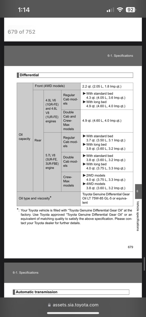

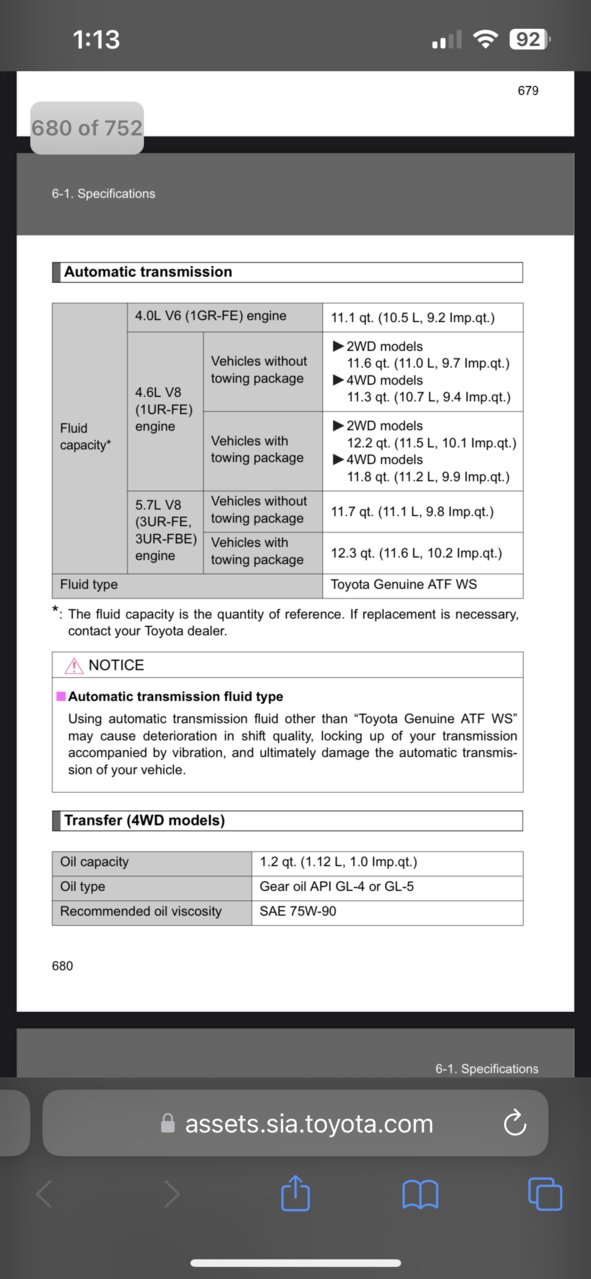

    From the 2013 manual
    7023D706-40E3-49C5-82D3-3BF9B0E4FFBA.jpg 53DBCF8F-A9DB-4A85-A823-EC6286E08828.jpg
    georgiey22 likes this.

    Incase you didn't know, this is the 2014-2021 Sub forum. The transfer case changed in 2014 along with the oil spec.

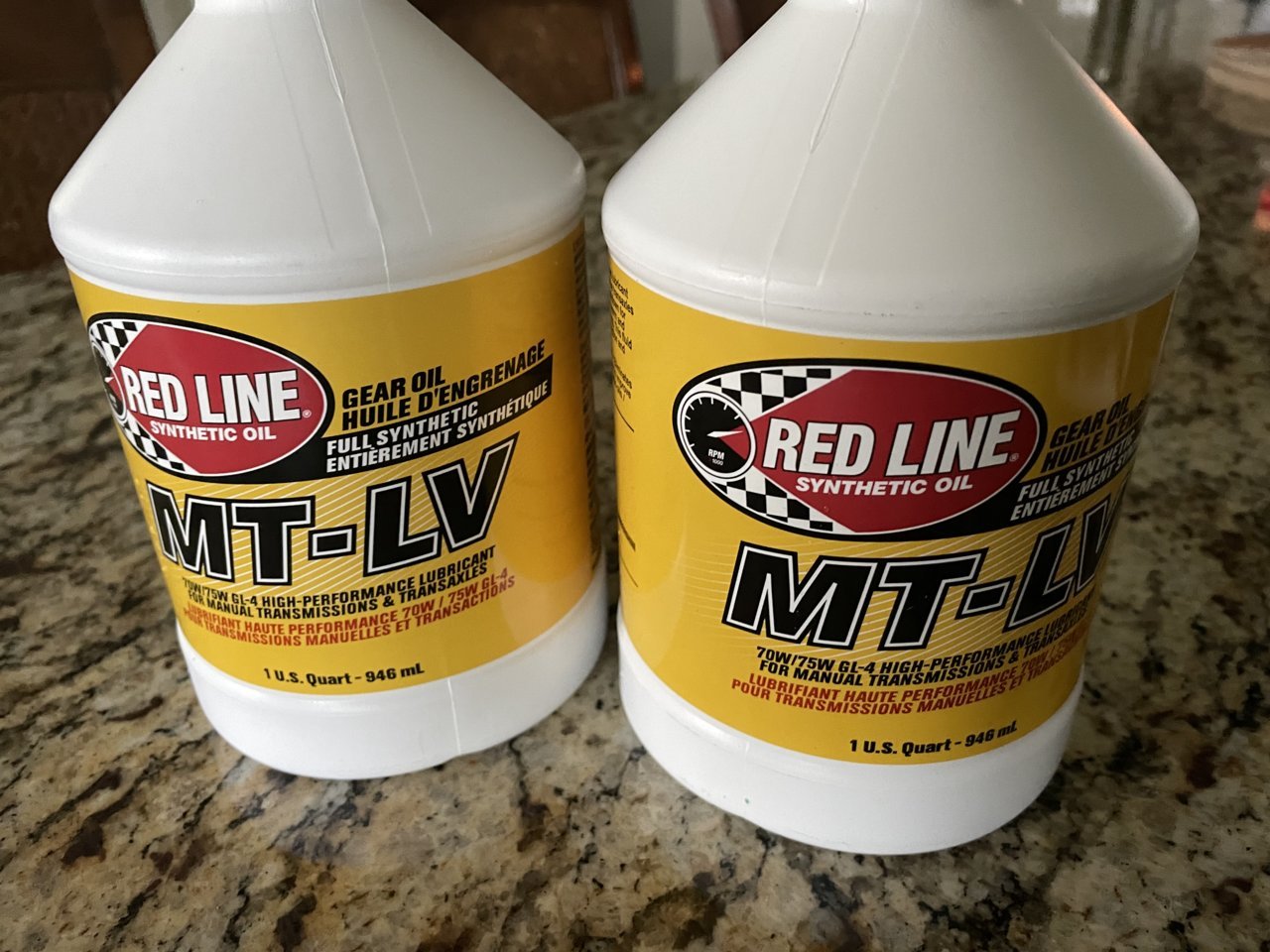

    Went ahead and drained the transfer case and added 1.7 quarts of Red Line MT-LV gear oil. Will update this thread in the coming weeks and months to share if there are any observable differences in my truck.

    I’ve been using the mt-lv for 35k miles, there has been no shift difference vs oem.

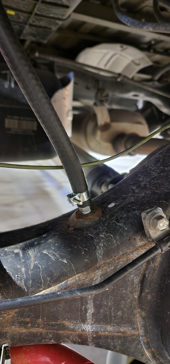

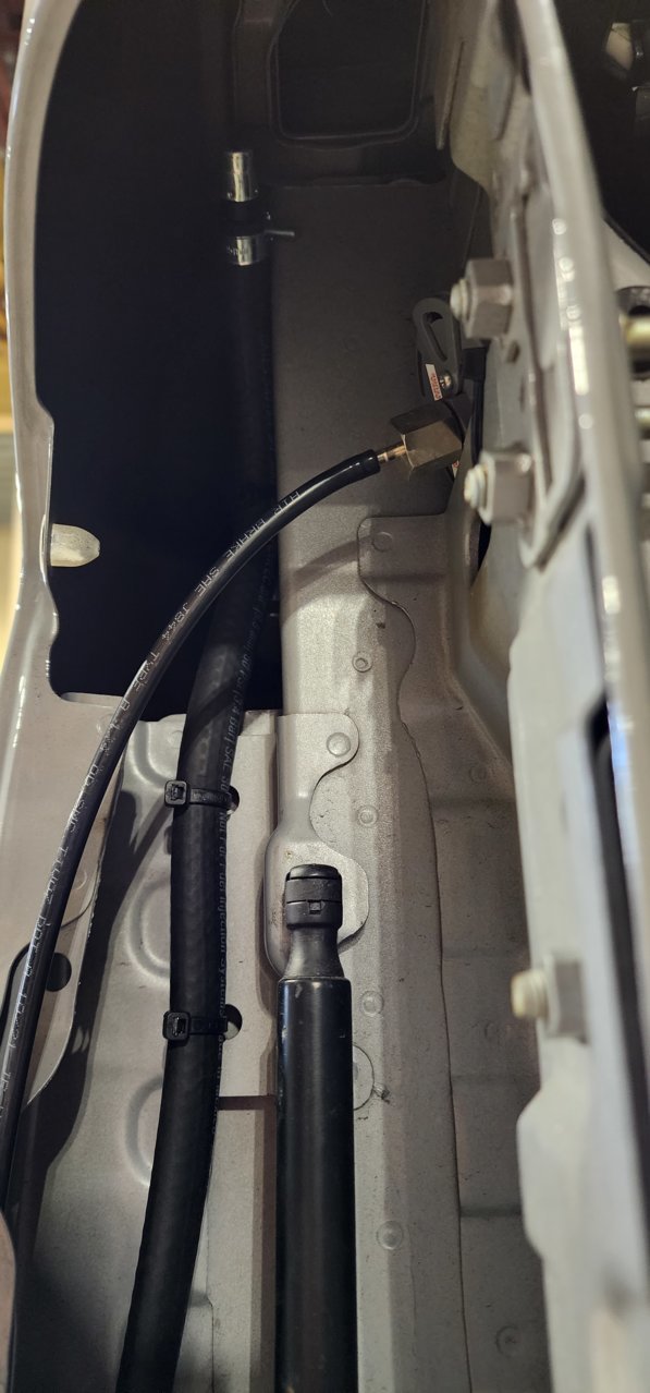

    Took care of both front and rear differentials and the transfer case and also relocated the rear differential breather to up behind the driver side tail light. Everything took about 2 and 1/2 hours with cleanup. I have 37,000 miles on the truck and the fluid looked really well. Some very slight tint of silver but that's expected from break-in.
