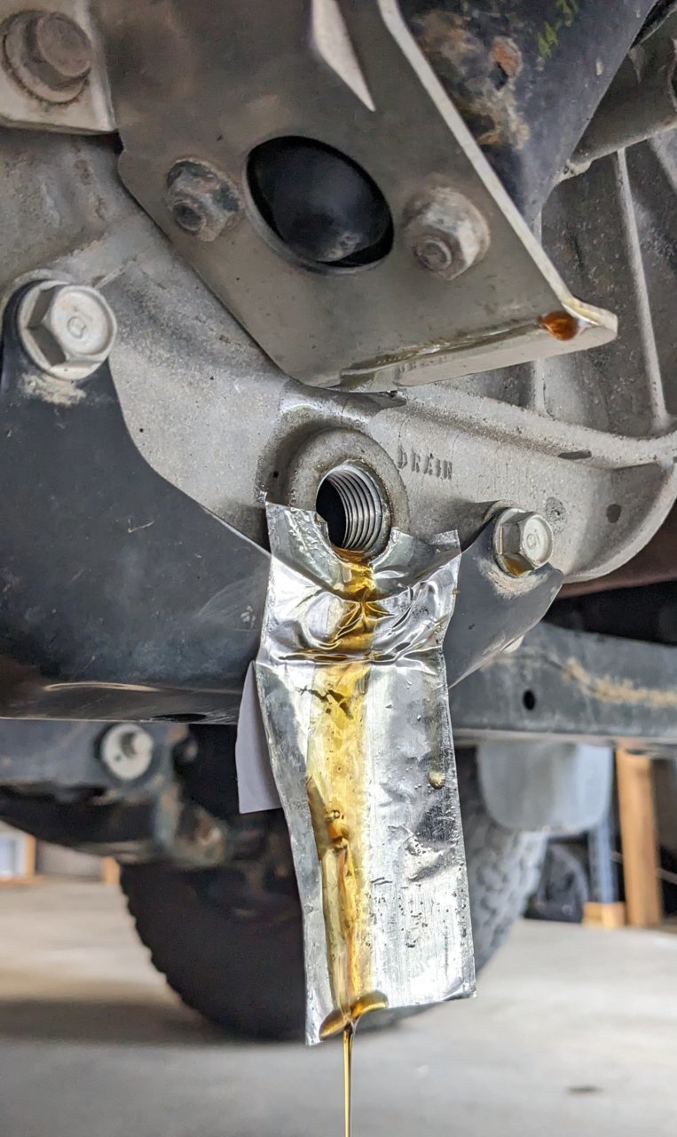

    TCase_MetalTape.jpg I found this thread really helpful, so thought I'd add this tip. It worked OK for me. Rather than drop the transfer case skid plate, I just used a piece of metal tape to redirect the draining fluid.

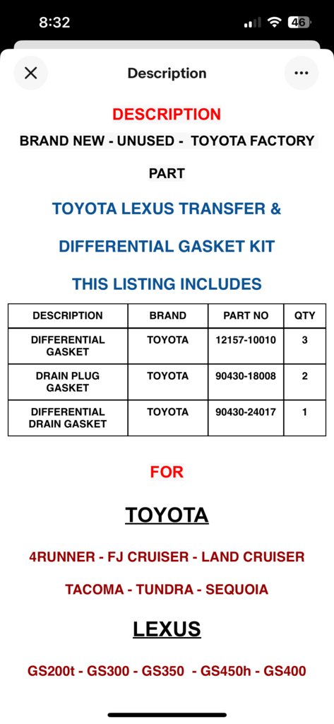

    According to SparksParts there is a new front diff drain washer, part # 90430-24017, the above is the old part number, but I believe it’s still the same flat copper washer.

    Weird, but not surprising that they’d change a part number and create additional SKUs for (presumably) identical items.
    But, yes. You’ll need (3) of one, and (1) of the other for the diff’s. T-case just uses 3/4” pipe plugs. Up to you if you’re comfortable using a couple wraps of Teflon tape or a dab of pipe dope. Some folks have concerns about Teflon in the case, but it won’t happen if you wrap the plugs correctly. …don’t wrap the first thread…
