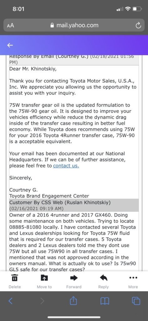

    I checked with my dealer and they use 75-90 in differentials and transfer case. They said they only use 75 when warranty is involved. I used 75-90 synthetic in all and no problems goin and out of 4 wheel drive.

    Yeah and they use it out of a huge drum, which is assumed to be lower quality. Most shops use the same oil for all 3. Doesn't mean it's correct. The T case takes a different fluid per Toyota. And Toyota sells a specific T case fluid that is super expensive.

    from Toyota to one of the members,

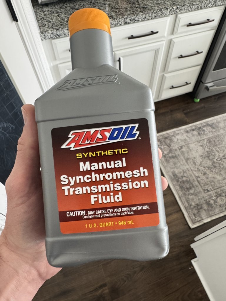

    You contacted sales associates/ customer service reps. Not engineers, their system says there is no substitute, that’s what they are telling you. They aren’t going to recommend an oil they haven’t deemed as an acceptable replacement. If you are looking for an Amsoil fluid that works well in our transfer cases by Amsoil, I’ve been using their syncromesh fluid, it’s been working great and a lot of the tacoma/4runner guys have been using it also. I’m not sure why Amsoil hasn’t added it to their substitutions list.
