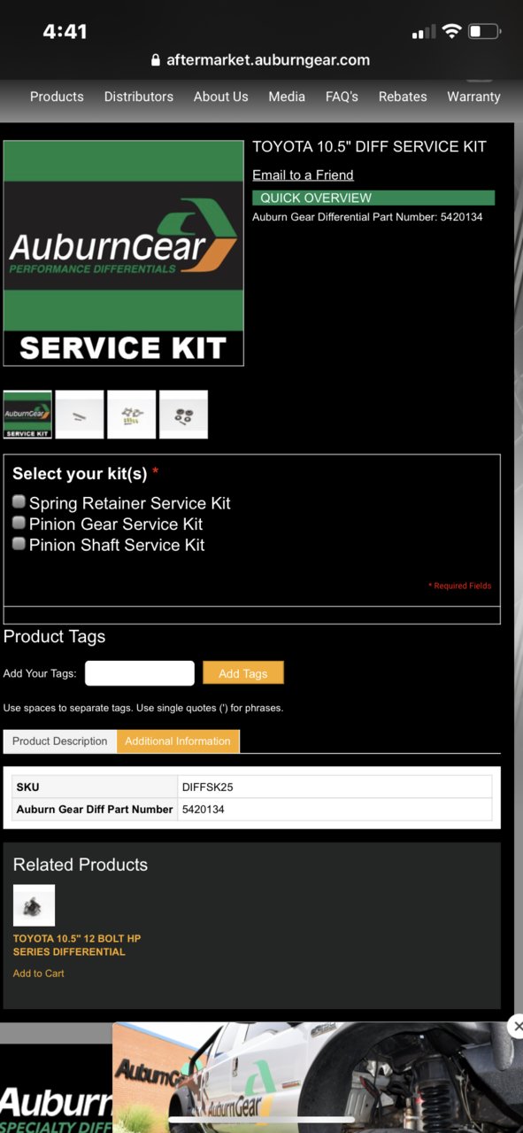

    Are the standard / original Auburn LSD for 2nd gen Tundra still available, what is the part number?
