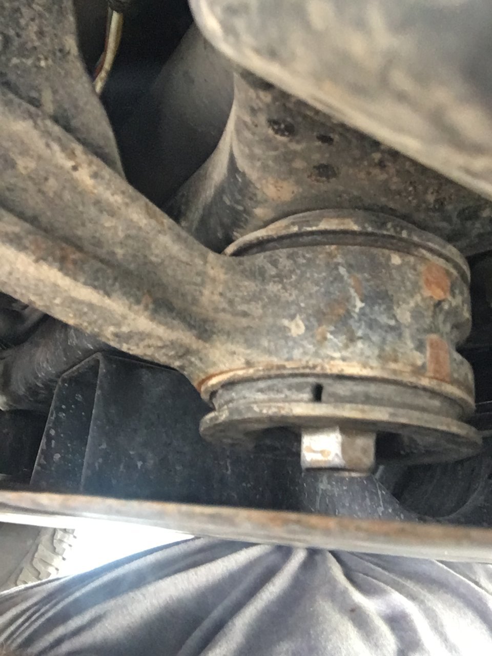

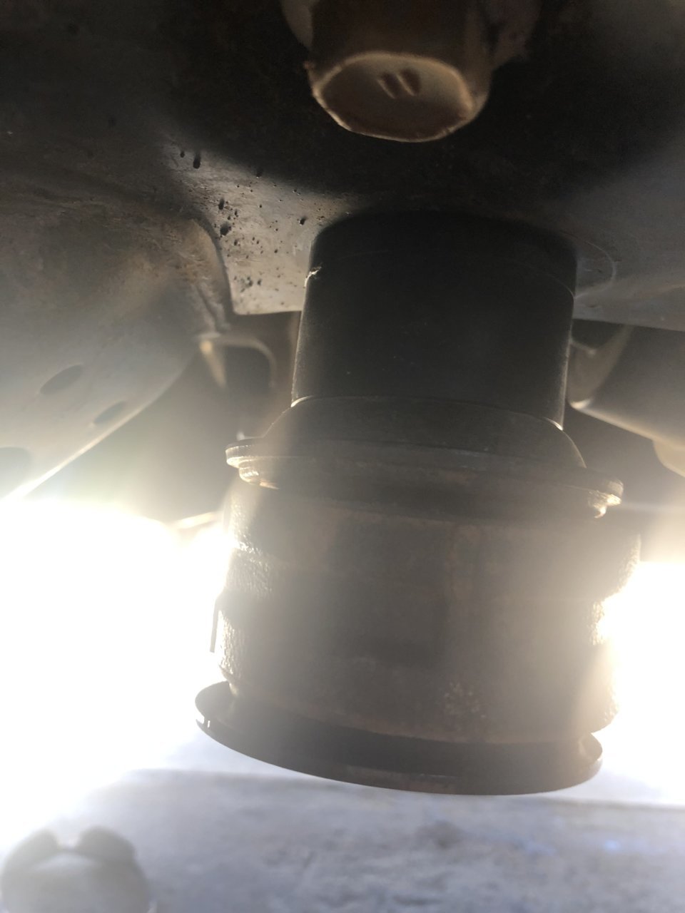

    Peeking through my skid plate it looks like I have some type of conical washer that would fit the contours over what you have there.

    Large flat washer on top of the cross member as I recall.

    My toytech diff kit has washers for those bolts.

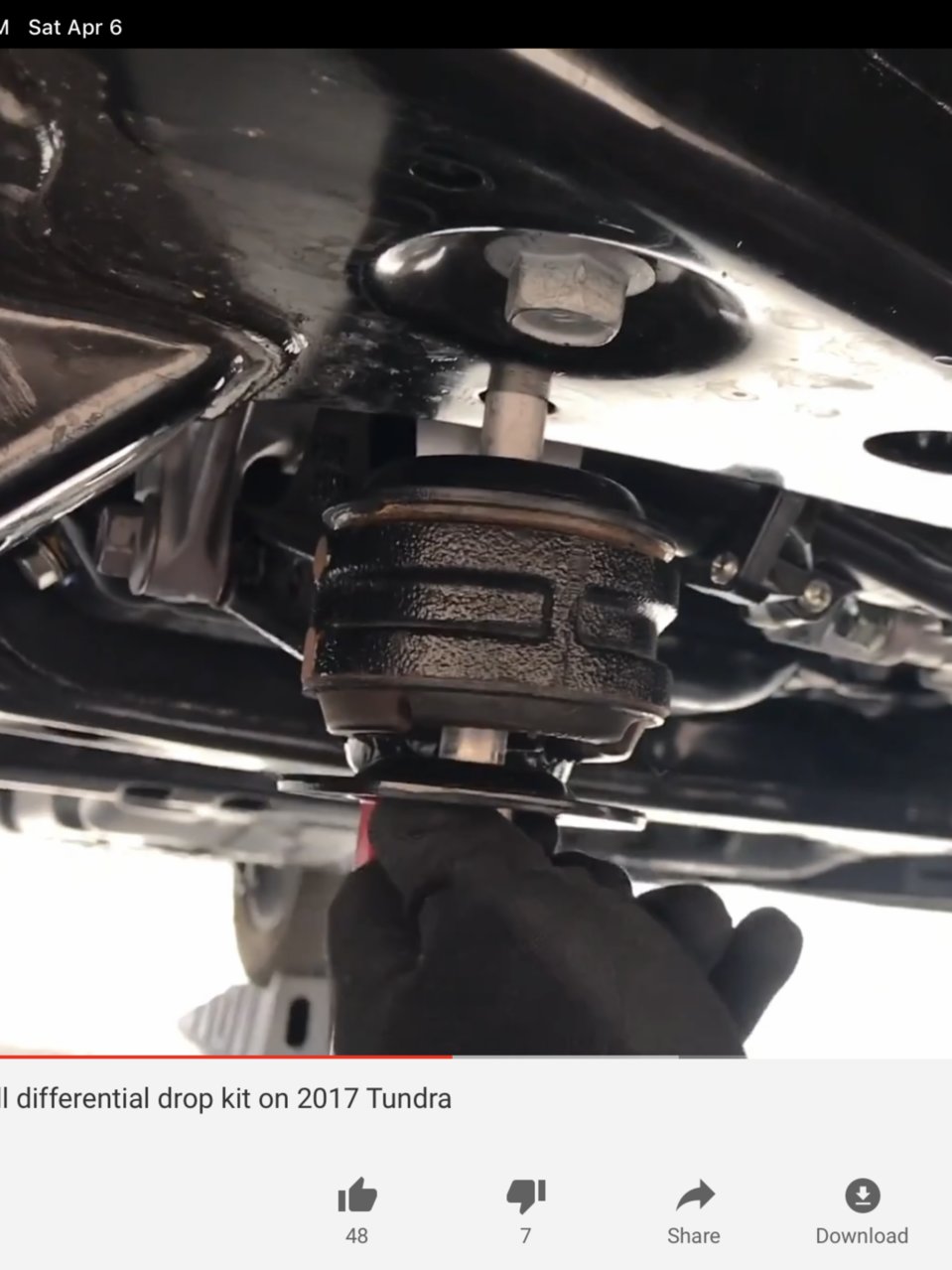

    Mine has washers to, just bigger than the head. Every video I watched and 15whtrd has the large flat washers on the bottom

    Looking at this again compared to mine. It looks like the bolt is bottomed out or not fully supporting the diff mounts.

    It’s actually not bottomed out, it still has threads but I have tightened it as much as I can without stripping or snapping it. I’m thinking of taking the mount off and bolting it up to the frame then attaching it to the diff

    Mine sits like that also. Been like that a couple of years. Not quite as big a gap, but slightly misseated. A friend that does installs said he’s seen others do it too. I wonder if it’s the brand of diff drop? I’ve been meaning to remove the drop since I’m only at 2.5” now. But the skid plate is in the way and I’m sick of removing it. And whenever the skid plate comes off, then I can’t find the stock bolts. :annoyed:

    I think that washer your missing should be factory and should have been reused prior to installing..

    This is exactly what is going on. Your installer didn't transfer the large washer onto the longer bolt. Go slap that bitch.

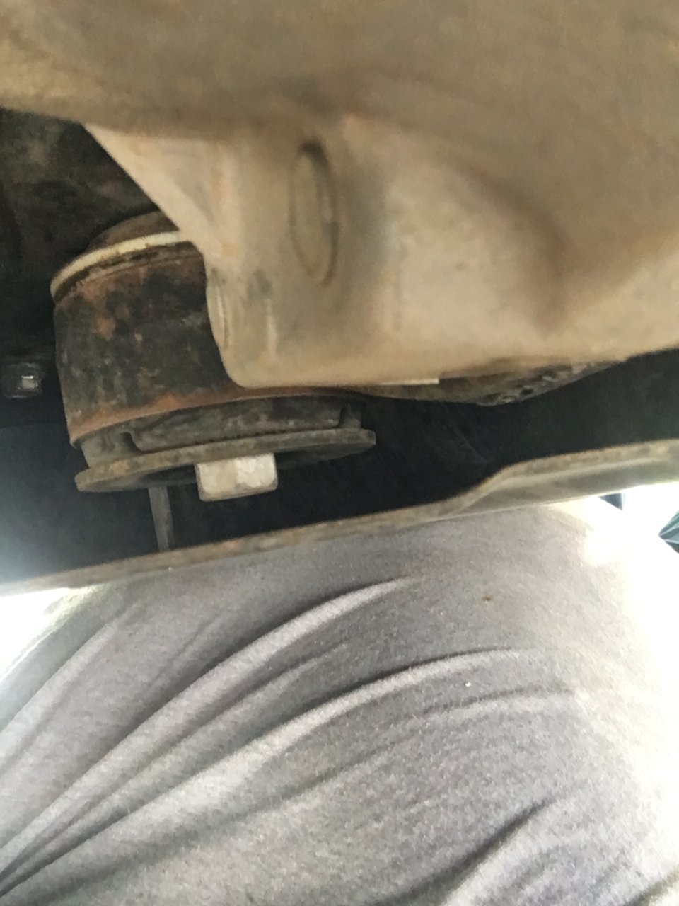

    Your missing the washer in this picture.

    Yep. I called today and they are suppose to find them or replace them

    ^^^Yes this! Those folks that installed it decided to leave off that washer, factory one goes back on and compresses against the bushing. Hopefully not cross threaded either, PITA to get the drivers side nut on and tight...when I installed my lift I think that was the point in the day where my swearing became audible throughout the neighborhood...

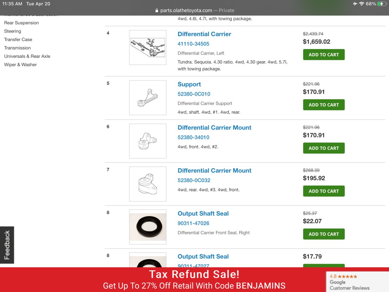

    Anyone know where I can order these? The shop that lost them is giving me the run around

    @Roman can help. Or any Toyota parts department is fine as well.

    @Roman i’m Trying to get the shop that left them off and lost them replace them. It’s just the bottom but I’ll let you know! Thanks!!

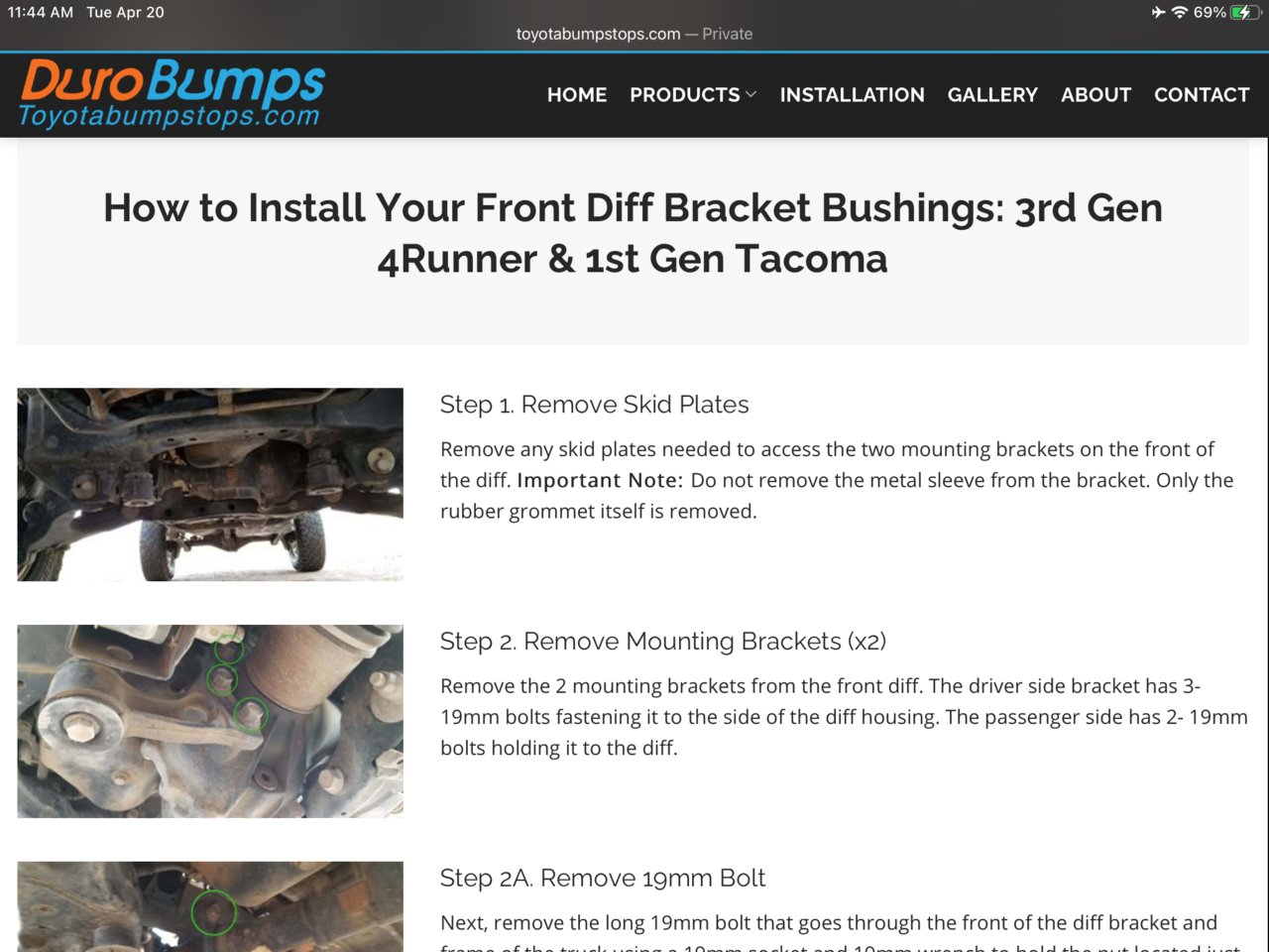

    Bad pic. I got one of the washers installed. Diff is not bouncing 1/4” now. The driver side is going to be a total ass lol. I talked with a experienced shop and the only conclusion they could come up with is during turns, slow bumps, the diff was moving around lowly causing the CV’s to bind. We’ll see!

    Same issue here....I’m following this thread...and ordering replacement bushings....
