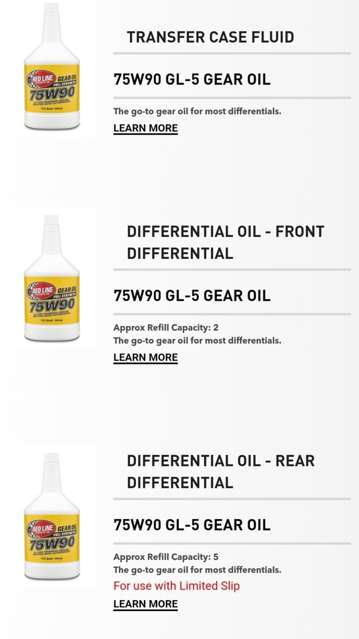

    I used (I've only done it once in my 2017 (at 55k, it has 77k now) once and did Ravenol 75W in the transfer case. Next time I'll just use the Red Line the transfer case too.
