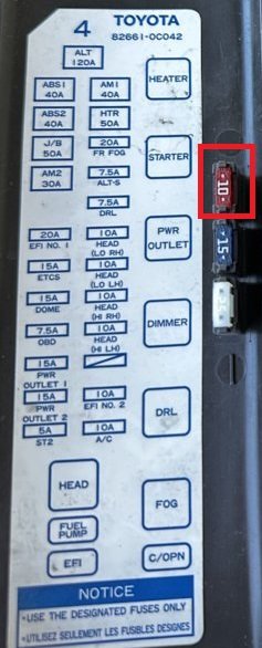

    Wait. Wtf… I just put that extra 10a in that empty spot and it started up the first time..!!! Seriously i’m gonna take it for a cruise see if things are better and if so, how the hell did that come out of there?

    No way… I put that extra 10 a dust in the EFI #2 spot and the problem is gone. Not quite sure how to feel about that other than stupid. Luckily I’m not a mechanic and only a window cleaner. I have 222,000 miles on this truck. And I guess I could look at it as lesson learned and a really good tuneup. Or a bunch of wasteful spending for no reason. Well, now I can get a new windshield and put some cool new tires on. Wow thank you for that clue

    Don't forget to replace that spare fuse, might come in handy
    Got plenty of windows I can hire you to clean :D

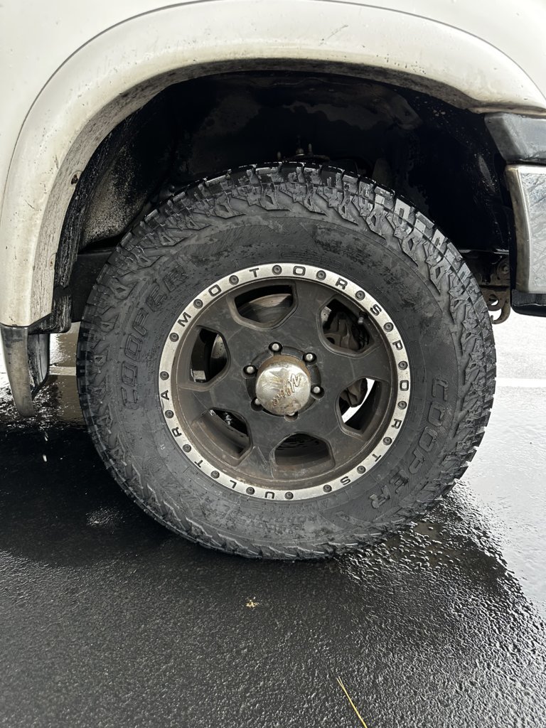

    Okay.. I think I can wrap up this thread. Hopefully. After re doing all the battery cables, negative & positive, the truck seems to running great. I replaced all spark plugs and coil overs. Fuel filter, air filter, MAF sensor, crankshaft position sensor and a bad thermostat. Then Bubba W ask me to check the EFI #2 fuse in the engine compartment. It was empty..! I’m pretty sure I am the one who caused my initial problem of 1st crank die, 2nd crank start and hesitating and bucking when punching it. My guess is I accidentally put the 10A fuse in the slot just above the EFI #2 spot that’s supposed to be empty! Stupid…. No warning lights and driving really good on my way back home on the 250 mile trip.. THANK YOU… you guys rock. I put new Cooper AT’s on it and got an alignment… next is a new windshield and I suppose I will learn a little bit about body work and replace the damage done from the deer encounter…
